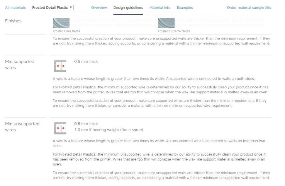

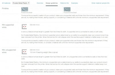

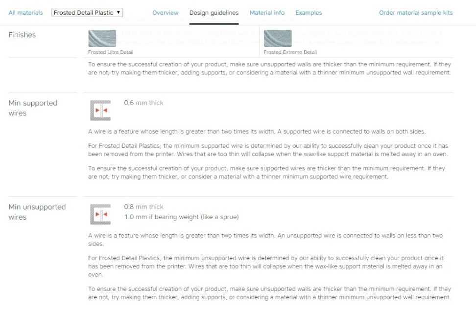

I'll certainly be designing the rails. I think we're good in 1/144 and larger.
Being long and thin, Shapeways would call the components of the rail "wires". The minimum wire thickness Shapeways can print is 0.6mm in diameter. The minimum wire thickness Shapeways' printers can clean by hand without tearing up the parts is typically 0.8mm in diameter, overscale for 1/350 scale. The minimum wire thickness for any part that carries weight is 1.0mm in diameter.
When a design is uploaded to Shapeways, their design analysis software evaluates the design immediately and would accept the rails as printable if the wires of the rails were at least 0.6mm in diameter. After the first order is placed, a human "print engineer", the guy or gal who actually prints it and cleans it by hand after printing, would evaluate the design before printing using software that measures each feature.
If any wire feature is less than 0.8mm in diameter, the human print engineer would reject the design stating that it wouldn't survive cleaning and handling. Shapeways would cancel the order frustrating the customer. If that happens, Shapeways will send me an email describing why the order was rejected.
Sometimes a rejection happens for a minor, inconspicuous feature easily thickened. I can thicken that feature quickly and the updated design is made available the same day for re-ordering. But I think in-scale rails are very thin to begin with in 1/350, maybe too thin to thicken yet make look right. We'll just have to see how the 1/350 rails look once I get them done. Let's hope for the best.

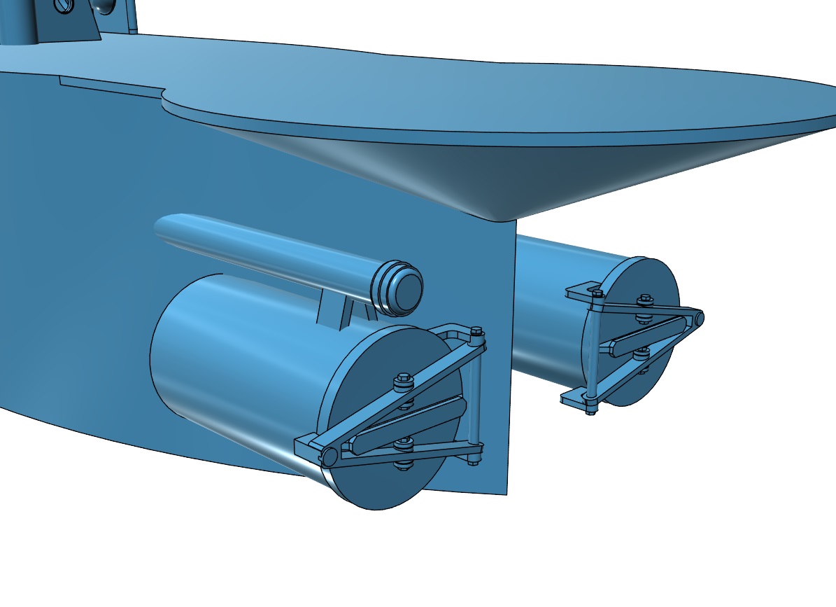

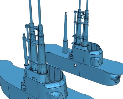

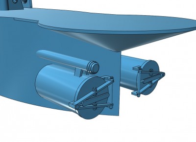

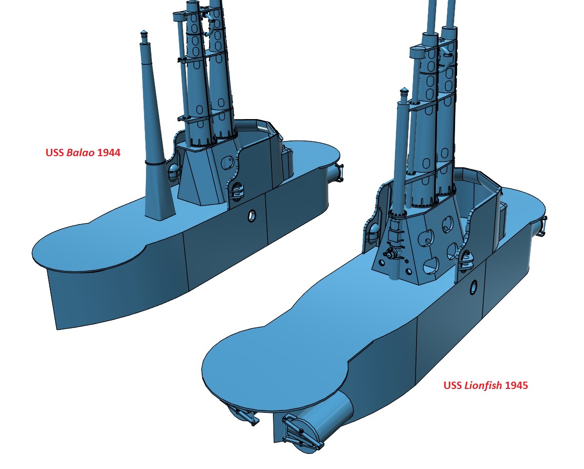

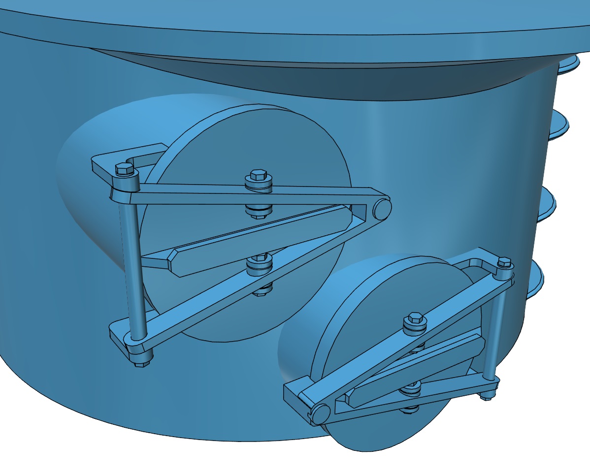

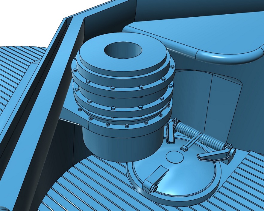

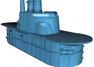

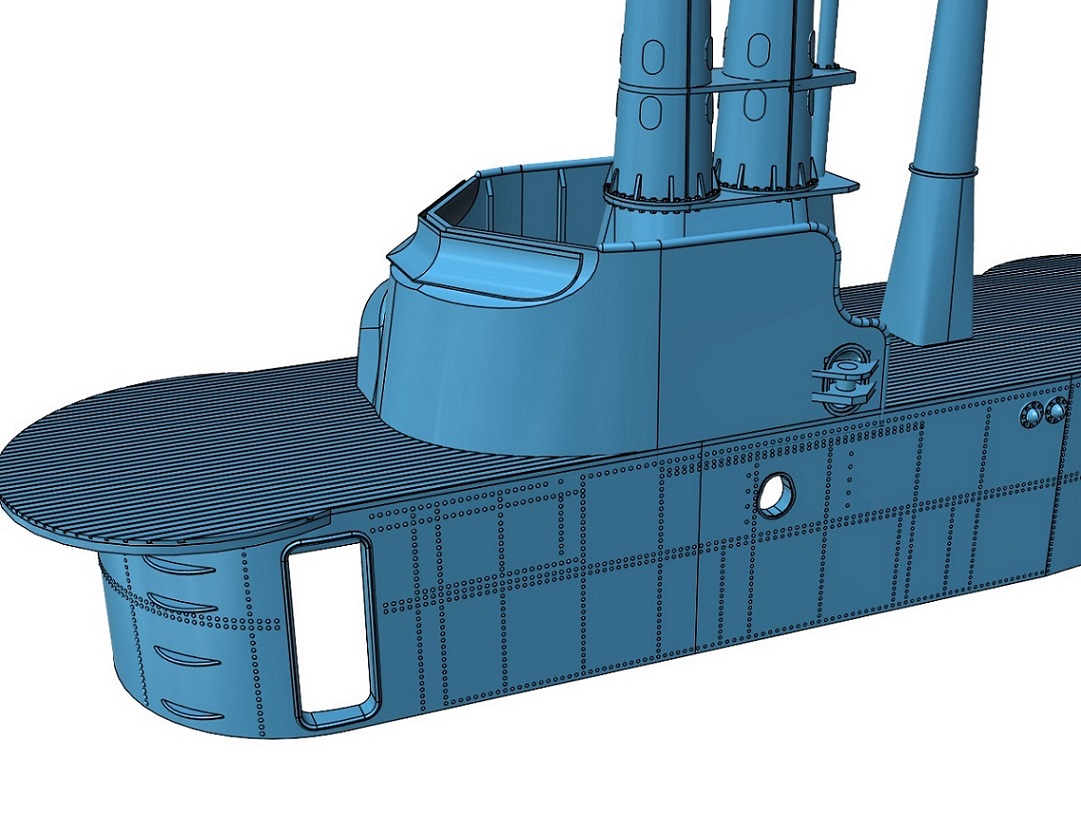

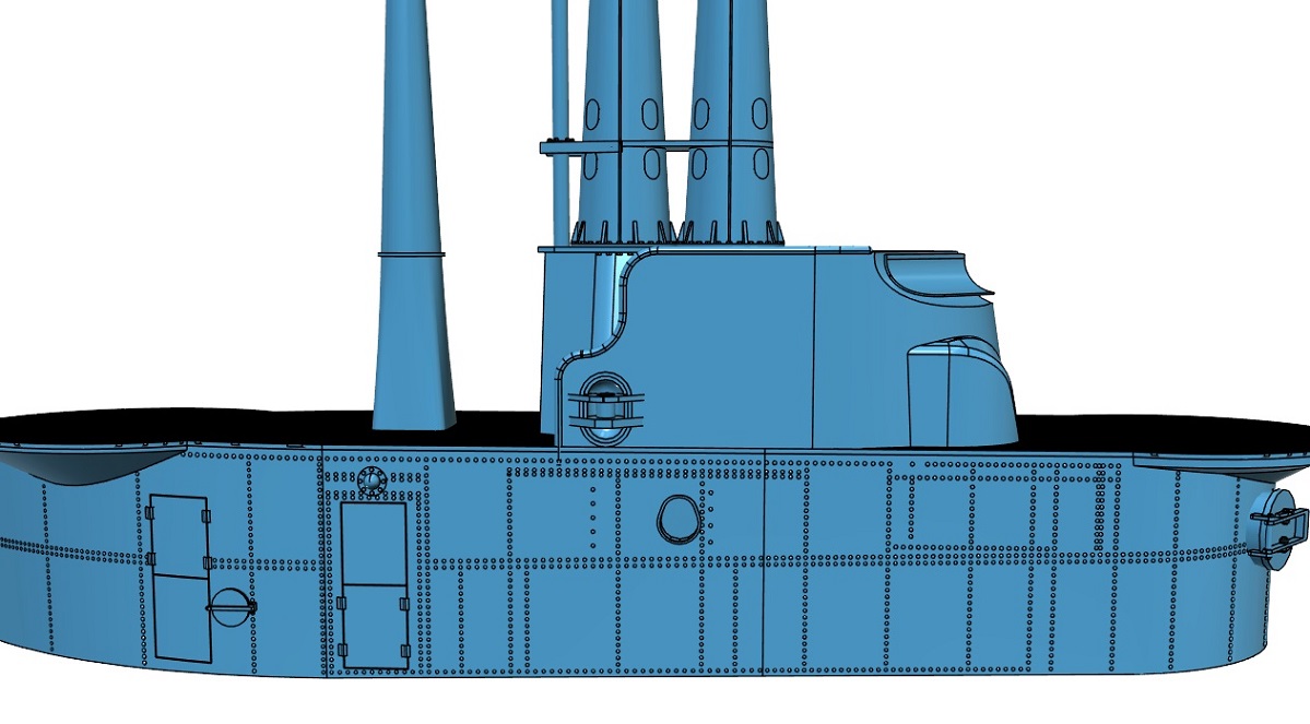

Here's the design at about 75% complete. Ammunition lockers and further details have been added.
There will actually be two versions to choose from:
1. Mid-war suitable for USS Balao SS-285 with "short" aft cigarette deck and "short" periscope pedestal
2. Late-war suitable for USS Lionfish SS-298 with "long" aft cigarette deck, "long" periscope pedestal, and additional ammunition lockers for a significantly increased AA fit
If desired, modelers can easily make minor changes to these two representative designs to better replicate the specific features of fairwaters of most boats of the class.
The design you see below is for a late-war Lionfish.

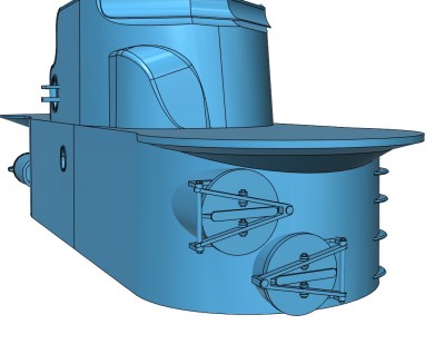

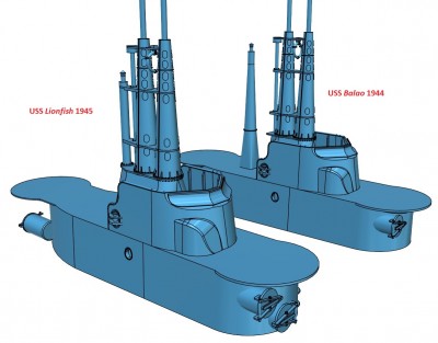

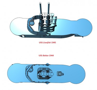

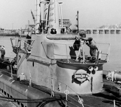

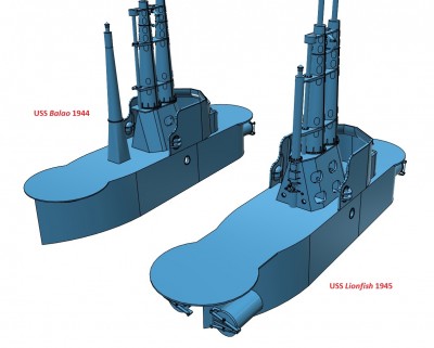

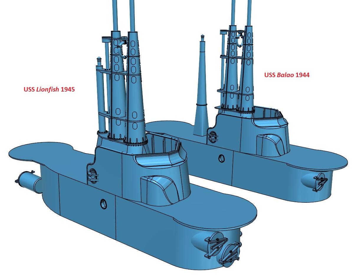

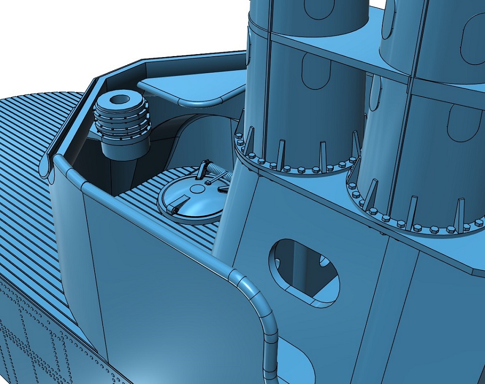

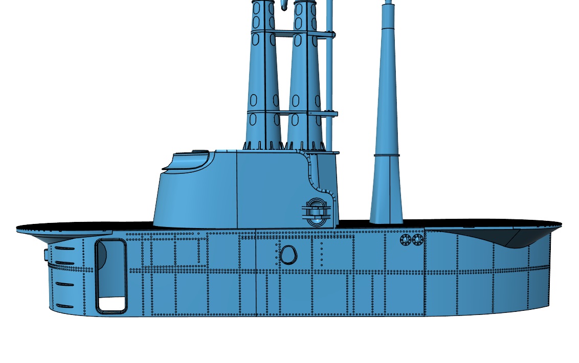

Here are some renderings so you can see the conspicuous differences between the two major types of Balao class fairwater designs.
The large cylinders protruding fore and aft I believe to be ammunition lockers. The hinge and door reinforcement for the ammunition locker on the front of Balao will be changed to a different configuration (two horizontal beams rather than two sloped beams that join at one end). The locker you see on Balao is a place-holder for one with a different hinge just to give you some idea of what Balao had, and didn't have, compared to Lionfish.
Among the many details yet to be designed: deck planking, rails, periscope tops, lookout stands, interior instrumentation on the open bridge, and a whole lot of rivets, and more.
Some of the features you see here will be tweaked a bit, the width of the aft cigarette deck extension on Lionfish will be widened, for example, but the proverbial light at the end of the tunnel is in view.

Nice! If I remember correctly at least one of the cylindrical protrusions held an inflatable boat/life raft. I will see if I can find the source for this.

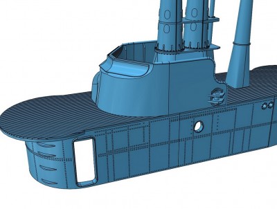

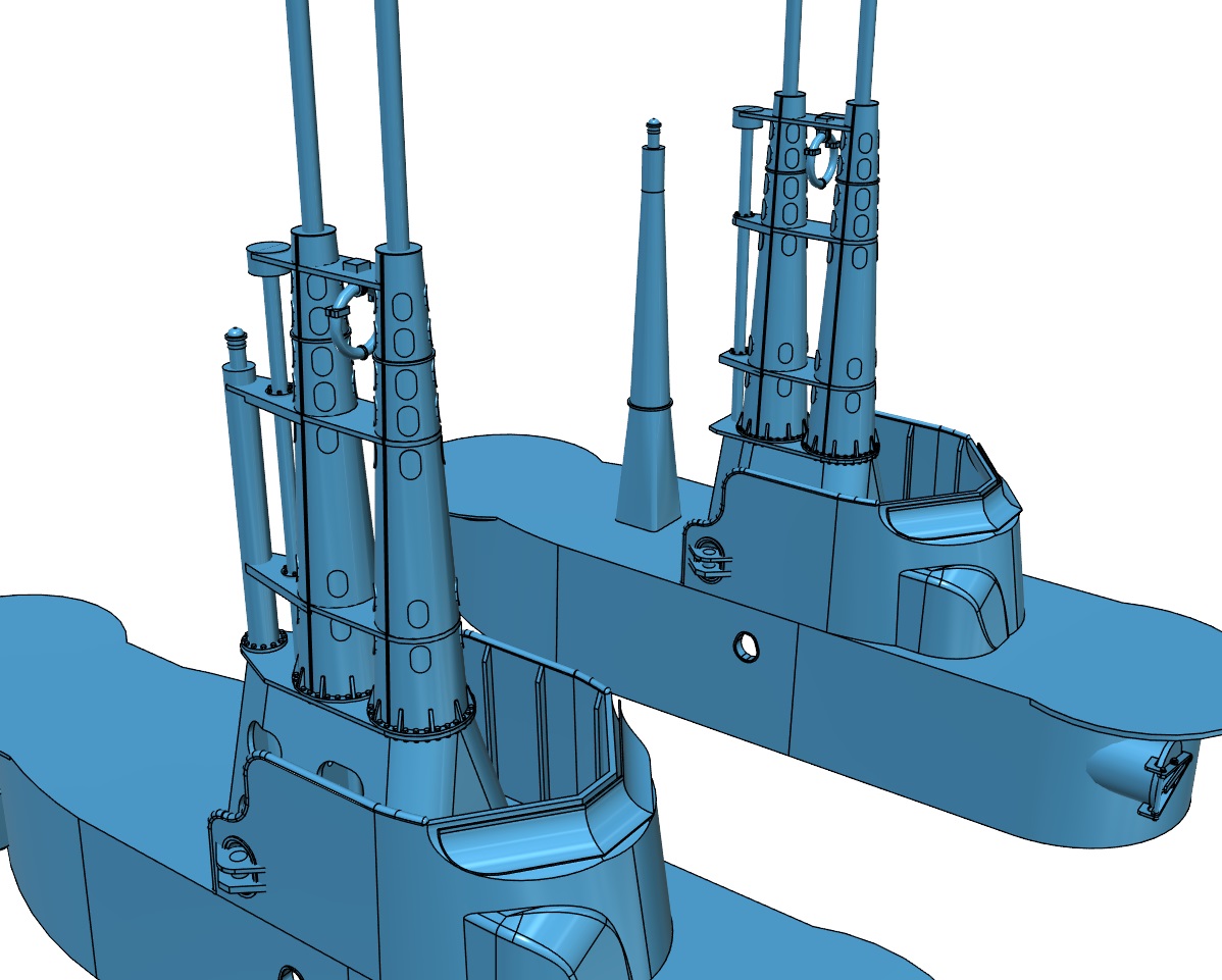

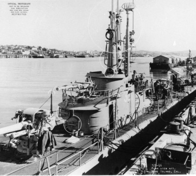

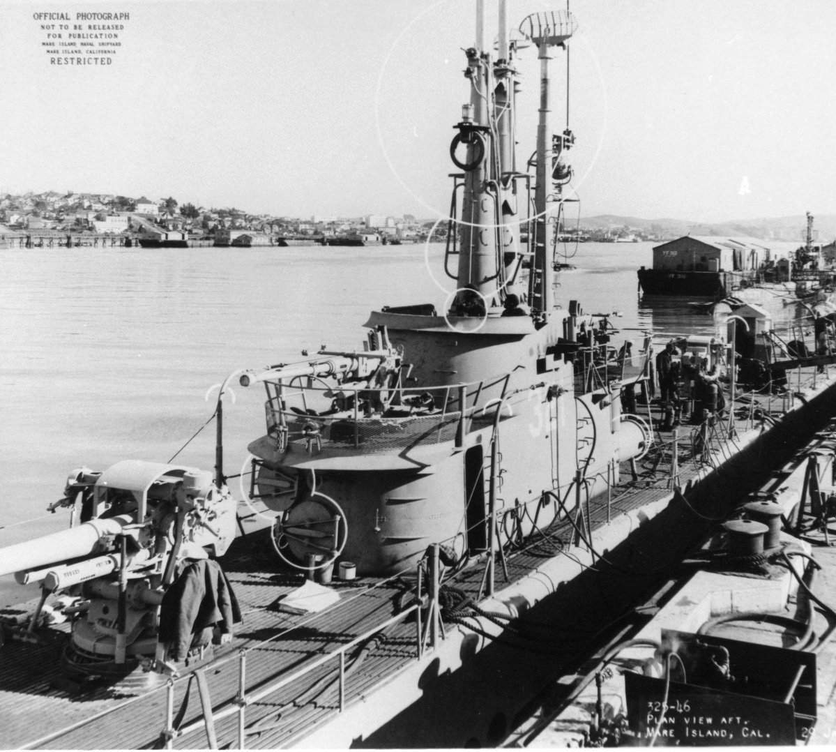

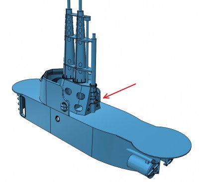

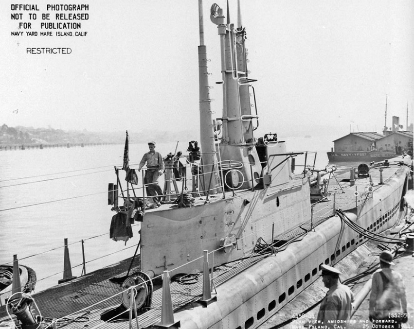

Balao at about 90% complete. Lionfish will be completed after Balao.
Riveting took three days full time, much longer than expected. Lionfish's riveting pattern is a bit different.
Some of the features you see here will be tweaked a bit yet to better match photos. But you can get an idea of how the fairwater will look completed.
The photos of Balao at bottom were taken when she carried Oerlikons. Later, her aft cigarette deck was enlarged to carry a single Bofors. The enlargement extended outwards but not aft. The model depicts the fairwater's aft cigarette deck after the enlargement, ready for a Bofors.

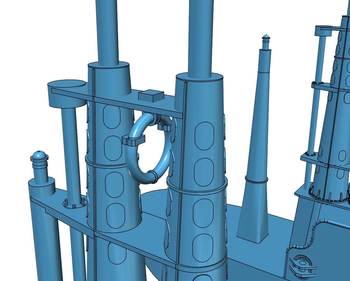

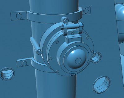

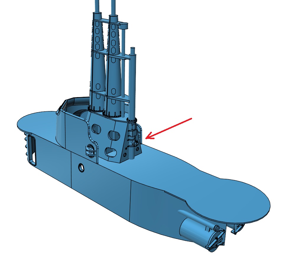

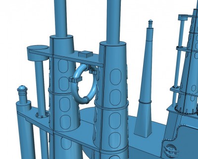

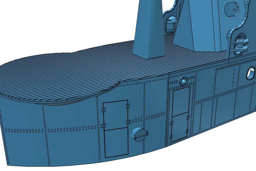

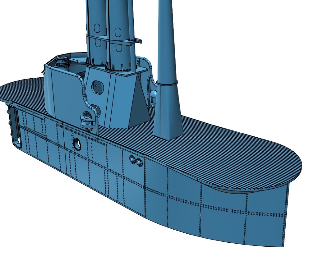

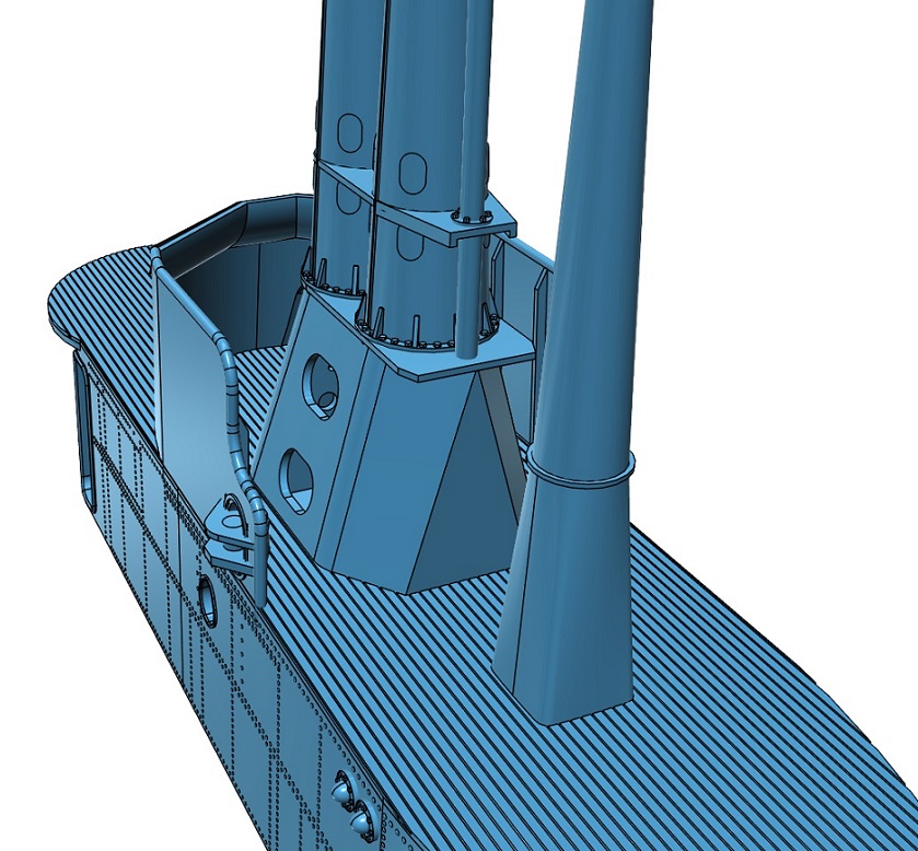

Here is the design at 95% complete. The shape of the aft cigarette deck has been improved to better replicate USS Balao's as it appeared in very late 1944-1945. A slat cutout for the hatch, and a bracket for binoculars have been added. The deck is slatted, not planked.
So far, no authoritative, dimensioned 2D drawings have been found from which to design periscopes that would be more accurate than what is already in the kits. Furthermore, including periscopes adds to the cost. I think it may be best for the modeler to use the kit periscopes instead.
Many different submarines of the class can be built from this design. For those who would like to build Balao specifically, she had two different weapon configurations appropriate for this design:
- One 20mm Oerlikon forward and one 40mm Bofors aft
- Two 40mm Bofors, one forward and one aft.
Last major features to design: lookout stands, some interior instrumentation, exterior details and the rails.
