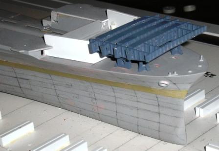

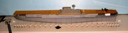

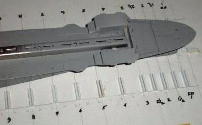

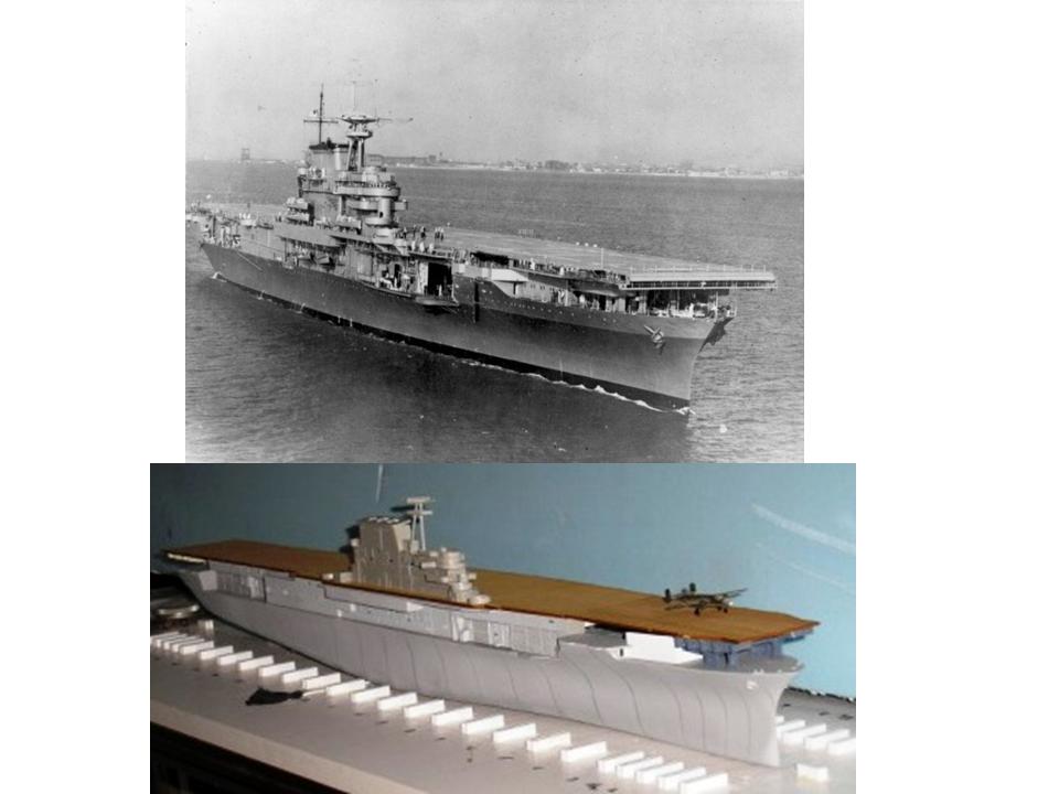

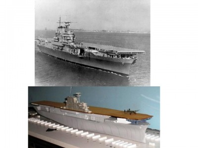

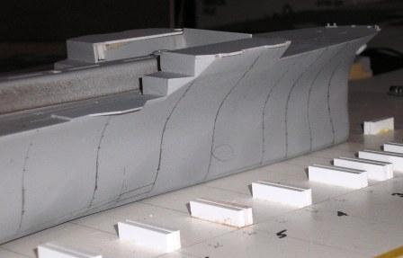

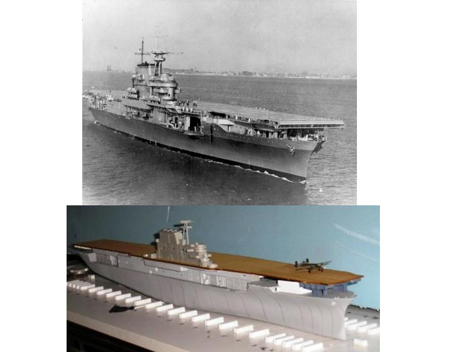

Well, I'm out of hibernation and back at it I guess. I've had to put aside modeling projects for the last several months to do some volunteer work. Robotics, if you must know. I helped some High School kids build a robot for competition as part of getting kids interested in Math and Science - Engineering is my gig.
Anyway, I have finished the HORNET hull to my satisfaction. It is now in essentially perfect agreement with the templates and lines from the Webb plans. In other words, it looks pretty much as it should have looked when I opened either kit box the first time. So then I got to thinking. The hull looks awfully smooth compared to the photos I have of HORNET. At any distance, the hull plating strakes are clear to me. Sigh. So I am gridding the hull using the plating diagram in the MD Silver plans. I'm probably about half done drawing the plate lines, then I will apply a combination of 3M tape and .005 plastic to make up the alternating courses (I'll only be doing about half the strakes that way since they alternate above / below as they overlap). I have done something similar on a much smaller model some years back and it has held up very well.
I have also found (as I think others have pointed out) that the sides of the Trumpeter Hangar deck walls are not correct enough for my needs when compared to the plans. I must be nuts, but I'm going to rebuild the sides too. I just wonder what plans they used . . . . . I just want you all to know that I said I would never scratchbuild anything because it is too time consuming. Boy, was I wrong.

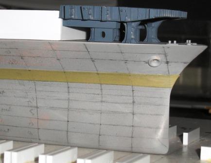

Anyway, here are a couple of the most recent pictures. Here's the overall comparison photo of the actual ship to the model:
You can see the pencil lines on the hull for the hull stations. I used these for the gridding (doesn't show here yet) to apply the hull plates.
Here's the side view. Unfortunately, the Trumpeter hangar deck sides are too tall and the ship appears more chunky looking than it will be when I get the right parts made. You can see the trapezoidal-shaped sponson for the for the hangar deck catapult just aft of the forward 5" gallery deck. It doesn't show here, but the deckhouse forward of those galleries is repositioned aft as is the gallery deck itself when compared to the original locations on the Trump and BWN kits I started with.
Finally, here's one more shot that might be interesting.
I'll post some more pictures when I have the plating in place. That should be sometime between one week and five years from now. Exercise and stay fit until then.
John W.

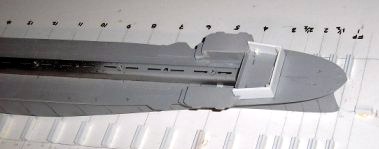

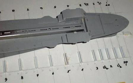

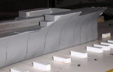

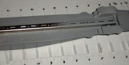

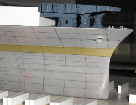

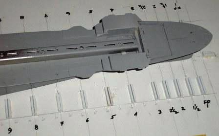

Here are a few more shots from different angles. The first is an oblique shot from starboard bow quarter. A couple of things to note here. A. - The hull never actually is parallel to the hangar deck edge except for a short distance well above the waterline. The hull flares up to the hangar deck - a small amount near midship (station 11 is the center of the ship's length) and a lot elsewhere; B. - The shape of the hangar deck catapult sponson (actually just the top deck of the sponson, the 'bumper' portion is not yet installed); C. - The slots for the Trumpeter deck house show how far aft the edge of the gun galleries had to be moved compared to the tip of the bow. Yes, I did use Trump's foredeck. D. - Yes, that is a wall shelf bracket channel screwed to the hull's hangar deck floor. To (hopefully) counteract any hogging of the resin (ex-BWN) hull, I put the channel in. During the launch for the Raid, almost all the roller doors were shut, so I have no plans to show any of the hangar deck internals.
HORNET Hull - top 004.jpg (14.29 KiB) Viewed 3629 times

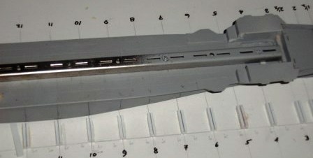

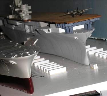

In the next two pictures, you can see the hull shape as it compares to the roughly parallel hangar deck edge. Again, Station 11 is exactly midships.
Finally, here's a low shot looking toward the bow. Notice there is a knuckle at the height of the foredeck and halfway down the aft edge of the 5" gallery deck, at the step. This knuckle is there in the plans and is visible in some photographs if you look carefully. It is plainly visible on the builder's model of YORKTOWN.
Again, I respect choices others make in what and how they model. I had a great deal of trouble reconciling the Trumpeter and BWN interpretation of the YORKTOWN class hull. As is clearly seen in many pictures, the ship's hull is extremely graceful and fast-looking. To model the ship, I had to capture that look as best as I can within my skill limitations.

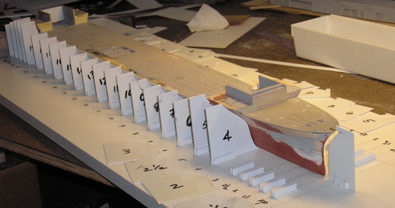

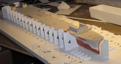

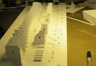

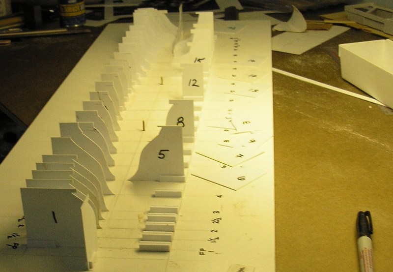

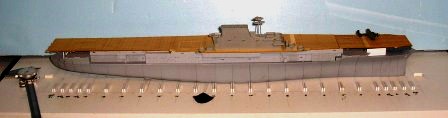

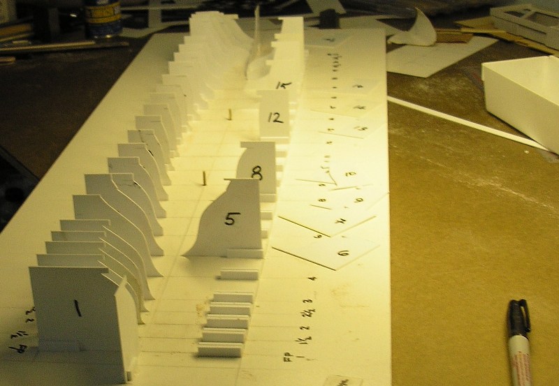

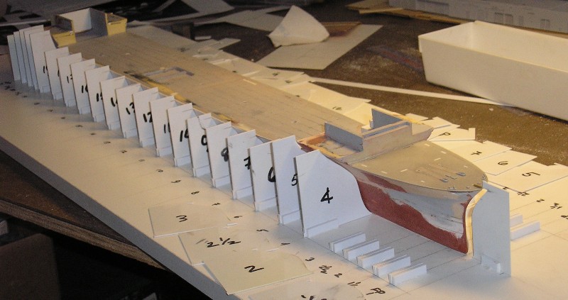

Oh Mike. You're thinking grand thoughts aren't you. Remember the advantage and curse of the larger scale is the opportunity for greater detail.
Looking back on my journey I'd have to say that I wasted a huge amount of time and resources trying to save time and resources. I kept thinking that I could get by shaping the hull by eye, for example, or by bending the plastic hull - with various methods - into submission. After I got pretty deep into the reshaping of the resin hull, I kept thinking how much time I'd lose if I started over with another material. Truth is, I estimate I removed about 35% of the resin by weight in the process of getting down to size. There is NO short, easy, or clean way to do this. I tried every way I could think of. If you haven't joined the bottom of the hull (that below the waterline) you can bandsaw a lot of the resin off instead of grinding. The hard part is removing the undercut areas from the bow almost all the way back to midships. You can try burrs, Surform tools, rattail files, and so forth. I tried taping coarse sandpaper to a large PVC coupling (I think it was about 4" diameter) and that worked OK. Problem is, there is no radius that will fit all or even most of the undercut areas. I can still smell the resin if I think hard enough about it. Not fun. This is why I say I'd use the basswood 'lift' method.
When I finally gave in and realized that I just had to build a hull jig, then things started to move much more quickly in relative terms. If I were to do it again, and I may do so with ENTERPRISE at Midway, I would build the hull jig first. Here's a quick picture of the jig - I posted this picture before back about page 12 or so.
I would use layers of basswood in layer cake fashion. I would carve the hull using the same jig I built, then use other kit parts and plastic scrachbuilding to get the rest of the ship built. The jig ensures the hull is shaped true and fair. One the hull is 'fair and square', the rest of the ship will go along pretty well. I would also take the time and effort to reduce (or blow up) a set of plans to the scale you in which you are building. It is a real pain, even with proportional dividers, to keep going back and forth between the scales. You can lay your parts right down on the plans as you build them. I did this in shrinking the Webb plans to 1/350 and it really helped out a lot and saved time - I'm certain of that.
While you would obviously need to scratchbuild the hull in 1/144 unless there is a hull in fiberglas from the R/C folks, you could still use a variation of the method I describe. At the end of the day, I have come to terms with doing the unthinkable - scratchbuilding - to get what I want. After all, the shipbuilders mostly used large flat steel plates. Evergreen sheet styrene isn't much different . . . .
Hope that answers your question, Mike. Seems like you answer lots of other questions, let me know if I can answer any more.

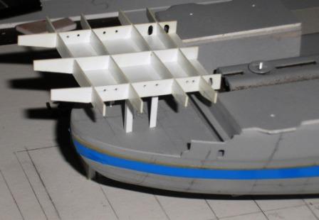

Great job. I took the coward's way out - my hangar deck will not be visible because almost all the roller doors were shut due to the heavy weather at the time of the Doolittle launch.
Since you are taking the time to add the hangar deck details, I hope you'll consider adding the same level of detail for the forward and aft flight deck overhangs. There are a few reasonably clear photos of these areas, and some of the plans for these ships show generally the location and components - but not the details as seen in the photos. I am posting below some pictures of my work in progress to give you an idea of what the structures look like if you decide to ditch the Trump parts which have limited (an incorrect) detail. On a close view of the model, these areas are quite visible.

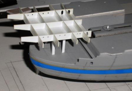

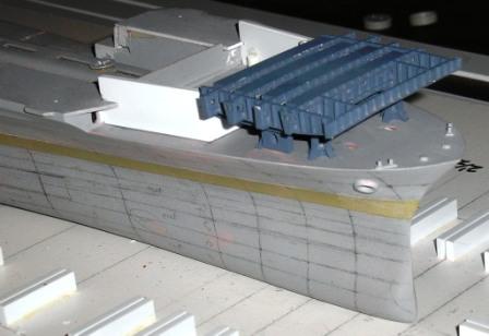

First picture is an oblique view of the forward structure painted Ocean Gray (5-O).
From a more sideways perspective, here's another view. Note the boxed in section for the flight deck catapult gear.
Unfortunately, from this angle you can see why I have to start over. The top of the structure should be level with the boxed-in structure behind it. It was on the Trumpeter hull. Unfortunately, the Trumpeter model is that much too tall according to my plans. The White structure is the correct height from the foc'sl deck to the underside of the flight deck. @#$%^^!
Final picture shows the basics of the aft structure which is more enclosed with work spaces. I stuck some angle stock under it to support it at the approximately correct height for the Trumpeter model. I should be able to use this structure over unlike the forward one.
This is a bit tedious, but not hard to do when you set your mind to it. When I started this project I had a standing rule that I would never scratchbuild much of anything complex because it is too time consuming. Boy, did I guess wrong in that.
Both structures were made from Evergreen plastic.
Of course, the supports for the catwalks tie into the ends of the crossbeams, as the pictures show. There are also safety nets strung under these structures so sailors falling off the catwalks toward the center of the ship will land in the safety nets and not on the deck below in a Class A personal mishap.
