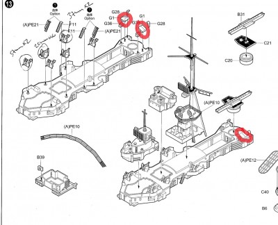

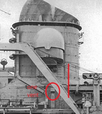

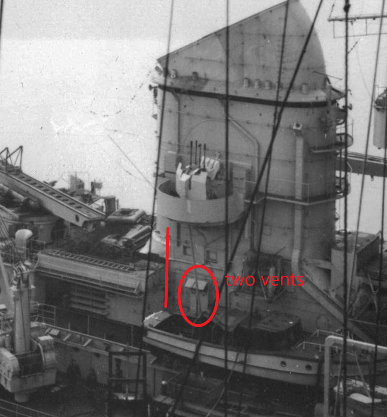

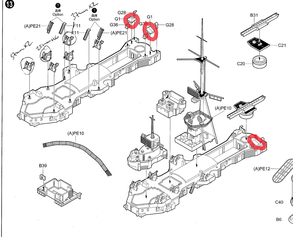

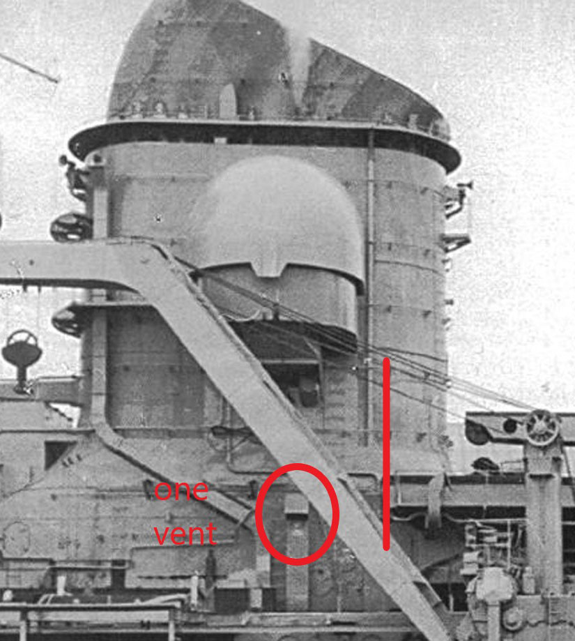

Slow progress on my Prinz, this must be the most complicated funnel ever, so many details! I think there are two things Trumpeter didn't get quite right in the 1/350 modell:
1. the torpedo storage container is too long, I've indicated in the pics the correct lenght.
2. I noticed also that the vents on the bottom of the funnel are not identical on both sides, see the pictures.
I haven't seen any other notes on these and wanted to share for anyone else still building PE.

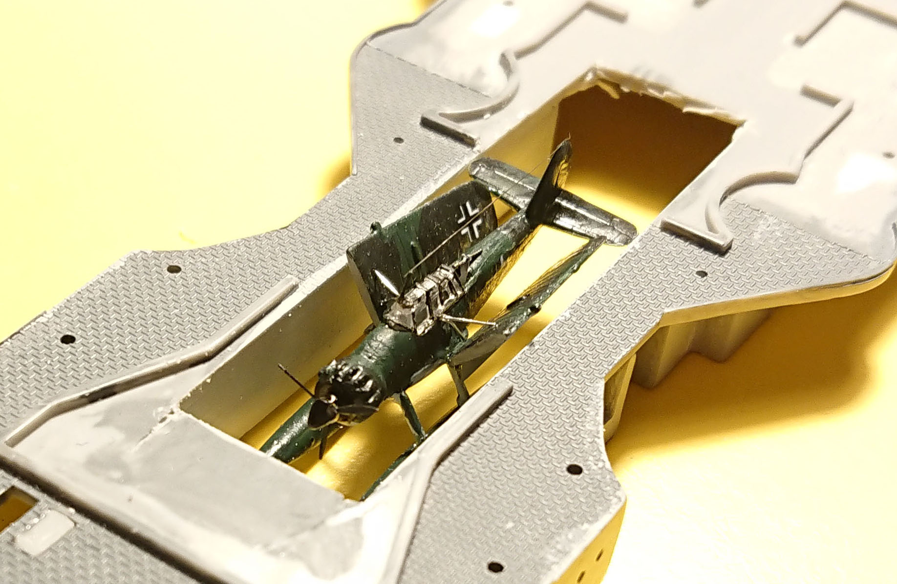

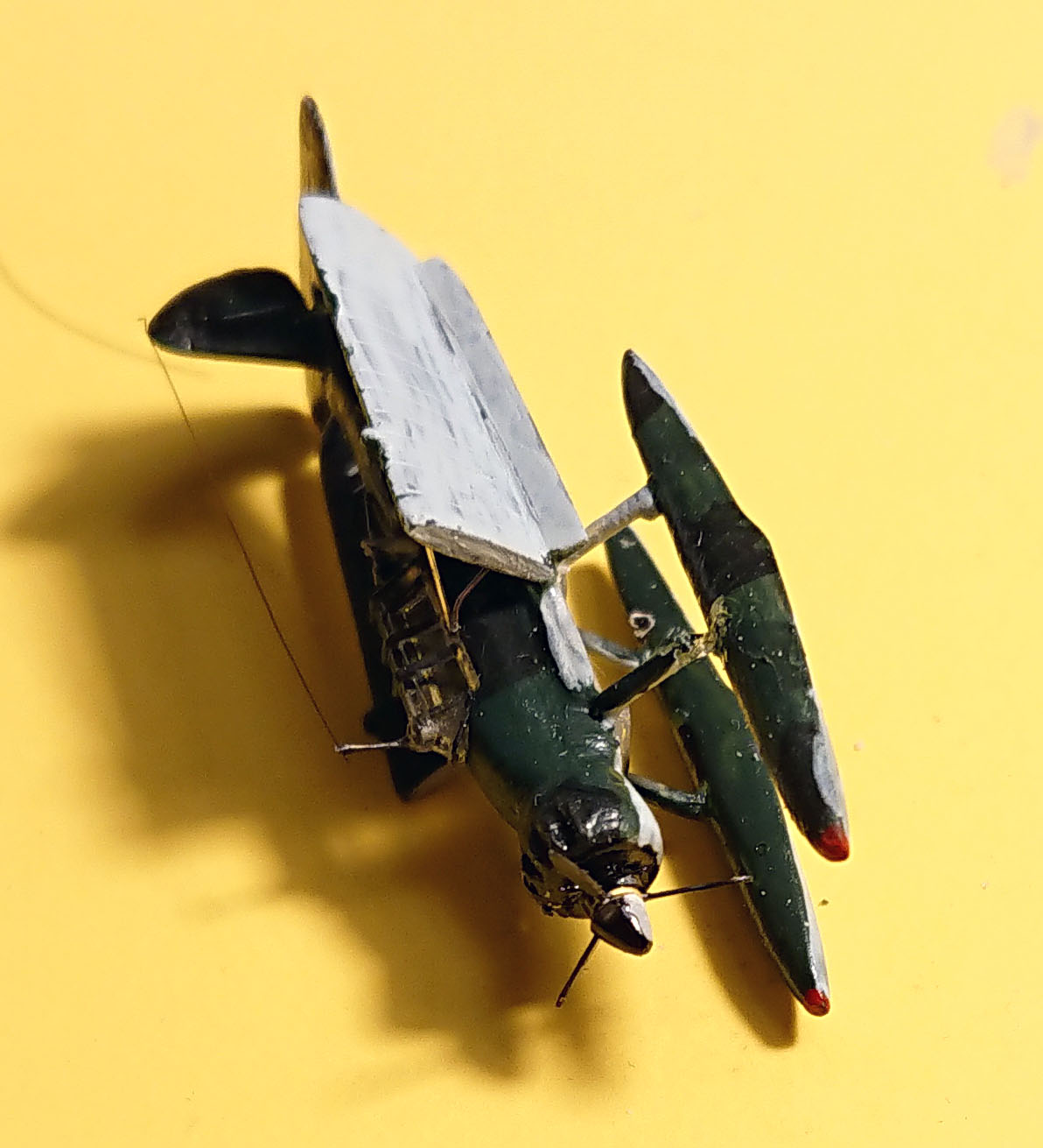

Working on the Arados and found out the hangar is very tight, either its too narrow or the plane is too wide. The tail barely fits, touhcing the ceilings and the wings have to be folded into too much upright postition to fit. Note that the wings don't fold from the back end of the wing and the flaps are down in this position, but even with these modifications a tight fit.
To make the Arado perfect I'm missing a swastika to the tail, any hints where to get?

rvuorenr wrote:Working on the Arados and found out the hangar is very tight, either its too narrow or the plane is too wide. The tail barely fits, touhcing the ceilings and the wings have to be folded into too much upright postition to fit. Note that the wings don't fold from the back end of the wing and the flaps are down in this position, but even with these modifications a tight fit.
The hanger space goes a deck lower. That way the aircraft fits fine.

The challenge is width, not height, picture shows just test fit.David Gatt wrote:rvuorenr wrote:Working on the Arados and found out the hangar is very tight, either its too narrow or the plane is too wide. The tail barely fits, touhcing the ceilings and the wings have to be folded into too much upright postition to fit. Note that the wings don't fold from the back end of the wing and the flaps are down in this position, but even with these modifications a tight fit.

The challenge is width, not height, picture shows just test fit.[/quote]
There is a possibility (large) that the aircraft is over scaled.

David Gatt wrote:The challenge is width, not height, picture shows just test fit.
The Arado 196 wings were removed to fit in the hangar, there�s a very good photo circulating the web, just google Prinz Eugen hangar.�David Gatt� wrote:There is a possibility (large) that the aircraft is over scaled.

Don't you mean folded back to the rear, Roberto?
