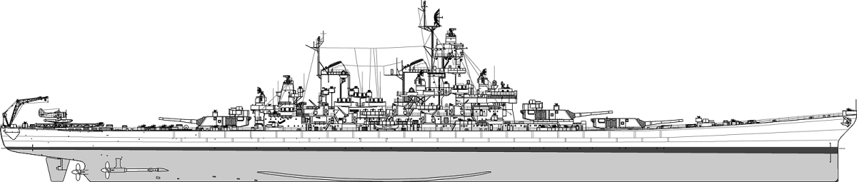

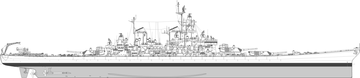

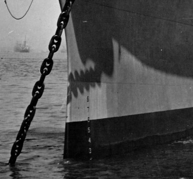

BB63 draft
Hello
I am working in some drawings for a book. I have got some questions about Missouri draft and waterline.
In the 80 the draft markings are more o less this, with superior waterline at 37'
But Iowa in 1943 had the waterline superior line at 36' Seems that Missouri don�t use marks in 1945. But, was the waterline at 36' or 37'?
By the way. What was the real level in the mark? Thanks in advance
- Posts: 5068
Somewhere in this thread, in a time long long ago, this subject was discussed in some detail. As a note, I believe that the boot topping on the Iowa's (Which has moved around a bit, especially at present) tapers toward the stern and is not as wide there. The apparent reason for this is that there are much more "consumables" loaded forward and the bow will tend to rise more than the stern at a light loading. This is probably an intentional design as the hull has little volume aft below the waterline due to the tapering and shaft tunnel between the skegs.

I found these posts
viewtopic.php?f=2&t=167869&p=745384&hilit=iowa boot topping#p745384
viewtopic.php?f=47&t=4683&p=647483&hili ... ng#p647483
According these data and with constant tapering: what do you think?
