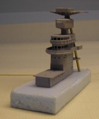

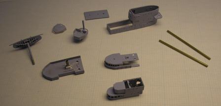

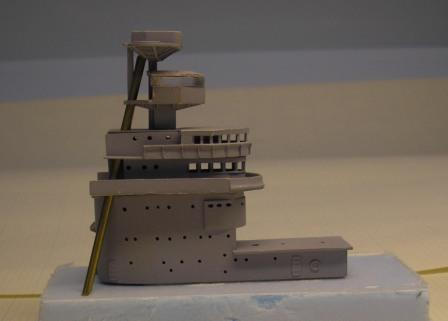

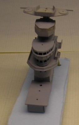

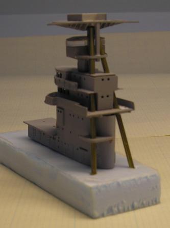

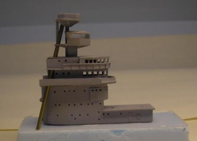

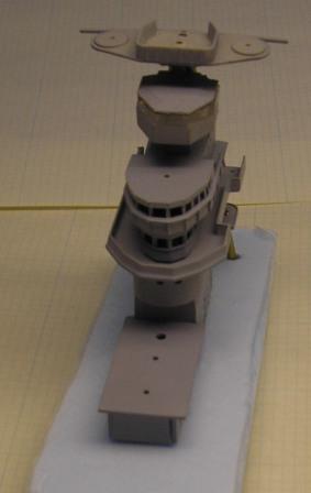

I agree with Martin that the drawings and pictures help, but there are still unanswered questions regarding what actually the final refit looked like as LEX left PH in April. It may just be that there is no additional info out there. I was working on LEX some time back - don't even remember when - and came to the same roadblock as others.
For whatever it's worth, after staring at many photos of LEX and SARA, I concluded the following for LEX: most likely, the shipyard (under the gun to get the job done quick but not necessarily pretty) used the materials at hand in as quick and simple a manner as possible. Read this to mean maximum use of flat plate stock. Look at the splinter shields for the 1.1" quad mounts for an example of what I mean. Likewise, when modifying the Flag Plot area, I was convinced they would take the same approach there - flat STS plate and flat plexiglass windows. I assumed they would use the shape of the existing deck as the forward outline of the new Flag Plot. So I went ahead and constructed what I thought it looked like from the available photos. I made the island in multiple pieces so I could glaze the pilot house windows and Flag Plot windows so some interior fittings could be seen. I chickened out and didn't glue it all together because I had heard rumors of this Wiper book a couple of years ago and I assumed that if I glued and painted it, the new info would prove me wrong.
From what I saw in the new book, I'm pretty comfortable that I got it pretty close to right and so I will proceed under that assumption when I resume work on LEX after my current battles with HORNET . . . .
Here's what I came up with for those who may be interested. There are obviously many details still not applied such as the searchlight tubs, the rails, and so on. This is the basic structure. Any ideas or corrections are welcome since I am still in a position to make changes - assuming there's a good reason to do so - without getting all defensive about it. I want it right.
Picture 004.jpg (11.59 KiB) Viewed 1983 times
Didn't have a macro lens at the time.

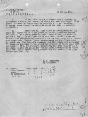

This was the best I was able to do in the records of Pearl Harbor Naval Shipyard. Two documents, from March and April. Note it mentions pre-fabrication of the splinter shields, etc.:

Dick - I like your line of reasoning and agree with most of it - some of it I neither agree nor disagree with since I am still not certain which point of view is best supported.
To clarify what I see in the page 53 photo: just to the left of the next to last (that is, the next forward from the most aft) vertical stiffener there is a ring welded to the outer edge of the platform deck. It looks to be a holder for some kind of pole or tubing with a cap on the bottom of it, that cap also secured to the platform deck. In the picture, both above and below that ring is what looks to me to be a vertical plate with several vertical stiffeners - very similar to the visible side of the splinter shield for the upper pair of 1.1s. Immediately to Port of this 'structure' is a pile of rubble which includes a tire / wheel. This 'structure' appears to be close to parallel, lower in height, and forward of the visible splinter shield, and close to being in line with it. That would agree with the drawing, but not with the comment of the lower group having been moved outboard, unless it was moved just a small amount.
Looking at the flight deck in the vicinity of the #1 8" mount in earlier pictures, there was literally no usable deck space for aircraft forward of the #1 turret and aft of the aircraft crane. I cannot see that when the lower pair of 1.1"s were installed, there was anything to be gained moving the attendant splinter shield / gun mounts more outboard (to Starboard) than even with the Port edge of the deckhouse supporting the upper group of 1.1s. It is clear from the plans and the memos Tracy posted that the initial proposal to put the 1.1"s side by side would impact the flight deck. As long as they were aligned fore - aft as per the 'temporary' installation drawing, I cannot see how moving the lower pair of guns one foot (or fifty feet, for that matter) to Starboard would materially affect the flight deck clearance at all. (I note that fifty feet would, of course, plop the aforementioned mounts onto the pier below.) The barrels of the 8" guns in the #1 turret look as they they came within a foot or less of touching the kingpost on the aircraft crane, so I just doubt the area was used for storage of aircraft. Perhaps the lower 1.1" group was moved a small amount to Starboard. Hopefully it is not measurable in 1/350 scale so we could all be in agreement for all practical purposes!
Jerry, I don't think the roof of the extended Flag Plot structure would have been canvas. The drawings and photos show the 20' rangefinder was mounted on that roof - in other words moved up one level from where it was on the roof of the pilothouse. I assume the purpose of that rangefinder was for anti-surface gunnery, certainly not for AA direction.
Tracy, the 17 April memo you posted seems to say that only two - total - new 1.1" mounts were actually installed aft of the stack, not the three originally called for. The memo further states that both were on the flight deck. This seems to say the third mount on the platform deck where the #3 8" turret was, was never installed. Would that be your interpretation as well?
Again, good discussion. Personally I don't have anything so much at stake that I have to defend it to the death to keep from having to change my model.

John W. wrote:Tracy, the 17 April memo you posted seems to say that only two - total - new 1.1" mounts were actually installed aft of the stack, not the three originally called for. The memo further states that both were on the flight deck. This seems to say the third mount on the platform deck where the #3 8" turret was, was never installed. Would that be your interpretation as well?
I take something different away from it; it says that two were installed on the flight deck, not three. It said "flight deck" instead of "aft of the stack." It looks like there is at least one 1.1" mount on that structure in this photo:
