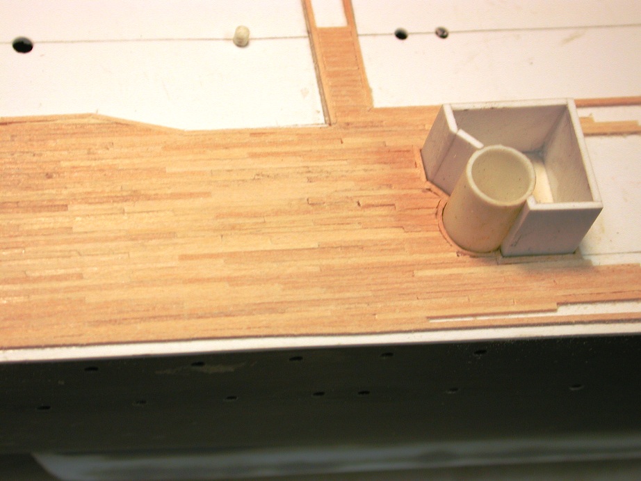

Nothing really exciting to show this time, just some progress on the deck planking. I am slowly working my way from bow to stern, and have completed most of the foredeck to about halfway along the forward superstructure cabin.
The work is repetitive and time consuming, yet at the same time satisfying and refreshing. I find that much of model building is logistical in nature. You need to decide which component to construct next, what materials it will take to do it, exactly how to do it and how the component will fit in to the model as a whole. Painting and finishing often adds another layer of decision making to the whole process. Thinking, planning and musing can take up much of a modeler�s time (at least this modeler�s time). Deck planking is a large job that, once it has begun, requires one only to sit down and do it, with little contemplation required.
After a section of planking has been put down and the cement has dried, I wet the area using a paint brush soaked in water. This tends to swell the wood somewhat and close up the any gaps in the seams. After the deck has dried I then give it a light sanding just to even up some of the rougher spots and remove any cement that might be on the wood. If you compare the last photo in my previous post with the first one, which is of the same area, you can see the results of this process.
The photo above shows some of the fitment involved around the oddly shaped compartment underneath the port forward twin 4� gun mount.
The last photo illustrates well the staggered nature of the planking run.

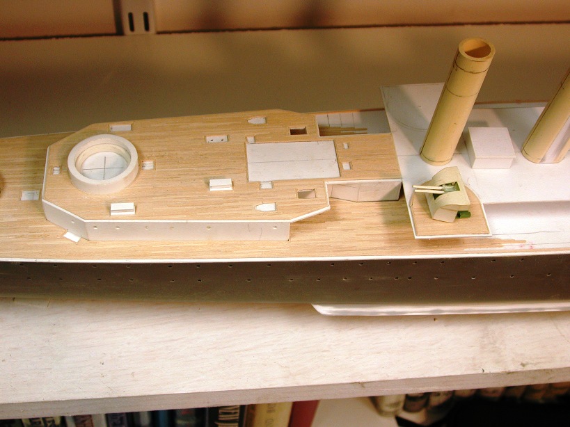

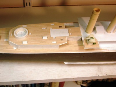

Just some photos on the progress this week, which was mostly continuing work on the deck planking.
The forward part of B turret deck was planked to a point just aft of the bridge superstructure and this has been completed. Two of the skylight hatches have also been constructed.
The deck around the twin 4� gun mounts was also planked and one of those areas was completed. The gun mount shown was temporarily borrowed from a model of HMS Abdiel I built several years ago.

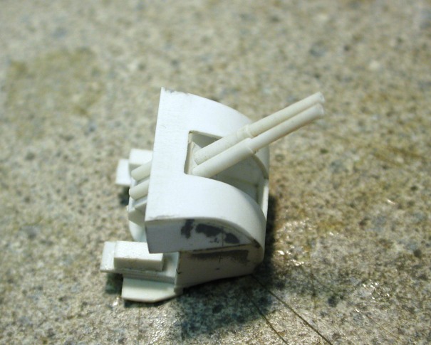

I�ve started construction of the twin 4 inch secondary gun mounts, again made of various shapes and thicknesses of plastic. Still some details to be added to the basic structure.
The shield is made of .015 styrene sheet and was quite time consuming to construct. The shape of the shield is somewhat more complex than it loooks and took several attempts to get right.
Still have to build three more.
