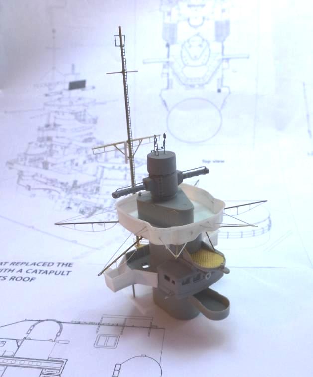

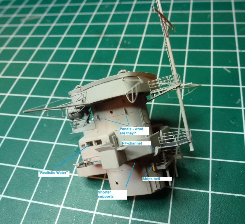

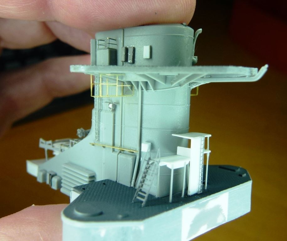

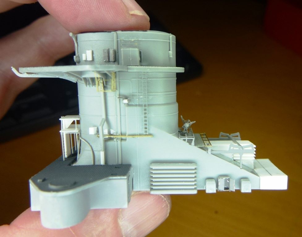

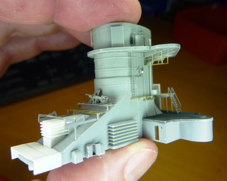

The bridge area/command tower is now in a near finished state. I decided to include gratings at the upper platform. I don�t have any evidence to prove that gratings were up there, except perhaps the photo of the damaged platform after the hit from HMS Renown on Apr 9th 1940- l have got a large picture of this, and it sure looks like some kind of gratings covering part of the hole (could of cause also be part of an emergency repair..).
Since this is 1:350, the planks cannot be to scale. I had some 1mm planks for a 1:100 Zerst�rer lying around, so I split two of them and cut to fit the length. Anyhow a great exercise!
The armored command post (upper) is not yet glued (or finished).
Instruments are Veteran Models

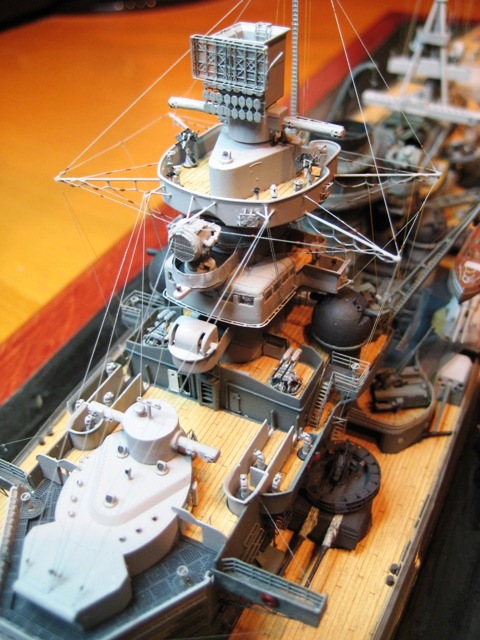

Last picture is my SCH. just for comparison. (With a planked upper platform ...).
Note that the stretch sprue footperts in GN are more close to the real thing than the PE-ones in SCH.
QUESTIONS:
1) Do any of you know whether GN had protecting nets in April 1940, like SCH had, to protect the crews of the 150mm singles from empty cases from the 105 AA?
2) Do any of you know the purpose of the square panels attached to the Command Tower (they can also be found in German Destroyers at the rear funnel?) See picture.

I don't know about April 1940, ,but there is footage of Gneisenau in manoevers with Scharnhorst in summer 1939 and Gneisenau has these nets. She is in "Scheme 2" in Asmussen's book. Interestingly, she has steel deck around the 105 guns.

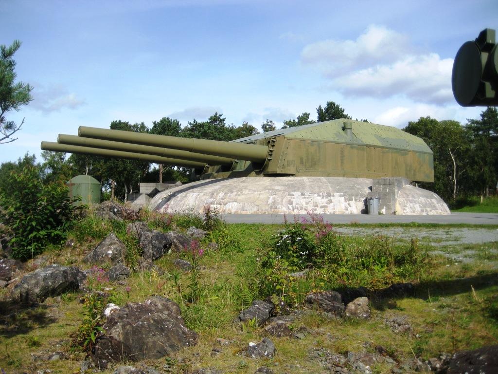

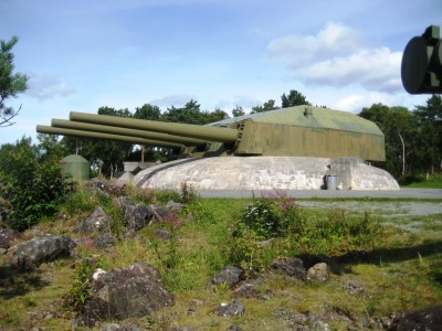

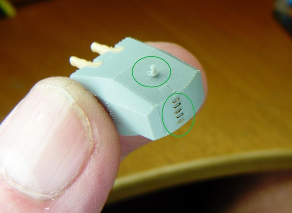

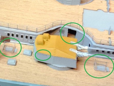

Guns:
Main battery: A and C-turrets have small handrails in front of the gun roofs. These are not to be found in SCH.
Also, the bins on each side of A and C (for cleaning rods etc) are not to be found in GN.
Note the small device at turret C front: So far no one has been able to find out what this is the use for this. Loudspeaker?

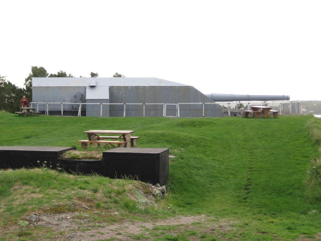

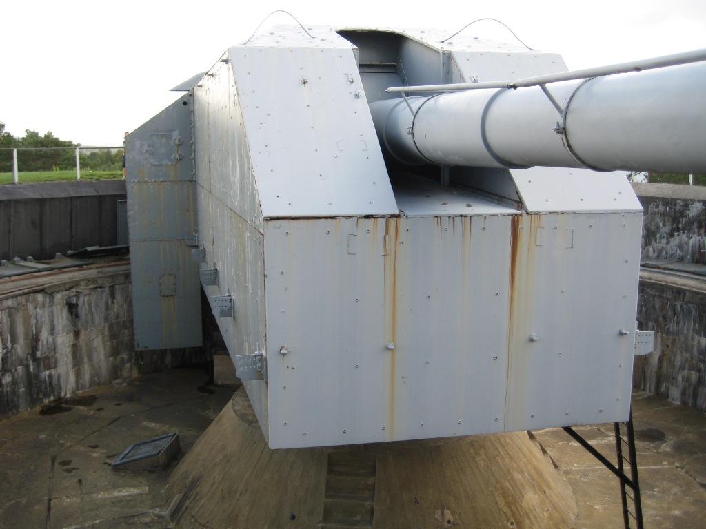

And if you care to see: My own photos from two years ago.Turret C, still in place at Austr�tt/�rlandet at the entrance to the Trondheims Fjord. The complete turret is there + additonal armour plates and a door at the rear of the turret! Blue shells are not Practice but Armour Piecering.

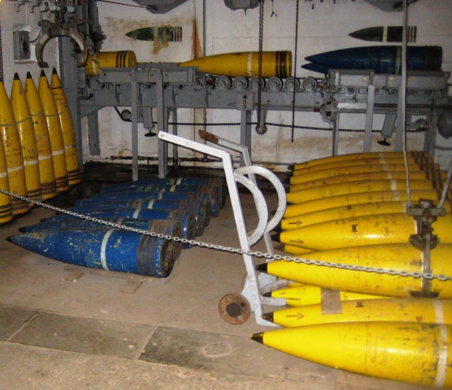

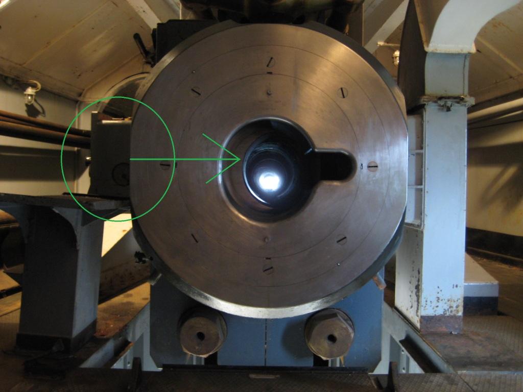

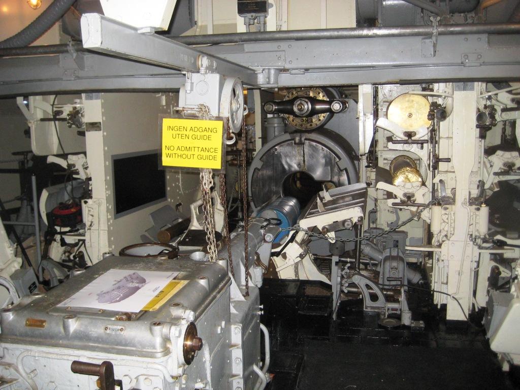

Shane!

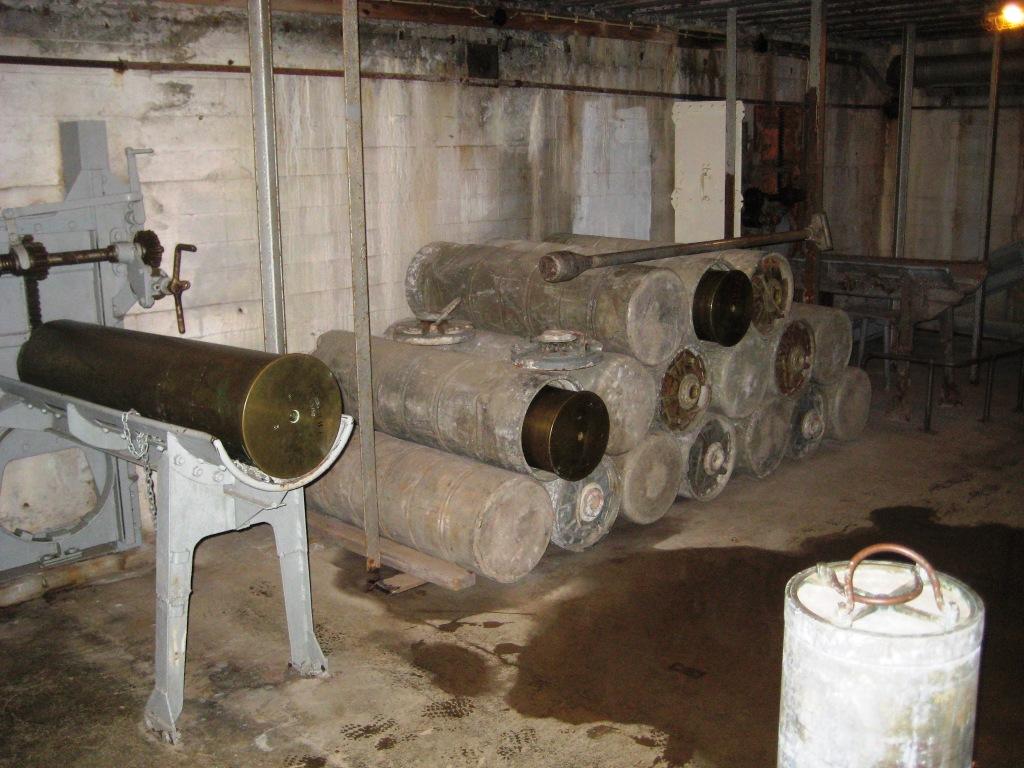

Interesting question. Being an ex artillery officer (Army) I shall try to explain:
Germany generally uses sliding mechanisms in their big guns while British and Americans generally use a screw / threaded plug design.
There are advantages and disadvantages in both designs.
The sliding block will normally require a brass cartridge to seal the chamber tight. This is not needed for the screw.
A cartridge makes it more easy to protect the powder, from moisture, blast etc. But a brass cartridge in a big gun often contains only a part of the propelling charge: First you load one or two bags of powder into the chamber, then the cartridge.
In the Gneisenau 283 mm gun system SK C/34, the propelling charge consists of the brass case (74,8 kg powder) plus a bagged fore charge (42,4kg powder).
This would propel the 300kg AP projectile to 890 mps, giving a range of close to 41000m (Bismarck 800 kg AP to �only� 35 550 meters).
Data: Skwiot: "German Naval Guns 1939-1945".
From Wikipedia:
The Breech mechanism closes and seals the gun barrel's powder chamber after the projectile and powder charge are loaded.
The breechblock, the principal part of the breech mechanism, is either a sliding-block or a threaded plug design. The breechblock must open and close quickly while making a high-pressure gas-tight seal. A typical gas pressure approaching 50,000 psi is found in the chamber and gun barrel shortly after the powder charge is ignited.
Weapons smaller than 155mm are usually of one of several sliding-block designs. Larger weapons are usually of one of several interrupted-screw designs. For rapid-fire guns, a sliding breech-block is commonly used which may open and close automatically as the gun is fired. Recent large weapons have incorporated automatic or semi-automatic breechblocks, more than doubling the weapon's rate-of-fire. Using Time On Target methods such as "Multiple Round Simultaneous Impact (MRSI)",[1][2][3] one modern 155mm gun[4] can fire eight projectiles, with all eight landing on the same target within four seconds, a task that normally requires firing eight individual guns at the correct calculated times.
From Wikipedia:

Re: 1:350 Gneisenau, Op Weser�bung Apr 9th 1940
You are right G! Of course there is no horn there- at least not in April 1940! And it is no longer in my model either!!

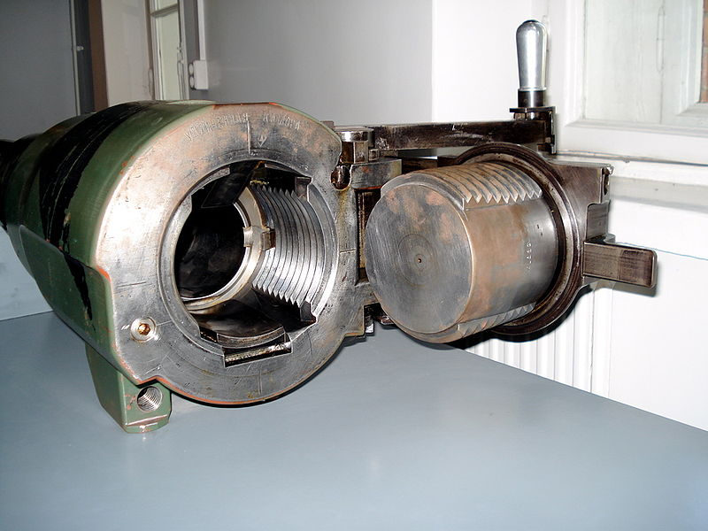

Hallis: No, the HK 91 with it's two rollers is a very different construction. I know it very well from my army time. We call it AG3, simillar to the G3 in 7,62X51 NATO (G3 is no longer in service in NO Army).
The picture (my own) will explain the construction of the type of breach-block we are talkingabout here. The gun is one of the reserve guns from Bismarck/Tirpitz, and is installed in M�vig/Kristiansand, Norway. You will find 3 of them there, one as a superb museum!
(We even have bigger guns in Norway: A battery of 406mm guns for the planned , but never realized H-class battleships. Installed in Harstad/Norway in housing simillar to the ones in mt picture. Also a museum - of cause!
Stein

That's very similar to the breech in an American M1 Abrams tank. And a lot of field artillery pieces.

eeh Yes... Because the smooth-bore 120mm Abrams gun is a German gun in the first place...
The threaded screw that I am referring to can be seen a lot of places on the net. This mechanism is used in anything from Field Artillery to 16 inch US battleships.

Secondary battery:
Turrets no 1 both sides have no AA on top. You therefore need to build a periscope on top of the turrets similar to the rear turrets both sides.
Nice additions are handgrips for entering the turrets (this was done through the hatch on top of the turret). From a LionRoar Bismarck PE-kit.
Two containers (gear and life-vests?) on top of each of the four turrets. GN only.
Ventilation openings rear side of the turrets was marked by pen after painting.
In this picture also:
Note the two hatches (with framework) to lower deck. These are not shown in Kagero�s book, but if you look at the picture (b/w in early camouflage) of GN in Norway 1940, you clearly see one of the hatches just in front of the rear 150 mm turret � just like the ones in SCH.
Passageway to the opposite side of the main deck.
Turret color was �Gelb� = Yellow for first part of Weser�bung (see picture of original document specifying this.
The document also specifies that Swastika Flags (Hakenkreuzflaggen) are to be painted bow and stern (IFF signs for friendly aircraft). No measures are given.
Of this reason the size and form of these markings are different from ship to ship.

Then to the funnel:
This is in some respect quite different from the one in Scharnhorst. The most visible changes are as follows:
In front of the funnel is a ventilation tower that must be scratched. This has some minor implication for the boat cradle, so you need to adjust.
Lockers and installations around the funnel are different, and there are no exercise guns either side. Behind the funnel there are platforms with ladders etc that you need to scratch.
And further aft you will find all in all 9 ventilation tower that all needs scratching�
Also, the mainmast in Gneisenau is positioned at the funnel�s platform.
I built this mast from brass tubing and PE as I did with the foremast.
You also need to modify the searchlight platform slightly (at the aft side). Also, lockers etc are different.
Underneath the platform, observe that the channel for HE-antennas is shaped and positioned somewhat different than in SCH.

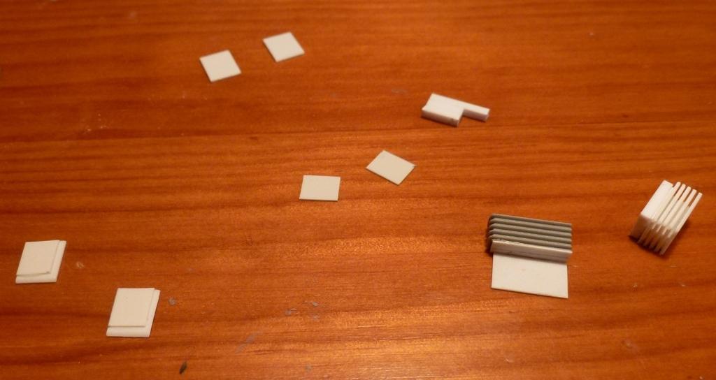

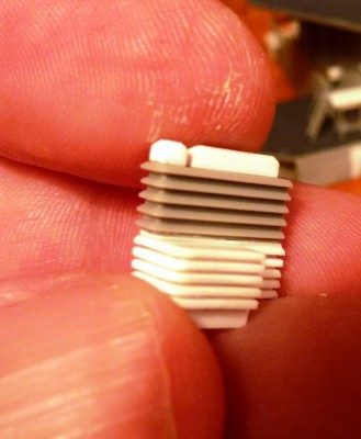

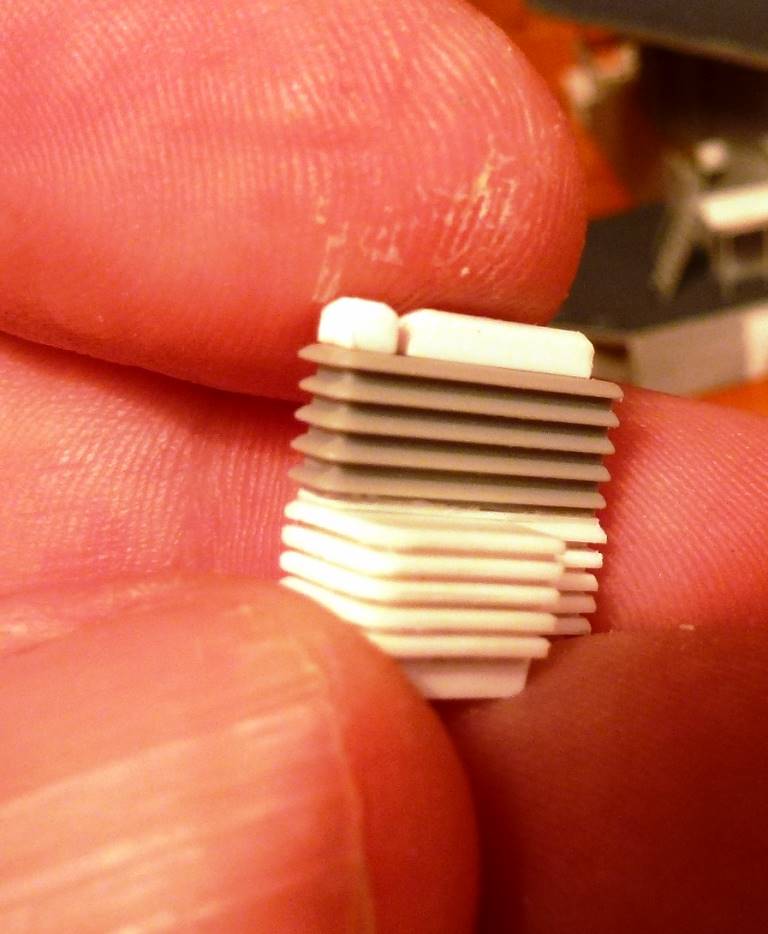

The ventilation towers are built up from 0.15 and 0.3mm Plasticard. Sides rounded off before gluing. Corners rounded off after gluing.
Ventilator caps/hats are made from Plasticard square rods cut and filed down to right shape.
