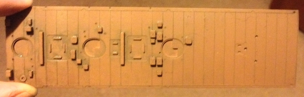

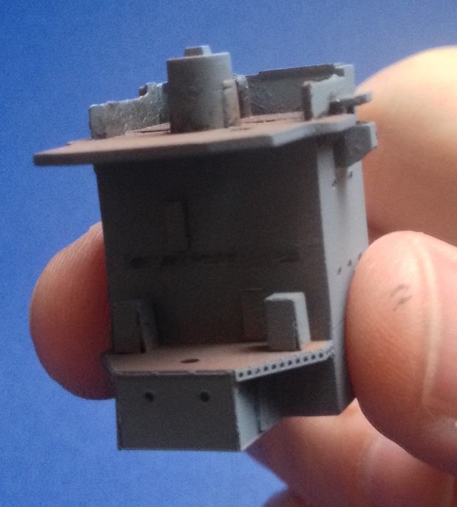

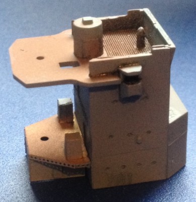

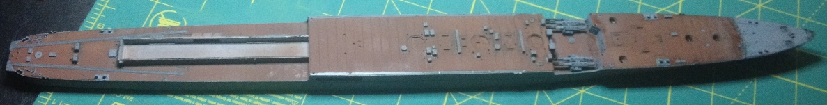

And here is the results of the linoleum color being painted over the was. Some pictures show up better than others. It is really easy to notice the molded on lines that would be the brass tie down rods now, even in these pictures. I really like the effect. Now I just need to improve the technique going forward.
back of the con tower middle level
back of the con tower bottom and top levels.

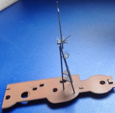

aft deck with main mast
midship deck
midship deck
forward area main deck
aft area main deck
aft area main deck
Thank you for looking. Comments are always welcome.

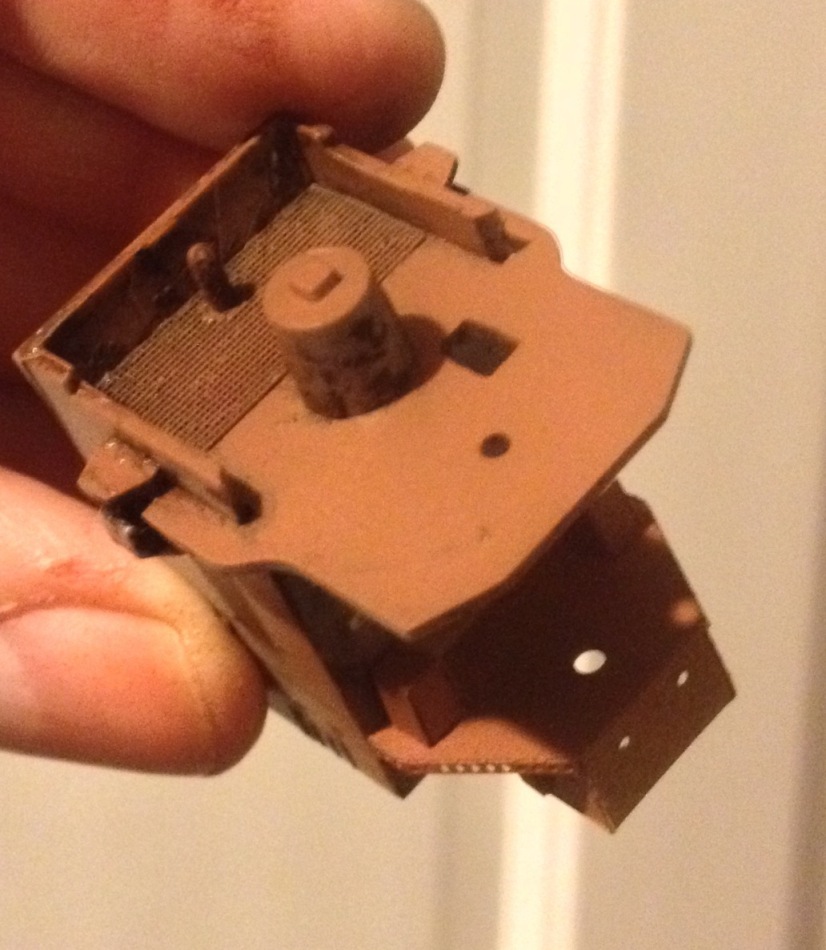

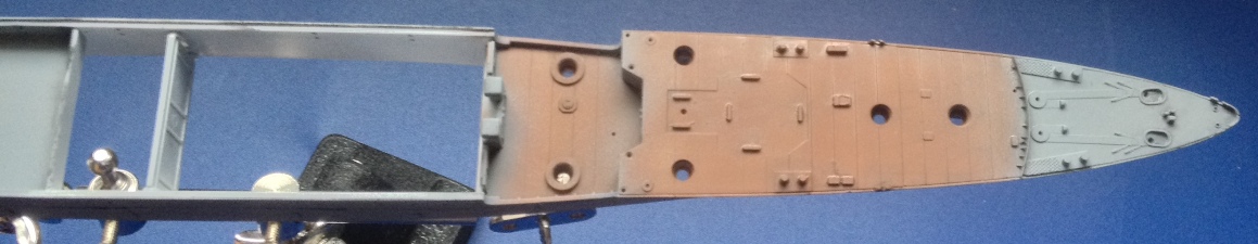

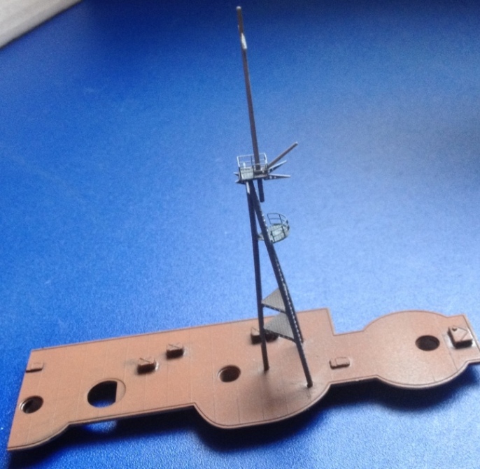

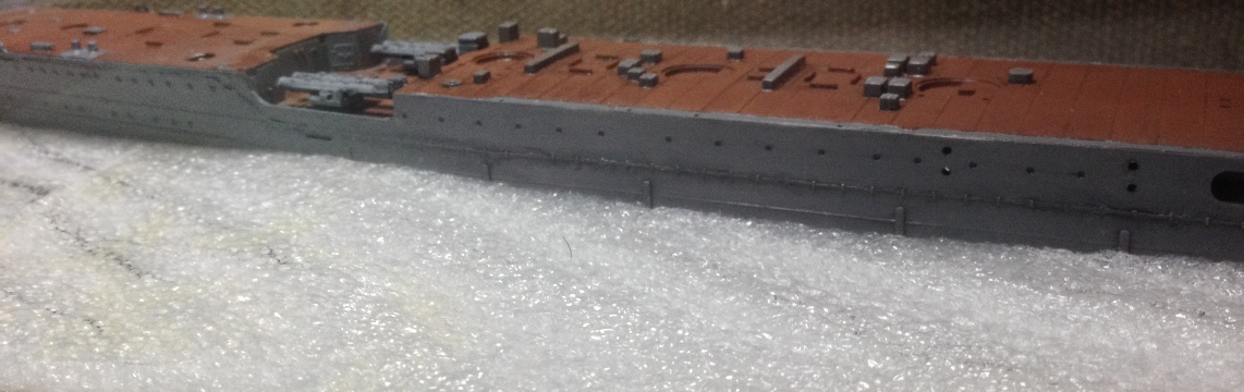

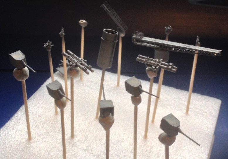

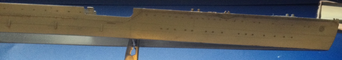

I have finished airbrushing the grey. Anything else that needs to be painted from here on in will be done by hand. I have to admit that this technique was rather intimidating as I was attempting to freehand the airbrushing. Where I do have areas to clean up, I am quite pleased with how close I was able to get things.
bits and bobs
bits and bobs
more bits and bobs
more bits and bobs
aft deck and main mast
bridge
bridge
back of the bridge
back of the bridge

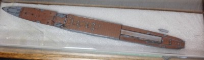

hull aft
hull aft
Hull forward
Hull forward

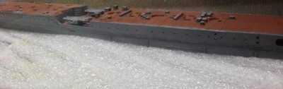

fan tail
fan tail
bow
bow
Gabriel
Angeliccypher
Posts: 1381
70 hours
Post by Angeliccypher »

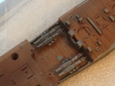

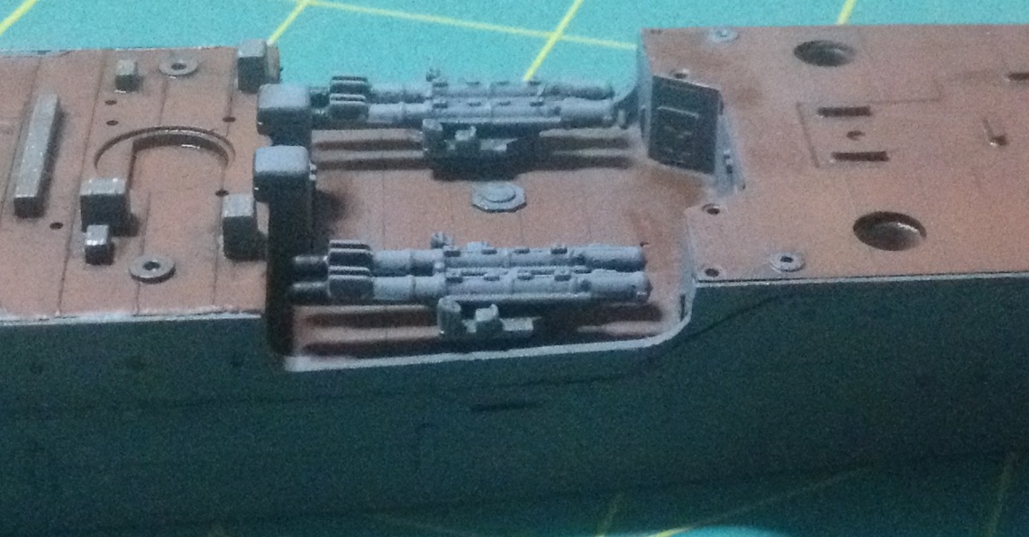

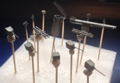

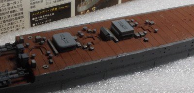

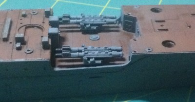

Another update. the grey is painted onto the modeled on items on the deck. Everything you see in the pictures is attached.
Gabriel
Posts: 8543
Re: IJN Nagara
Coming along nicely!
Posts: 9052
Re: IJN Nagara
Post by Dan K »
Agreed. Nice looking work on the TT mounts and bay.

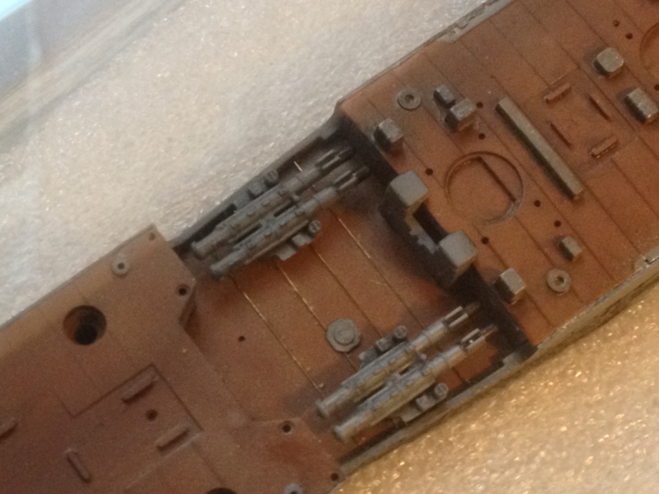

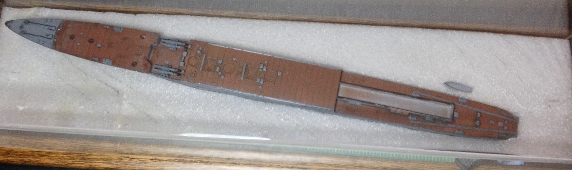

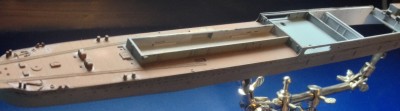

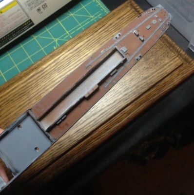

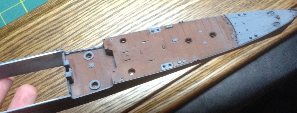

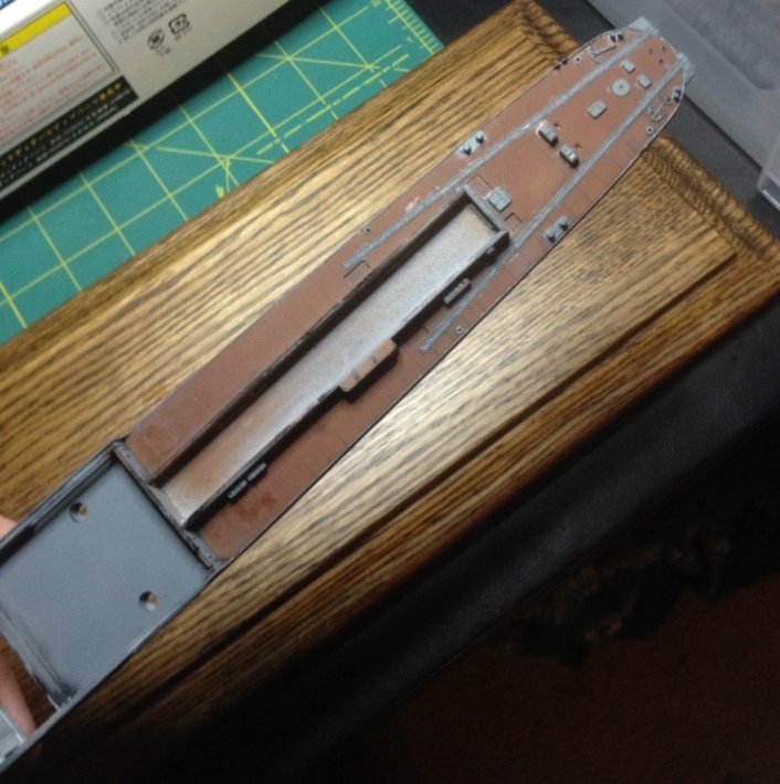

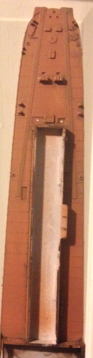

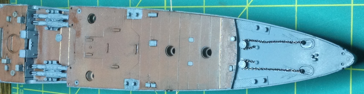

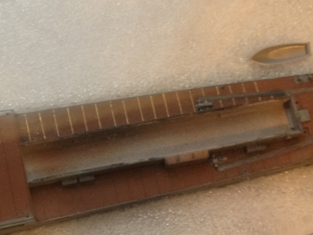

There has been some. I will edit this post later and add some pics I have. Mainly going through the absolutely tedious task of adding the brass rods to the linoleum areas of the deck. I have also started work on the water for the base. Then decided to put all this aside and go back to my San Francisco for a bit. Even though I have done a fair amount of clean up on the hull on that, there really appears to be little to show for it at the moment.:)
As promised here are the pictures of my latest on her. Any glare or funky color/reflections are because I took the photos while inside the case from Grandpa's Cabinets (shameless plug for an awesome product).
anchor chains complete and starting the brass rod on the deck.
starting the water shaping
You can see the officer gig position in the water.
All the bow section of rods are complete up to the bridge.  Any areas that have a structure not currently attached, I will add the bars after they are on.
Forward torpedo deck brass is done.
Aft starboard side is coming along.
As always, comments and suggestions are welcome. Thank you for looking.
Gabriel
Angeliccypher
Posts: 1381
Re: IJN Nagara
It is funny how work stalls when you are not happy with how it is turning out.
I am ripping off all of the brass rod and going to use the Flyhawk deck tie down set. This is happening for two reasons: First, I hate the fact that it looks really out of scale. Second the rod sometimes rolls and I end up with glue from Hell to Breakfast and it looks horrible despite my best efforts to remove it. Thanks to all who offered suggestions in the main forum to said dilemma. While I wait for the Flyhawk set I will likely start working on other sections like the funnels to get them ready to attach.

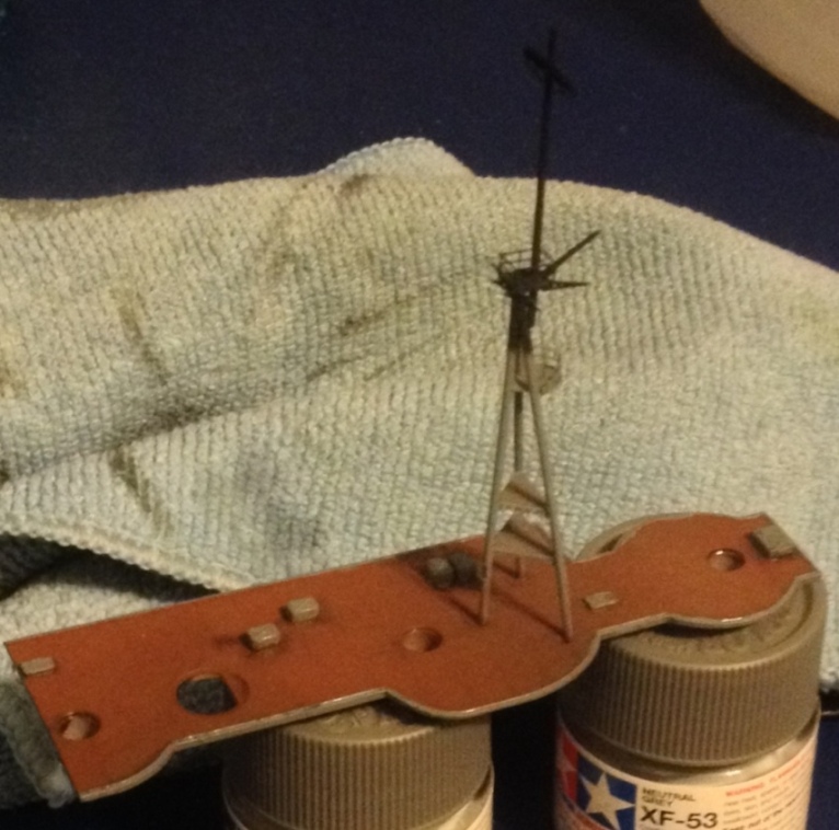

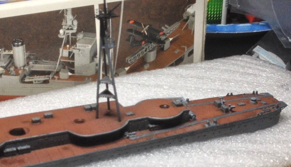

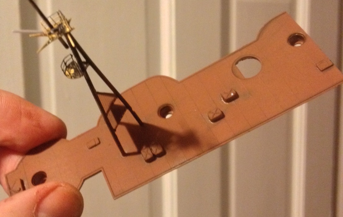

After ripping up all the tie down rods and spending time to clean up the mess I managed to get some new construction done.
Free handed the black on the mast.
Gabriel

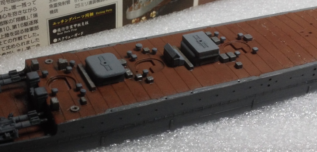

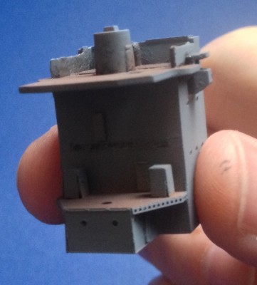

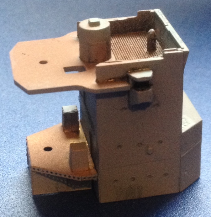

After painting all of my PE and working on the small fiddly bits that belong on the decks I was able to attach said bits as well as the structures between the funnels.
