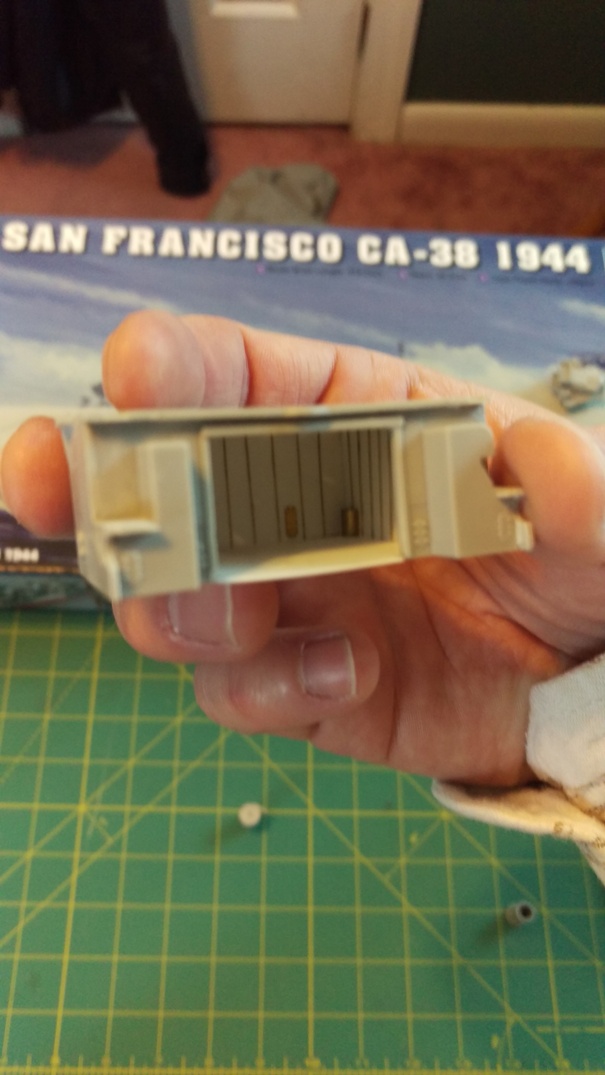

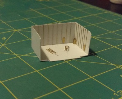

So after the debacle with the previous pictures, I think I have that sorted out now. I sat down and started to build the hangar. This is some basic structure detailing. There will be a few other things added into the hangar later like a work bench and spare parts to hang on the bulkheads. This will be likely primed and painted tomorrow while I am working on the seams on the outer structure around it. Then it will all be attached to the kit.
Thanks for looking.

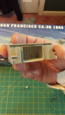

Test fit picture for Matt:

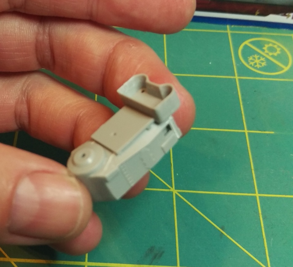

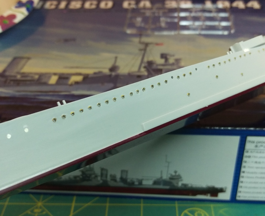

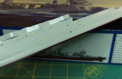

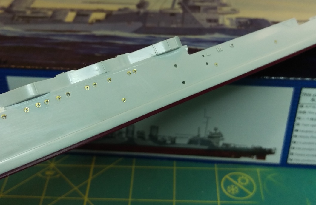

So looking at some of this it really does not look like much has been accomplished. Most of it has been cleaning up seams end ejector pin marks. There has also been some modification (or removal of grossly overdone "detail") as well. Descriptions of the work will be with each picture. Hypno7 told me he wanted to see some of what I had actually been doing so here they are.
All portholes have been added on both sides of the ship.  I am lazy so you are only getting to see one side.:)
aft section of more portholes
The structure that sits on top of the boat deck.  The was largely a ton of seam work and ejector pins.  I will fix the "detailing" on this later

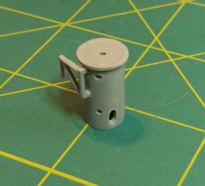

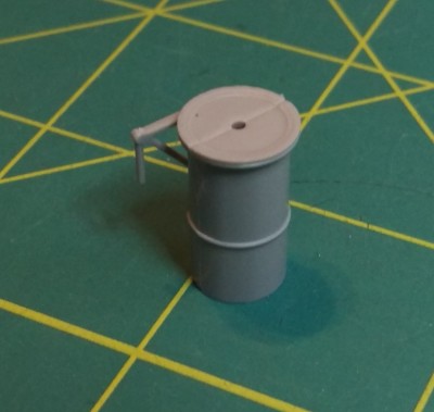

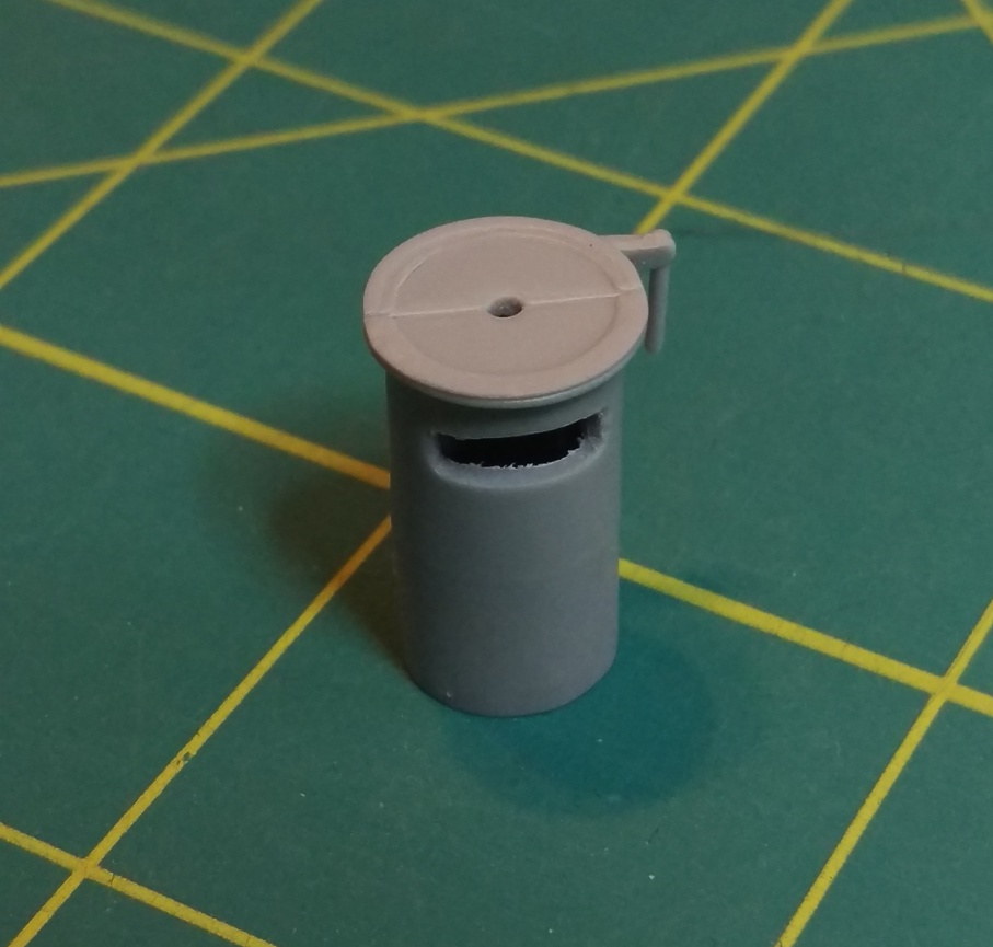

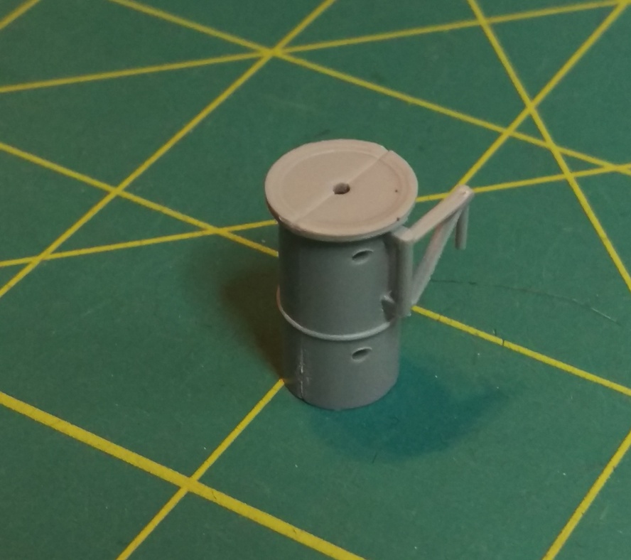

The catapult tower with no seams filled as it is to be assembled out of the box.
The other side of the same assembly.  Mind you I have not done anything besides put this one together.....yet.
The second of the towners.  I have cleaned up the seams removed the horrible excuse for a rail and added th hatch opening.
The reverse side.  Trumpeter also forgot the window that looks into the well deck.  The seams on top will not matter as they will be covered.

Very nice Gabriel! How are you gluing the portholes?

Thanks guys. The poet holes started off as a practical issue. I am glad I needed to use the PE. I think it looks a lot better. Is use white glue specifically Gator Grip from my PE. I swear by the stuff.
