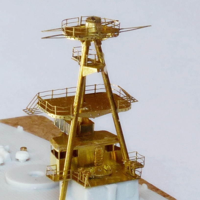

so I decided that the outmost parts will be done from a styrene square rod instead of PE (not in the photo, will be added later). Next came the aft bridge. While dry-fitting PE parts onto the resin hull I realized the bottom part (molded on the resin hull) was approx. 1.6 mm too tall. This was apparently noticeable when viewed from the side � the bridge overhang aft should be just above the aft main gun turret according to photos but there was a large gap there. So I had to cut the upmost layer of the resin part. I continued by gluing the aft mast pole into its place and constructing the aft bridge. While designing the second version of my PE parts I noticed one interesting detail � contrary to pre-war photos Chicago had a new position for flag bags aft extending out of the crane platform as on the photo below. So my part is now hopefully another step closer to the original. Flag bags themselves are not shown on the photo yet, will be added after rigging is finished. Also supports under the extended "wings" will be added.

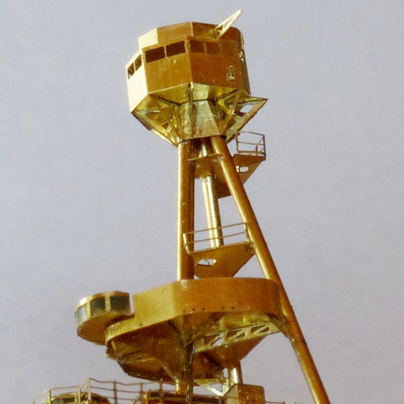

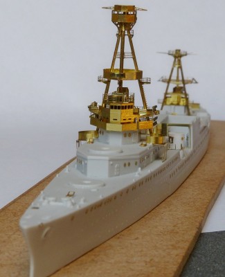

Nothing much done in the meantime, only those small searchlight platforms and their related ladders added to the forward tripod mast.

WOW! She is looking sweet

I�m loving this! She looks awesome and I can�t wait to see more.

Nice photo angle on the work. Looking very nice.

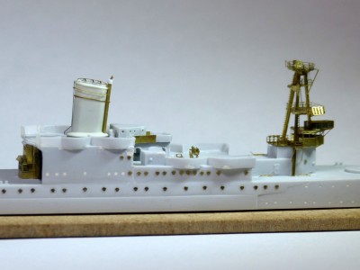

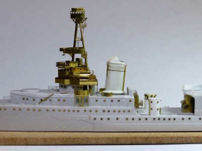

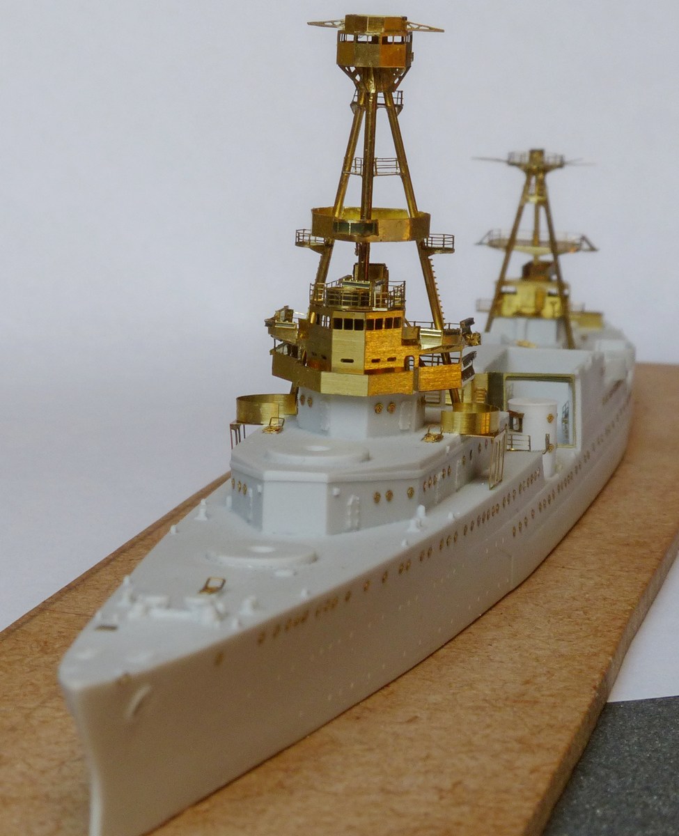

It took me much more than anticipated to get back to my build, but luckily I am back at my Chicago now. Apart from many smaller details, I amended the upper 5in gun platform and worked on funnels. Started adding railings along the deck yesterday. I hope to post more updates soon.
(I don�t know why the preview photos seem to be so much out of focus - the actual photos are much better if you click them)

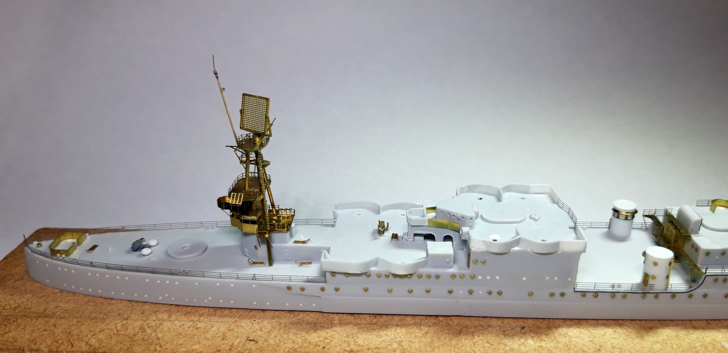

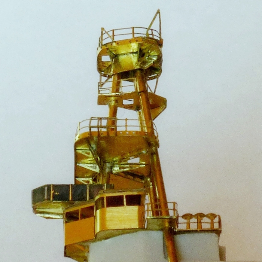

Details on both masts and railings completed today

Really nice, crisp work, Valdi.
- Posts: 8543
Re: 1/700 USS Chicago CA-29 at Battle of Savo Island
I'll second that!Dan K wrote:Really nice, crisp work, Valdi.

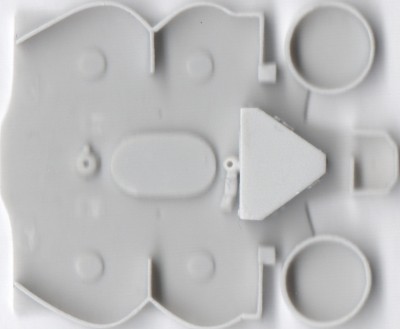

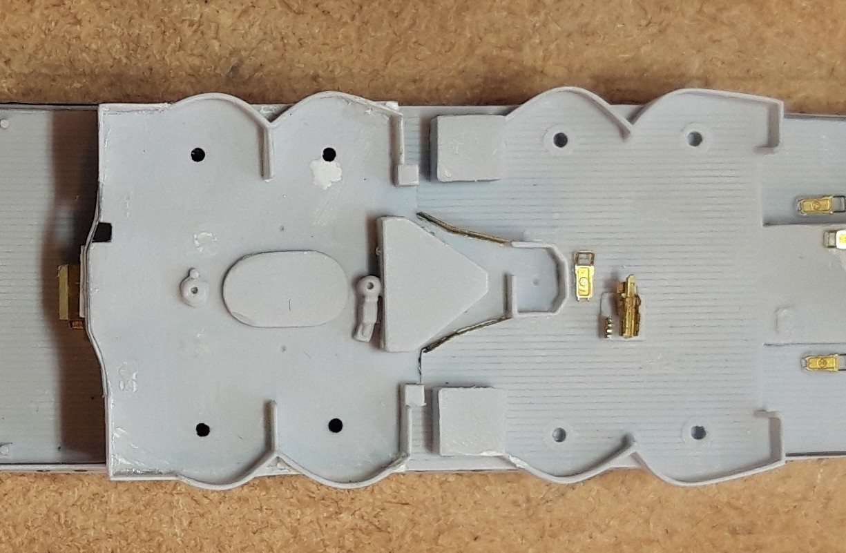

For the matter of documentation of earlier steps: I realized the original kit part for the upper 5in deck was not really correct. Photos show the arrangement of splinter shields at this level was clearly different than in the kit both on Chicago and Houston, see photos before and after amendment below. They came out not exactly as intended (it would have been better to remove the shields entirely and replace them with brass stripes) but they are still better than before.
Also the tubs for 1.1 in quad guns were actually not located at the exactly same level as the upper 5in deck, so I had to separate them from the 5in gun deck and decrease the height of their underlying superstructure parts. It is not eaxctly clear to me yet how exactly the situation looked like at the back of these tubs, but apparently their back was open and there was a ladder that connected them to the lower 5in platform below and the other one above. There were slight differences between individual Northampton class members and I have not find any clear picture showing the situation on Chicago, so an educated guess will have to be used here.

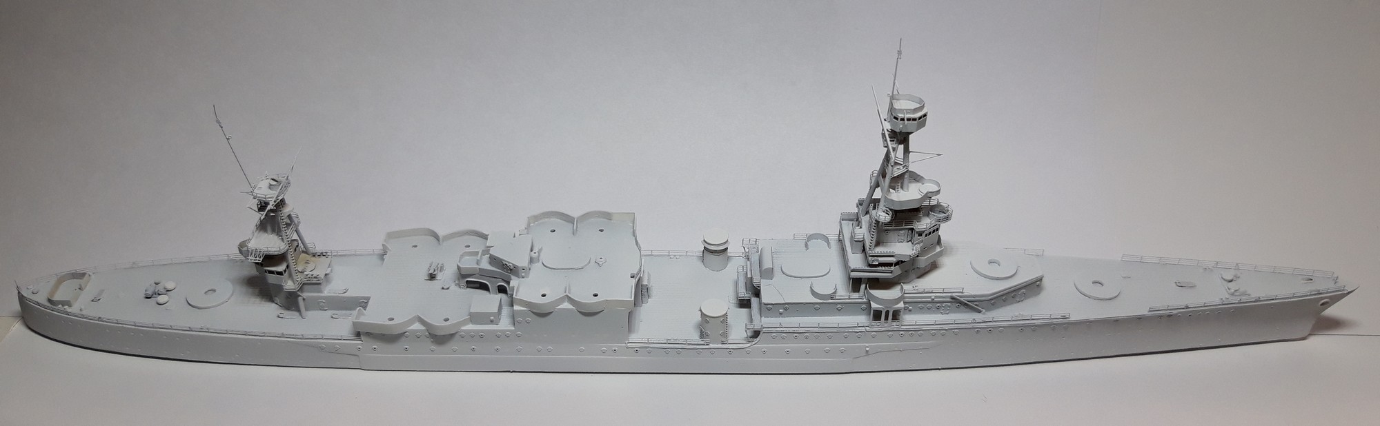

Just a quick notice that I�m not stuck again - today I transformed my Chicago into something like a "White Ghost"
I�am happy that the deleted portholes remained faintly visible as I intented to have them appear as that they were plated over. Also the PE portholes look quite reasonably to me. Now I am waiting for the main gun mounts, watch this space

Vladi, this build is amazing! A great inspiration for my planned 1941 builds of Chicago and her sisters.
