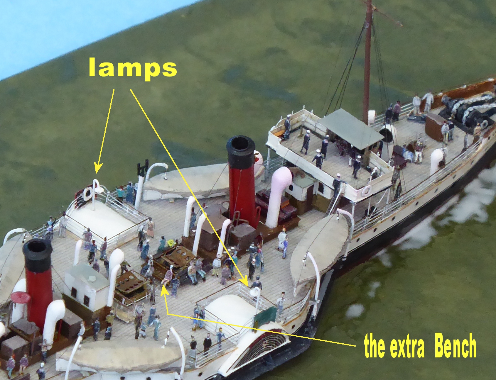

Not entirely convinced on that 2nd gangway.
Although it wouldn't be uncommon to have it ( most of the time there is a short and a long gangway onboard),
-in this case the shadows of the forward one might be cast by benches as well.
There appears to be a shorter? bench just forward of that gangway that seems to cast a similar, but shorter shadow.
My 2 cents...

@ Neptune....

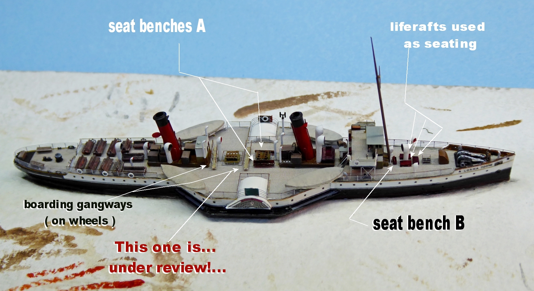

Hmnnn.... I shall re-examine that...-
- I had thought that as they had
( sometimes ) a huge load of passengers to load and unload ( at every stop )
( Lorna doone was licensed for nearly 900 passengers..(!)
that the 2 x gangways might be deployed as one for boarding and one for disembarking
anyhows... the tightness of the Horizontal lines in the shadow MIGHT INDEED be a bench.... Hmnnn!

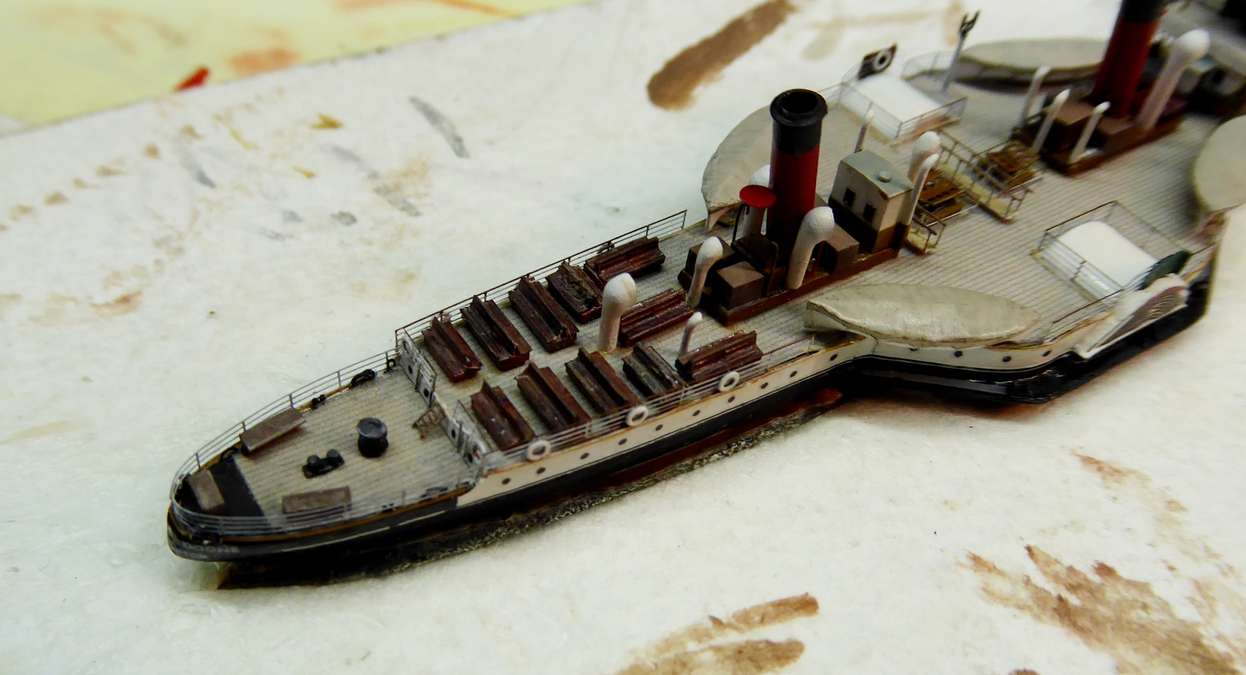

a bit of progress.... mostly annotated images
that have been stared at and re-re-re-re stared at... to try and glean how
the benches were placed.

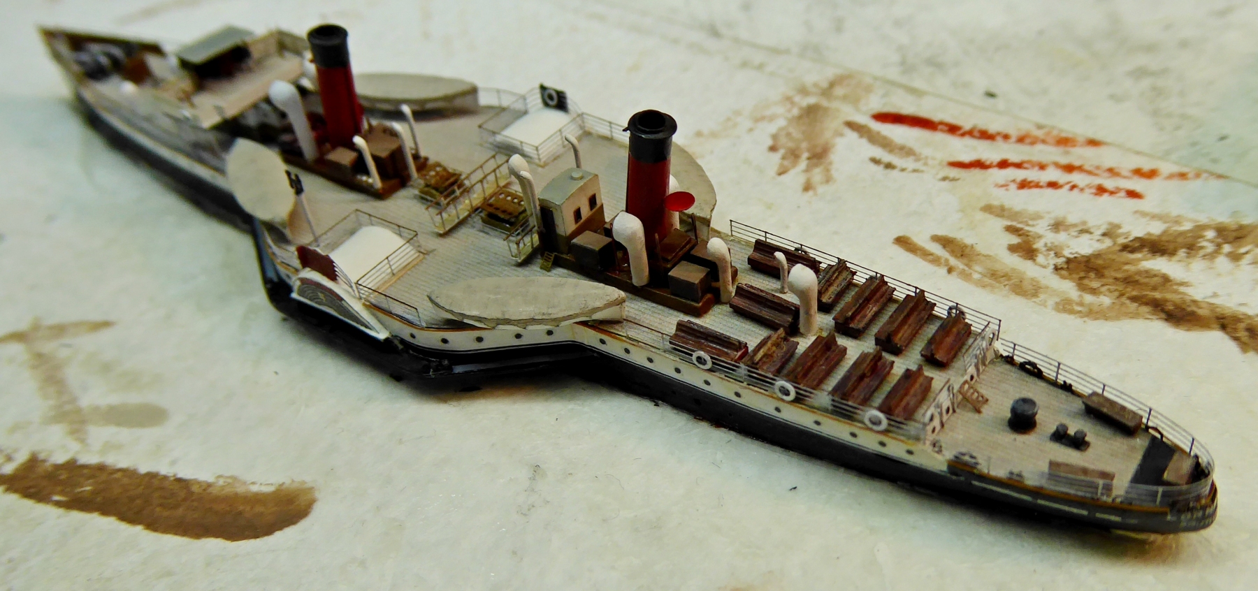

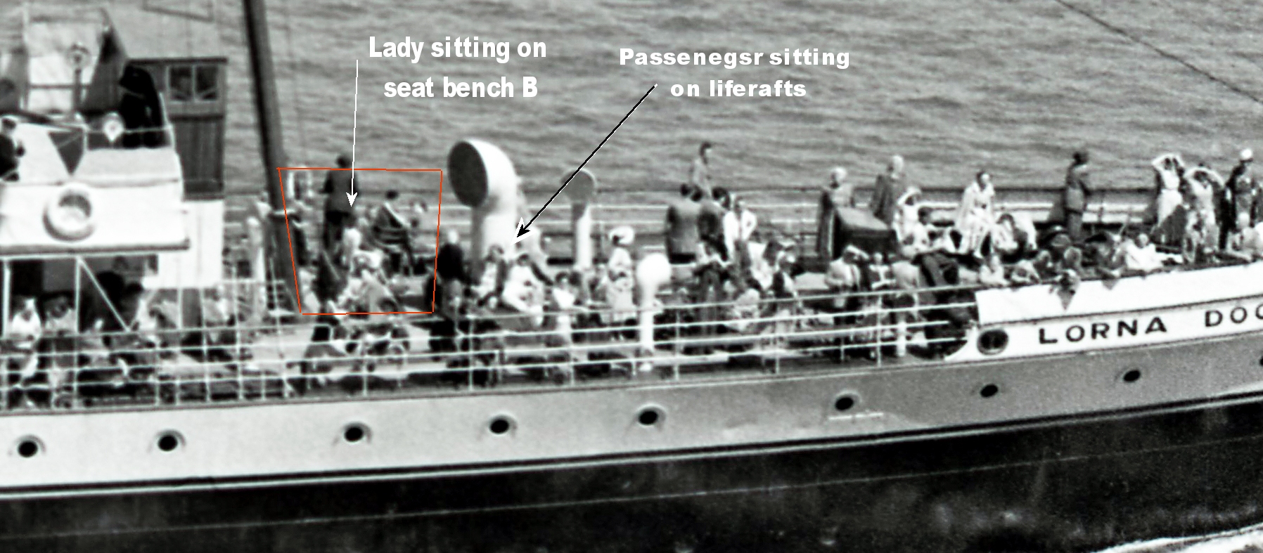

in view of above;
so far the longitudinal benches are in place ( but not yet ' toned down' )
Seat Bench B took some finding...( as seen above ahead of the mast )
along with the life rafts stacks around the large cowl vent
identified by passengers sitting not on benches or deck-chairs...
The aft seats have had some thin paint and placed onboard the vessel
The mast was made... ( 0.5 mm tubing )

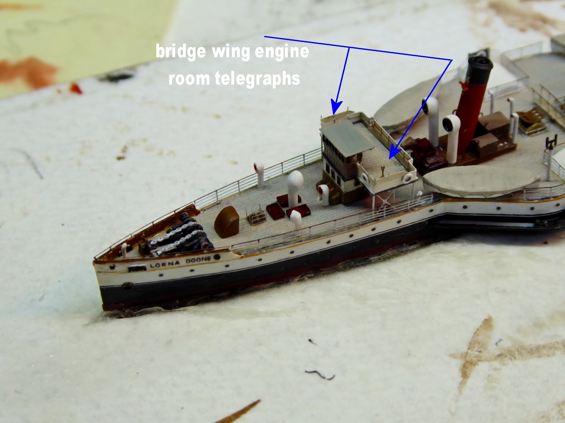

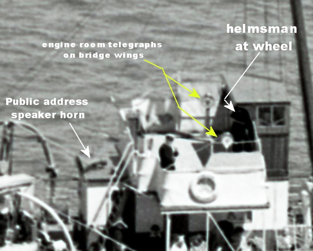

On the bridge wings they had polished engine room telegraphs
and...

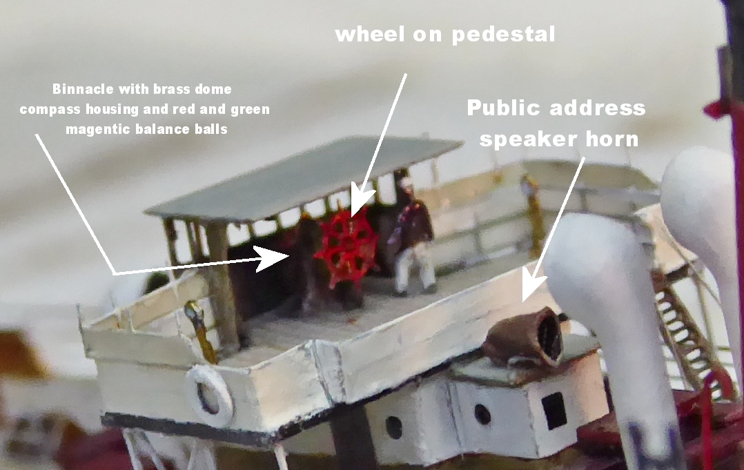

alas it does seem I reached the limits of my work-bench-point-and-shoot camera
so apologies for VERY poor image enlarged ...
I made a lovely binnacle- complete with brass domed compass housing
with the red/green magnetic balance balls-- but even I cannot see it anymore ! :big_grin: :big_grin:
The wheel picked up the flash and as such looks a most odd colour in the photo-
-not so in real life !!

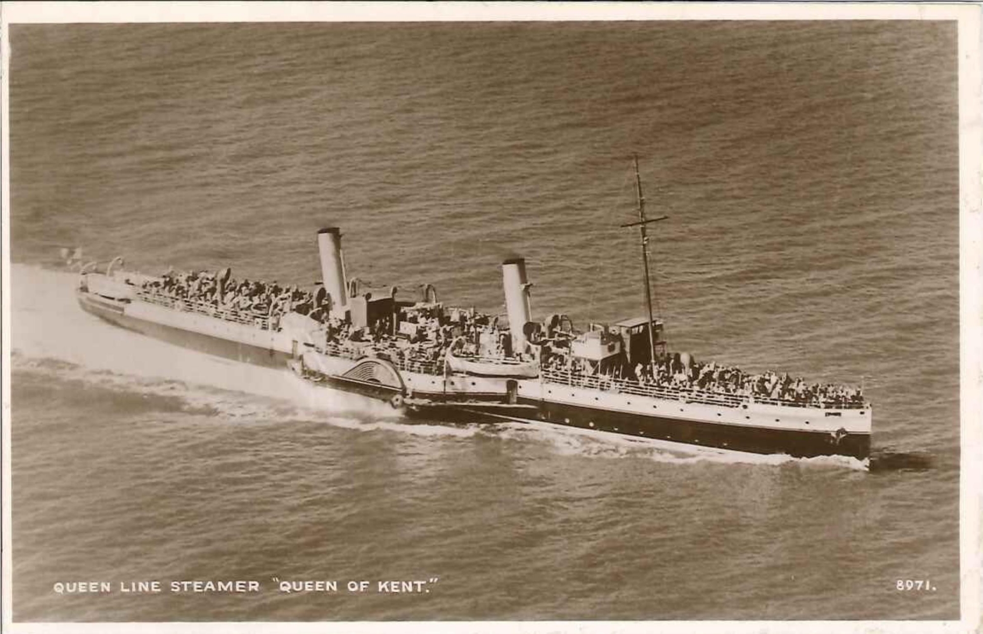

meanwhile a photo of sistership SOLENT QUEEN ( ex Melton ex Queen of Thanet )
with a full load onboard...!
==|> showing almost ALL deck detail obscured by peksy passengers !! :big_grin:

I love how you identify individual pieces of equipment in the not-so-great-quality photographs and then scratchbuild them using ingenious solutions. It is so educational. I love the smart looking benches!

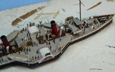

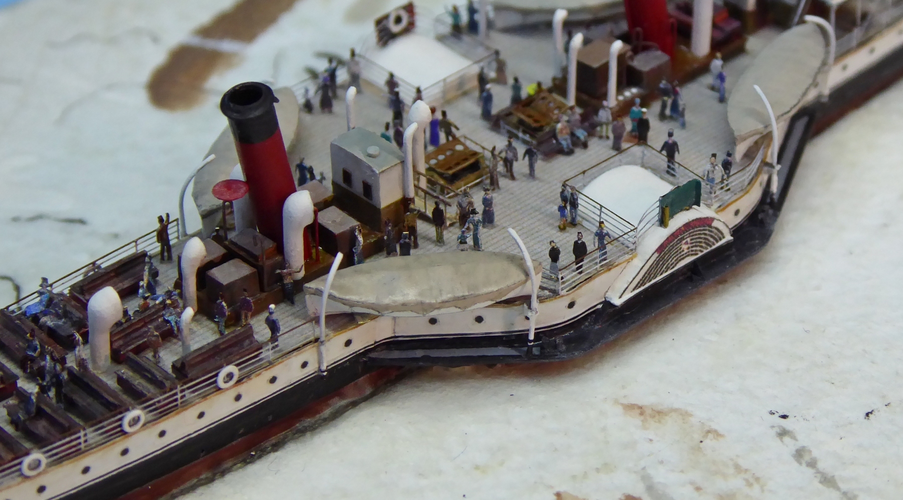

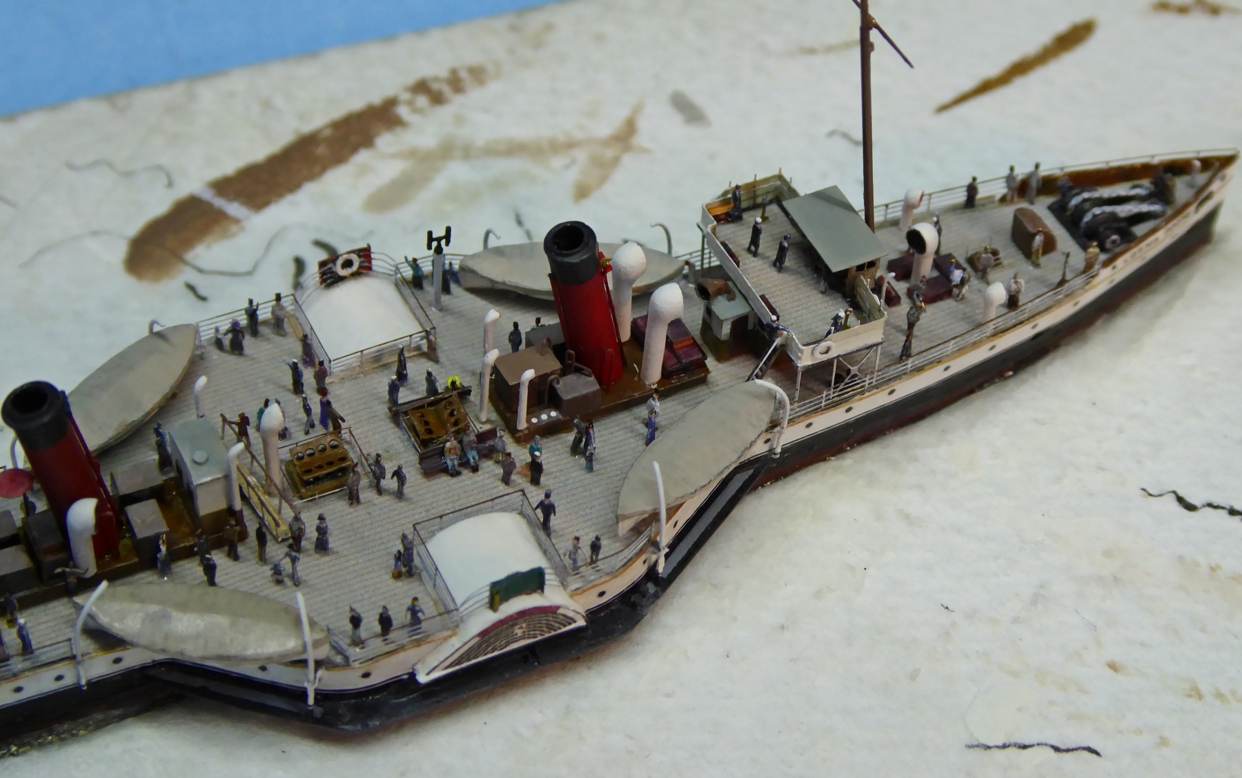

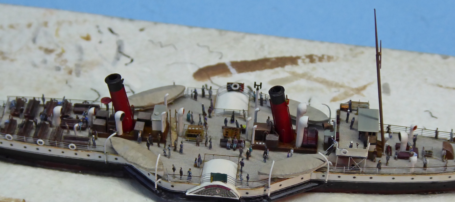

I have been busy--( between classic cars - family and a small health hiccup...)
with... forming and painting very small people ==> passengers...pah!
Naval crew uniforms are soooo much easier to deal with in 1/700 ....than pesky civilians.... !
all wearing different coloured clothes--some with children...
arghhh!
I used PE figures--
Just after World War 2 to early 1950's.....
British civilians were not that well fed... and mostly they were slim .
Resin and 3 D figures just looked a bit.... errr..... " big "....
the PE figures ( from a variety of sources ) had some white glue to give them some depth. -
--and heads, arms , torsos and legs
were altered and bent to give some variety of poses
I enclose images of the status quo
==> next stage is the greeny grey sea... .and then rigging..... and completion.
I reckon anther 3-4 weeks
Jim Baumann :wave_1:

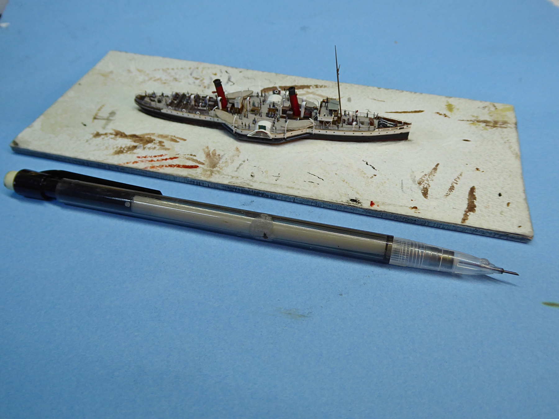

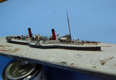

3 images only today--
so a summary...
I removed the ' spare ' gangway -( thank you Neptune :thumbs_up_1: )
and made another-- slightly shorter - bench
Thereafter I installed the 2 x deck floodlights,these are delicate
and fiddly to install on to the top of the paddleboxes

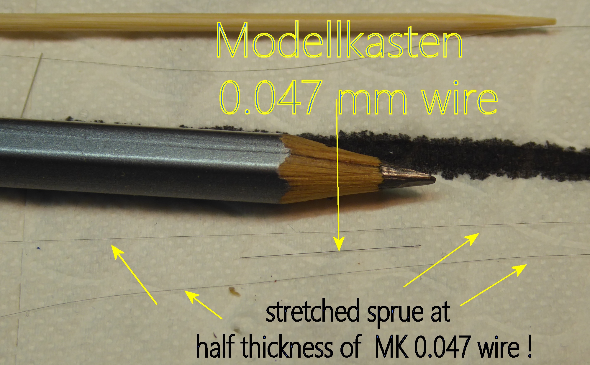

I rigged the stays for the two funnels before doing the shrouds
and halyards

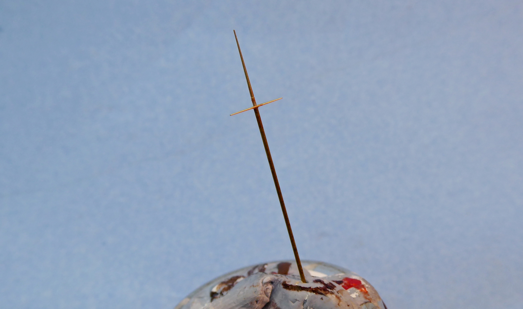

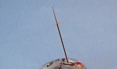

Initially I thought I would make life easy for myself
and use the Thinnest 0.047 mm Nitinol wire ( Modellkasten)
but on this diminutive ship even that skinny wire looked colossal!!
So I resorted to my favourite media and used stretched sprue
same old method--
viewtopic.php?f=4&t=37536
just pulling it quicker to make it MUCH finer ! :big_grin:

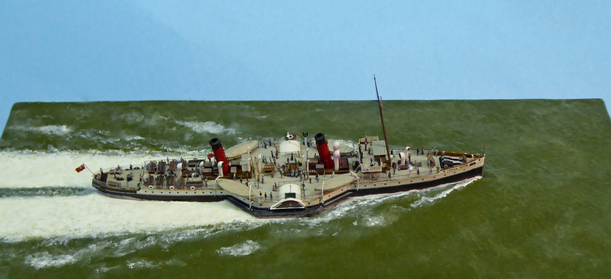

thereafter I set to levelling the gaps between the edge of the 'paper water'
and the Hull-- I have used successfully ( for decades) white glue for this
Usefully--when applied its white ( so I can see it!) but dries clear
thereafter once dry--I set about painting the wake and the sea
Next update in a few days
Jim B
Maarten Sch�nfeld
Posts: 1843
Re: PS LORNA DOONE ex HMS Atherstone -- 1/700 Paddlesteamer
Post by Maarten Sch�nfeld »
Hi Jim,
same old method--
Your ways with ultra-fine rigging with streched sprue keeps baffling me with amazement! :worship_1: It just looks so simple, but it requires a very fine technique, a very secure hand and the patience of an archangel!
Roger Whittaker +9/13/2023
SG1
Posts: 421
Post by SG1 »
Getting better and better! :woo_hoo:
Iceman 29
Posts: 1945
Location: Bretagne, France
Post by Iceman 29 »
:cool_1: Top!

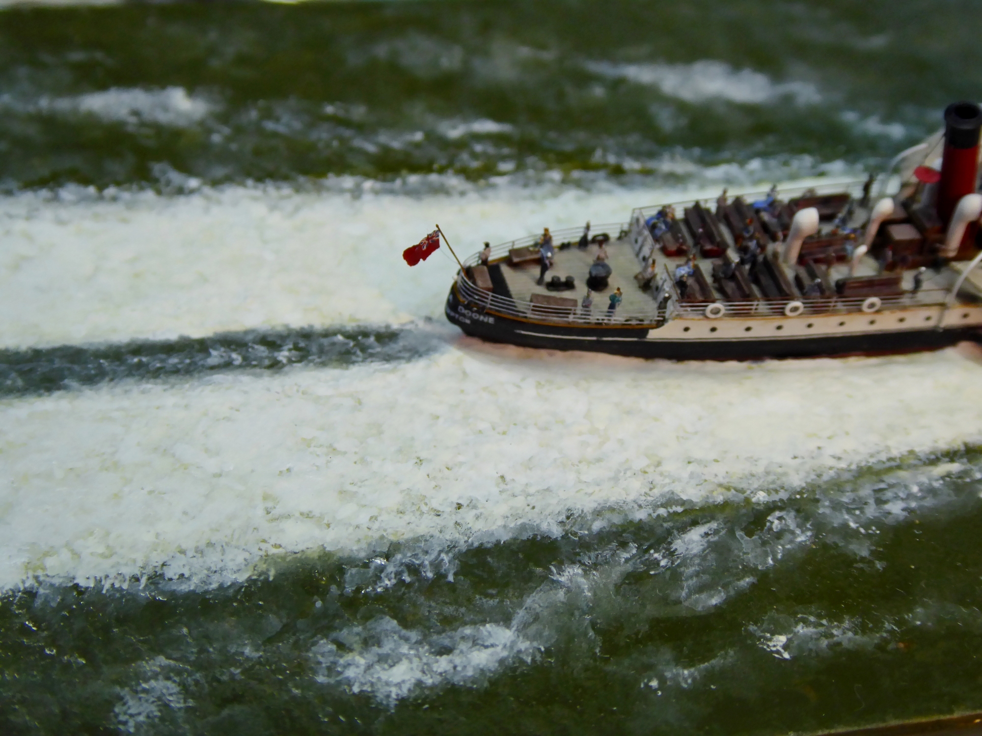

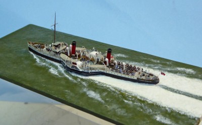

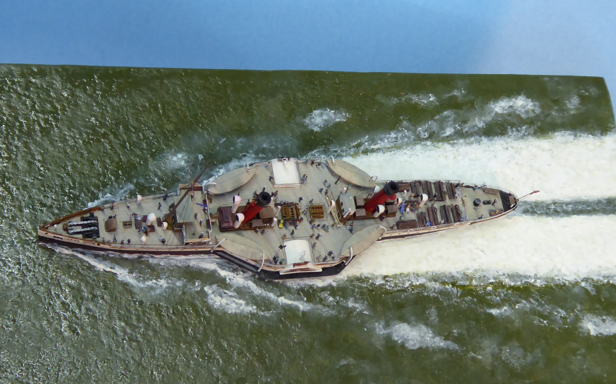

Pascal
JIM BAUMANN
Posts: 5691
Post by JIM BAUMANN »
Thank you gentlemen;

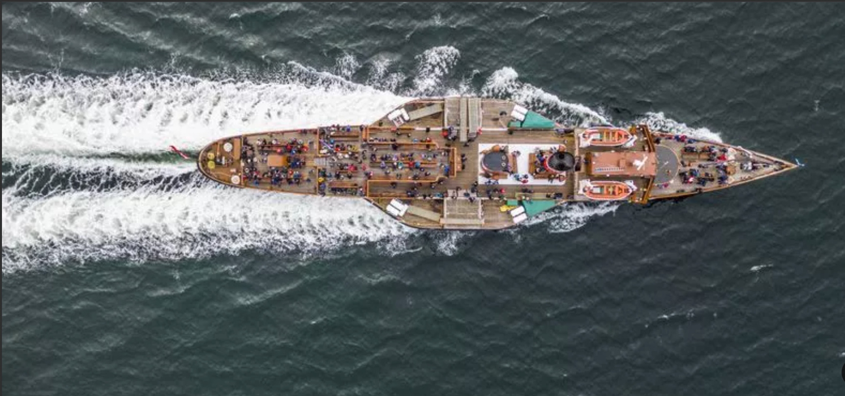

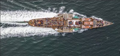

I deliberated and wrought my hands for some time...

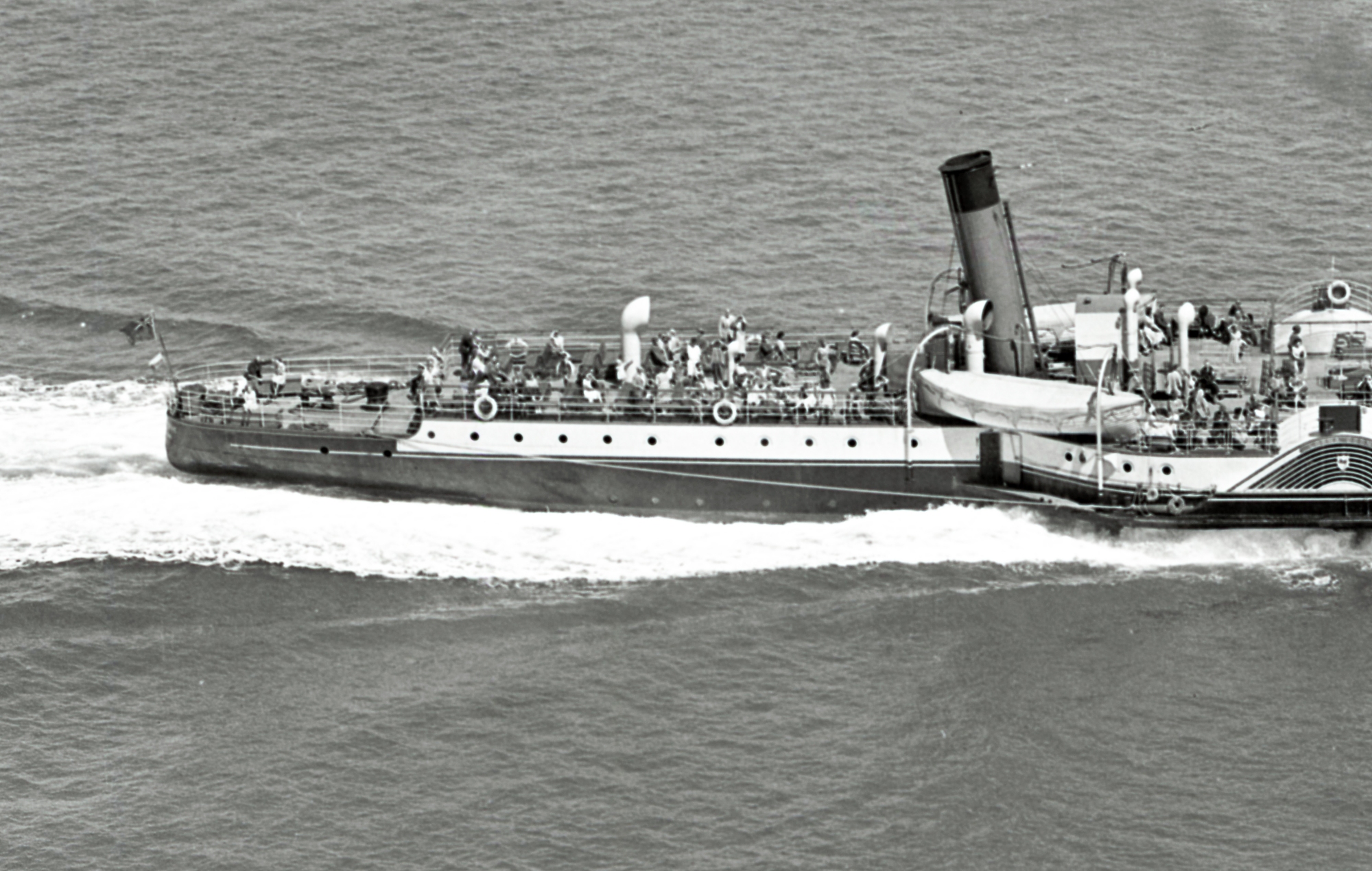

the vexed question of " paddle-steamer wake pattern,
at differing speeds, differing paddle wheel designs, differing hull shapes etc
how much by foaming white 'thrash' aft of the paddle wheels is realistic
Views of paddle-steamers from above are surprisingly rare-- and then mostly of
the Waverley- a large British seagoing paddler of nearly 19 knots- and only a few
of the images are of the vessel them at high speed...
The large fleets of Swiss Lake paddle steamers-- fine vessels that they are
have top speeds up to 17 knots-- but cruise at around 10- 12 knots ( tp reduce wash on lake shores)
and the few overhead images bear that out
a few images as examples...Waverley's paddles... when the dig into the water seem to make a distinctive
pattern aft of the paddle wheels both sides-- which appears to differ somewhat from the
" thrashier " more turbulent white water pattern of Lorna Doone...
Waverley being a 1948 build I think has more efficient "blades"
than the 1914 designed Lorna Doone and her sister Solent Queen.
a few image to support my thoughts...
PS Waverley
Solent Queen ( ex Queen of Thanet )
Lorna Doone ( ex Queen of Kent )
So onwards ...

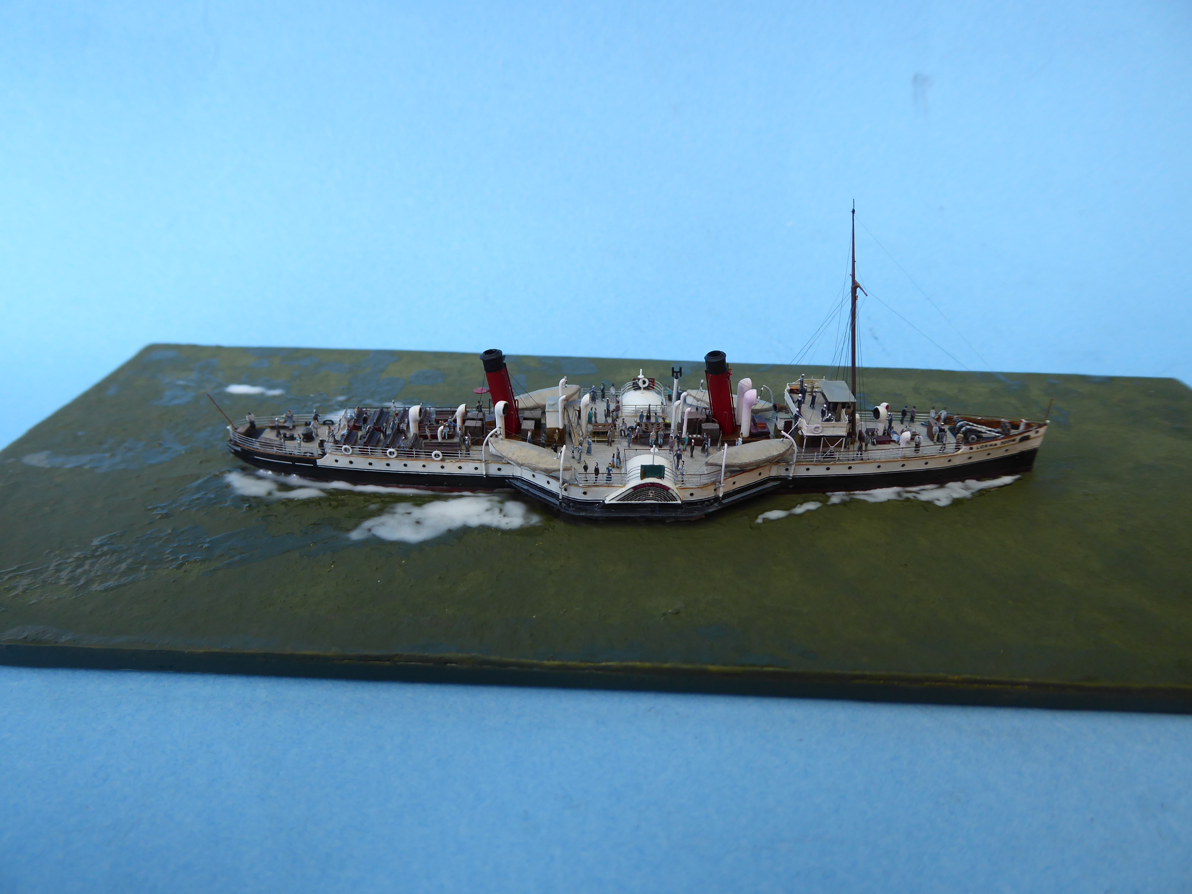

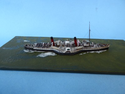

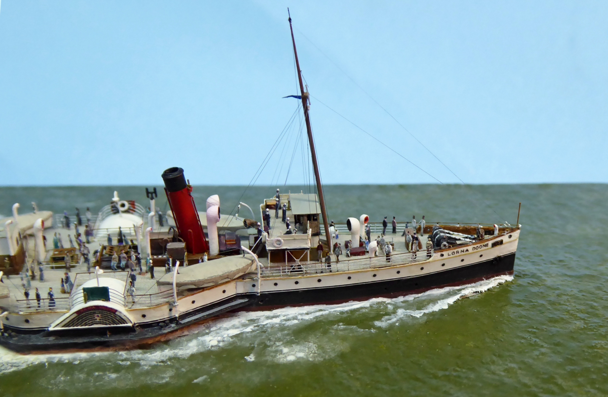

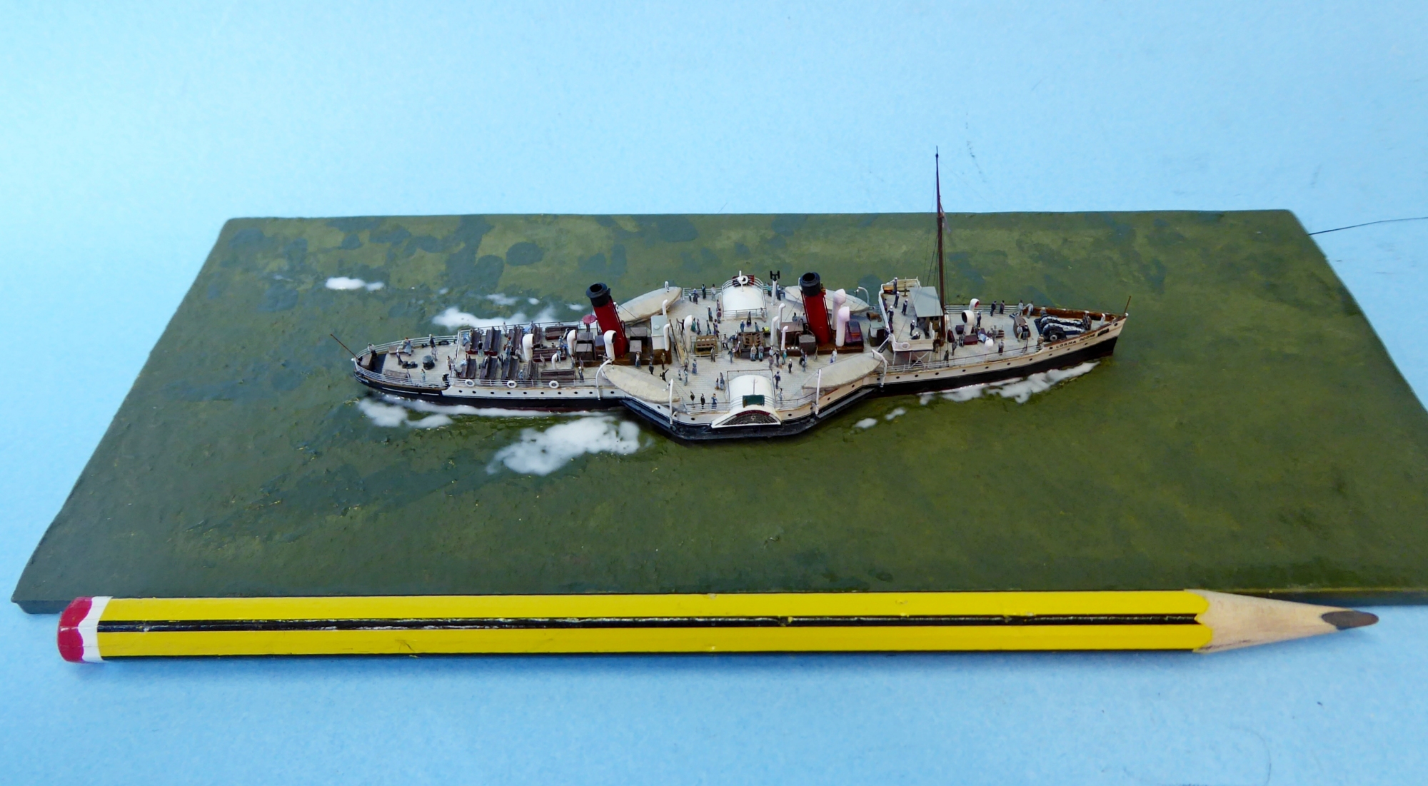

I eventually chose to create an amalgam of the various images
but leaning more towards the thrashy water of the 1915 ex minseweepers,
charging down the Solent at 15-16 knots....

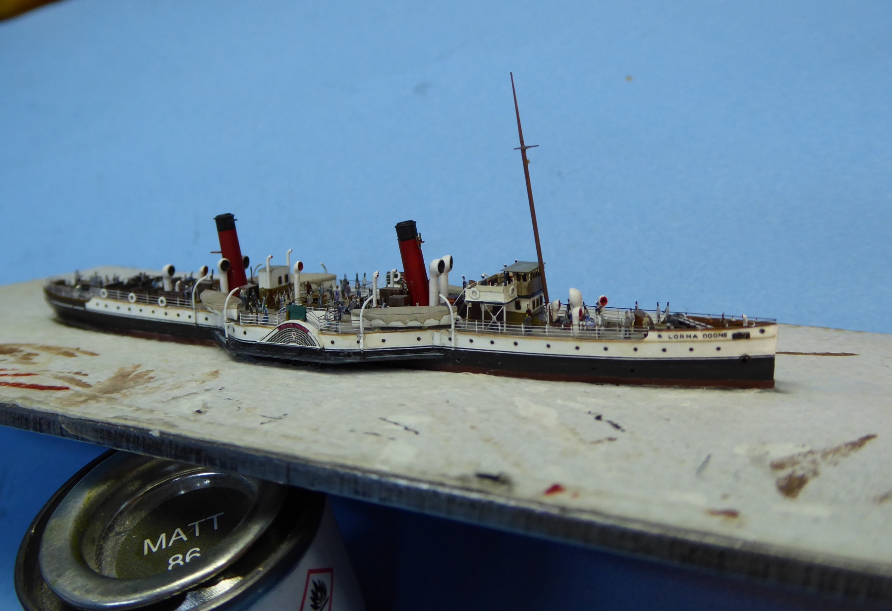

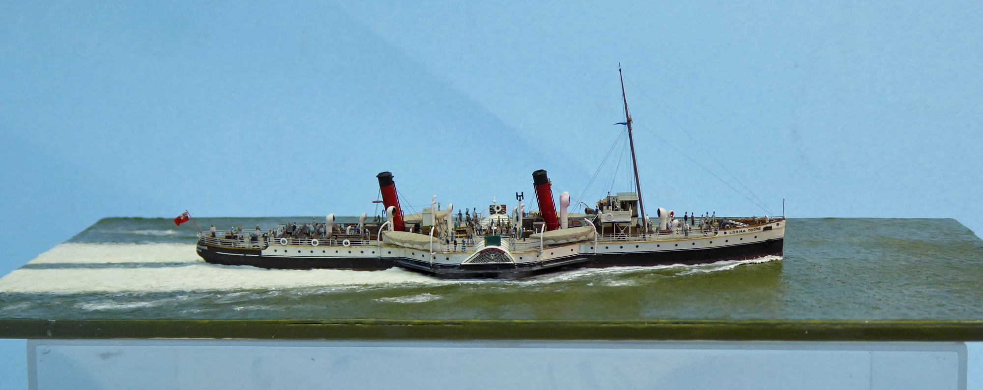

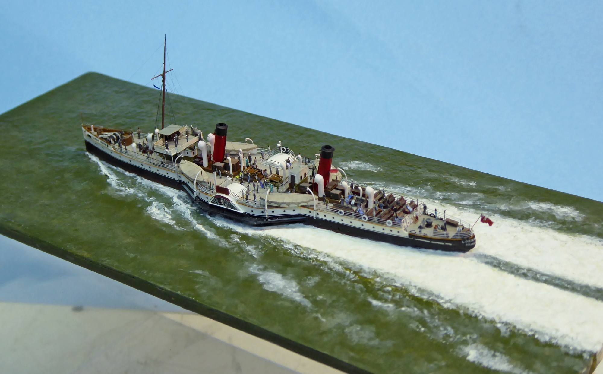

The model is essentially completed -
aside from a last check-over ...
below are some snapshots with the workbench camera ...
I will do some ' proper ' photos in good light with the SLR on a tripod..!
giving proper depth of field and less wide angle distortion that the point and shoot
Its been quite the journey...

Beautiful work! The wake pattern looks very good. Congrats on getting her across the finish line!

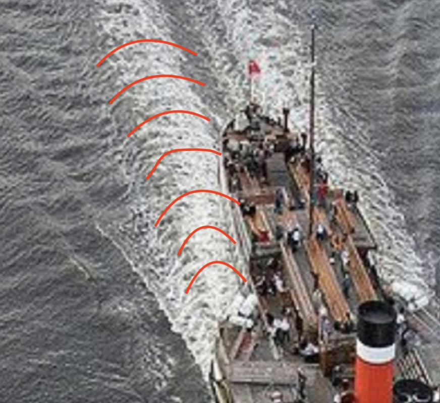

In this photo, you can see the small curved waves produced by the paddle, faster in the center than on the outside of the wake, forming a curved wave. Looks pretty typical to me.
Depending on the speed of the vessel, it must be different of course.
