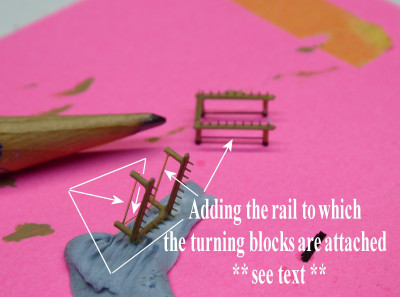

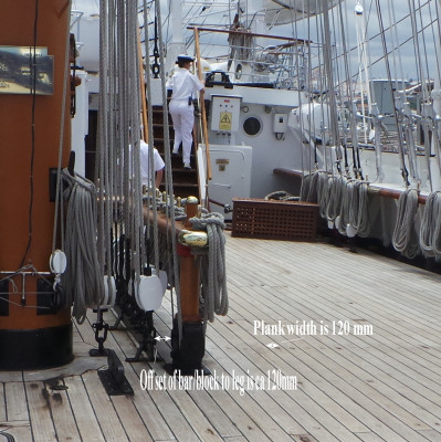

I added the simulation of the bar that holds the turning blocks
for the halyards to go to the belaying pins
In real life....
these bars are separately mounted slightly inboard
-- but 350 times smaller--and with the space requirements for handling in model format
--and the fact that my pin-rail legs are a little over-scale...
and that the real life the bar is approx only ca 120 mm or so distant from the leg
( in 1/350 = 0.34 mm )-- so its a permissible compromise in my view .... :heh: :wave_1:

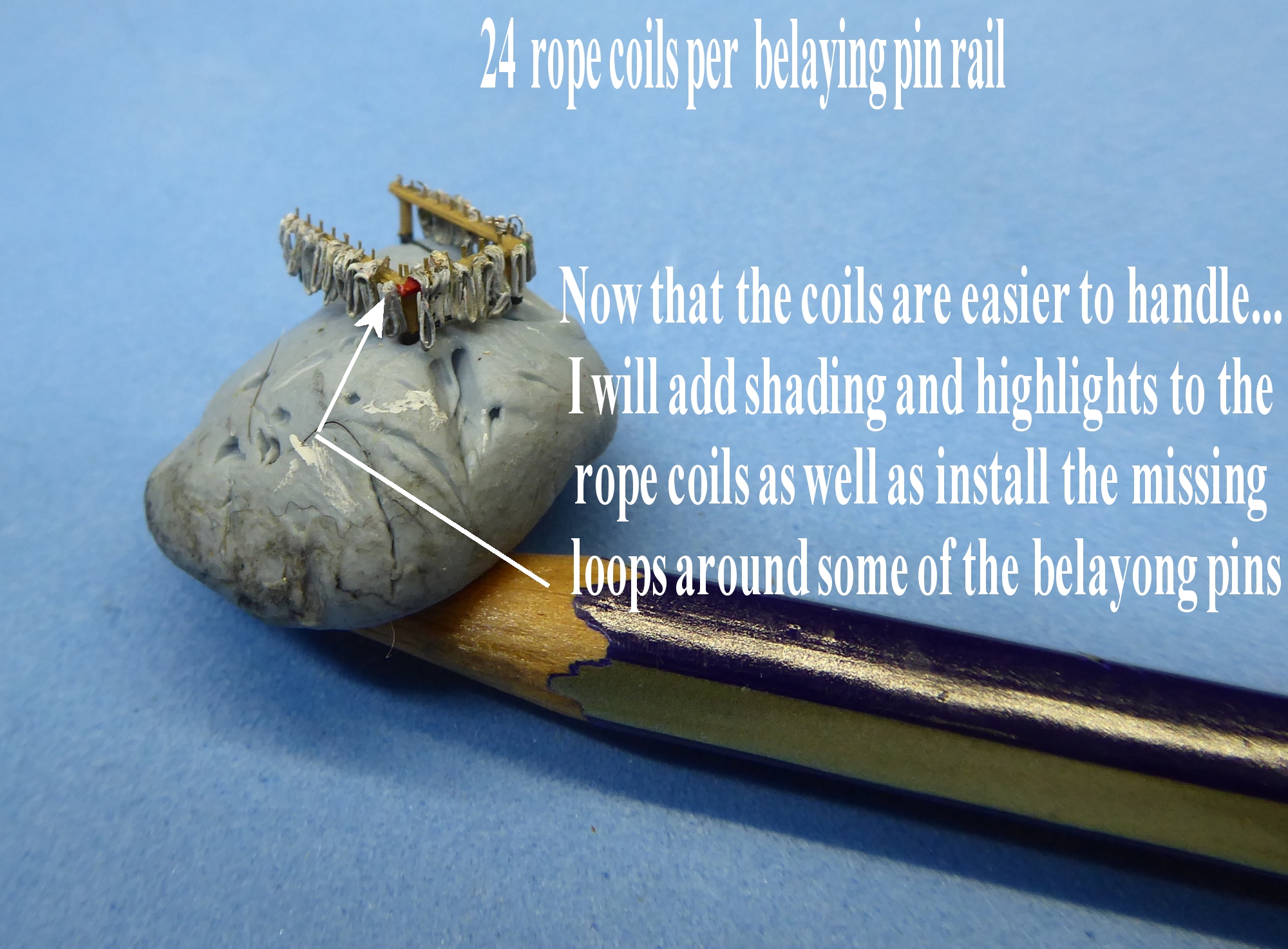

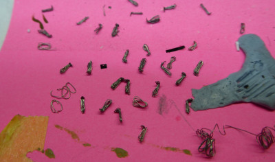

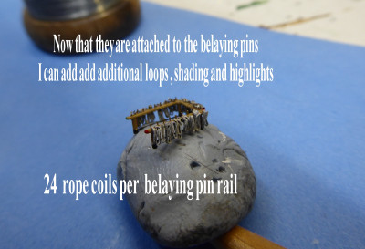

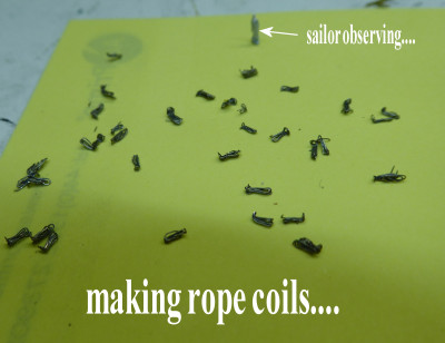

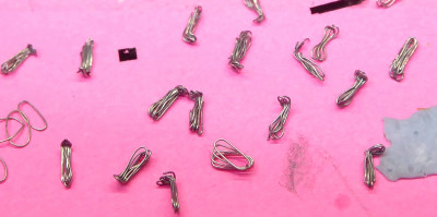

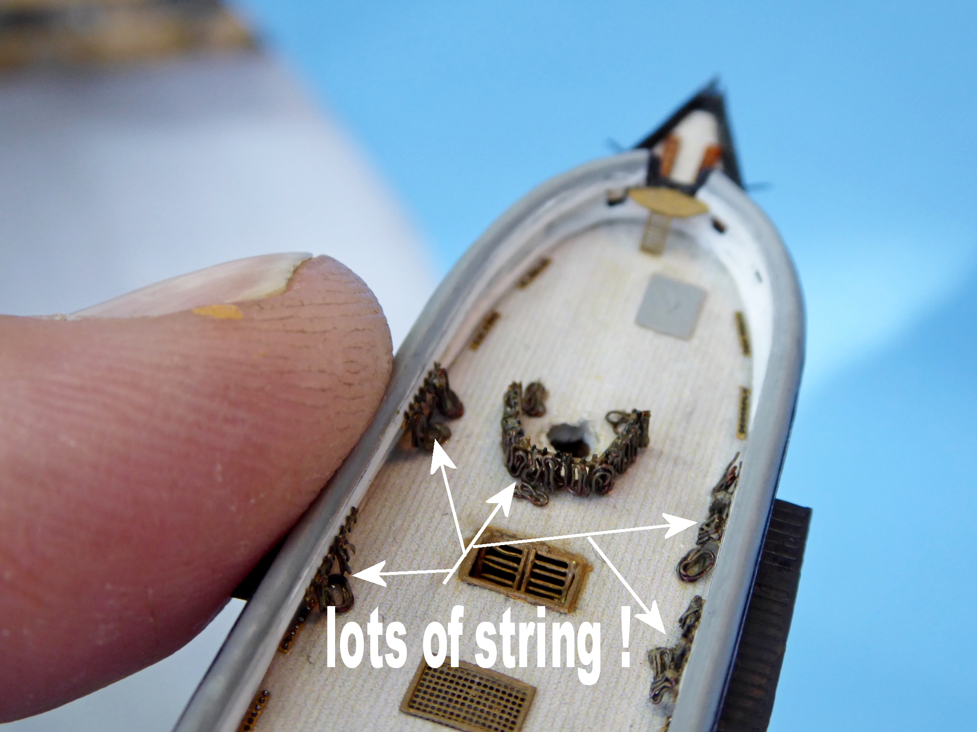

making the 100 plus rope coils is a tedious business--
-wrapping copper wire around 2 x drill shanks taped together, compressing them, shaping etc etc
the success / wastage rate is around 50/50
once attached to the pin rail...it looked somewhat better!-
(-the rope coils are the devil to hold secure to paint )

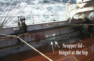

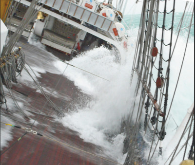

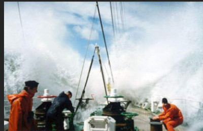

Sailing ships( and steamers !) in rough weather and big seas could ship lots wateriin main deck-
( note the lifelines spanning that deck--crew can clip on whilst transiting fore and aft...(!!)
-this tonnage of water must be gotten rid of quickly -- or stability can be impaired --hence ships are fitted with scupper drain lids
This top hinged lids allow the water to escape from both sides--important in a rolling sea

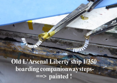

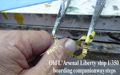

Replacement was harder--I searched through my entire stash of PE for something suitable ==> x 14 !
( plus spares for mis-cuts and, dropped etc)
Nothing and more of Nothing !!
except ........
a 20 + year old PE fret- 1/350 -L'Arseneal Liberty ship--- the somewhat overscale treads of
the boarding companionway were perfect --and plenty of them
These will be affixed shortly!

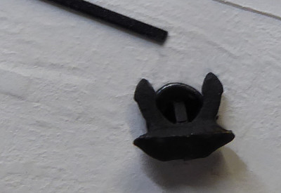

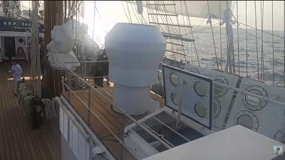

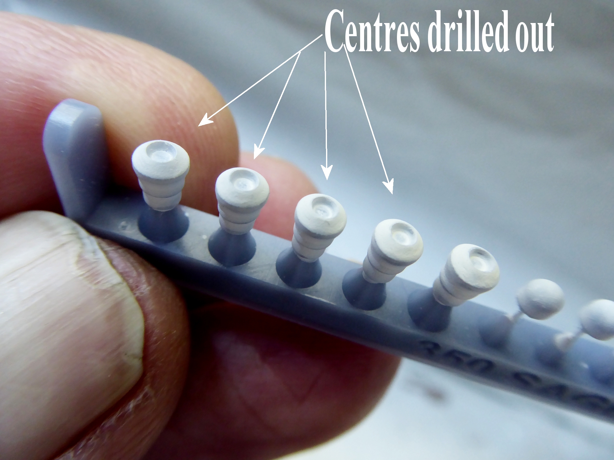

the gargantuan " Big Vent" above the engine room flummoxed me
Not owning a lathe I was unable to create the right shape and be sharp and edgey( its only ca 5.5 mm high) ****
I had these designed and 3-D printed for me by a kind French friend.... :wave_1: :thumbs_up_1:
seen here under-coated.
**** They were printed in steps of 5% and 10 % so as to give latitude in exact size!
I subsequently drilled out the centres on my mini-pillar drill

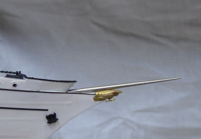

The figure head also again flummoxed me!

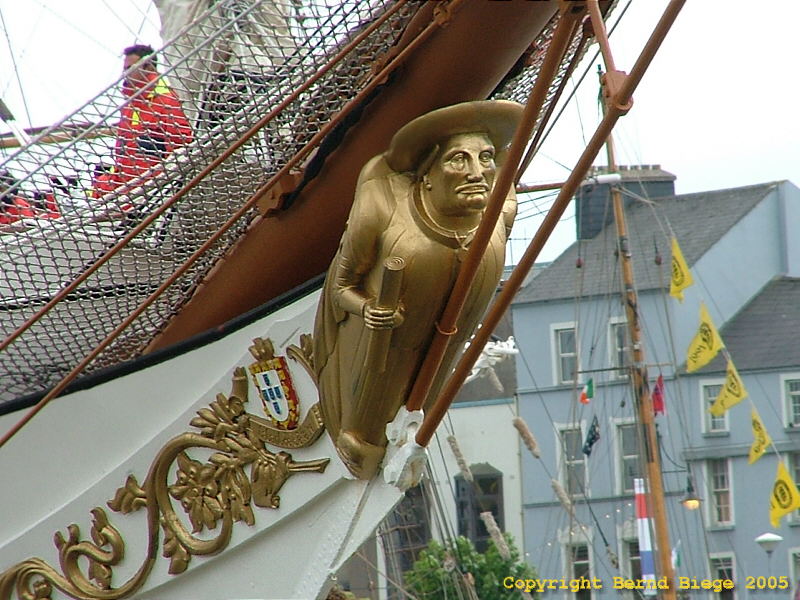

carving or adapting a ' proper ' figure ( as on 1/700 Bretagne ) was easier than
trying to make a stylised and semi-abstract figure--which has in its right-hand a rolled scroll !!
I had this figure-head designed and 3-D printed for me-again- by a kind French friend.... :wave_1: :thumbs_up_1:
it is seen here attached with test fitting of the bowsprit
It till needs a bit more work to fair it in

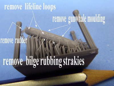

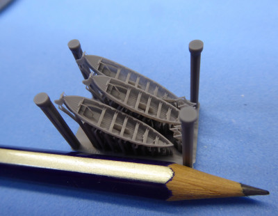

I stared work on the 2 x 27 ft whalers. these are broadly RN pattern
The best I could buy wee from Micromaster of New Zealand.
But these very fine 3-D prints have a different fit to those aboard rge Sagres ;
so needed work to adapt successfully !

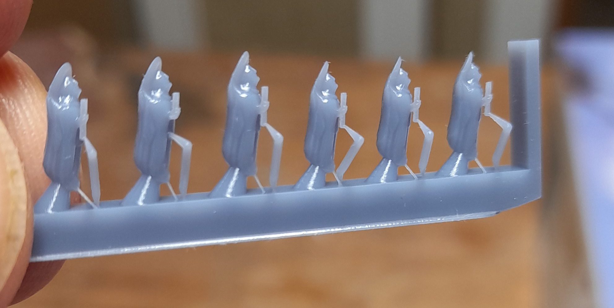

Hello all--some new progress;
Sagres being an old ship--1937-- but as a sail training ship she is compelled to meet modern safety equipment regulations
She carries a number of modern Liferaft cannisters ( 14 identical--2 smaller ones )
I have tried a few life raft cannisters

I have tried making these from scratch--but was failing to get the inflatable Tubes ( collars ) consistent, symmetrical
or indeed believable bends.
I tried making the tubes from lead free soldering wire bent as well as cut and shut.
I gave up and bought these
They are BEAUTIFULLY detailed models in their own right
alas --for me they have a number of issues ( ...--for the Sagres RIBS )
1) they are too long ==> 7 metres as opposed to the 5 metres Ribs on Sagres
2) they are inboard powered, and have divergent angles for the tubes-which have pointy ends
But the tubes were believable--so I removed everything, cut the tubes off the hulls, shortened both the hulls and the tubes--
re-assembled them with parallel tubes ( taped) as in the overhead image of the Sagres Ribs
The process was as below;
[at
the chosen spec of the RIB was like this;
the rubbing strakes were added using 0.2 mm black tape
varnished after application with clear matt varnish to homogenise the levels
( after the images below ---they had a wash to reduce the contrast and intensity

The mast diameter was calculated as below and verified with scaling off Photos
Each plank is 120 mm wide
extending the line of the mast vertically down -excluding the deck mast collar
vvvvv Visita_al_Buque_Escuela_NR2P_Sagres_de_La_Armada_Portuguesa_en_Las_Palmas_de_Gran_Canaria_(14466253604).jpg
4 x planks = 480mm
2 x 3/4 planks = 90mm 180 x 2
570mm diameter...
aha ==> plus caulking!
I estimated -- by measuring the planking on the screen with a ruler-(!) - that the caulking to be 8mm
5 x lines of caulking within the mast-- 5 x 8 mm = 40 mm + 570 = 610 mm for main mast at deck ?
divide by 350 = 1.74 mm dia at deck for 1/350 Sagres
