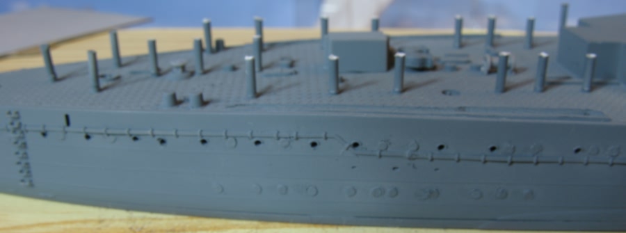

It seems that adding the Lionroar floatplane handling deck (�flight deck�) is really very complicated. :thinking: I needed some time to develop a plan. First I cut all the plastic pillars from the Tamiya plastic flight deck and glued it one by one to the corresponding position of the lower deck (Mogami37).
Mogami37
Mogami37
The Lionroar instructions are not very clear here but it seems that it is expected to cut these pillars from the resin rod. This is difficult because the pillars seem to be different in length. Another reason not to use the resin rod is the larger diameter of it compared to the plastic rods. Mogami38 depicts the plastic pillars in place.
