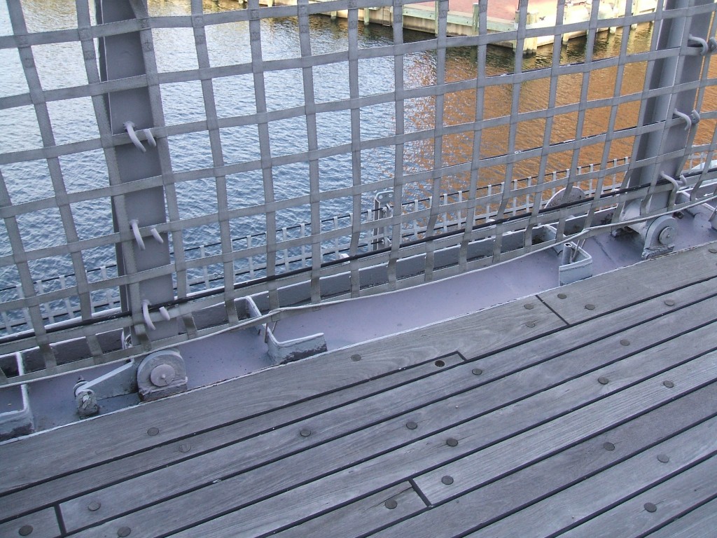

1. The real I-Beam stanchions are actually quite thick and beefy. On the real ship the outboard face of the stanchions are nearly at the deck edge, while the inboard face of the stanchions are aligned with the inboard face of the chocks. In other works the stanchions are nearly as thick as the chocks. Folded PE stanchions provided by Pontos and Eduard are still too thin, unless you use two PE stanchions glued back to back for each stanchion. Otherwise either the outboard dace of the stanchions are too far inboard, or the railings can not align with the backs of the chocks.
Here is a photo of BB-64 (museum) which shows the larger collapsible stanchion and its relative position in the waterway:
If it were feasible to have 3D printed stanchions provided, that would be the ultimate way to go. However, using the Pontos brass PE stanchions in place of the kit version will not really improve how these fit or look (Pontos is what I ended up using). This is a crap shoot and you probably won't like the odds or results.

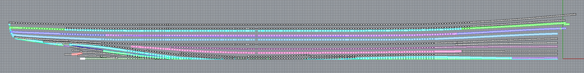

chazi wrote: I just started to build USS Missouri model 1/200 from GPM - polish paper models publisher and I'm looking for drawings for shell expansion or shell plating of the hull.
I have been working on and off on putting together the shell plating data from various sources. Most of the blueprints I have are extremely difficult to read. I think there are eleven blueprints plus the mold loft data. Each one is about 40MB so its about a half GB. And then it has to be deciphered because most of it is hard to read.
This is some of my work in progress. I am still refining the XYZ coordinates. I have not started on the shell thicknesses and types of joints.

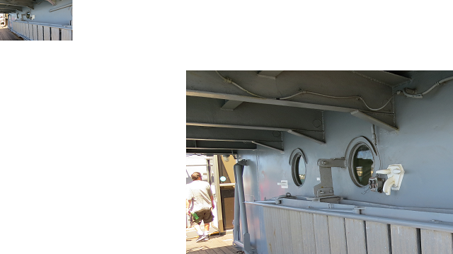

This is a picture I took on board Missouri. You can see that the steps are folded flat.
Larry
