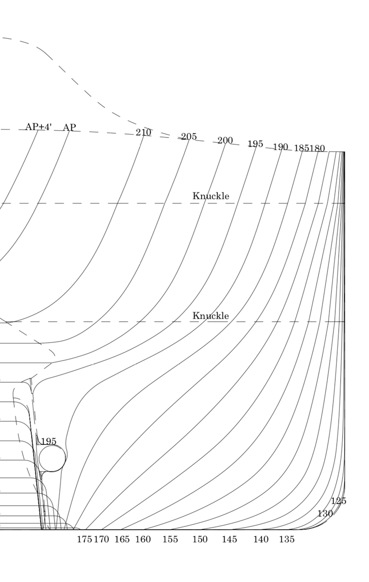

I hate to criticize fellow authors but, while the book does well illustrating details, the structural aspects of AOTS: Iowa are problematic. To be blunt: correcting the hull to AOTS would be a total waste of time.
For some reason the hull structure of the Iowa-class has caused problems for kit makers. This is surprising because the documentation is available. The bow is and stern are always wrong in kits.

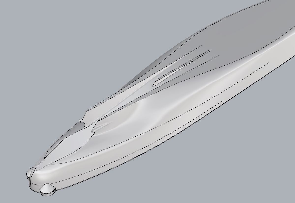

This is the MOLDED shape of the hull taken from the original blueprints:
Kits tend to miss:
1. The twin keels are an integral part of the hull form and are not attachments (ie, not true skegs).
2. There is a docking keel running from through the space between the twin keels.
3. The tunnel between the twin keels widens as you move forward them takes a slight turn inward at the forward end.
4. There is half siding that runs from through the tunnel to the end of the ship.
5. There are two knuckles in cross section at the stern.
6 The flat siding at the bottom of the hull tends to have the wrong shape.
Tamiya made some misteaks and it appears that others took the Tamiya hull form, blew it up, and make the misteaks even bigger.
Kits also tend to make the bow waterline waaaaaaaaaaay toooooo wide.
My other peeve is that the they tend to make the forward tower start to narrow at the 08 level (primary conn) when it actually narrows at the 07 level.

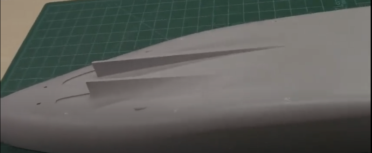

Here is a screen cap from a YOUTUBE video of the Trumpeter Stern:
It should be immediately obvious that the hull form is not even close here.

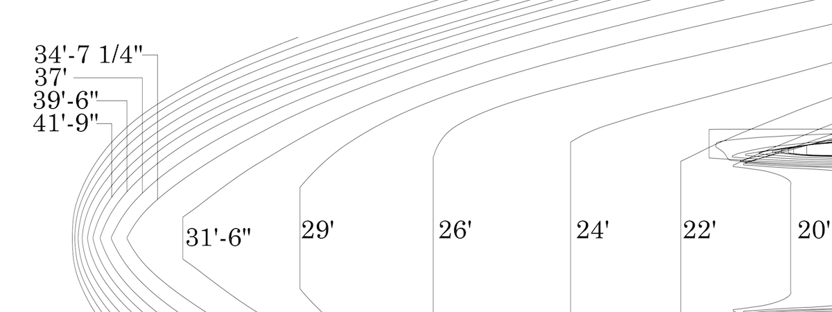

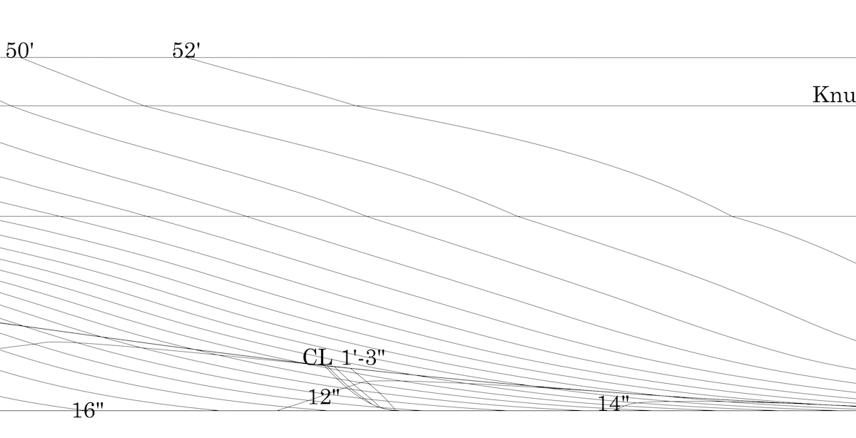

I promised myself I would not do this but, in response to this thread, I pulled out AOTS to look at the sections, waterlines, and buttocks. What I have is quite different. Then again, I'm just some schmuck in an Internet forum.
AOTS does not indicate where the waterlines, sections, and buttocks are, so I cannot make a direct comparison.
A) Note the discontinuities at the knuckles.
B) The discontinuities are more subtle in the frames. Note the position of the shaft relative to the inside of the twin keel.
C) Note the straight lines across the keel
I'd also not recommend following AOTS for the plating lines.

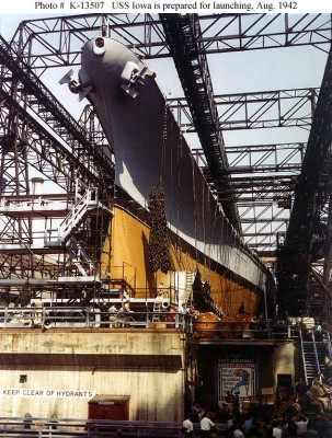

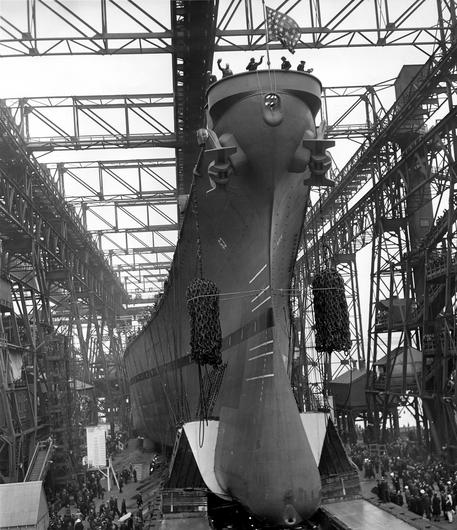

When launched, the 4 IOWA class BBs did not follow a single protocol for what was or was not aboard at launching - here are some photos to illustrate my point - BB-63 DID have her 20mm bow enclosure in place, BB-61 did NOT. BB-62 did NOT, BB-64 I can't confirm - no launch photos. Here are some photos to explain:
BB61 -
BB62 -
BB-63 -
Additionally, here is a photo of IOWA's 20mm Bow enclosure from the deck level:
Each shipyard handled things differently as to how much of the ship was actually completed at launching. Most were fairly incomplete (lacking 16" turrets, 5" gun mounts, all smaller arms, etc.) and the ship was then towed to a "fitting out" pier nearby for months of completion of all shipboard systems prior to a Shakedown Cruise and subsequent commissioning.
Edit - So, here is a bow plan I converted from a .pdf BigJimSlade sent me - this shows the configuration of the 20mm mounts as they were designed on IOWA class ships.

To what SeanF just posted - The IOWA class (as were other USN warship classes) were in a constant state of "evolution" - their continual changes in anti-aircraft defenses were on-going as were modifications to superstructures; this state of "flux" in what actually commissioned from the origiinal builder's plans is a study in itself.
Understanding the differences between the ship "as launched" and the ship "as commissioned" AND subsequent alterations made after initial shakedown and 1st deployments helps one understand that nothing with these warships was static - I'm fairly sure that the initial battle reports coming back to the Bureau of Ships from all theaters of combat more than likely contributed greatly to how the follow on ships were configured and thus commissioned.
Ships that are launched are still "under construction" - lacking most, if not all weapons systems, very little of the final superstructure, and no masts/RADARs, etc. - a lot of this has to do with the location of the launching ways, depth and breadth of the waterway where this would occur, and other logistical factors which would make launching a "completed" ship almost impossible.
Hope this helps,
