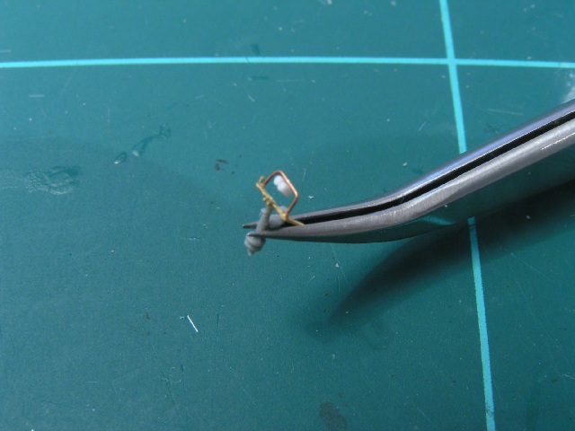

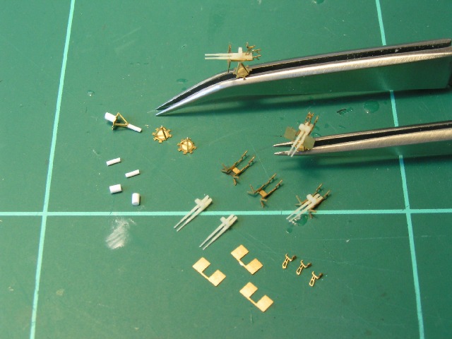

Hi again,
regarding to the number of US News 20mm Oerlikons I have reviewed a lot of sources. Consequential I decided to put five 20mm Oerlikon to the model. I used also the tripod base from Lion Roar instead of the gun pivot. The barrals and the PE comes from L'Arsenal nice set. I have added plastic rod as a pin on the bottom for fixing the gun to the hole in the deck. The other pin is the guns base. There are a lot of parts to finish and it is time-consuming to make progress. Now the PE is fixed to the boat and the loockout chairs are finished with some extra details in form of binoculars. Also finished with some more detail, the three Mk. 51 gun director tubs. More and more New wake up to life.

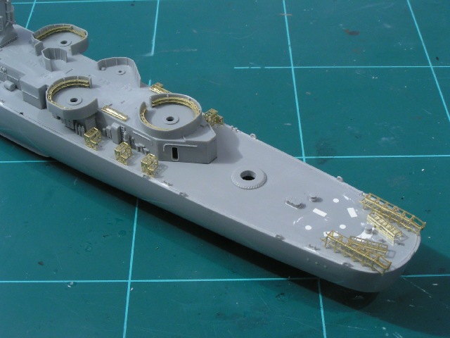

Hi Christian,
Lookin' real good! Nice work with the PE, crisp bends and nice and straight fit. It's fun watching your build.
Timm
Timm

That's a very impressive job

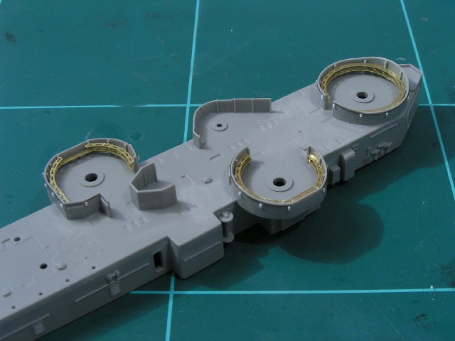

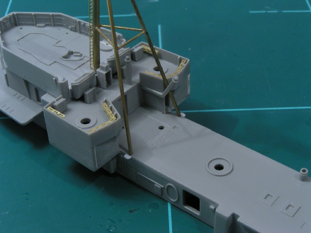

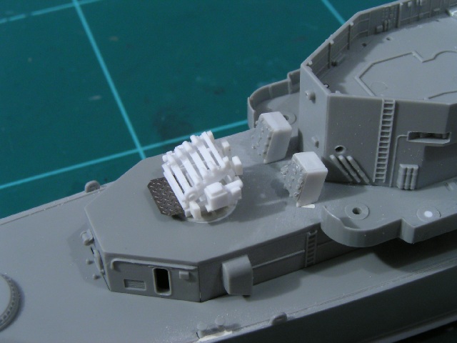

Hi again,
Timm and Jose, nice to see you�re watching my build
there is always a bit of time to find to work on the model but now I have finished the K-gun and Mk. 9 DC racks. It was easy to bend the parts with my Hold and Fold bending tool. The racks lacks the charges, but I have only styrene in diameter 1.5mm at the moment and that isn�t thick enough. Next I have made two lockers that were placed in front of the bridge, next to the Mk. 15 hedgehog. I�ve modified the lockers (unused lockers from sprue D) with some styrene. Next I�ve added parts often seen on photos. First, platform edges to keep the aft legs of the tripod mast. Second, clamps and hinges on the 40mm gun tubes to hold the tubs canvas covers. Attempts to make the clamps/hinges from 1/700 scale railing failed. At first I thought about making the parts from plastic stripes and fine bras, but then I decided to use stretched sprue instead of brass. That's it for now

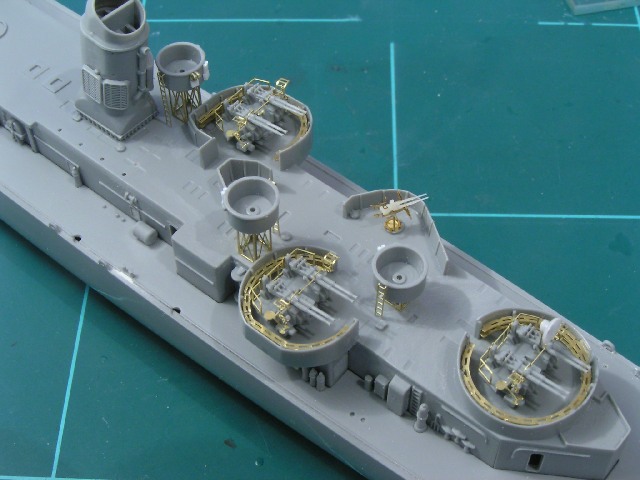

Christian,
I am wondering if you have any plans of loading up the 40mm ammo racks or leave them empty?
And this may be a general question for eveyone, out there. I just started wondering this, lately, after putting them on my USS Oyster Bay AGP-6. I can't recall seeing any models where the modeler has inserted something in the racks to replicate the ammo ready for use. I covered mine with canvas, instead, mostly because it will be in a diorama and "in action" somewhat.

Most of my ants and spiders who are working to finish USS New are in holiday, so I think (just now) I will leave the racks emptyNukeMM wrote:Christian,
Joking apart, a question I haven't thought about before. I have thought only for making canvas covers, but I have dismissed it because I would like to see the fine details of the racks!
Man you make me thinking aout the next problem
On most of the photos showing the ships in a harbor or a yard, the racks are emtpy because of the unloaded amunition! But on employment they sould be ready for action. Mhhh, I would like to display USS New on high seas - ok, time will tell

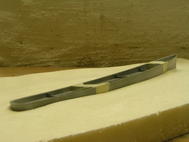

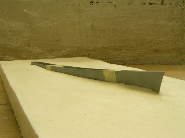

@Rui and Carl, I�m thinking about your sugesstion about the rack covers
@Dave, I�m pleased to hear you�ve got one, and yes, the detail is quite good!
@Kim, thank you for your kind comment!

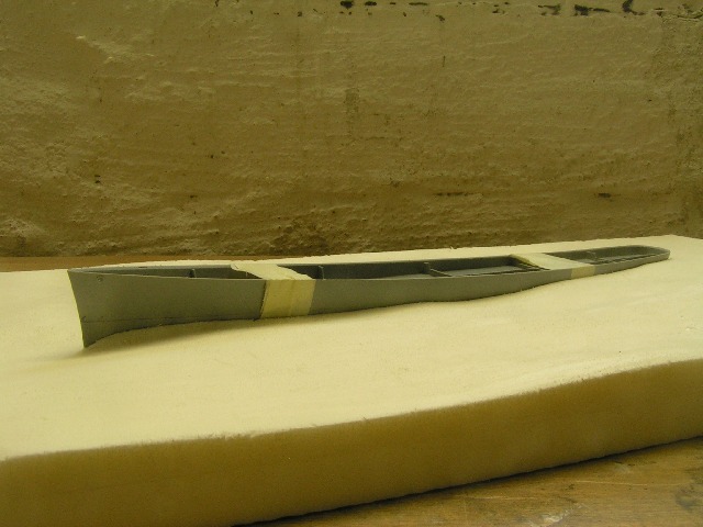

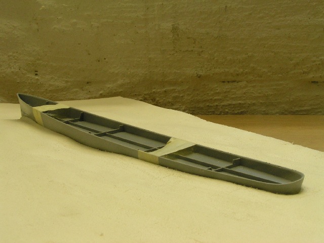

Back to USS New! Today I start working on the base. I have used Styrodur, a more compressed sort of Styrofoam. That was the first time I shaped a seabase for a larger model, and shaping the compressed stuff was not as easy as I thought. In the end I used a knife to shape the rough base and then sanding paper for the finer work.
Before I cut out the ships section I shaped at first the whole display (the display is arpox. 25cm x 55cm). In the second step I cut out the ship section slightly smaller than the ships outline and fitted the hull by shaping the ships outline with sanding paper. I would like to display the model making a starboard turn with the starboard lower hull coming out of the water. The underwater bow can also be seen.
I�m curious what you think of that!

I like the look. When I do my USS The Sullivans I think I will try the compressed foam. I am going to have heavy rolling seas, and I think the way you did it gives more control over the rolling waves. Thanks for the idea.
