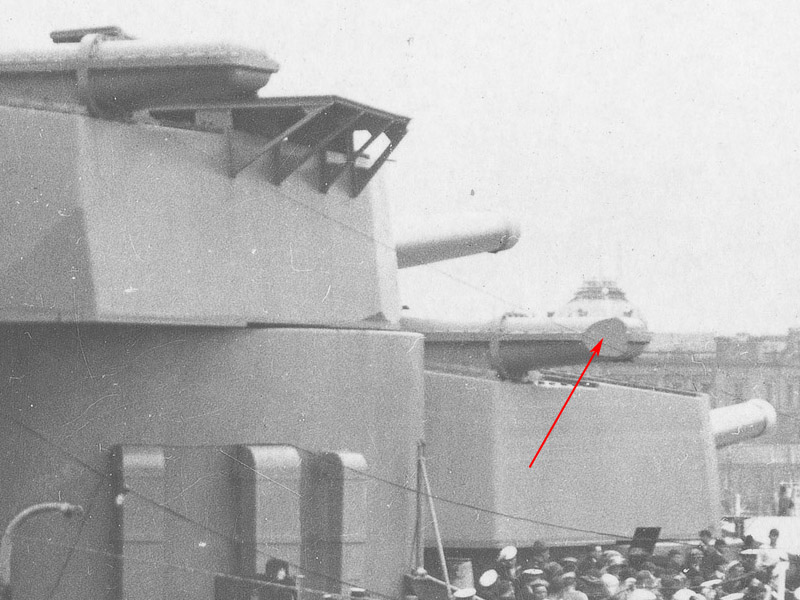

Bill Livingston wrote:Are you sure that first photo is X turret and not the earlier platform on B turret?
A turret rangefinder hoods are angled, B turret rear armor plate has two additional facets on the outer lower corners, the vents of B-turret are different, you can see the typical awning line plus spreader (attached to the vent), I cannot see any breakwaters that should be very visible for B turret, the small bollards near the taller barbette, the jack staff has a small plate where the fog light was fitted, you can see the quarterdeck ladder's davits and there is also a boat moored at the stern (and that does not happen at the bow). So that is nine reasons to say:
:yeah: really sure
Oh, and there is a platform on X-turret that is unique to that turret :wave_1:

It almost looks like the PE platform is simply mounted too far forward on the turret.
:yeah: really sure
Oh dear...! I just knew I should never post at quarter to one on the morning when I'm tired!
I know ALL of this stuff... yep, all nine points... and even thought it as I was writing my post... but I still carried on writing it regardless... just because that end framing, from that angle anyway, just looks completely different to all the other photos I have seen...
But I'm less tired today... so less oblivious to any facts that might get in the way of distorted thinking... and I think I have worked out how to get this platform right... we will see... :cool_2:

I worked out what was going on last night...
I had confused these two photographs...
This one of B Turrets earlier platform...
And this one, which you just posted, of X turrets platform...
X-turret platform (late).jpg (93.13 KiB) Viewed 5588 times
Not exactly similar are they???
I really need to engage my brain next time - or put in a warning to ignore any late posts I may make...!
Grovelling apologies EJ...!!
