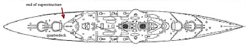

Grizly,
My little help for finding the quarter deck or super structure:
http://www.engr.mun.ca/~cdaley/5003/ship_terms.pdf
But there will be better ways to find out what is ment by super structure.
Like giving Google the words: "HMS Hood quarter deck" and it will show us the quarter deck in pictures and words.
That's my way of translating it into Dutch.
