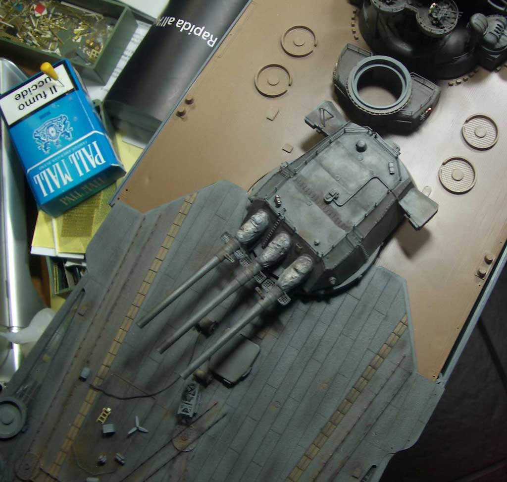

I am getting to the aircraft deck on my Yamato model. Can anyone point me to a close up photo of the upper surface of Yamato's aircraft deck? I am trying to resolve the texture and color of that deck.
Most drawings do not show tread patterns on the aircraft deck except for, in some cases, a narrow clearly defined area near the aircraft trolley rails. In ATOS where presence of tread patterns elsewhere is invariable indicated by shorthand there are no sign at all that the drafter meant to indicate any tread pattern on this deck. The deck is obviously not entirely linoleum covered because there are clearly labeled linoleum walkways on parts of that deck. So is the rest of the deck smooth steel? Some models took pains to depict plating patterns on the deck to indicate bare steel. But short of clear reference proving this interpretation, I would find that interpretation somewhat unlikely as the Japanese appears to be in the habit of putting tread patterns on every bare steel deck surface. In any case plain steel deck would seem pretty treacherous in heavy weather. At least some references suggest the smooth parts of the aircraft deck is in fact covered in either concrete or asphalt, and the aircraft deck as a result is actually significantly darker than Kure gray.

Re: Calling all IJN Yamato & Musashi fans
I've heard of concrete being used on the a/c handling deck on several occasions but cannot find a corroborating source. OTOH, bare steel seems unlikely as well.

I still have no clear indication of any covering on the aircraft deck. Would concrete's thermal expansion coefficient be sufficiently close to steel so that a concrete layer on the aircraft deck would not delaminate from steel in extreme weather?

Apparently, Skulski and AOTS Yamato is the source for stating that this portion of the deck was covered with concrete. Reinforced, I think was the expression.
While concrete as we typically think of it would not suffice with regard to delamination, I imagine that if it were mixed with some latex (like Shinano, IIRC), then perhaps it would work. Just a thought.

I would not imagine a thin layer of concrete would add much structural strength to the steel deck. I would be puzzled by the addition of concrete layer unless it is added solely to provide a smooth and yet non-slip surface that would allow wheeled vehicles to be pushed around. Steel deck with Japanese style raised tread patterns could still impede the wheels of things like engine test stands.

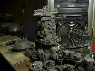

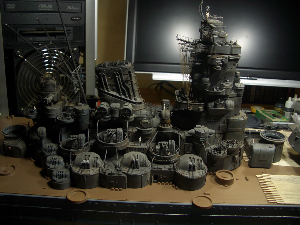

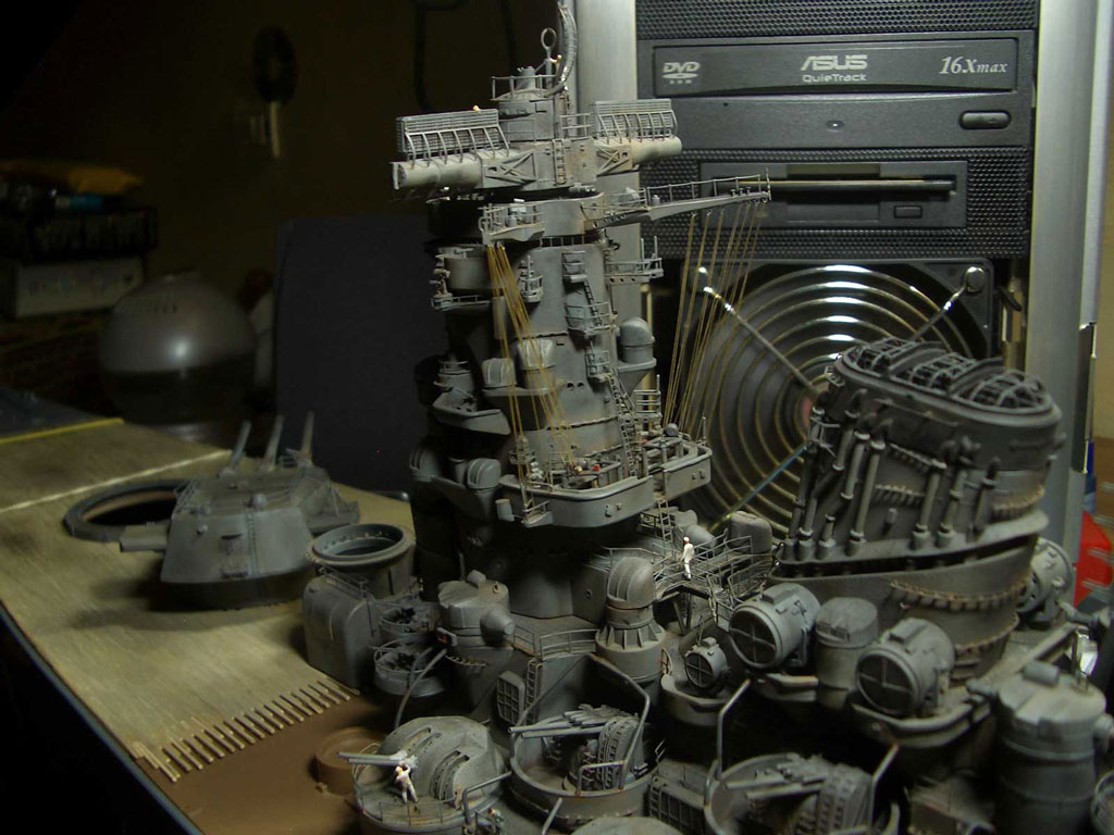

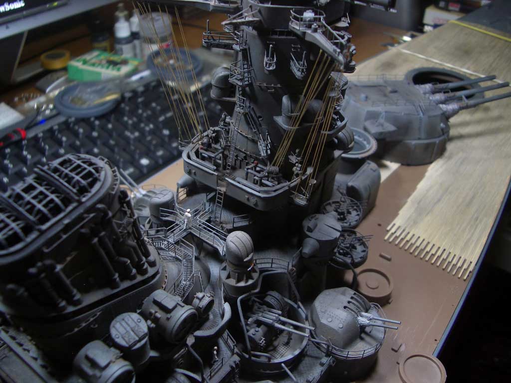

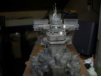

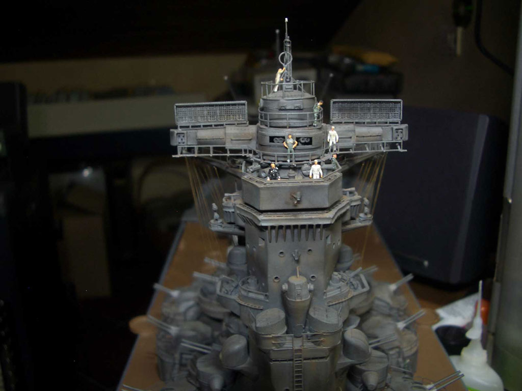

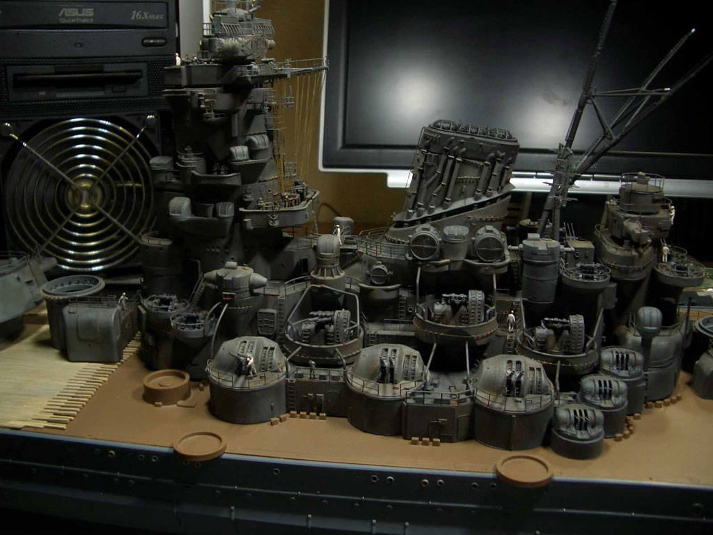

Hi to everyone. Some photos of my "work in progress" Nichimo 1/200
- Posts: 9117
Nice pics.
