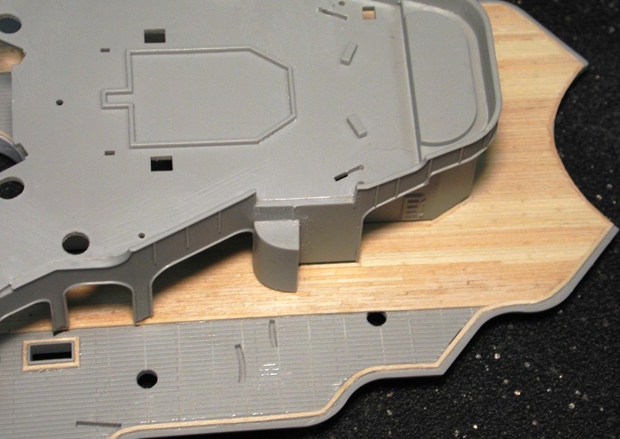

For anyone who may be interested I am posting some progress photos of the deck planking on my model. I am using .02"x1/32" (about 4" x 6.25" in scale) bass wood strips. I cut the strips into 1" planks and then offset each plank 1/4" to get the four butt shift at the ends.
I started with the boat deck. The first step was to install margin planks around the perimeter of the deck and at the major bulkheads, fittings and openings. The deck perimeter plank is a single piece on each side that was glued down in segments and moistened and bent around each of the curves above the 5" casemates in turn. The funnel opening is too large, so I added a thin strip of plastic around the inside of the opening and then glued the curved margin plank on top of that. The bass wood is fairly easy to bend after a good soaking, if you are carefull and go slowly.
The margin planking is the slowest, most tedious part of the process, planking open sections of deck actually moves pretty quickly. When the entire deck is laid it will get a light sanding to even up the surface and eliminate any excess glue, then a light stain and sealant. I am backdating my model to the mid-thirties time frame, so one advantage of the wood planking for me is that it will cover the grooves in the deck for the 5" DP gun tubs, which had not yet been installed at that time.
