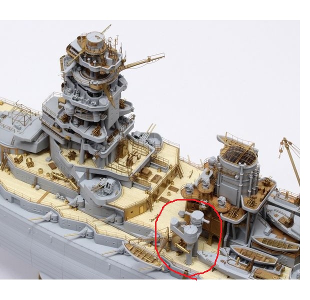

I'm stealing this photo from an earlier posting for feedback on the 1933 Nagato kit:
The midships rangefinders appear to be on a solid structure, rather than:
I'm fearing Aoshima made the platform "solid" for Nagato by simply using the Mutsu image as evidence. I can still correct a '33 Nagato I'm working on, so I'm hoping to get a resolution to this issue.
Thanks!
Thanks!

Re: Calling all IJN Nagato class fans
I'm not certain those rangefinders appeared until after her first modernization of 1934. You may be confusing them with the searchlight platforms errected around the funnel.

The rangefinders are present in the 1933 Aoshima kit. Your comment that they weren't even present during the modeled year is also a possibility I've considered. My next question: is Aoshima's 1933 kit more accurate to her 1934 fit? Were the 127mm guns installed at that point?
Thanks!
Thanks!
From Combinedfleet.com:
1932:
Four twin (4x2) dual purpose 5-inch (127-mm) HA guns are installed. The existing 3-inch (76-mm) AA guns are landed. Four 40-mm/62 Vickers AA guns (2 x 2) are also added to the weather deck.
1932:

Wouldn't the rangefinders have been added at or around that time? If they need to be deleted from the build, that's fine. If not, is the shape present in the Aoshima kit correct? The TROM isn't clear.
I've found evidence of the searchlight platforms present on NAGATO, but the photo of MUTSU with her twin funnel configuration and midships (127mm?) rangefinders present seems to be the only time I see all these features in one place.
I'll try to remember to check the Ishibashi BB book tonite. Maybe that will have this configuration in it.
