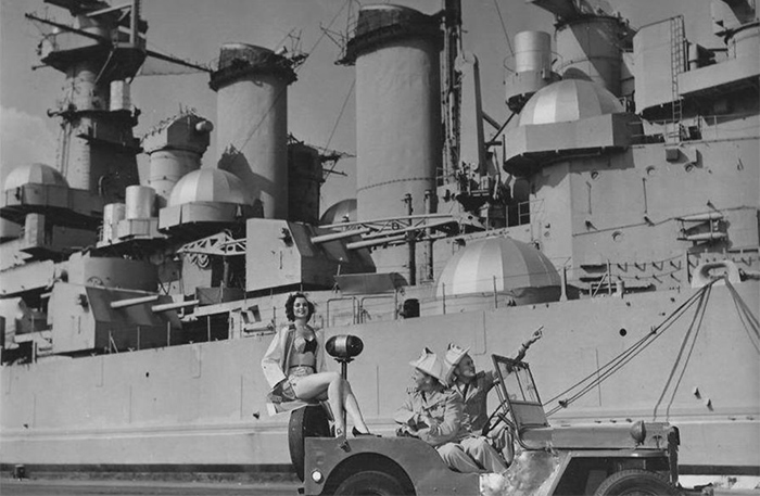

Matthew - I was trying to do something like this reference photo:
But it is difficult to simulate something natural which will be visible after 3D print - otherwise you might get just flat surface.. I have had very precise 3D model of bags as on picture above but could not print them. So - I over scaled and exaggerated the bumpiness and shapes in order to achieve something 'similar'

I am amazed at what you guys can do with PE microsurgery in a small scale. That said on my monitor your 20B Deck Blue looks quite brown. Monitors vary.
As to the 40# STS side plating above the external armor belt, This construction appears to be similar to that used on many ships of the vintage, including the Alaska's and Iowa's. The two horizontal plates were as far as I can tell welded and reinforced with a semi flush vertical reinforcing strake at the end butt joints. Except at close range or by running your fingers over the strakes, it is almost impossible to notice the riveting. The strakes are actually quite narrow, perhaps 16" or so in width. Perhaps someone with access to the North Carolina can give exact dimensions.
See attached photo:
