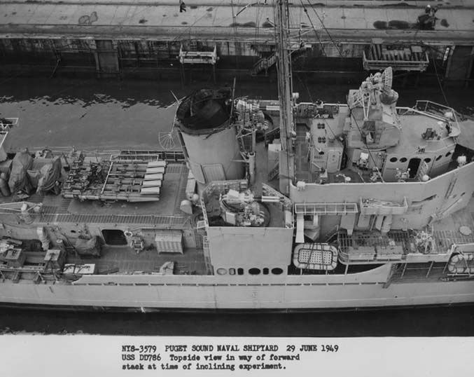

Anyone have a plan or series of photos that shows the locations of the exposed ventilators and ducting on the Gearing DD FRAMs?

Can I help? Do not know exactly where these vents are.............. tell me more.......... Jimmy

Jimmy:

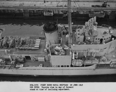

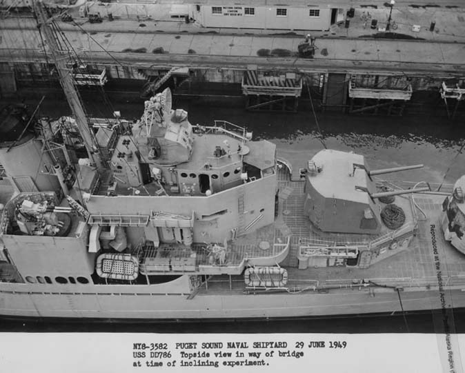

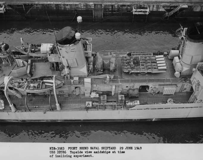

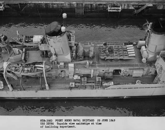

Here are some photos that show examples of the type of vents and trunking that I cannot find Gearing FRAM photos for. My plans do not show them.
The pics are Gearings but not the FRAM conversion ships.
Upper deckhouse just to the left of the door
http://www.navsource.org/archives/05/0583109.jpg
Just aft of the funnel, and just in front...
http://www.navsource.org/archives/05/0583108.jpg
Just forward of the starboard 40mm mount.
http://www.navsource.org/archives/05/0578618.jpg
Just aft of the whaleboat stern
Mr. Wizard

That's because NavSource does not allow hot-linking to their site. Some of the same pictures can be found on the Naval Historical center, which you can link to:
Posts: 8571
Re: Calling all Sumner/Gearing-class (DD) fans
And some of the other images:

Jimmy:
Its been awhile. I have linked a couple of Sean Hert's Photos from this site that show the vents that I am talking about. There is a lot of great-detail in his photos, but they only match about 1/4th of the vent fittngs that I have to install. I hope these attach okay. I could sure use some help in locating where they all go.
Under the 01 and Bridge decks
http://www.modelwarships.com/features/w ... 50-03.html
On the 02 Deck, just outboard of the the Aft funnel and forward of the red-shapes (looks like the head of a candy cane, gray of course)
http://www.modelwarships.com/features/w ... 50-07.html
Under the Aft Deck house on the 02 level
http://www.modelwarships.com/features/w ... 50-10.html
Thanks
Mr. Wizard.

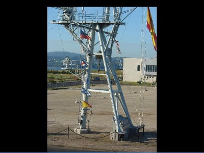

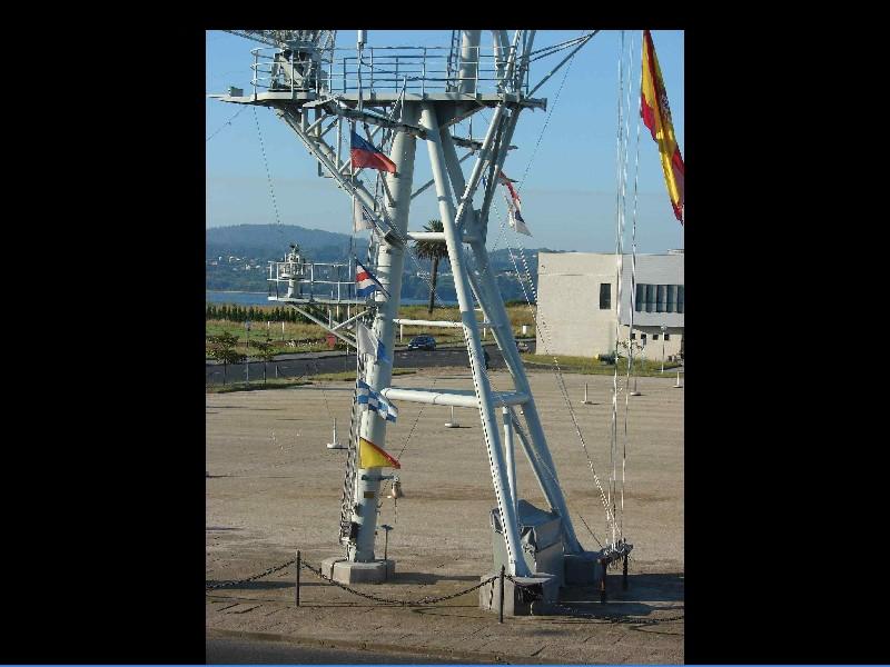

Our dearest friend FRANCISCO PERES DE NANCLARES took these pictures of the mast of a GEARING destroyer framed , and so I�m posting here. Hope it will help someone to detail some Gearing mast in a model building....... see the photo of the plate that tells the story of the ship......... hope you enjoy!!!
FRANCISCO: Thank you very much!
Nice regards: Jimmy
