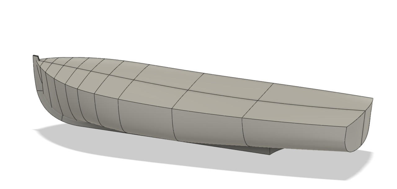

In fact I just found my mistake about my firt print, the barrel tube was hollow and therefore very thin, hence the collapse during printing, yet I had checked ... it is by increasing the scale to 1/48 directly with Chitubox, the program that generates the file for the printer that I realized the thing, I will reprint to be compliant.

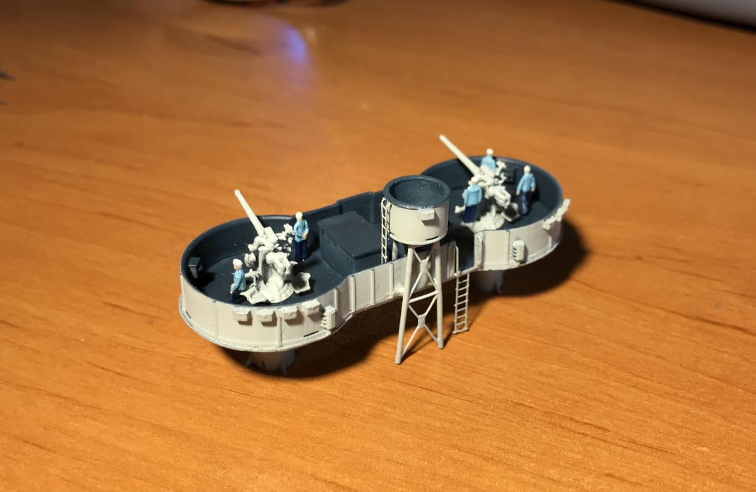

I'm dragging my heels a bit at the moment, I spend a lot of time on the guns, because there's not much 1/200 on the internet for me, even at Shapeway, it's not very good in terms of definition, so I'm sticking to it.

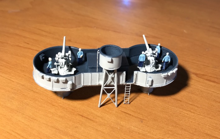

I start the design of the 3 inches / 50 ( 76 mm) guns, they are placed (2) on the front platform and 2 at the back of the ship. A new big job, but I have what I need in docs.
Here is the latest version of the 40 mm Bofors. I have already printed a 1/48, the printing is superb, but then I took the drawing again to add some details it was missing a little bit.
The 1/48 test.
The big and little brother...

The documentation I retrieved to draw it, it is more complex than the 40 mm Bofors.

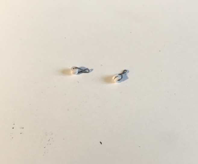

I received the anchor chains, I had to redrill the stopper holes, not easy without breaking anything, but it's good, it looks good. There are still the anchor grips to make.

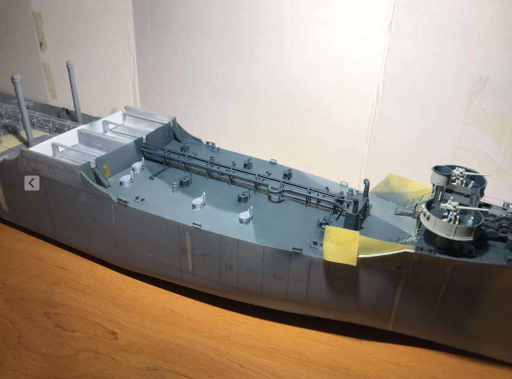

The front gun platform is finished, I'm waiting for the NorthStar firing director, it's not easy to get it from them!

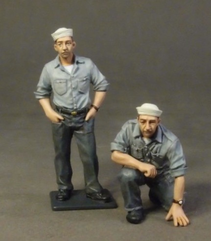

For the colours of the work clothes, I was inspired by these nice figurines. Colors will be corresponding after weathering.

I don't have any dungaree shirts or trousers around any more. Dungaree trousers about the same color in service as somewhat washed and washed Levi's, not a really dark blue. The shirts usually fade to a pretty light blue, without a lot of saturation. It's a nice touch having a number of crew members visible on the weather decks.

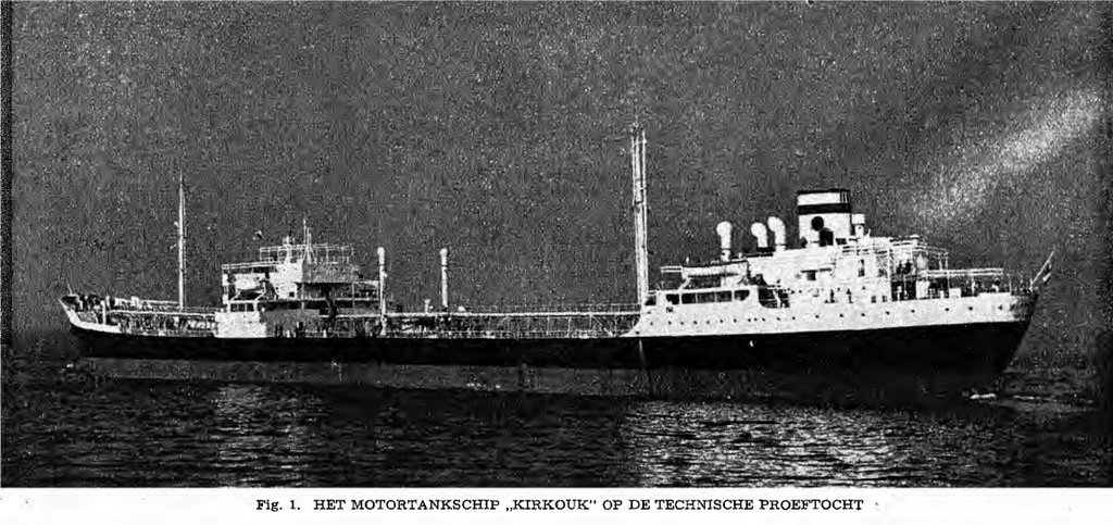

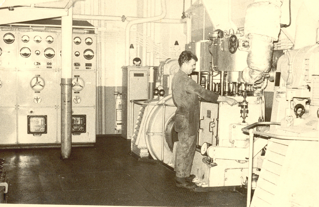

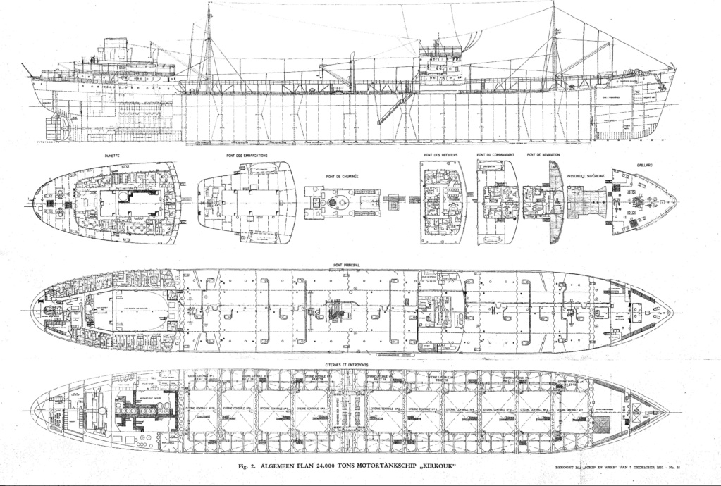

My father in the engine room on the french tanker "Kirkouk" built in Holland/Amsterdam after WWII for TOTAL (CNP), he was second engineer , main engine wad 2 strokes diesel engine Stork, seven cylinders.
1964:
Steam generator, setting the speed regulator.
Cylinder heads platform.
The "Kirkouk" in Algeria, 1956:
T2 clone, but bigger, Diesel engine.
September 5, 2020.

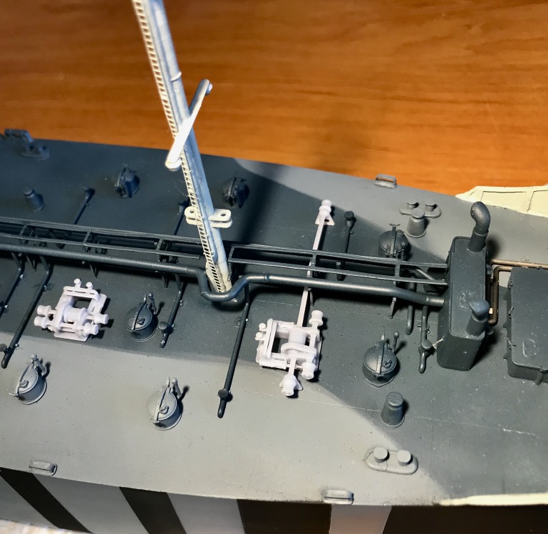

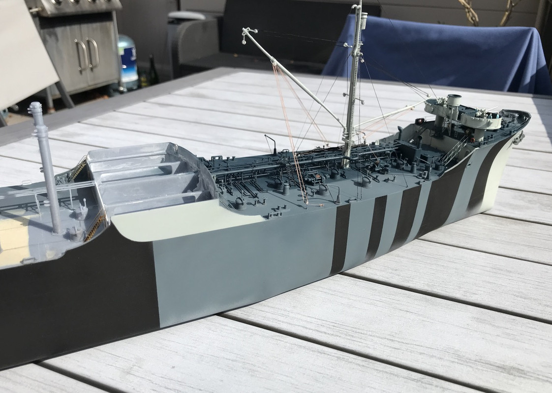

I started to install the piping that is supplied and of different sections, Ervergreen tube, piano strings, everything goes through it, that's what will give finesse to the details for the bridge.

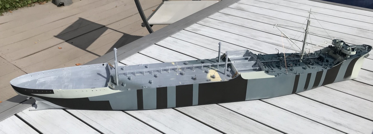

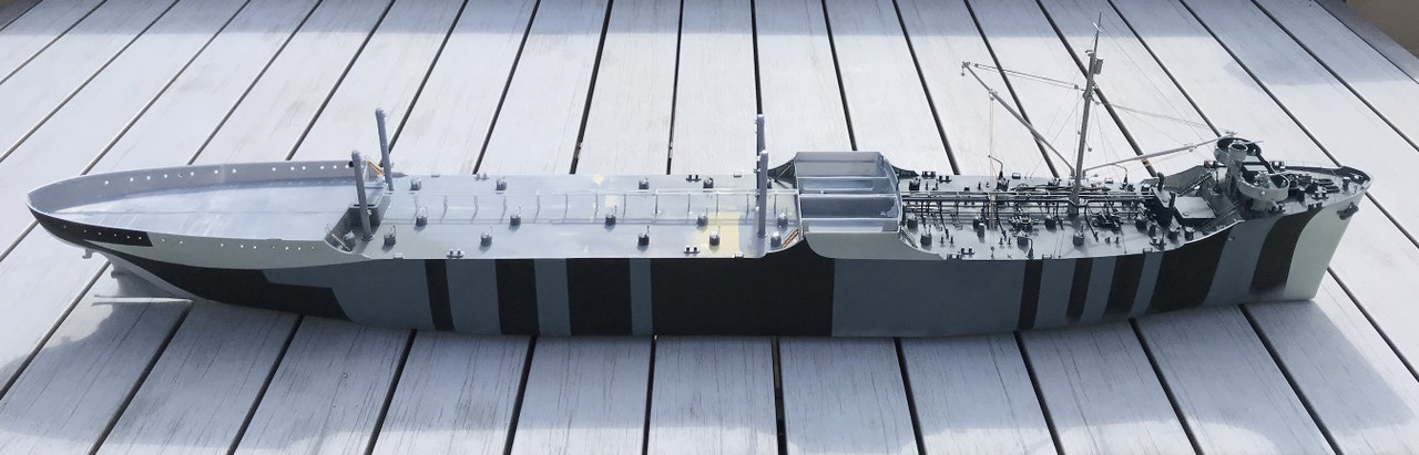

I am now struggling with painting, a dazzle is always complicated and long to paint. I also made progress on the front pipes, but I still have some to install.
I started painting to find the right method. Black is Tamiya, easier to apply than LifeColors. There will be an antifouling, there was USN red or black.

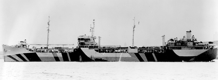

On the Dazzle measure, there was no antifouling, but I think they didn't bother to represent it. On the photos we can see that it does not mount very high along the hull so that the camouflage remains effective, probably, on light ballast.
USS Tamalpais (AO-96), veterans of the tankers pose in front of this very beautiful model, we can see a paravane on her launching mast, it will be reproduced also but at the sea station, although..:
USS Mascoma (AO-83), Paravane at the rack.
USS Tamalpais (AO-96) - You can see the black strip (boot-topping) and the red antifouling .

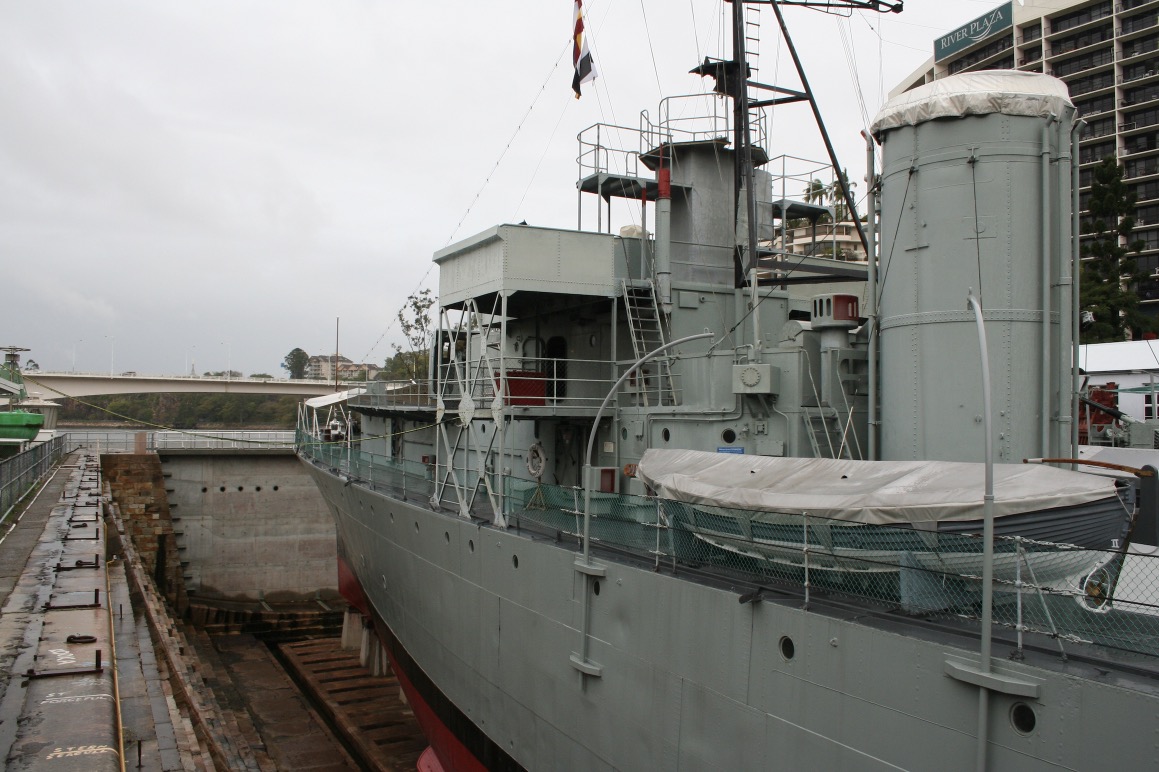

Black here on the Pamanset, or just a black stripe and red underneath? This is also a possibility.
USS Sebec (AO-87) (1944 - 1946), but same "Escambia Class" series. San Francisco bridge behind. USN Red antifouling probably.

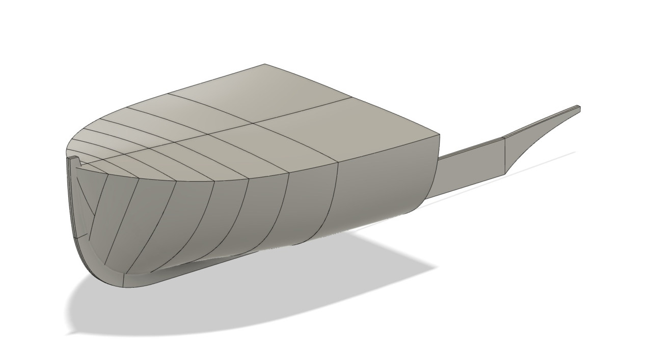

I have kept the hull defects, I could have erased them as elsewhere, they will be useful for the application of the patina, the bow plates are often deformed by the pressure of the waves... This can be seen on the photos above.

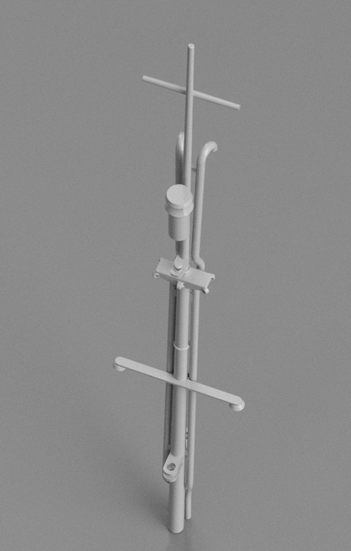

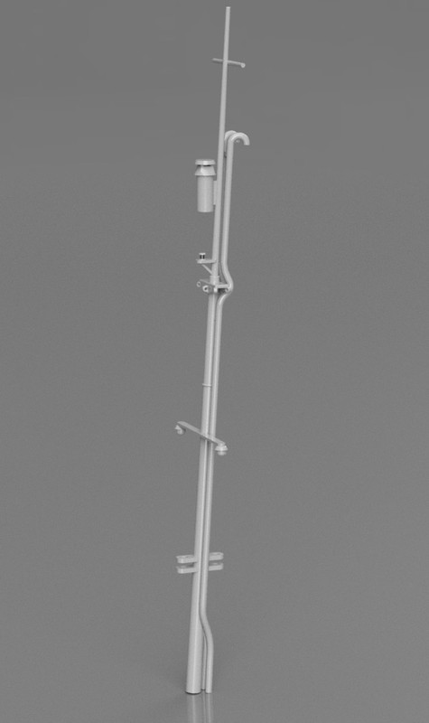

Drawing of the foremast, 3� backwards inclination, with its crow's nest and the hydrocarbon vapour discharges from the cargo tanks, the ladder to climb it will be in PE and also the winches for manoeuvring the cargo derricks. I have simplified it. Not too many pictures of the machine.
This one looks a little bit like it, I could be inspired by it.
I don't have this documentation when i started to draw:
In two pieces to shorten the printing time, 13 cm high in total.

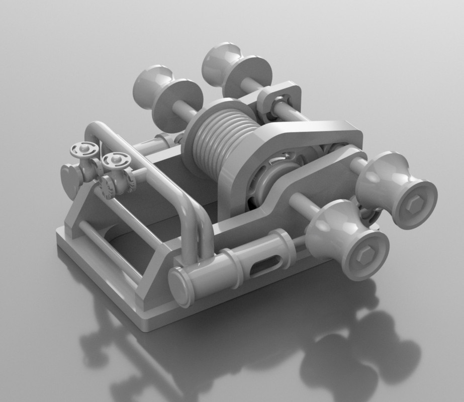

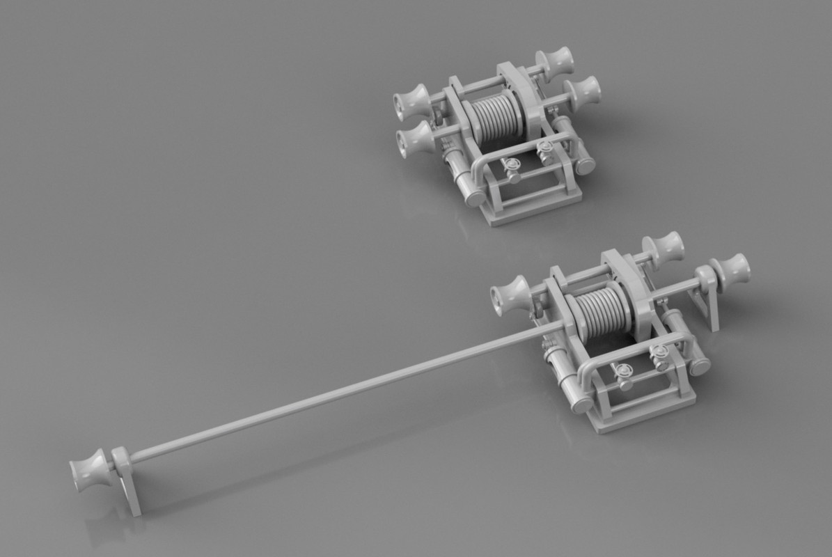

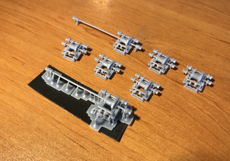

Successful printing for this winch declined in two versions, the valves are well printed as well as the rods of connecting rods, the forward mast too. I printed some more. I have the steam supply pipes made in Evergreen.

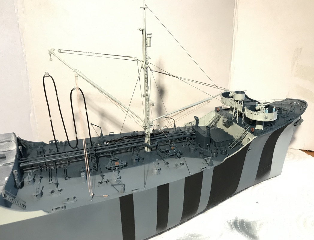

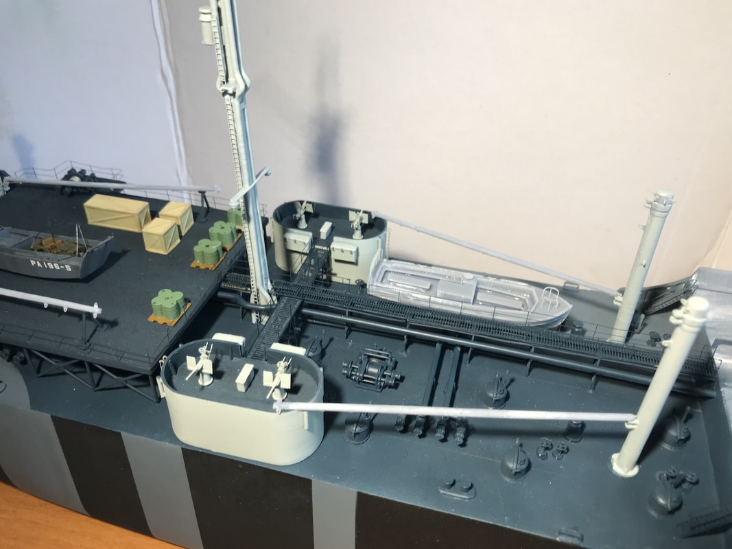

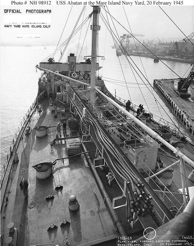

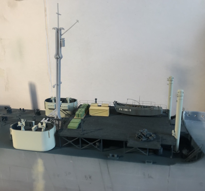

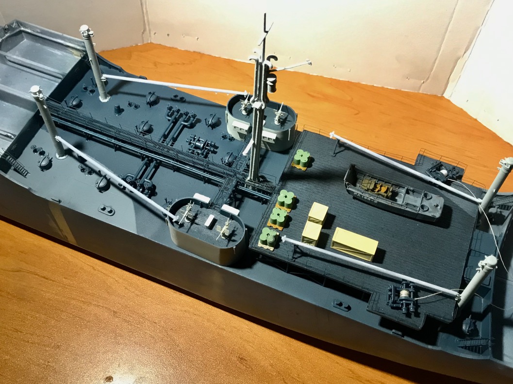

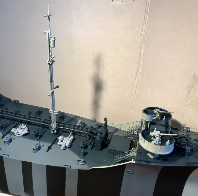

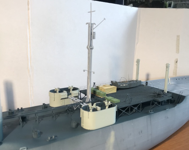

I continue on the details of the foredeck, mast stay cables, crown buoys, dome of the forward bunker tanks, add many steam pipes, install the winches and their piping, 2 drums of supply hoses.
Northstars finally sent me the M51 firing directors... It's coming out in dribs and drabs at their place...
Dome of bunker tanks and deep tank. Turrets. Hoses and their supports

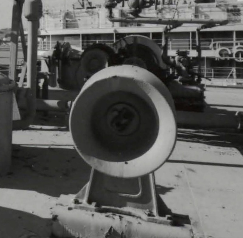

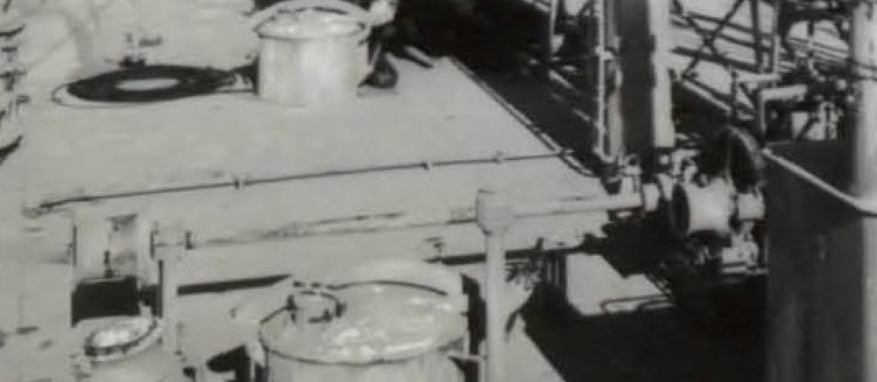

Cardan valve handwheels.
These valves are at the bottom of the tank on the suction pipe of the petroleum product.
There is a large main line valve and a stripping valve, a smaller pipe that goes down to the bottom of the tank. A rod system with cardan joints mounts flush with the deck to close or open them.
I've seen this system still present on coasters from the 1970s and 80s, a horror to maintain.
Quickly replaced on newer vessels by hydraulically operated valves.

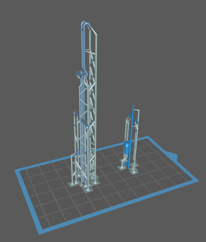

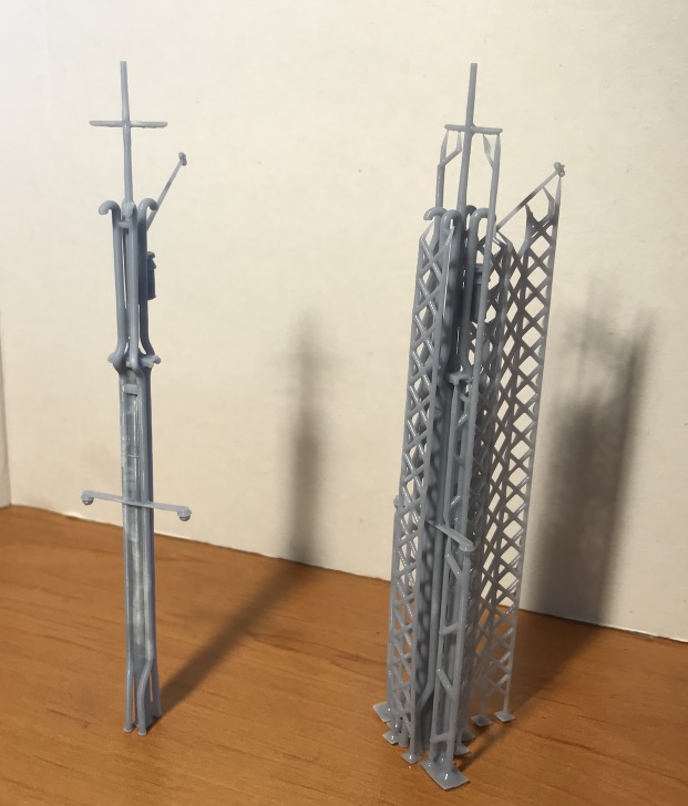

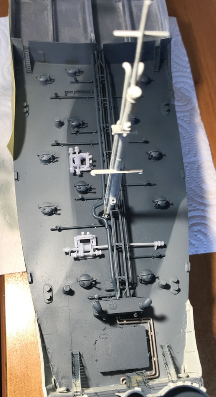

I started the drawings of the 2 cargo masts, and the 6 small ones along the rail.
Printing of the 2 front lcargo masts booms, of different lengths, and the small masts along the beam, there are 4 of them, there are 2 more at the back in front of the middle castle intended for the launching of the 2 Paravanes, I haven't drawn it yet because I lack information on their exact shape, but it's on the right track.

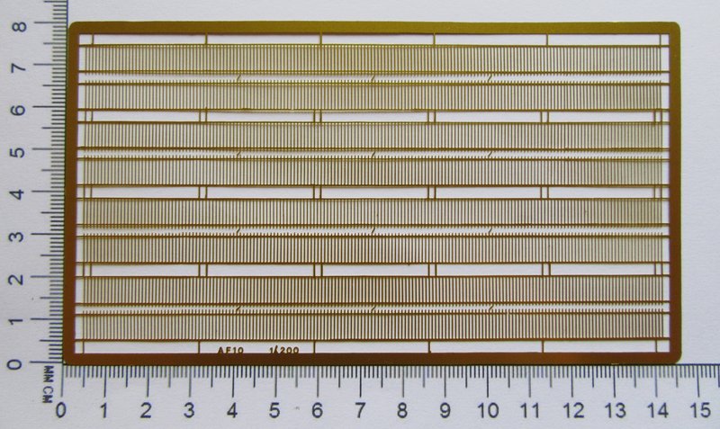

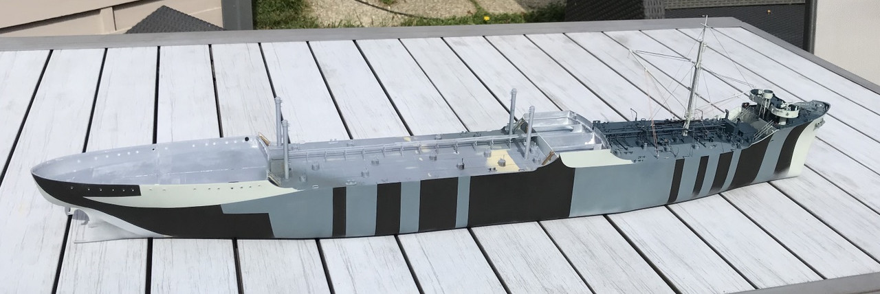

September 20, 2020:
I made good progress during these two days, especially on the rigging.
I bought a good tool to make "small holes", it's expensive, but great and for life.
It allowed me to make the pulleys.
The rigging is not finished, but not far, at least on the front, I still have the lifting cables for the hoses to mount.
I also have some hoses still to be added including a port / starboard manifolds, the forward hose was connected to it in operation. You can see it on this picture of the AO81. This photo helped me a lot.
A few pictures, under the Breton sun, of the progress of the starboard Dazzle scheme, almost finished, there is a comma missing at the stern, painted this evening and maybe an addition to be made at the bow, depending on the height of the antifouling.
I'll be able to start the port side paint in the next few days, then the antifouling.
Just added what was missing on the starboard dazzle, this side is finished. A few little touch-ups to do and it will be perfect.
Added the masts for the launching of the paravanes, I integrated the pulley, it's not bad, I just had to drill the hole to pass the wire, 0.3 mm drill bit ...
Creation and printing of the two forward manifolds, the manifolds allow, the connection with the ground or another ship to load or unload the products.
On some ships, they can be sophisticated enough to allow several combinations of connections depending on the shore installations, never identical because several products can be loaded/unloaded at the same time .
The most provided are on chemical transport vessels.
Received the shooting director M51 from Northstars Ukraine, of the beautiful work, it is very fine, very fragile, comme counter weight are broken, I had to separate the operator from his machine for painting, too bad it is not made of origin.
I also received some grids that can be used as a footbridge (Pass) or as a station barrier, luckily it was exactly at the desired width, a stroke of luck, it's pretty sturdy, which allows to glue the railing easily, just cut the small arrows at the end of the uprights with scissors. It looks really good, I've already seen this kind of openwork plank, what's nice is that you can see the structure underneath.
I found this PE board in England a few days ago. They are the only ones who make and sell this reference.
https://www.scalelinkfretcetera.co.uk/product/slaf10/
So I installed this pass, and also, the removable gangway that allows once lifted to open the front hold panel.
I'm starting to get some dust on the deck, a cleaning is necessary...
Finished the central walkway, I'm waiting for stairs ordered at L'Arsenal 2.0, I don't have enough, but not available, it's going to be long.
Started the Dazzle Bd scheme. The starboard forward railling is installed.
Printed the aft mast. 12 hours.
Raw formwork, paint earlier, I painted the central bridge last night in 20B, the 5O parts to be painted according to the Dazzle scheme.
There will be some camouflage paint additions to be done on the platforms of the Oerlikon 20 mm.
Nothing is glued.
October 9, 2020:
As expected the rear part of the main deck is progressing well. The deck under the platform is of course equipped.
Nothing is glued.
October 9, 2020:

The hole punching device is interesting, I had not seen one like that before. In the larger 1:120 scale I could use a regular hole punch plier used by leatherworkers to make the hundreds of blocks used on an APA. For 1:200 a smaller tool would be needed!

On the port bow of this part of the deck, I could see a utility boat, as can be seen on some of the photos.
I found this site very interesting with different models of USN boat. Still to find plans...
https://www.okieboat.com/CAD%20boats.html
Service boat Mk 2 , 40 feet.
The 40 feet service boat was most often used to transport naval troops between the ship and the coast.
The benches in the middle could be folded up and moved to the side to allow the boat to be used for transporting goods. It was sometimes used to transport equipment and other personal effects purchased in ports to the ship. It was stowed on the deck of the harbour boat, with the 28-foot personnel service boat nestled above it.
The 26 feet with a small roof at the bow appeared to be stationed as a lifeboat on the Pamancet from a photo:
I'm going to "pump" this davit plan it's perfect:

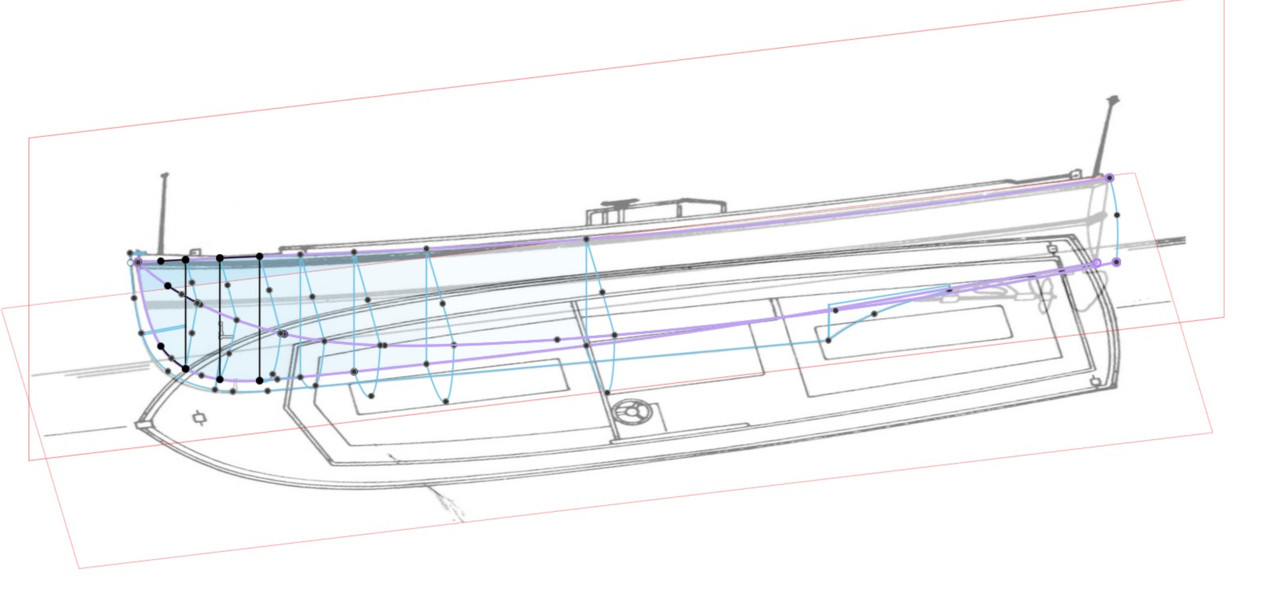

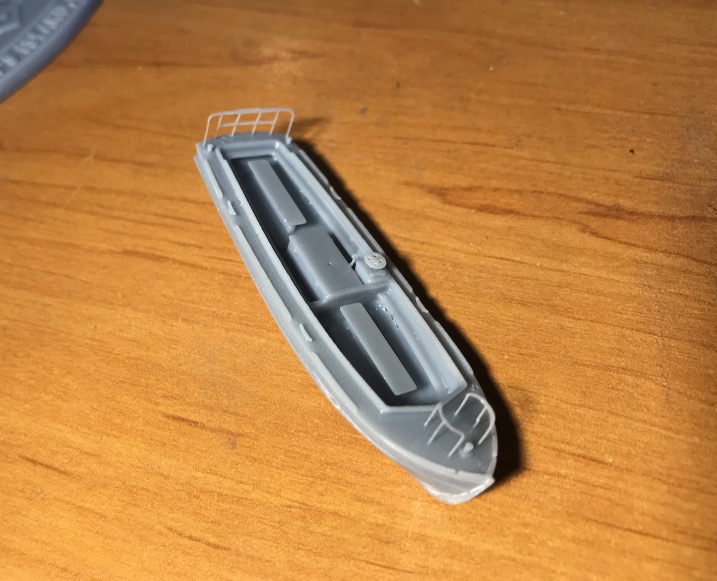

October 7, 2020:

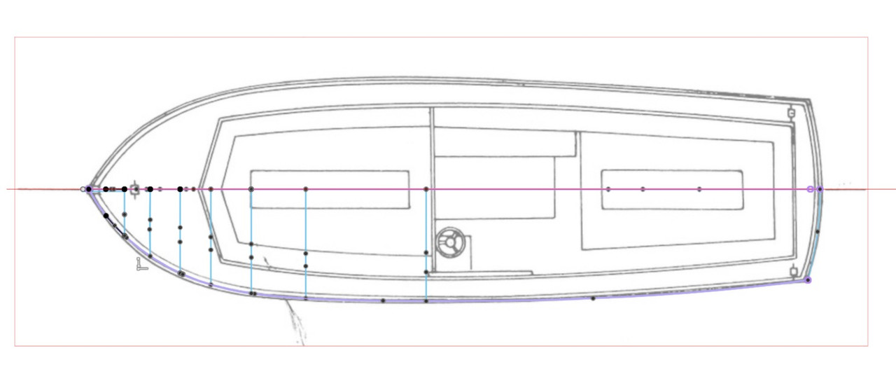

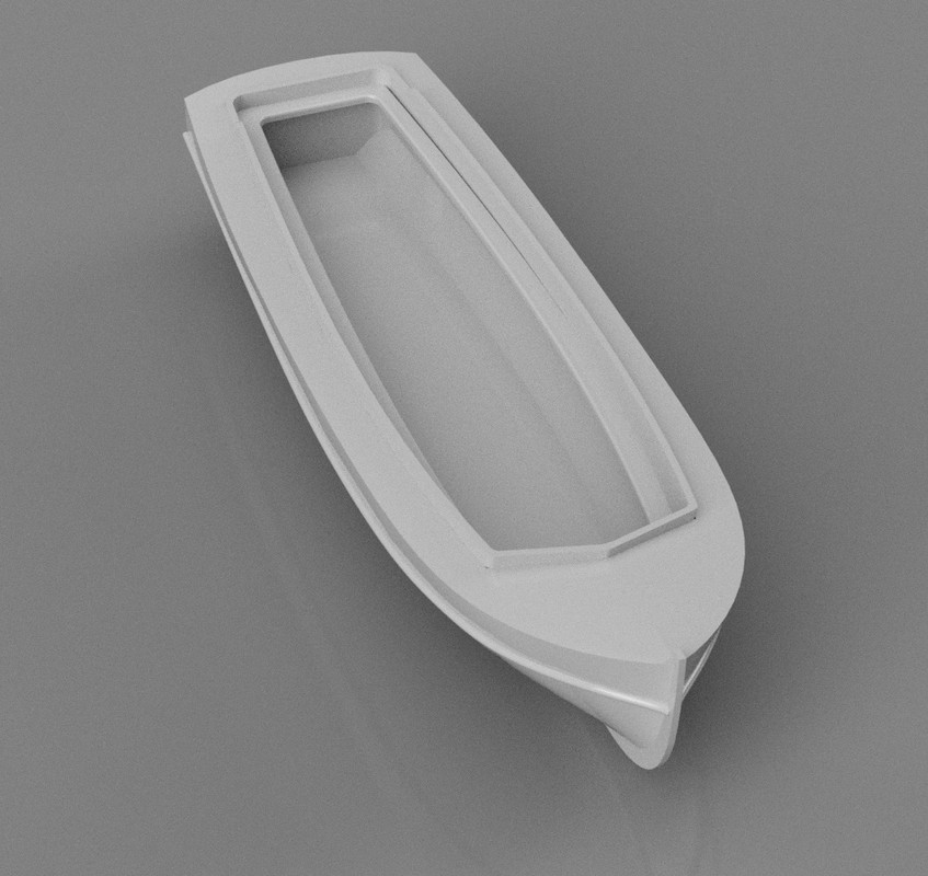

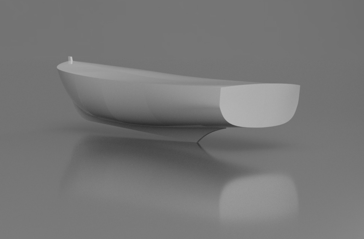

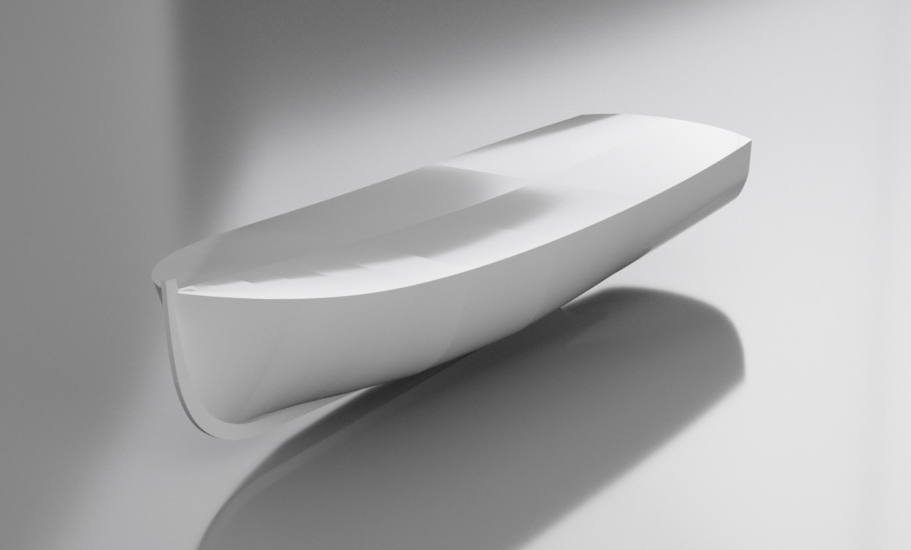

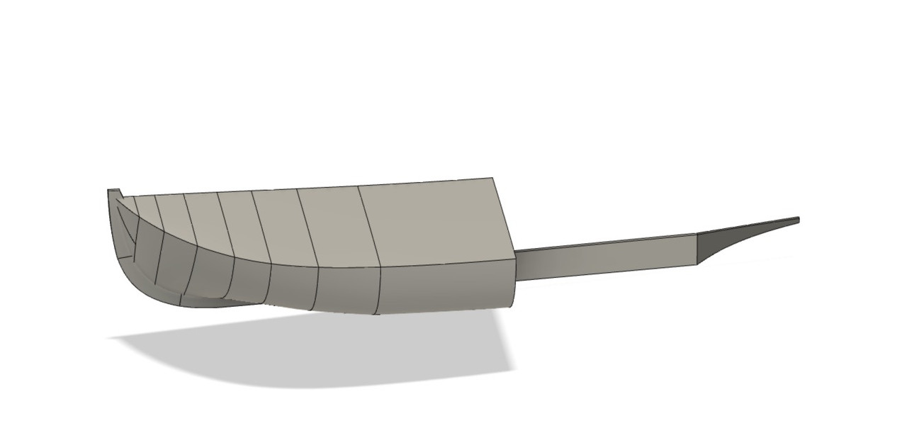

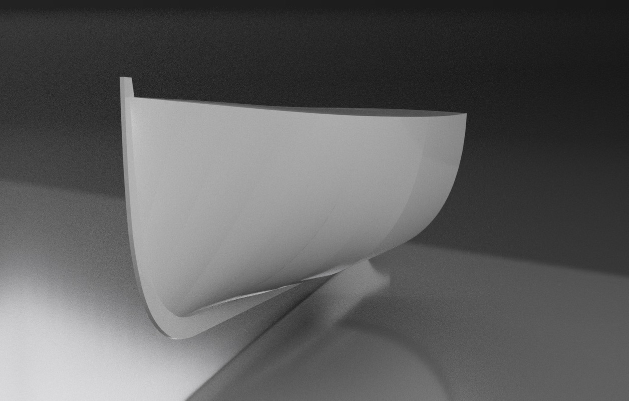

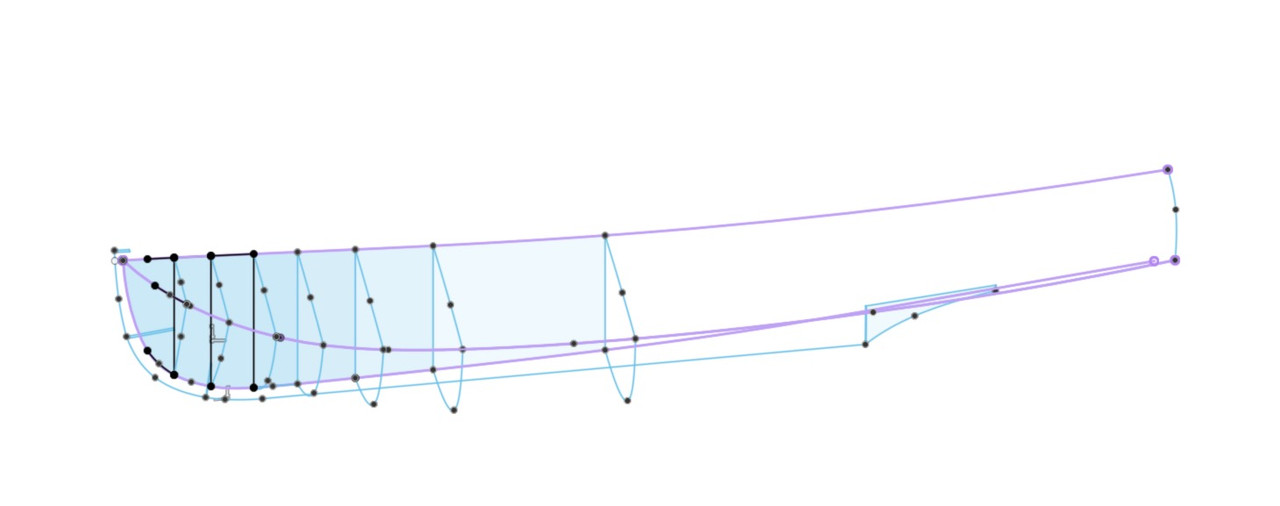

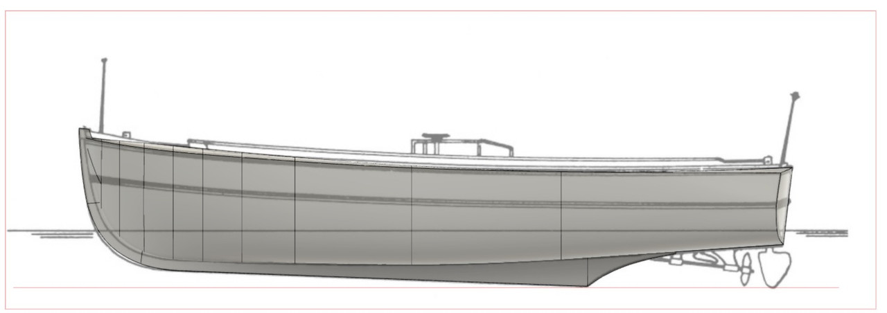

I started drawing the 40 feet (12 mts) the motor boat this evening, still using the half-hull method, it should go pretty fast, i have not the hull sections plan, never mind..:
October 9 ______________________
The design work is complete for this USN 40 feet utility boat. The cradle remains to be drawn to place it high on the deck.

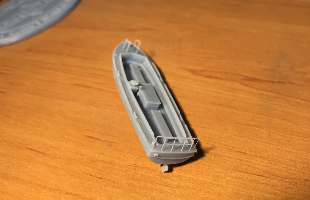

Printing tomorrow.
The boat did not come out too badly, I was a bit worried about the 0.3 mm railing.
One more piece of the puzzle!
But I reprinted two of them, I was not totally satisfied with the 3D printing side.
The new ones are better.
Printing of the ber is finished.
Height adjustment in relation to the bridge to be carried out with the cutting pliers. Painting tomorrow 20B.
5O paint.

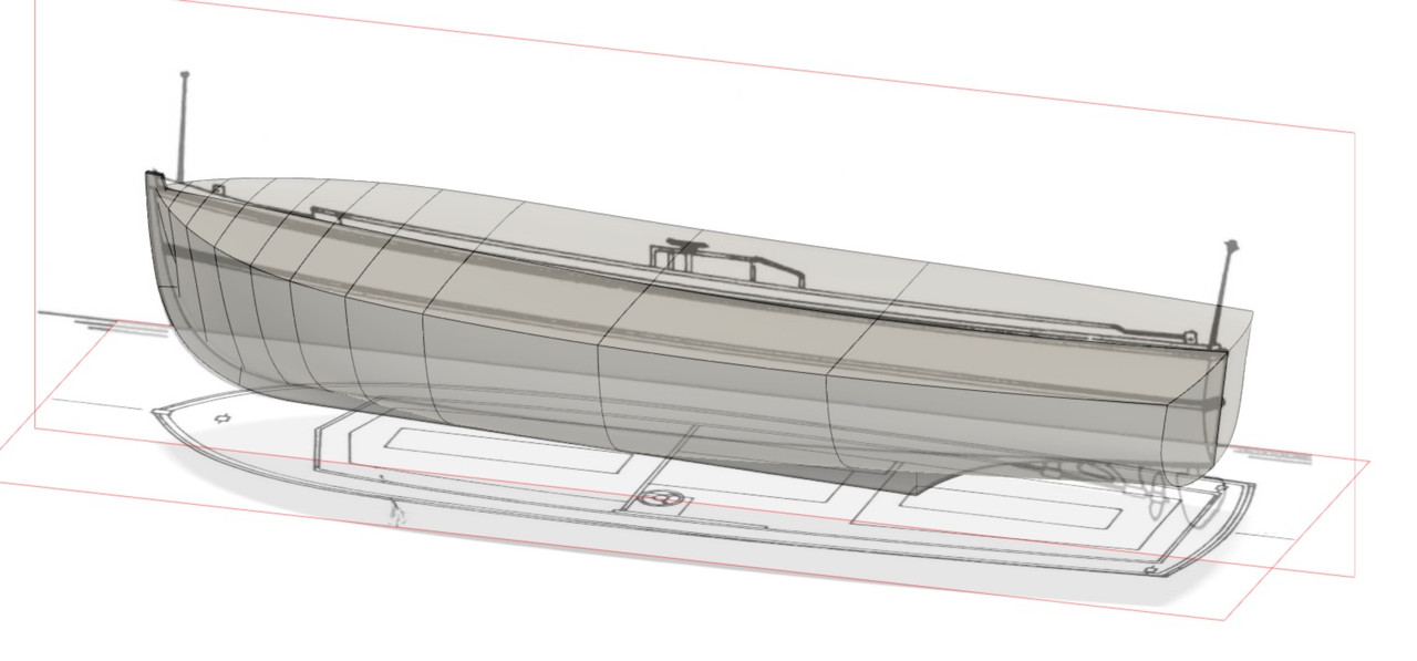

October 7, 2020:
Printing tomorrow.
