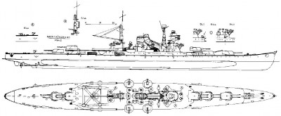

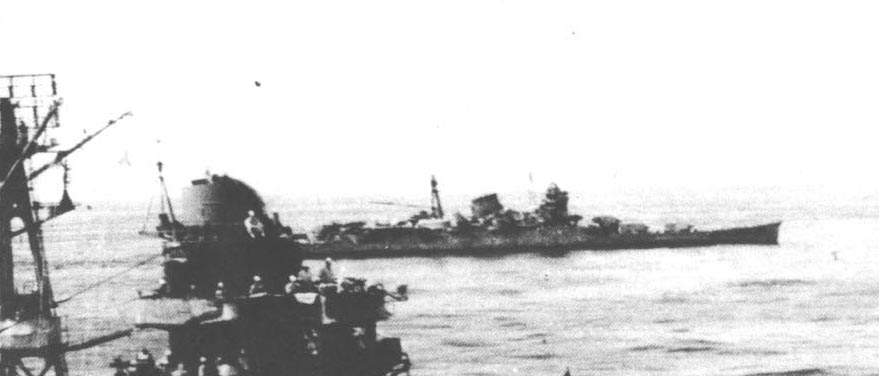

Unfortunately, late war closeups of Suzuya are almost non-existant. The photo below is a crop from the view of Tone refueling from a tanker during the Battle of the Phillipine Sea with Suzuya in the background.
There is a drawing of Suzuya or Kumano in the Model Ship Modeling Special on this class - as with the photo below, there is an enlarged platform for carrying the 25mm mounts at the base of the bridge and it has gained some support columns in front.

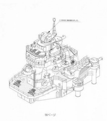

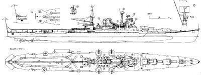

From the Model Art SMS vol. #8: bridge structure views of Mogami/Mikuma as built, top left, Suzuya/Kumano as built top right, Kumano, late war bottom right.
The revised AA platform is very similar to the late war Mogami's but not identical, IMHO. Illustration also does not show ammo box placement.
About the degaussing cable for Suzuya, late war, I'm inclined to believe she retained it. She was never brought in for major repair or changes so, it 's likely to have been left on.

Thanks a lot, Dan. The drawings you posted confirm my previous feeling that the AA platform on Suzuya/Kumano seemed to be a bit smaller and one level higher than on Mogami.

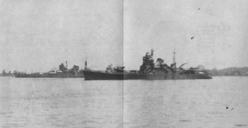

I can post one more late war photo of Suzuya but, it's not detailed enough to reveal anything about her bulges, degaussing cable, or much else. She's on the left.

Actually no, the first drawing that Dan (Thank you Dan btw.) that post is too simplistic. IJN Suzuya and IJN Kumano main difference from a IJN Mogami's main bridge after 1944 is that circled area.
The so-called crew rest area, added after the increase of AA guns:
In IJN Mogami that area was bigger in size (red circle). While the one under the enlarged AA platform (blue circle) was same as in IJN Kumano and IJN Suzuya. The height was also the same.
One more difference not showing in the first drawing, is this area (at least as-built and early in the war), the orange circle:
Tamiya's 1/700 IJN Kumano and IJN Suzuya have this difference from the IJN Mikuma.
