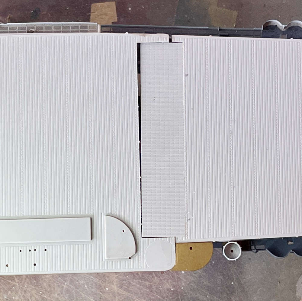

...and we have a problem. At this point, I have all of the walls around the hangar deck on the starboard side glued on, and I'm about to start on the port side. I did a test fit of the flight deck today (as I do almost every day) and noticed a problem: there's a big gap on the port side where the two halves of the flight deck meet, but not on the starboard side. So it's like the flight deck is 'bent' at the joint. I'm a bit puzzled as to what could have happened. So far all of the parts supporting the flight deck went on fine, no real fit issues, and the slots in the hangar deck are such that you can't really put the parts on in the wrong place.
So this problem needs to be fixed at the source, with the parts supporting the flight deck. The wedge between the two parts of the flight deck is pretty huge, and would be hard to fix in a way that's not obvious given the planking on the flight deck.

In an attempt to understand my flight deck problem, I temporarily glued the two halves together using two straps of sheet plastic. The whole LONG piece is pretty floppy, but they can't shift or shear relative to each other. I quick test fit of the unified flight deck suggests that the walls around the starboard side of the hangar deck might be tilted inwards a bit, towards the port side. That's pushing the middle of the flight deck to port, causing the bend. The way I think of it, the ends of the flight deck are pegged to the elevator wells, and the walls need to be in the right place relative to that reference line. I'll need to do some more metrology to see if this really is my problem. If so, I might be able to apply some He-Man strength and bend the parts outboards a bit to get them in the right place.

Hey Mike, I don't think applying he-man strength wil do the trick as the sidewall warp will probably return once you let the ship dry overnight. I suggest you use stainless steel strength. Put some steel spacers between the walls in places where they can not be seen and see of the deck will fit afterwards. Another trick I learned the hard way (I'm looking at you, HP models) is to put the model upside down on a flat surface and see if the sidewalls are warped in the vertical plane. If so, glue some sandpaper to said flat surface and start correcting it.
- Posts: 8561
Re: 1/350 USS Enterprise CV-6
I had the same problem when I built my Enterprise. After the fact, I think the problem was in the area highlighted by the arrow.
When you build the hangar, there is a gap between in the inner and outer bulkheads, which I didn't think belonged there, so I clamped it together. Apparently, that was a mistake on my part.
IMO, that is where I went astray, and where the gap came from.
I finished that kit about 3 years ago, and don't remember how I remedied the issue.

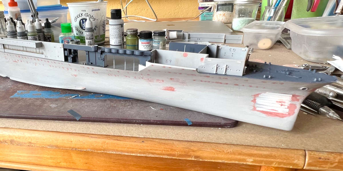

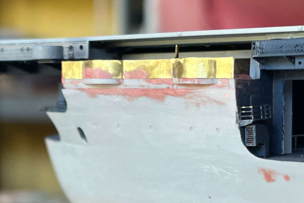

Moving up the port side, we get to the front of the hangar deck and the port side front 5" gun gallery. I ran into a few problems in this area.
First, part B8 (front most part of hangar deck walls, with the big roller doors) glued in a bit high and a bit forward, al least with regard to the hull sponson for the 5" guns. However, the photo etch attached to B8 is in contact with the hangar deck, so I couldn't put it in lower...unless that photo etch isn't quite in the right place... Out same the sheet plastic and putty to fill in the steps that were left. A lot of work is going into making it look like no work went in.
Second, the 5" gallery deck part was sitting too far forwards and too high relative to the hull sponson. I needed to trim off part of the aft wall, and the bottom aft corner to relieve interference with part B8. Maybe this part was sitting high since part B8 glued in a bit high. Anyways, all is well and this is ready to be glued in and then puttied like the others.
Mike

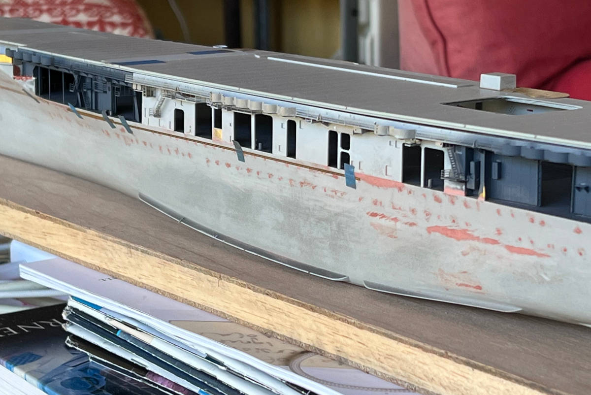

For some reason, I was quite eager to see the degaussing cables go onto the kit. After much ado, here it is. It went on fairly easily. I bent it at the ends to follow the curve of the hull, and used a bunch of little pieces of tape to tack it into place. Once I was happy, then I glued it down. There's a gap where the hangar deck catapult sponsons were, and I plan to fill that with the unused bits of the degaussing cable from the kit PE parts.
Another milestone is that the fore 5" gun galleries are glued in place. It took a fair amount of persuasion to get them in, but they're in, puttied, filed, sanded, etc. There's still a little of the putty-n-sand to do, but they're pretty much done. I've also added the catwalks around the front of the flight deck, and the flight deck still fits! This time, I did all of the work with the flight deck on the kit and everything inverted, thus adding those parts wouldn't affect the fit of the flight deck.

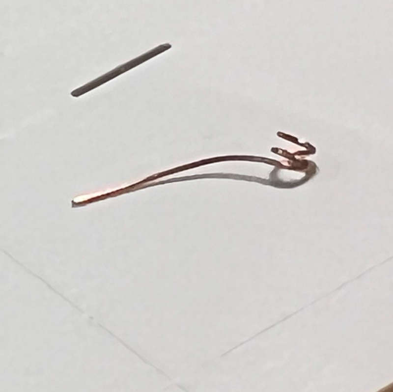

I vaguely recall someone mentioning that the rings at the very front of the bow were really bad. It was only after looking at a good photo of the area that the as-molded kit area started to bother me. Here's a comparison of what it's supposed to look like (please disregard the red circle...that's for something else) vs. what you get. The kit gives you two vague bumps, and those vague bumps are too far apart.
