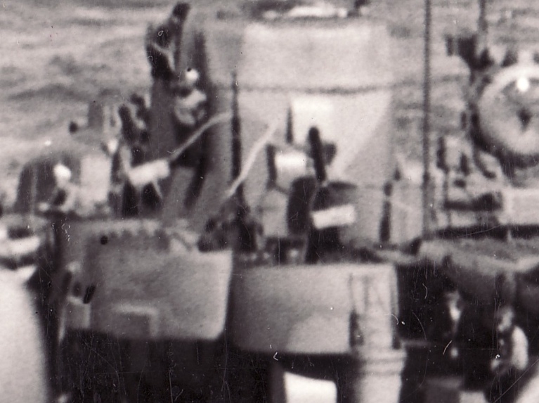

Attached is a close-up crop of the aft deckhouse view of the 20-mm gun added there
- DD436AftDeckhouse-19May42.jpg (100.67 KiB) Viewed 2931 times

Rick, when I first saw this Meredith photo, I thought that the projections atop the MK-37 were the initial installation for the MK-4 radar brackets. But if you zoom in, they are crewmen sitting on top the the director. She didn't even have the beginnings of a MK-4 installation when that photo was taken.
- Posts: 3882
Dick,
It was pretty common for the Mk 37 director guys to get "out" of it in the South Pacific. It had to be uncomfortable in there in the hot sun.
To be honest, I had not looked real close at this photo before this beyond hunting for 20-mm guns. My previous thought was that a censor had "removed" the Mk 4 radar, but the SC radar is still there. By June 1942, it was getting pretty late for her not to have a Mk 4 radar installed. But, the DesDiv 22 destroyers were kept pretty busy prior to Midway and didn't really have any extended yard periods until July/August (except for GRAYSON at MINY in May-June) 1942.
I have added this photo to my hunt list at NARA ... I'll see if I can get a better scan of this photo (and see if any "unidentified destroyer" photos of her are near-by in the box).
