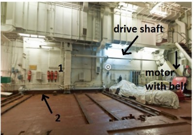

Kirov class helicopter hanger can hold 3 helicopters in line abreast. The elevator is in the center position. So the two helicopters stowed to either side of the elevator must be moved side ways onto the elevator before they can be raised onto the deck.
I am building 1/350 kirov class model based mostly on the ptoyr velikey. I intend to have the hanger open. My ambition is to make elevator doors and the elevator itself operable like on the real ship.
California Bound posted a few great shots of the inside of the hanger. There are several interesting things in these pictures:
1. There are raised rails running parallel to the length of the ship under the helicopter stow to the side in the hanger. This makes it hard to simply turn the helicopter's wheels 90 degrees and roll the helicopter side ways onto the elevator.
2. There are raised rails running athrowt ships on the hanger floor on the other side, where there are currently no helicopter in the pictures.
This makes me wonder exactly how is the hanger floor arranged. The raised length wise rail under the helicopter suggests the helicopters themeslevs can't be moved sideways onto or off of the elevators. The raised crosswise rails suggests something large is meant to be moved sideways mechanically.
So my guess is the floor of the hanger actually comes in 2-3 mobile sections, one under each helicopter storage spot in tHe hangers and sized to fit the elevator. When a helicopter needs to be moved onto the elevator, the entire floor section with the helicopter attached moved on crosswise rails onto the elevator.
Does anyone have any information to confirm or refute my conjecture?

Thanks. I think the panorama confirms my basic idea of how the hanger works. Basically the helicopters are secured to flat pallets. These pallets can be moved in the transverse direction inside the hanger mechanically on rails. To raise the helicopter up to flight deck level, the pallet with the selected helicopter is slide onto the elevator.
The pallets do not extend the full length of the elevator. Instead the helicopter is stowed with its nose pointed to the front of the ship. The pallet they stow on start just before the nose gear of the Ka-27, and extend just beyond the main gear. There are depressions on the pallet for accommodating the main gear tires.
I am not clear on whether the pallets slide directly onto the elevator, or if there is some mechanism that raises the pallets slightly to move them onto the elevator platform. The question arises because the top of the rails on the hanger floor appears to be at the same level as the top of the pallet stowed on the elevator.
Also I am not clear if the hunger is intended to house just 2 helicopters, leaving the elevator well clear, or if it actually intended to accommodate 3 helicopters, with one helicopter being stowed on the elevator platform.
The difficulty with stowing three helicopters is having 3 pallets in a row would keep any of them from moving. There are nonetheless two ways I can think of for 3 helicopters to be accommodated:
1. One helicopter rests directly on the elevator platform in the elevator well, and not on a pallet. When this helicopter departs, it would create room on the elevator platform for the other 2 helicopters pallets to move onto the elevator. The problem I've seen another photo of the elevator in the up position, but without the pallet on it. It clearly shows raised transverse rails on the elevator platform for engaging the pallets. So there is no way for the helicopter to roll off the elevator because the raised rails blocks the wheels.
2. There are 3 pallets, and there are some mechanical provision to enable pallets to be stacked. This way the helicopter stowed on the elevator would also sit on its own pallet. one this helicopter departs and the elevator lowers, some provision would enable another loaded pallet in the hanger to be slightly raised and the empty pallet stored underneath it. This way the other pallet can then slide onto the elevator for its helicopter to be delivered to flight deck.
However it is arranged, it appears to me the Soviets were thinking a lot about how to manhandle and secure helicopters in heavy weather, and were willing to accept a great deal of complexity and weight to enable the helicopters to be handed by mostly mechanical power. It seems to me there are much simpler ways to store and maneuver three helicopters if one were to be willing to use sailor muscle power or simple captan and winch to manhandle them if one was willing to restrict heliopcter operation to relatively calm weather.

It appears these pallets are at level with each other. The elevator platform seems to be slightly lower so they can roll straight on. Don't think they can stack. Also in the panorama, you can only see two platforms, one in place on the elevator, which is level with the one on portside, with the helicopter. Starboard position, is empty.
There is also a certain device, sort of manual winch, when you look straight down, not sure what that's for.
Another option for the third helicopter, would be to place it opposite. With the nose towards the stern, in that way the landing gear would be on the clear aft part of the elevator and not on the rail obstructed part. Wouldn't be too well lashed on that position though, since the rails for the wheels are much wider apart and there is no real sign of lashing gear. It would also clear some space to work on the other helo's like that, since only its tail would be placed between the other two helo canopies.
I do however question how far raised these transverse rails are... Possibly they can roll it over the rails, not needing any platform for the first helicopter.

I notice that on the side without helicopter and pallet, the top of the railing seems to come up to the same level as the top of the pallet on the elevator. This leaves no room on the top of the rails for a pallet if the top of the pallet on the elevator was at the same level as the top of the pallet on the sides of the hunger, as it seems to be on the other side. This puzzles me.
On an earlier photo in this thread that looks straight down the elevator well onto the elevator platform, it appears some of the rails on the elevator platform can be seen through a gap in the middle of the pallet sitting on the elevator platform.
I am wondering if the pallet actually doesn't sit as one piece on top of the rails, but rather slide in several pieces between the rails, so the top of the pallets can infact be level with the tops of the rails.
As to rolling helicopter wheels over the rails, I don't think that could be how it is intentionally designed. The amount of effort required to roll a heavily loaded wheel over a vertical obstruction is quite substantial. It would also impose quite a bit of lateral stress on the landing gear. If they really intended roll the helicopter across the rails, they could have designed gaps in the rails to accommodate the wheels.
I get the feeling that the mechanical arrangement of the hanger elevator/floor is even more complex than even meets the eye. Notice a substantial set of hydraulic jacks located behind the set of 4 vertical bicycle style roller chains on the bulkhead ahead of the elevator. The rolling chains probably lifts the elevator platform, but I don't know what these hydraulic jacks are meant to do. They clearly have nthing to do with the elevator doors, but have something to do with the elevator pltforms, but not while the elevator platform in the down position.
Notice also there are a number of cutouts in the center of the elevator, and what appears to be fold down retaining latches near the end of the platform. These are clearly not helecopter tie down points. It seems to me they are designed to engage recesses on the elevator platform and hold the pallet in a fixed position while on the elevator.
Also, just ahead of the pallet on the elevator floor, visible in the downward view into the elevator well, there are 4 small ramps with gaps in the middle. I am not sure what these are for. If I were to guess I would say they are there to allow the helicopter to roll slightly uphill, implying the top surface of the pallet is not always flush with the upper surface of the back half of the elevator.

The jacks are the actual lifting mechanism of the platform/elevator.
As you can see the single chain going down, which doesn't make much sense since somewhere that chain has to "lose length" to lift the platform. By moving that grey platform down, which is connected to the three jacks, you shorten the chain by twice the length of the jacks.
I stink at paint, but I'm sure you'll get it. I'm fairly sure it works like this, although you can't really see the aft part of the chain and where it's connected. One time the jack's length (meaning fixed on the moving grey part) would only bring the platform halfway.
If they'd use winches (to coil up something), they'd probably use regular steel wires instead of these big chains.

What puzzles me is why there is not a similar system on the aft side. There seems to be only a single chain there, perhaps connected to the forward part underneath the elevator, that would however require some additional heaving mechanism to shorten the chain.
I did find the platform shifting device/mechanism. In below picture you can see the motor with belt/chain which drives the drive shaft on top. Then No1 is the transmission down, by belt/chain inside that casing to the lower drive shaft No2. On both sides of this drive shaft you can see wheels, most likely cogwheels or sheaves which are operating/shifting the platforms on the most forward and aft rail. These rails are higher since they keep the platforms from moving forward and aft, while the more inside rails are supporting the platforms.
You did get me genuinly confused about that rail/platform/elevator post though... Not sure what you mean :scratch: :huh: :faint:
