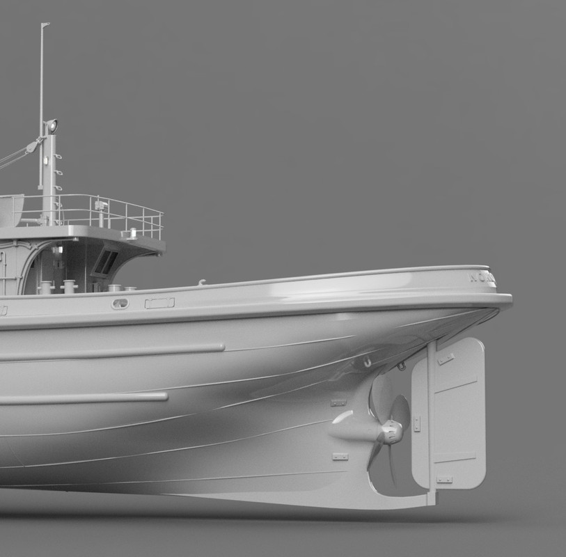

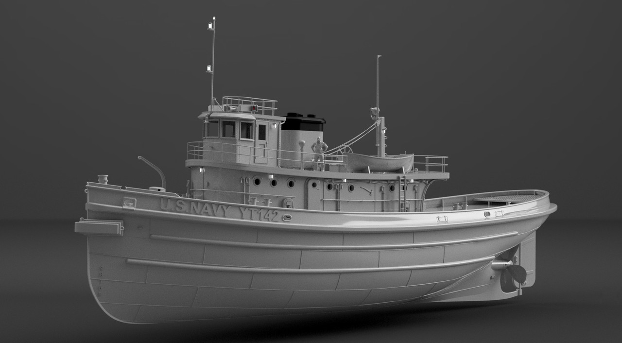

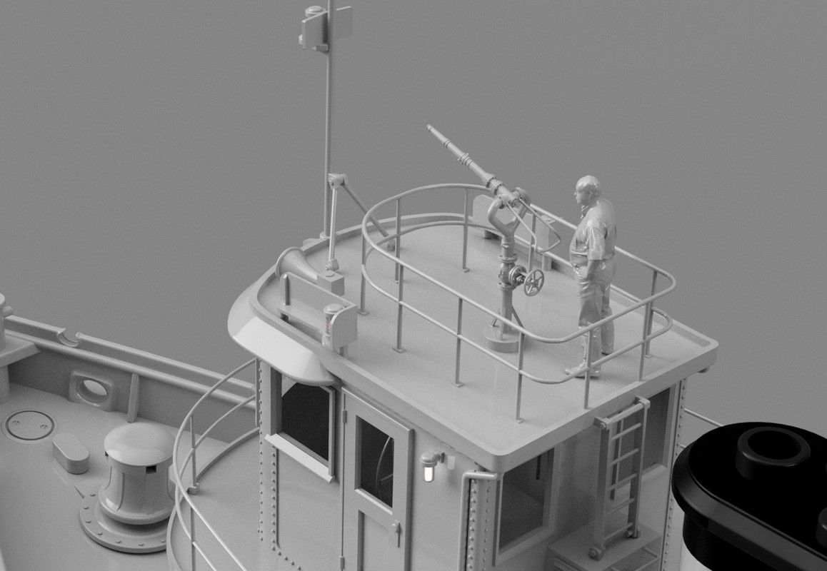

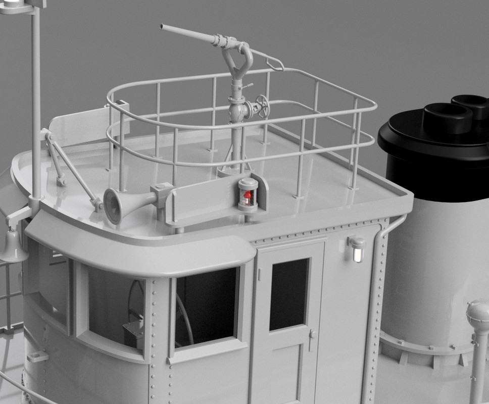

I'm coming to the end now, I'm trying to erase all the small defects when possible and to draw small details.
Here the navigation lights, the foghorn, improvement of the stern tube connection, sacrificial zincs etc..

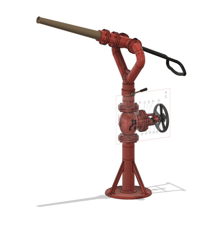

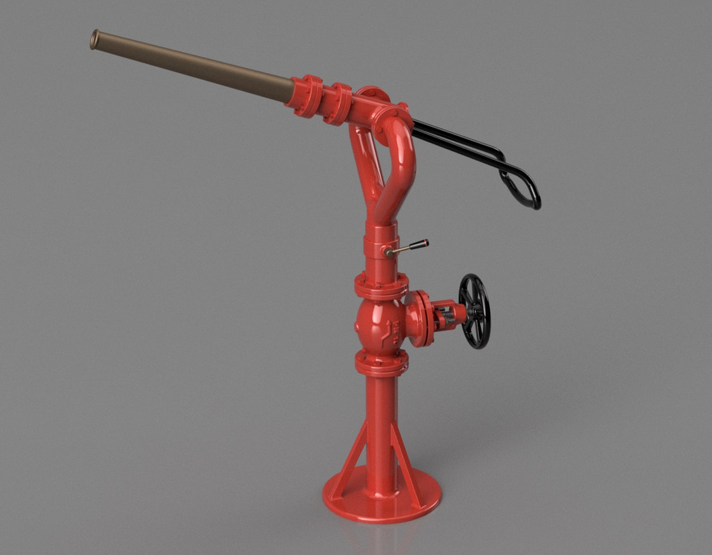

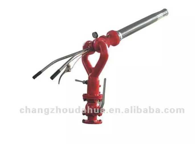

Small fire drill this morning. �:)
It took me a while to find this style of fire cannon in pictures. This model is still made in China, in 1:1 scale, a classic on ships since more than 70 years.
The only difference is that it can project physical foam now, thanks to an ejector integrated in the gun.
I still have some corrections to make.

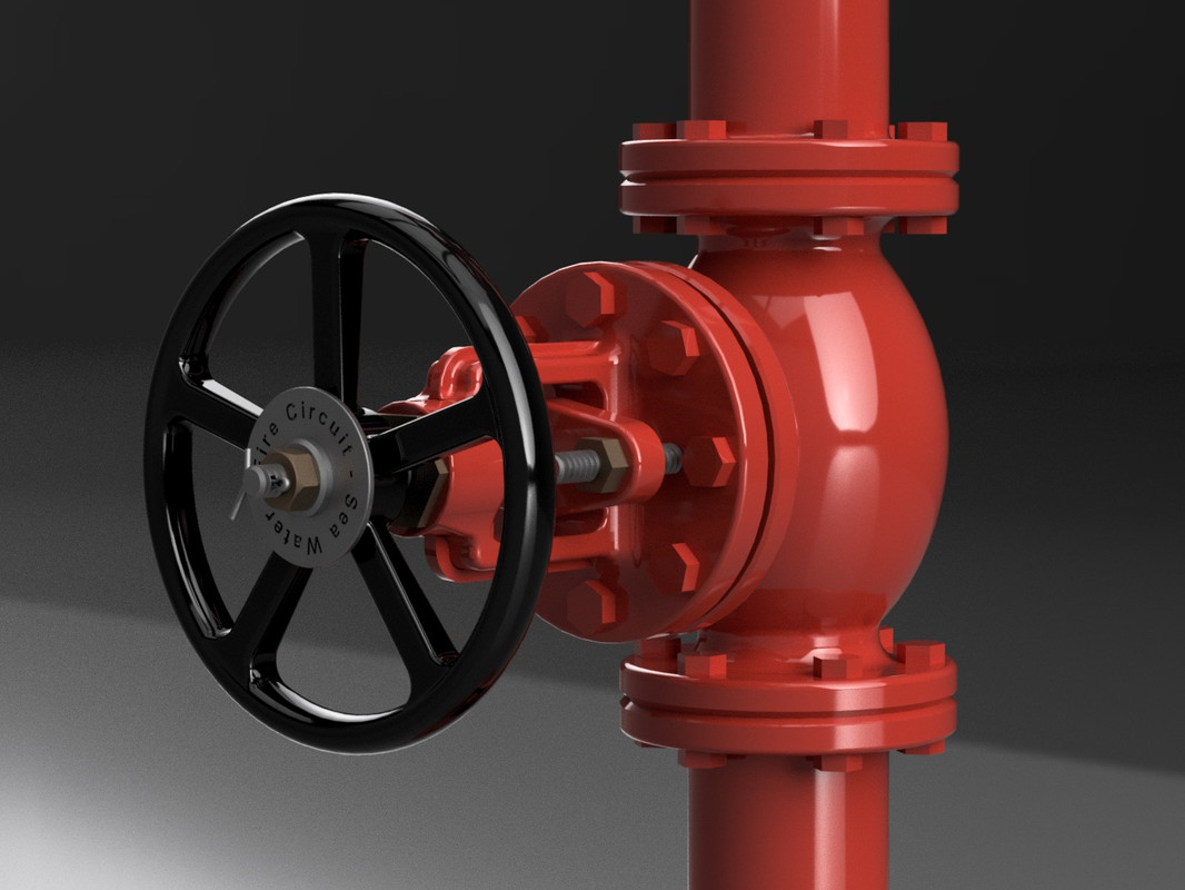

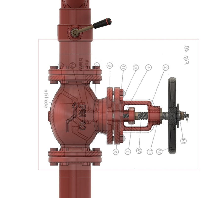

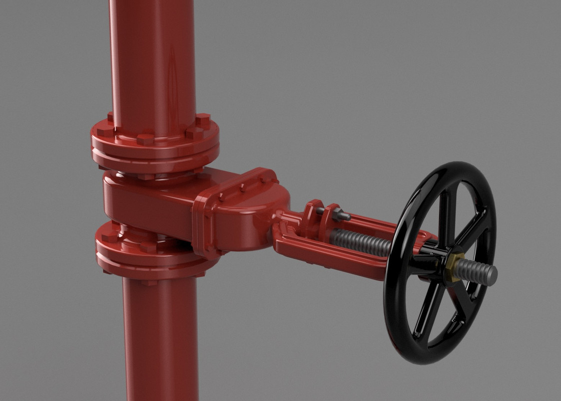

I've made a pleasure to detail the gate valve, it can be used for other ships/impressions.
An example at 1:1 scale
The fire cannon will be placed on the top of the bridge of the tug.
A little doc on the various marine valves:

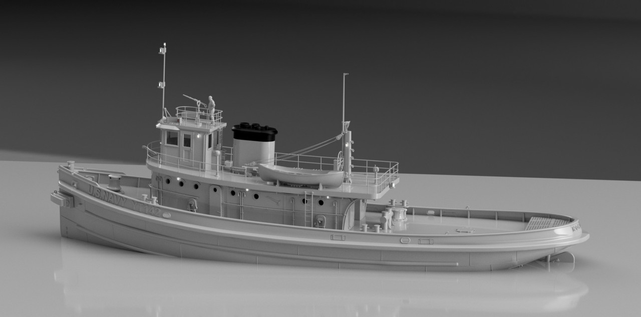

The final version:

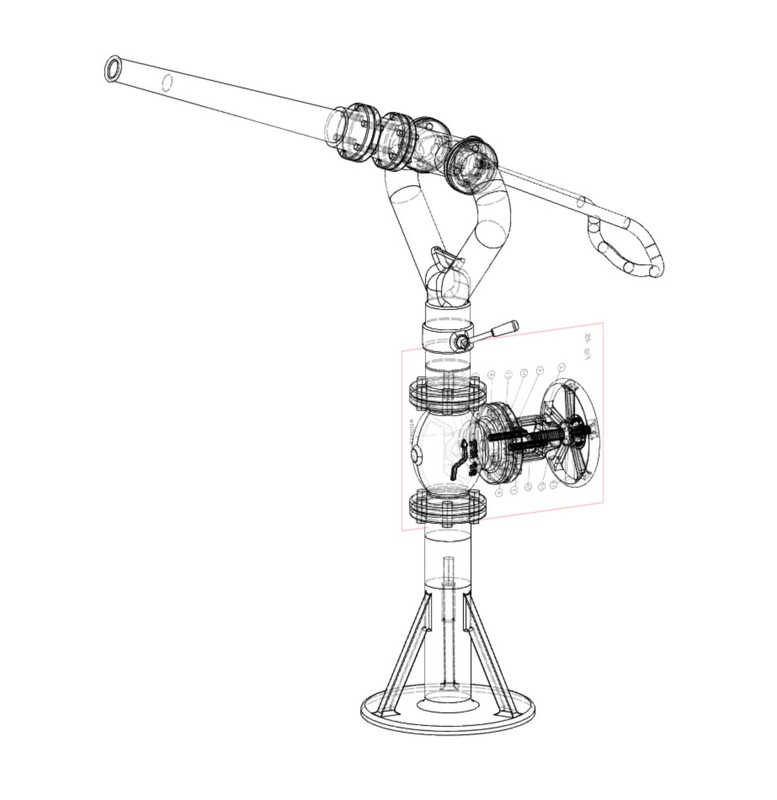

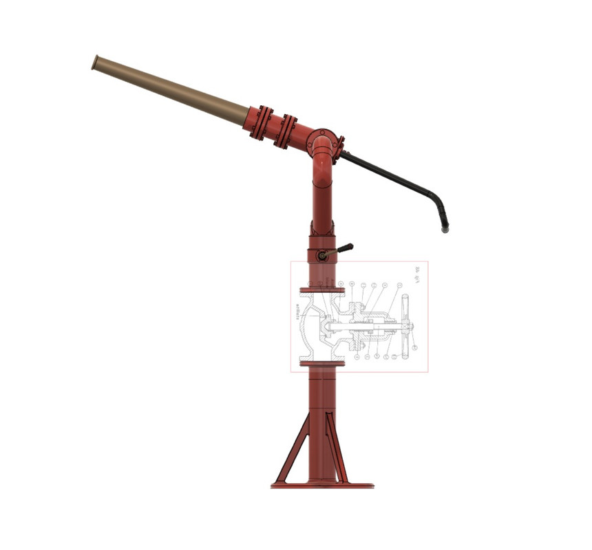

It was pointed out to me that this was a flap valve in the photos, so I quickly drew this type of valve with the plan I had posted above.
One more accessory in the drawing stock. �:)

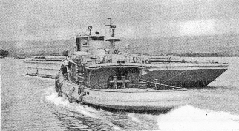

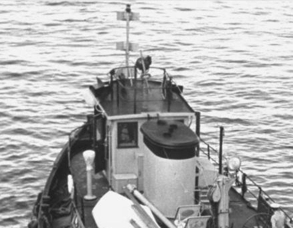

I was not sure about the shape of the cannon's lance at that time. It appears to have several setting cones on the end probably to set the cannon to the pressure pump.
I just found this image, it will allow me to modify.
Hoga:
Hoga:

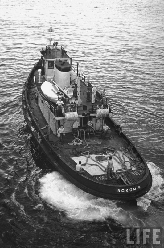

Nokomis had only one fire gun at the beginning and during Pearl Habor attack. It seems that the tugs were better equipped after the attack with an additional platform on the stern, Hoga too.
Nokomis, later:
Hoga, Pearl Harbor.
Hoga:
Nokomis, later:
Hoga, Pearl Harbor.
Hoga:

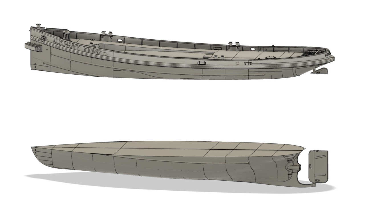

Preparing a test print of the waterline hull, a first for me. It requires a little preparation in terms of drawing, including a good classification of the different parts.
I'm only printing the hull for the moment, the fittings will be printed separately. This will allow me to check the fitting of the 2 parts for the 1/100 in full hull.
First we have to make a cut! �:)
The ship is 87 mm long at 1/350.
