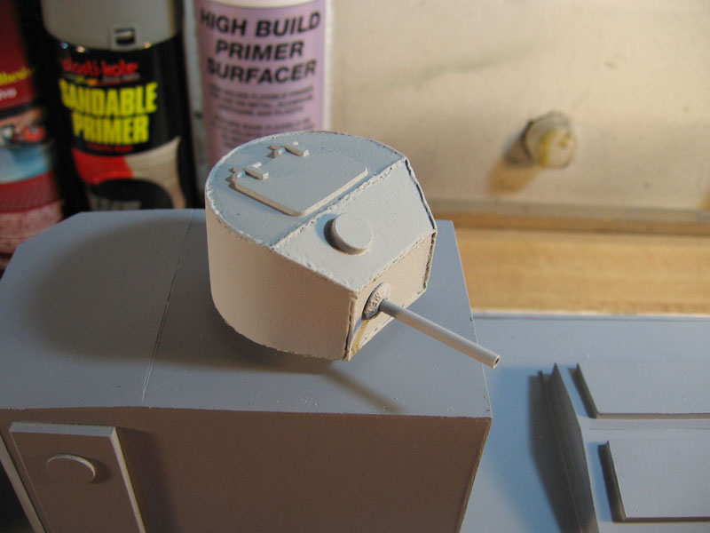

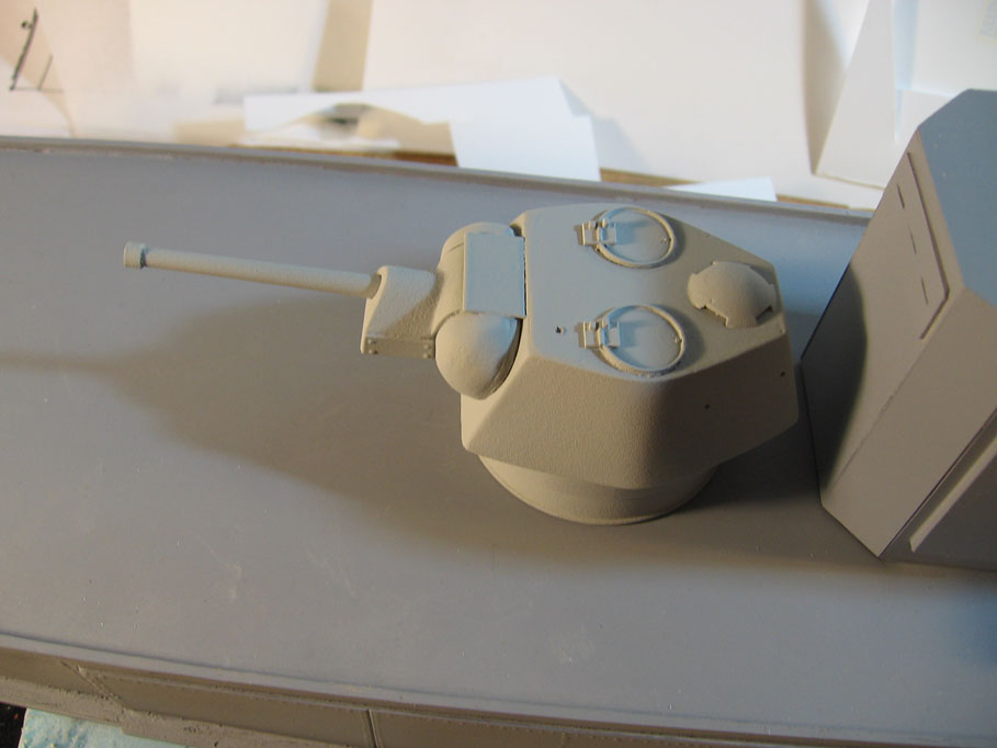

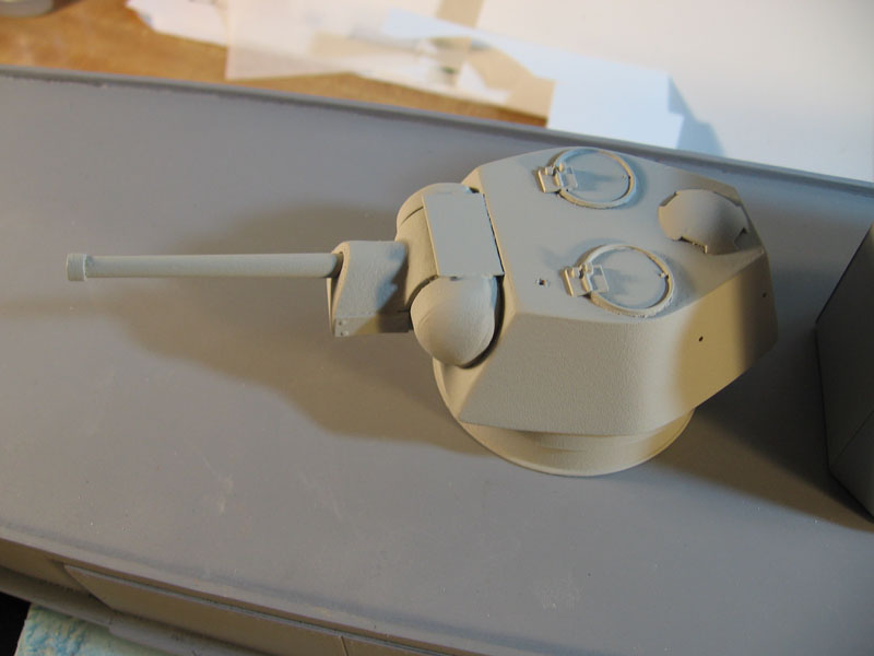

Here's a wide shot of the whole boat and that angle again with the finished turret.
Steve

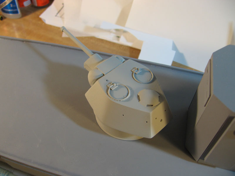

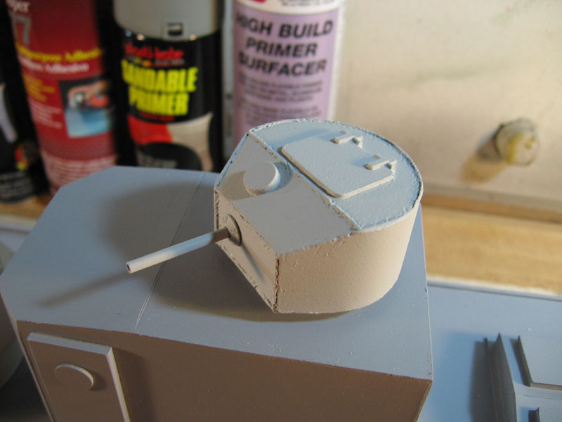

Got the smaller gun master made and finished today.
She's ready to mold. Moving on to finishing the super structure and deck.
The barrels for the guns will not be cast resin. Instead I'm going with the widely held theory that the tank turret was a straight barrel. I will supply the drawings and the brass in the kit to make your own. This way you won't be breaking them off.

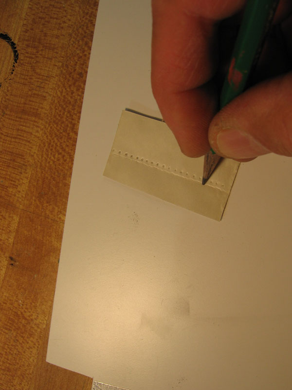

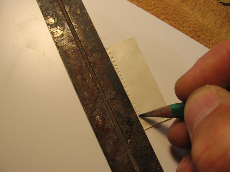

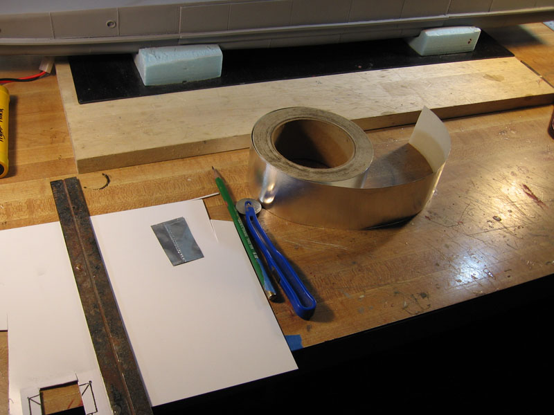

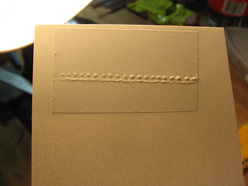

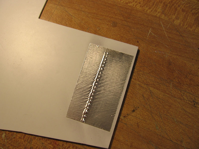

So I was looking through the post of this man's build thread. Don't know his last name but his first is Ron. What blew me away was his approach to rivets and hull plating. Litho Plate! If you look through the posts you'll get to that part. What I didn't like was finding Litho Plate and then having to glue it on. Still faster but I'm always in a hurry.
Then I was looking through my supplies for something totally unrelated and found the aluminum tape you can get at hardware stores. I used it on my B-29 to simulate rivets and brushed aluminum using a pattern wheel. The thing I didn't think of in those days was making the rivets from the back side to get the raised effect. Then it struck me I could do welds that way too. The tape has an adhesive backing. Thus no gluing. Question was when I rub it down will I lose detail.
So I did a quick test to find out.
Here's what I used. The tape and the basic tools.
Using a straight edge you can mark the seam and make the rivets by pushing from the back side of the tape against a flat balsa building board.
Then you can dirty up the seam with the pencil to simulate the welds.

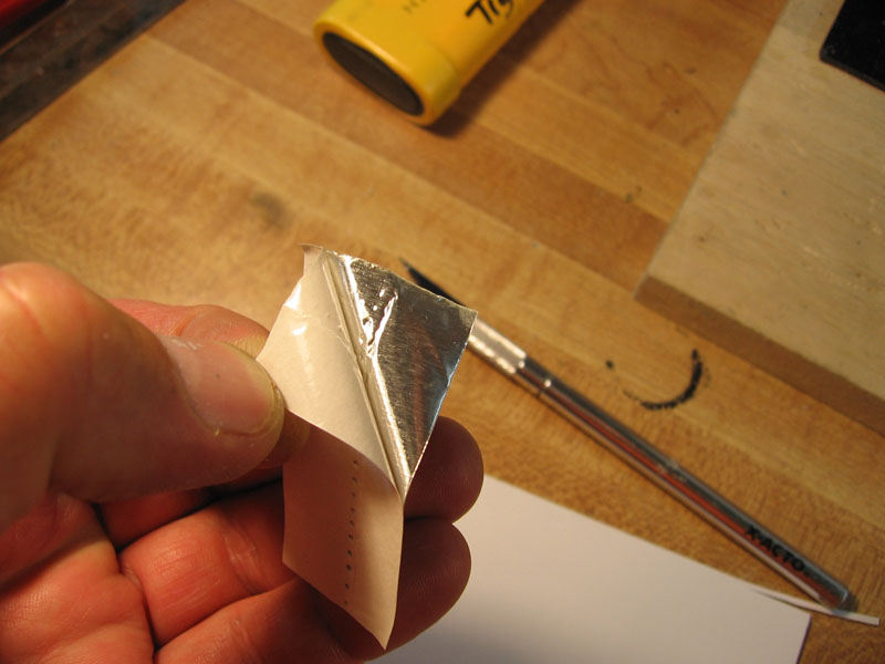

Peel off the backing on the tape.
Rub it down and I was easy about it either. Just rubbed it down hard in order to get it smooth.
A little primer on it to see how it's doing and it looks great. And I did this in a few minutes. Quick and dirty. If I take my time it gets better.
This means I can finish off the deck, super structure and a few other detail in a day rather than week! This boat will be done a lot faster now. And it opens up a whole lot of other possibilities from projects I would shy away from because of welds and rivets. No more.
I owe it all to Ron and his fantastic work. Sure he does it different but it was his building thread that gave me the idea. It's really the same and I always give credit where credit is due. Thanks Ron for the lesson. It was oput to good use.
Me a happy camper!!
Steve

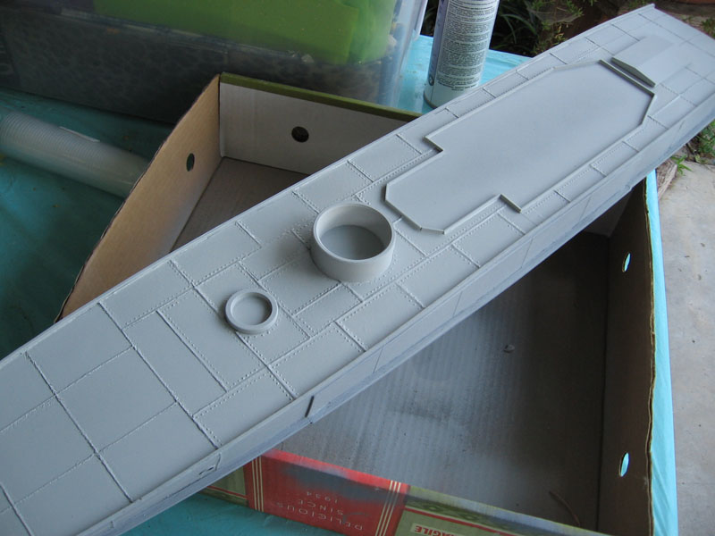

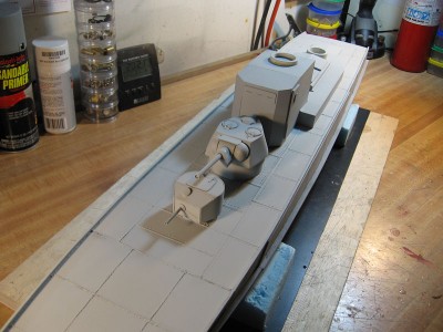

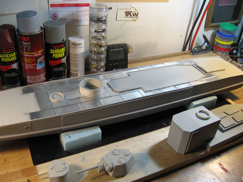

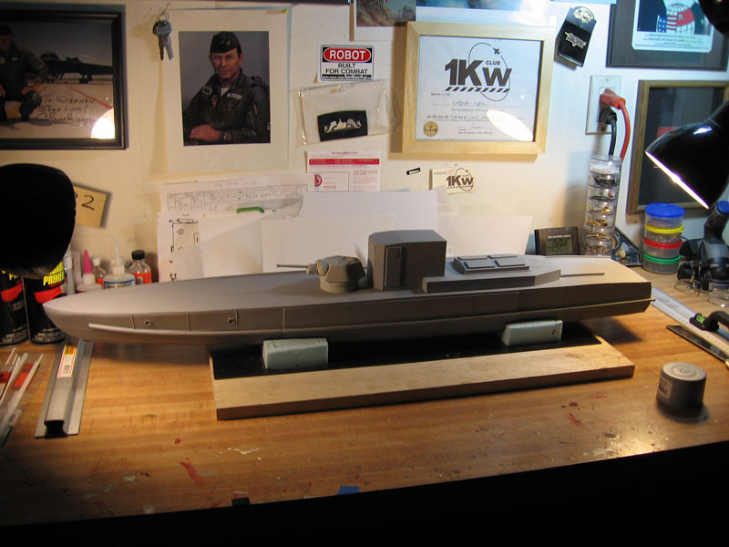

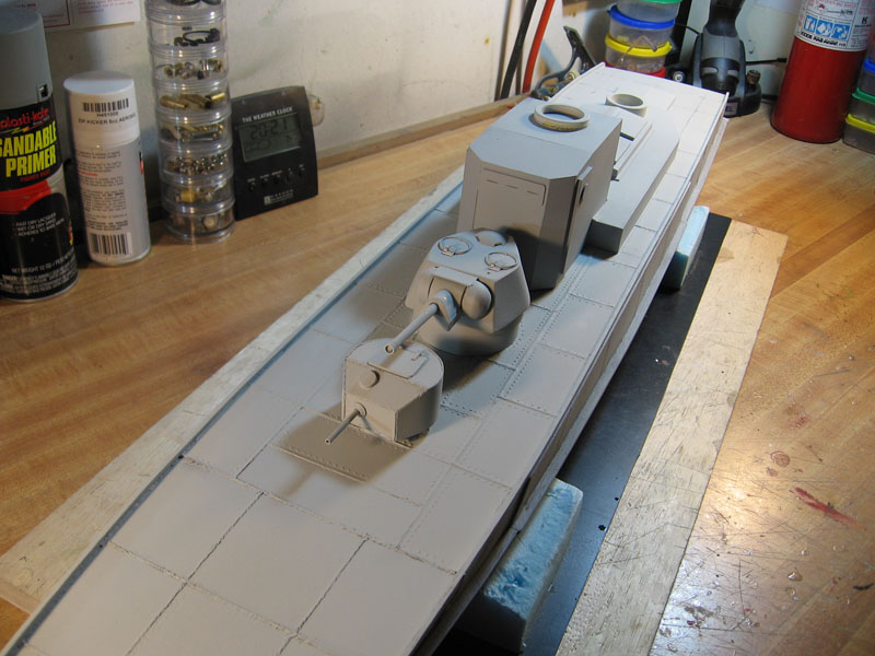

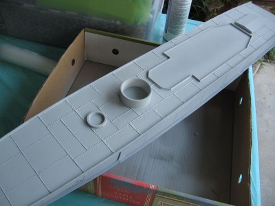

A lot more done yesterday and today. Welds on the deck. Armor plating and rivets. All a bit large for the scale of this boat. But I have seen some of these Russian boats that had very raised rivets and welds so I leave it as is.
Here's some pictures.
Steve
