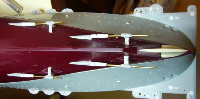

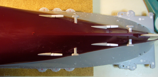

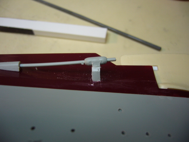

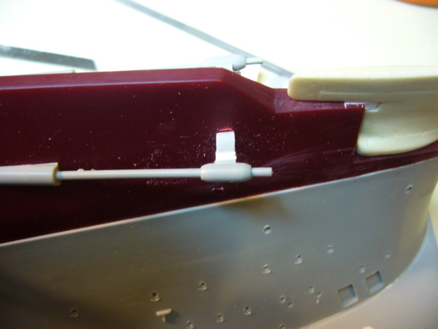

As most of you have found out the rear shafts are too close to the hull and the props hit it so something had to be done. I chose to follow Charles Landrums fix and extend the braces.
I was told the shafts are not correct as depicted, there is a tapering to the shaft housing as it comes out of the hull. Some pics are on the way but don't know how I will deal with that but do have a few thoughts. We'll just have to wait and see.
The horizontal brace
The vertical brace
The vertical brace

I've been a busy little beaver but not much to actually show. I liked how Charles Landrum did the plenums on his Lex build so I copied that. I also made and installed the mooring bits that are missing in the kit (also removed the couple of wimpy ones they had on the aft weather decks).
Got some pics that show the Lex shafts, props, and rudder which I'll post here. They show the braces to be streamlined instead of the squared off shape in the kit so had to go back and do some judicious filing, those rifflers that have been gathering dust on the shelf really came in handy. Have a real good shot of the Lex from directly aft while in drydock and it clearly shows the rudder shape. Only problem is the file size is too big and the only one I can get to fit the forum here is way too tiny. WIll see what I can do later though.
Also have a pic of the spreaders taken from the Lex looking back so you can see they are not solid as depicted in the kit.

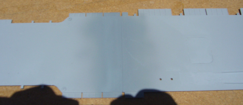

I braced the top of the hull so the flight deck would naturally fit in instead of trying to force the top out to fit the aligment studs on the bottom of the deck.

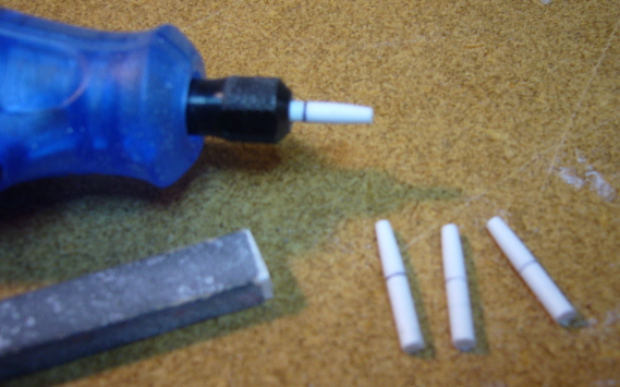

After seeing the pics of the Lex in drydock I had to make some modifications to what came in the kit. First I streamlined the shaft braces. Then I cut out the plastic shafts. Next I formed tapered extensions from rod stock, chucked them in my little Dremel and tapered them to the approximate shape I saw in the pic. Then it was sand them a little more to get them to fit and line up with the shaft supports.
Siniace I was going to replace the shafts themselves anyway now was the time to drill them out and put in the brass rod. I won't put the props on until it is painted as the PE ones are easily susceptible to damage.
These are the extensions with the last one still mounted in the Dremel
This is before drilling
And this is with the shafts inserted but not yet glued or cut to length

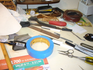

I hadn't been doing much on my models as I have had so many other things going on right now. BUt I noticed something that got me started off on a tangent that should have been addressed awhile back. I have noticed that most of the pics I see of modelers benchs are rather cluttered, mine included. This bugs the neat freak side of my mind but I have just sorted things out as I work and move on, besides, I rationalized, I haven't got everything set up yet so it will work out. Too late! I noticed that I had pushed my magnifiying lamp back and snapped the mast of my almost finished Constitution cross section, AGAIN! DAMN!!!!!
So I decided to do those things I had been thinking of and get things set up, then finish the Constitution, after repairing it of course, and get it out of the way in my small workspace.
Here are a few pics of the disaster and the first steps to recovery.
Here's the broken winged bird
Disaster recovery 001a.jpg (59.25 KiB) Viewed 3145 times

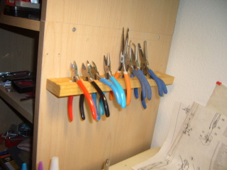

First get all the pliers off the worktop and in place
Disaster recovery 002a.jpg (48.53 KiB) Viewed 3141 times

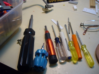

Screwdrivers are next
Disaster recovery 003a.jpg (54.32 KiB) Viewed 3146 times
And then on to the knives, sanding sticks, files , and whatnot
Disaster recovery 004a.jpg (65.79 KiB) Viewed 3143 times

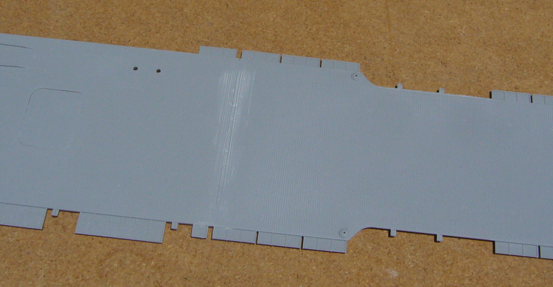

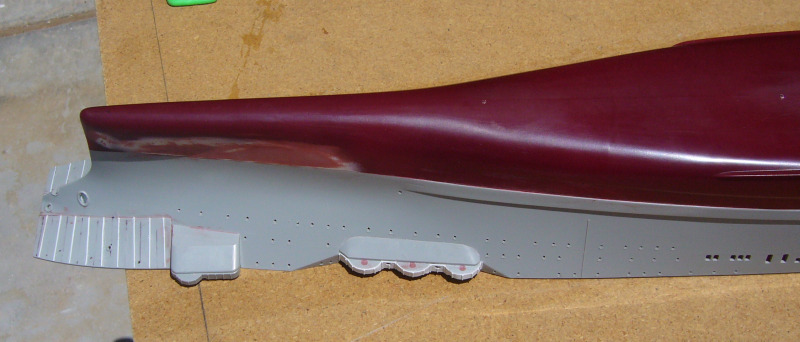

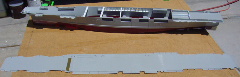

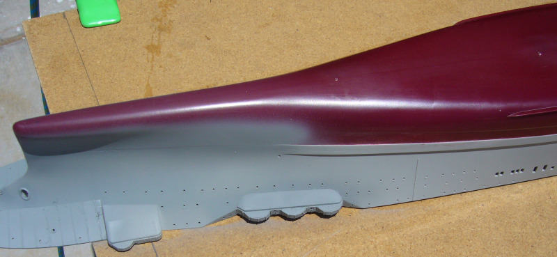

Well it's obviously been more than a week but I'm still kicking. Been busy as hell and a lot going on. Will be out of town again next week and have a cabinet I have to build for an organisation when I get back but I took a small amount of time to fire up my new airbrush and get a feel for it. I first just loaded up some paint and sprayed all over a big piece of stray plywood I had laying around. Then I got my hull and deck out and sprayed primer on the areas I've been working on. This is supposed to show any flaws that will show when you do the actual painting. I was pretty impressed with how most of it did come out and it does show the flaws I have to work on. That will have to wait a little but here are the pics of the results. I tried an online photo editor to see if I can get better results than with my HP product. With this one I can get them small enough to post yet still be able to zoom in. Yay!
Here are the two pieces. You can see the damaged section of the flight deck from the glue, part of the learning process of what not to do I guess.
Here you can clearly see the damage and where i've sanded and filled it and tried to redo the plank lines. Hopefully the primer will make this clearer and easier to do.

Front sponsons and hull sections primed. It does show the flaws. Cool!
