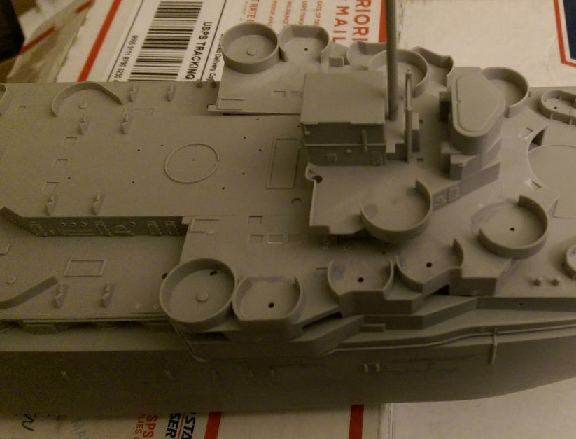

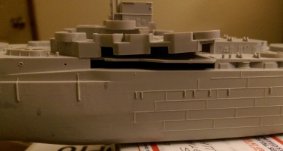

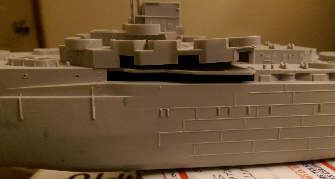

OK, a couple of points to keep in mind on Trumpeter's 1/350 BB-35 Texas kit, or at least my copy. There have been a couple of pieces that had some minor warping - the two hull halves were two. Because the bilge keels are separate there wasn't really anything good to grab on to, so I wound up clamping the sides for the "gross" press and then using my fingers for the more fine pressing and alignment of the joint on the bottom. Trumpeter actually molded on some docking keels, so unless your model is mounted on stilts, most people won't even be able to tell if there's a miss-alignment or gap. The other major piece with warping was the Air Castle F1, and that's the port aft side, visible in this picture:
It doesn't fight being pressed down at all and should be trivially easy to fix. Note that I have been removing the raised blister plating - it's grossly over scale and just looks wrong to me, especially since the blisters are the only part of the hull to actually have the plating effect and the rest is perfectly smooth. I'm leaving the bumpers and pipe protectors and have been using an XActo #11 to carve off the raised lines, sand off the stuff that I don't quite get off all the way, and Mr. Surfacer in a couple of small divots where I cut or knicked into the plastic too far. There's a couple of areas wher the molded on rung ladders extended below a line and I just said "heck with it" and cut away the molded on detail and didn't bother to save the rungs BELOW that point. I only lost 2-3 rungs when it happened, so it's pretty possible to save most of the detail fairly easily. Next photo is looking down on the superstructure deck and some of the superstructure I played with building up:
MIght be hard to tell in this photo without looking, but there were mold seams on the deck around the open backs to the gun tubs. If you want to fix them, you obviously want to do this BEFORE you start gluing down superstructure pieces. I got a little ahead of myself and did this to the piece above the superstructure deck (the Signal Bridge level) in a fit of exuberance and joy and wound up having to deal with this with the piece M27 in the way of an easy sanding stick job. The pilot house level (pieces M3 & M23) sits above the armored conning tower and CIC space (piece M27 again) and rests on a single support on the conning tower, four legs to the signal bridge, and front leg of the tripod. There is an air gap and the pilot house level doesn't actually touch any other major block of the superstructure below, so these pieces must be well aligned. Trumpeter's instructions for the four legs (step 8.) makes it look like the builder is supposed to blue them together and then onto the bottom of the pilot house level, but they actually stand separate of each other by a couple of millimeters. Trumpeter would have you glue this together, attach it to the pieces below, and then run the tripod legs through everything.
My experimentation has revealed that running the front, purely vertical tripod leg first (not really gluing it in, just setting it in for alignment) made adding the legs much easier in that I knew they were straight because the front support (to the armored conning station) and tripod leg were lined up. Because of the complexity of the area, I am planning on gluing the aft vertical legs in, painting the deck and superstructure in this area, and then attaching the rest of the legs to get a good, straight alignment and nice paint demarcation. There is a lot of overhangs and interlaced pieces, so I don't think that assembling everything, then painting everything, and THEN applying photo-etch is going to be a very happy experience. I think a paint as you go and sub-assembly style is a little more suited for this kit.

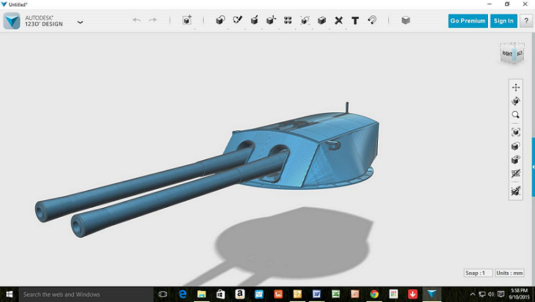

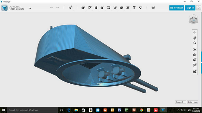

Could we see some test printings?

Re: Calling all USS New York-class fans

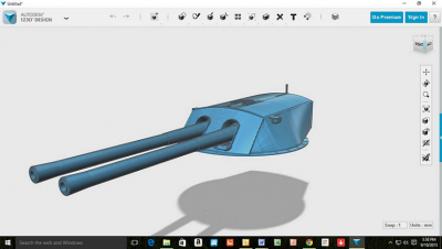

Not yet printed, the computer designs were completed yesterday. Samples in hand soon, though.
I do appreciate that seeing only a computer-generated rendering does not inspire much confidence that the product will actually look as intended, especially with a new technology experiencing some growing pains where both designer and 3D-printer are learning much for the very first time. Having said that, here are some links to products I designed in various scales, Shapeways produced, customers purchased and installed on their models:
1/192 Mk.32 Twin 5-inch Mounts and Mk. 37 Directors: viewtopic.php?f=13&t=159734&start=40
1/200 Mk. 56 Directors (about halfway down the page): viewtopic.php?f=59&t=154697&start=400
1/700 HMS Duke of York Extended Searchlight Platform (see customer's photo and comments bottom of page): http://www.shapeways.com/product/SLNZ8H ... d=57709243
1/700 HMS Duke of York Enlarged Signal Deck and HACS Mk.V Directors (see customer's photo and comments bottom of page): http://www.shapeways.com/product/DZJSBY ... d=57569901
1/700 HMS Anson Enlarged Signal Deck and HACS Mk.VI Directors (see customer's photo and comments bottom of page): http://www.shapeways.com/product/MRZZSC ... d=57570067
Some thoughts (please pardon my ramblings): there are several critical steps that have to happen well in order for you, the customer, to receive a quality 3D-printed product, and the good news is that despite initial difficulties and disappointment, designers and printers and software developers are just now gaining needed experience and becoming very good, predictably so, at these steps:
1) accurate, well-researched design by the designer using quality software
2) the printer's software "sees" the design just like the designer's software does
3) the 3D printing machine prints a product that matches the design
4) the product is handled, packaged and shipped without damage
The renderings shown in the post above are how Shapeways' printing software sees the design. To show you how the designer's software sees the design, in other words, what the product is originally intended to look like, here below are some screen captures of the New York and Texas turret Nos. 2 and 4 as rendered by the design software I used for this project.
Hope this helps!

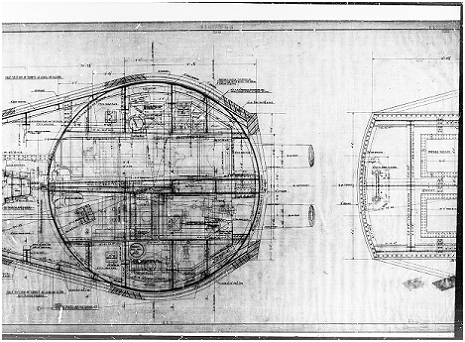

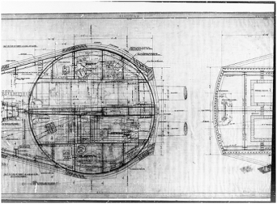

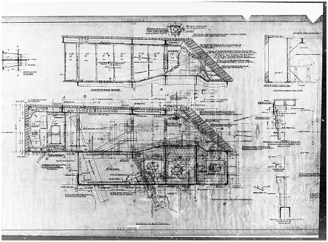

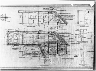

- An excerpt of the builders' plans dated 1914. This is how the original turret engineers intended the turret to look. Notice that the bottom of the glacis at the turret floor level is not flat, it is slightly curved, unlike Nevada and Pennsylvania class turrets mounting the same gun. Scan courtesy of the USS Texas Museum.

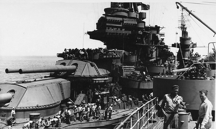

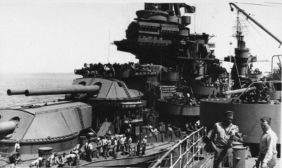

New York at Norfolk, November 1944. NARA II via James Noblin.
Gents, Tracy,
In particular, I was looking to confirm what was New York's paint scheme after V-J Day, since this picture below from wikipedia is how she supposedly looked at the October 1945 Navy Day celebrations at New York City harbour. As you can see, the ship looks either a dark grey or a faded MS21, but the ship camo site still states she was in MS31 8b for the duration of 1945. So you can see why I'm confused.
I'm not seeing the MS 31/8b! She would be in MS21 at the end of the war. The caption is wrong.The current museum has her in her last paint configuration(Ms21) as well.Haijun watcher wrote:Gents, Tracy,
