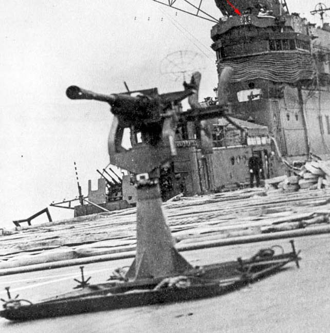

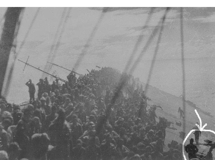

Re: Pontosmodel 1/350 IJN Yamato 1945 Detail Up Set (New Too
first pic you post was the one i referred toDan K wrote:To generalize, the round bases for the single 25mm mount tended to be permanent, while the square bases were for temporary or mobile installations. It was really for flexibility of use, depending on circumstances.
Not only wasn't the base plate fastened to the deck, the gun itself wasn't bolted onto the plate either
here we could see the circular base didn't have means to be locked onto a base plate, not from outside at least.

Good pic! The problem is that the documentation for Yamato at the end is thin on the bases for these mounts. I do agree that round bases need to be included.
