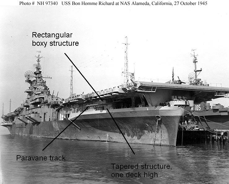

raser13 wrote:i was wondering if anyone would have better images of [the forecastle]. the diagram in the book is good but doesn't have any detail. like stairwells, walk ways, other equipment that was in this area, and such.
There are some drawings in the AOTS book of the forecastle that show various inclined ladders and platforms of this area. IIRC, look at the A6 drawings of the forecastle (don't have it in front of me at the moment). For what it's worth, those platforms and ladders would be difficult to see on a finished model in 1/700 or 1/350 (see first photo below).
There is one notable, common kit accuracy error near the forecastle. It is the structure forward of the forward elevator on the real ship just below the flight deck. On your kit, look at the structure at the front of the hangar deck that is tapered towards the bow and rounded at the corners. Kit manufacturers inaccurately portray that tapered, rounded structure all the way up to the flight deck. On the real ships the tapered structure is only one deck high. There was another structure, essentially a big rectangular box, that sat on top of the tapered structure. IIRC, this area of the ship was used for crew berthing. The rectangular box extends all the way up to the flight deck but that's not how the kit manufacturers have replicated it. I don't know of any kit that has that area shaped properly and it's very conspicuous on the real ship. Capt652 got it right on his model.
Capt652 got the boxy structure right.
The "Big Rectangular Box" that kit manufacturers don't get right.

o.k. thanks.steve i probly would never have seen that issue with the forcastle area being partly rectangler. i'm still going to add the slated ladder that is on the wall with the deck gear locker behind the wildcats. noobody else would notice ,but it would bother me every time i look at the model.

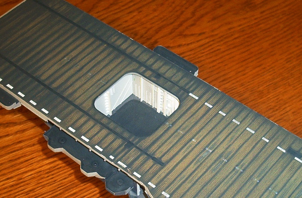

Essex wrote:...to be continued next week with the forward elevator well.
Forward elevator well
Wartime photographs of the forward elevator well on any of the Essex class ships are rare indeed, especially those showing the forward bulkhead. Although wartime photos of this area of USS Yorktown continue to be elusive, Tracy White was kind enough to send wartime photos of this area on USS Intrepid CV-11 and USS Lexington CV-16. The details visible on the wartime photos of the two ships, including details of the forward bulkhead, are identical. Therefore, I replicated these details on USS Yorktown consistent with the photos of her two sisters.
Unlike the white hangar deck interior bulkheads, the black and white wartime photographs show that the forward elevator well bulkheads were painted a very, very dark color, possibly Navy Blue 5-N or Deck Blue 20-B. After discussing the most likely color for these bulkheads with Tracy, I will be painting the bulkheads shown here Deck Blue 20-B. Two reasons: 20-B was more commonly used than 5-N generally, and the bulkheads were only visible from the exterior of the ship when viewed from the air when looking down into the well.
Additionally, each ship had the warning "BEWARE OF PROPELLERS" conspicuously painted on the forward bulkhead, although done somewhat differently for each ship. Intrepid's warning appears to be 36" tall white letters (with the word "OF" in smaller 18" letters) painted in all caps across nearly the entire width of the bulkhead. Lexington's warning appears much smaller, painted in two rows of about 12" letters in all caps, possibly in red, on a white rectangular background, located on the left (port) side of the vertical elevator track. Like her sisters, Yorktown probably had a warning painted here too. If so, it probably was similar or identical to the warning on the funnel uptake trunk as seen in the film "The Fighting Lady": red letters on a white rectangular background.
Elevator well bulkhead details confirmed by photographs provided by Tracy White.<br />These bulkheads will be painted Deck Blue 20-B. Note that the vertical track on the<br />forward bulkhead is offset to port. It is unclear what function was served by the<br />three diagonal pipes or rods visible on the bottom right of the forward bulkhead.

To expand a little bit on what Steve posted, a lot of thought and effort went into camouflage on carriers, given their importance. Consider that the lower wings on aircraft were painted medium blue on the parts that folded and were visible from the air when aboard ship. (Corsairs and Helldivers mainly) Look at the below picture of Lexington in 1941 and see how "brilliant" the elevator wells are in comparison to the rest of the ship:
Reposting CV-16's aft elevator well picture as a demo:
Note that the underside of the elevator and the pit itself are in white, but that the bulkheads behind the F6F drop tanks are dark. I have kept my eyes open for documentation on the color to be used, but have found nothing so far. My personal, WAG is 20-B deck blue over 5-N because every ship would have stock of deck blue, but not all ships would necessarily have 5-N (CV-9, for instance, was 5-L and black).
This is just a wild guess at this point, no documentation to back it up.

Steve Larsen wrote: Forward elevator well
I see, you modified the forward elevator well since december 2007.
This part of the ship is a challenge... (The biggest challenge is the island and the radar outfit.) In the AOTS drawing A8/2 can be seen three elevator tracks, marked with red circle on the attached picture. The tracks are both sides at the rear of the elevator and at the front in the middle. (Not offset to port.) There is two elevator lifting piston in the elevator pit, marked with green rectangle on the mentioned picture and see the drawing E7 part #16.
The Trumpy kit has the elevator tracks only both sides in the middle, as on the photo of the mothballed ship, posted earlier by Steve. But there is no lifting piston on this photo, it must be a modified elevator for the heavier aircrafts. I don't know when this modification made? Was it during the WW2 or post-war?
There is a color photo in the book "Carrier Air War in original WWII color" by Robert Lawson and Barrett Tillman on the page 60. This shows the elevator well of the Yorktown in 1943 loading Hellcats and aircraft towing tractors for her shakedown cruise. (I think this photo was taken on the same day as the photo in the Warship's Data 5, page 28.) On this photo clearly can be seen the elevator track at the rear as on the AOTS drawing, and not at the middle! Maybe the front track is there, too, but I'am not sure... Interesting is the triangular platform in the edge of the well. I scanned a part of this larger photo, see the attachment. Note the color of the elevator well!
It's ok, but there is an other photo of the Lexington after her 1945 refit, see in my next post! On this photo the elevator track about in the middle of the well! Is it Lexington's original outfit or a wartime modifcation?
