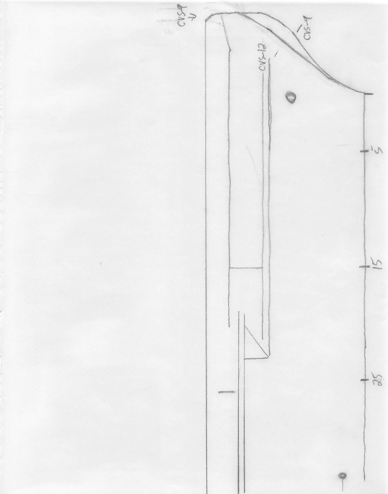

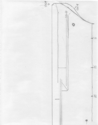

Postwar Essex hurricane bows
I am starting a kitbash of a Trumpeter Ticonderoga (CV-14) into a 1969 Hornet (CVS-12) and wanted to pass along something I discovered in my research.
Obviously Hornet is a flat-front hurricane bow ship, and the ones I have modeled before were rounded-bow. When I was comparing the booklets of general plans for Essex and Hornet, I discovered something. The forecastle of Essex - a rounded bow ship - extended almost to frame G. The same plan for Hornet the forecastle ends at not quite frame F, and presents a noticeably flatter bow. The Hornet plans don't have a profile, but if you plot the flat front and set the forecastle deck back a frame (see attachments) you get a noticeably different profile. And all of a sudden the difference between the two subtypes is a lot clearer. It's not just the flat front - it's the long straight "neck" and flatter bow compared to the rounded bow ships.
I am assuming that all the SCB-27A/C ships got the wartime long hull if they didn't already have it - and this trimming back was something that was done to the later SCB-27A/C ships when they received their hurricane bows to further address the slamming issue from the flared "long hull" bows. I was wondering if anyone had a source that specifically addressed this. Or tied the flat front configuration to the truncated forecastle deck?
I saw one post that indicated that it might have had something to do with the secondary conn, and that actually makes sense now. The "rounded bow" ships essentially rose vertically from the froward tip of the forecastle, so there was no need for a flat surface - it was already essentially flat. But the flat front ships' forecastle deck ended about four feet aft of the front of the secondary conn. So the flat front would have served the practical purpose of maximizing the deck space of the secondary conn, adding a knuckle underneath the compartment.
- CVS-9 / CVS-12 forecastle plan
- CVS-12 forecastle plan.jpg (22.32 KiB) Viewed 15124 times

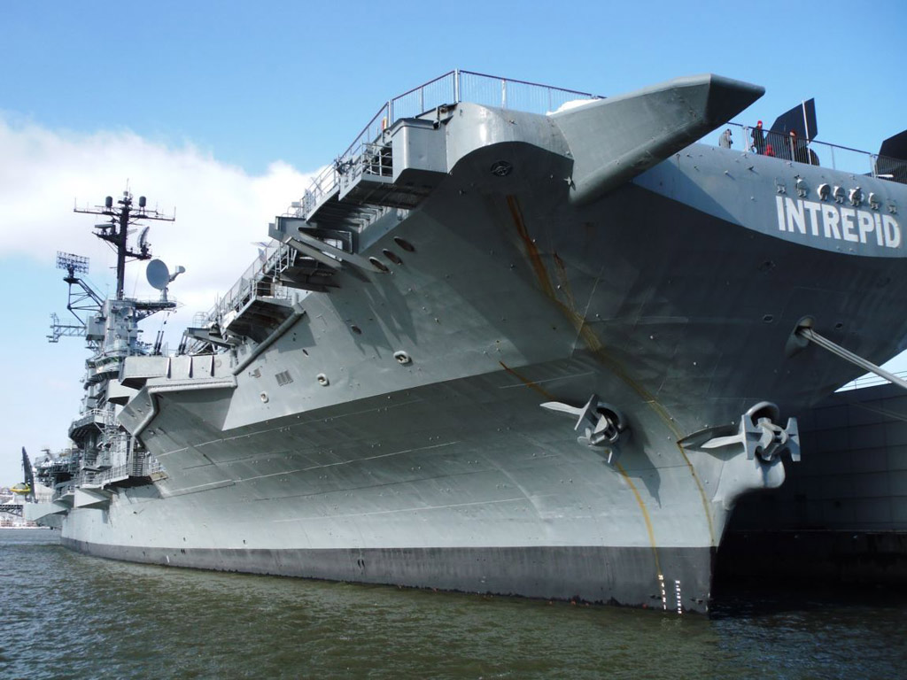

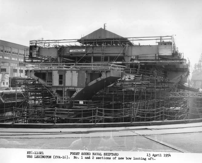

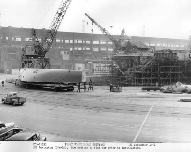

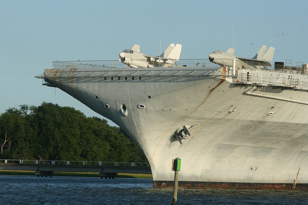

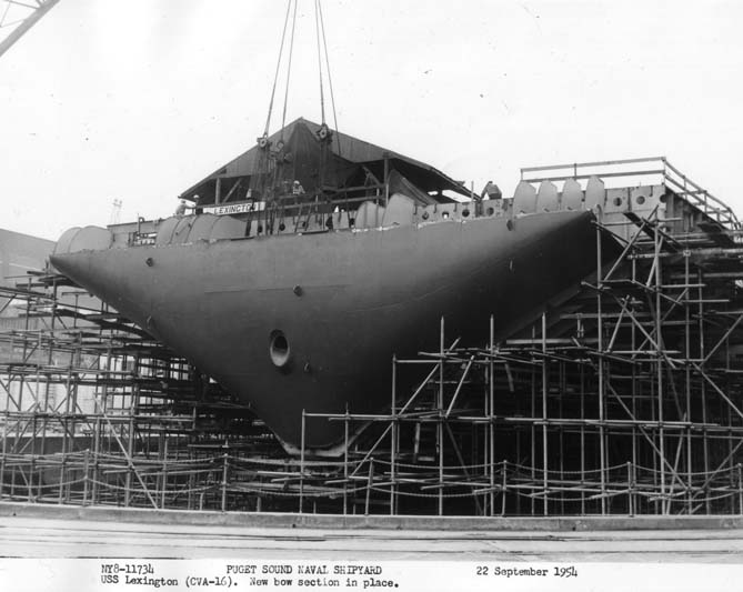

SCB bows do make for a very interesting discussion and as you pointed out, they were not all the same. Tracy White may have some information on how Hornet's bow was altered and why it is differently shaped from Essex, Intrepid and other ships of the class.

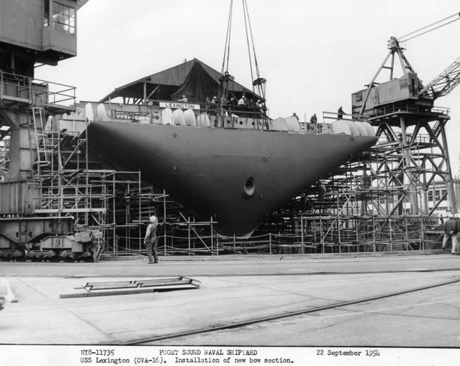

The Navsource photos below show Lexington receiving her new hurricane bow. Note that a very large portion the original bow was cut away. The original open space between the forecastle and the flight deck was not simply plated over, the existing bow was in fact replaced. Two entirely new bow sections were created on shore then attached to the ship. Yard photos call these new structures "Section No.1" and "Section No.2". The two sections are essentially (1) an extension of the hull and (2) a rounded cap. The first photo shows the new bow extension being fit to the hull. The next three photos show the rounded cap. The extension was attached to the hull and the cap was attached to the extension, completing the enclosure (fifth photo).

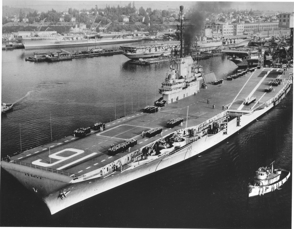

Compare Lexington's bow to Hornet, Intrepid and Yorktown (last three photos). All of these ships are "short-hull" Essex class carriers, yet their new bows are all different to some degree.
