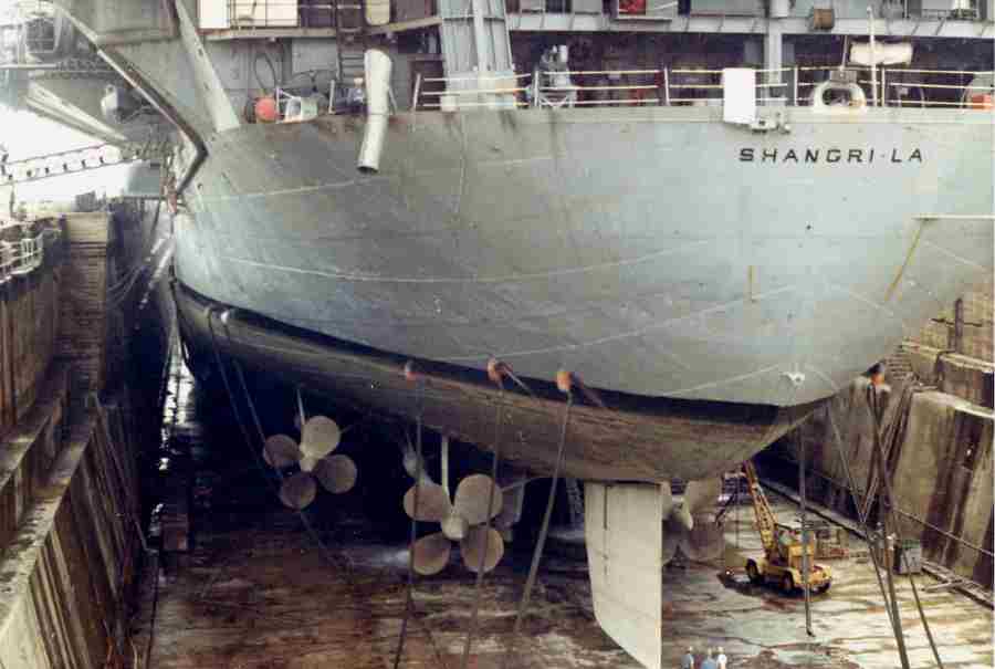

Capt652 wrote:Been working on the fantail after receiving some great photos of Shangri-la that I hadn't seen before.
That is outstanding! One thing I did notice, however...I believe the supports for the shafts were "Vee" shaped, not just a single strut. You can see what I mean in the attached picture:
Shang in dockyard in Philly.  I believe I got this from the Shangri-la associations website

Martin wrote: One thing I did notice, however...I believe the supports for the shafts were "Vee" shaped, not just a single strut.
I agree. Another example of shortcuts that Trumpy did, But that is what scratch building is all about right? I will make that correction before I'm finished. Here is a photo from a different angle to show the bracing;

also you guys have been talking about the prop shafts being a "v" shape instead of a single rod. here's a better angle to show the contact points on the hull
