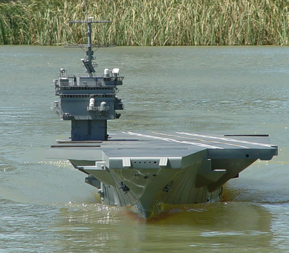

Hi Everyone I have been on and off this forum for a while now but I thought I would post some pictures of my ship, its been going for 8 years ( I dont get a lot of time on it) but it is operational now and I can start getting into some of the details like hangars and working lifts.
Anyway here are some pics Cheers

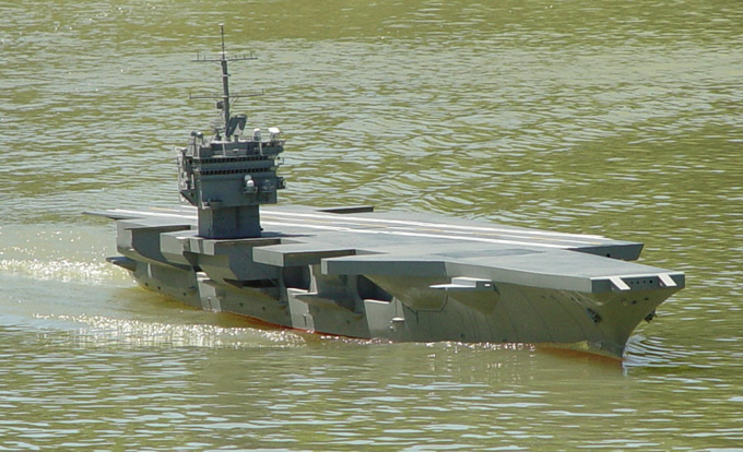

Hi Guys, glad you like the ship. I made some mistakes in the construction which meant some parts didnt stand up to the wear and tear of operational use so its just come back out of a refit, for a better word. but I will detail that later.
Here are some more pics of her underway.
Please let me know if you have any questions about the model or construction

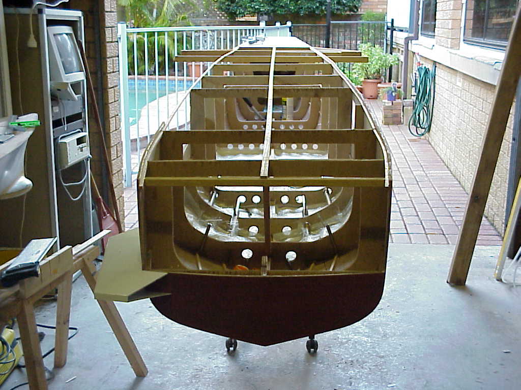

Hi Guys thanks for the comments:

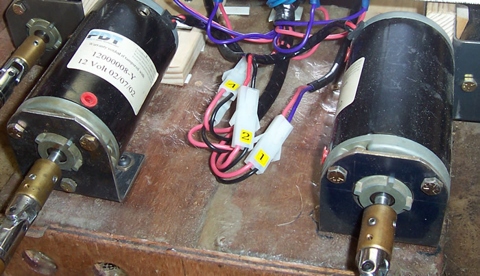

To answer some of your questions, I built the hull. Its plank on frame with a fibreglass coating outside and a resin seal inside. she weighs in at about 100Kg dry and 300Kg with Ballast.
The ballast consist of 10 X 30 A/H batteries and the four motors were designed for Wheel chairs and Golf carts, they pull about 4 amps each when she is running. Maximum real speed at the moment is 5.5 knots.
There is also small footprint 64Bit computer onboard to provide storage for the cameras when mounted, the GPS, Wireless link and sound effects.
Normally the computer is stowed in the forward section but there is a pic of my cat dosing where the PC normally lives.

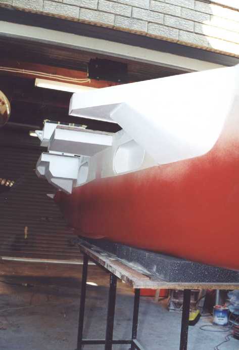

The following pics give you a look at the construct and a little of the interior, I will try and take some more interior shots in the next week or two to post up.
Sorry for getting carried away with the photos, I will stop for now

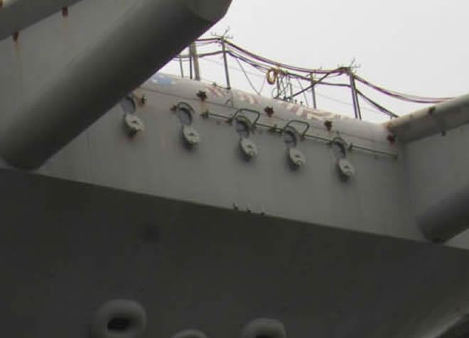

Well as far as im concerned Craig lets have more build pics of her as a model of this size is fairly rare so more pics please an could you tell me what them holes are for in between the front bridel catches as ive seen them on the real ship ?

As for the holes in the front I always assumed that they were port holes and open to the outside with the hatches in front.
However I recently discovered this photo of Enterprise which indicates they have glass as well. I am guessing but I would think the hatches may be for protection in heavy seas.

The portholes in front are for the forward conning room used in emergencies.

Those 5 portholes are about all that remain of CVN-65's namesake CV-6. They were removed from her conning tower during her scrapping and subsequently installed on CVN-65 as a memorial.

Thanks for showing the construction photo's .Amazing work !
