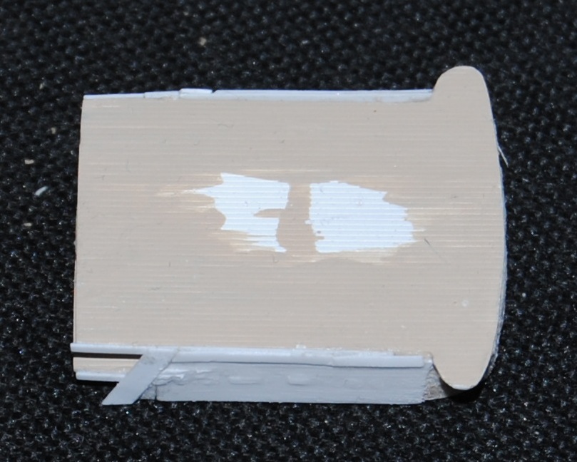

My current method for scratchbuiling hulls is rather different than other small scale methods such as "bread and butter" and Don Mkeands full keel and frame method as illustrated on the Fine Waterline site. Each method has its own advantages and disadvantages. I think mine works best when you have a relatively substantial hull but only deck plans and side views to work from. If this build works out I may rework this thread into a short tutorial on scratchbuilding hulls in styrene/balsa.
For starters, the sideviews were reduced to 1/700 on a photo copier. A waterline shape was worked out from the deck and side views using french curves (burmester set) while making sure that the side view was .5mm too low and the waterline was .6mm too narrow. The side view and the waterline were transferred to 1 mm styrene and balsa planks were attached. The sheer was cut from the planks using the keel plate (=side view) as a guide and the decks were added in .5mm styrene. Then I filed and sanded the balsa in shape using the deck plates and some pictures as a guide. This is the result after an evenings' work: Next time I'll be adding the shelter deck bulwarks and the hull plating.

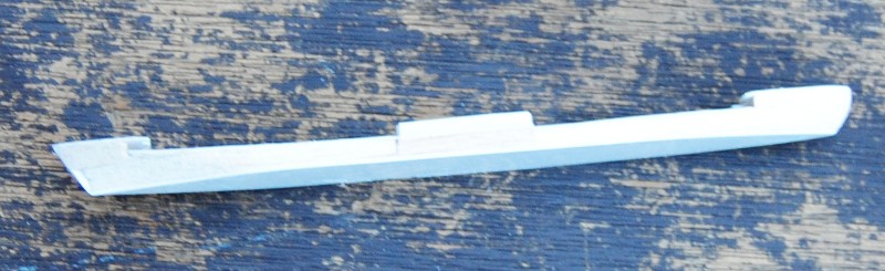

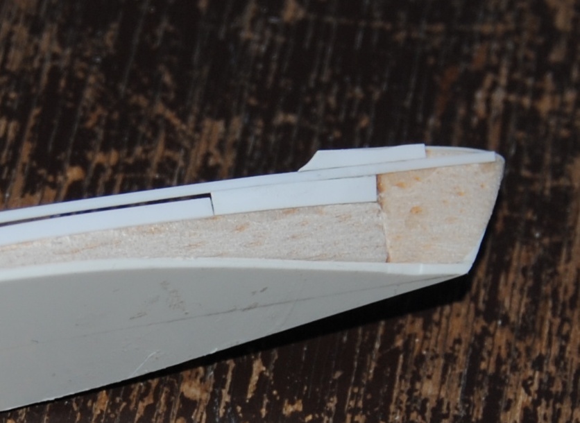

I'm making use of the fact that balsa has less resistance to carving and sanding than styrene so I'm able use the styrene as a guide. This is a fairly easy process, the problems lie mostly with getting the sheer line right. And I will plate the hull off course.

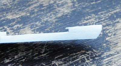

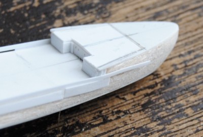

Time to work on the bulwarks. As Straat Cumberland is a three island ship I have relatively short main deck bulwarks with limited sheer. Evergreen strip is rather flexible so I decided to represent them by 1 mm strip and use the flexibility of the strips to follow the sheer line. First I glued the strips to the center and foc'sle. After that I carefully build up the plating on both sides in 2 and 3 mm strips while cutting the curvature in the curtain plates and making sure there was some space left at main deck level.
As this would leave the joint between bulwarks and curtain plates very fragile I added some reinforcements to the inside of the bulwarks.
And then I simply started adding more and more styrene strips to the hull.

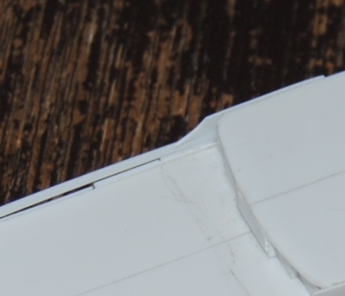

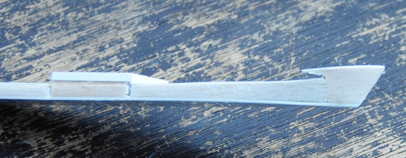

The poop bulwark refused to cooperate and had to be rebuild a few times.
But was plated in after being frowned upon.
When plating I worked from the poop forward, adding styrene strips in about 7cm long strips while following the sheer line. As you can see the pattern is not perfect in the ends but this was also the case in real life. I hope some of the plating pattern will remain visible after a few priming, sanding and priming cycles. When I reached the stem I stopped for now. Straat Cumberland had a rolled plate stem which cannot be plated directly but will be shaped from .3mm styrene sheet.

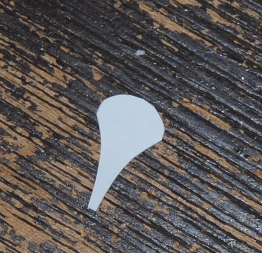

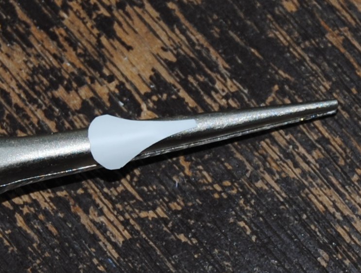

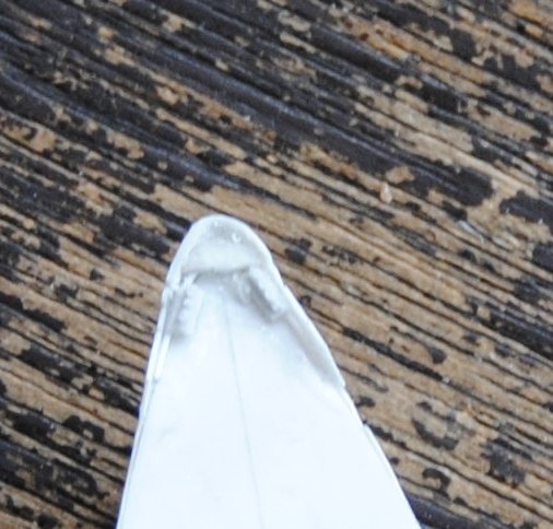

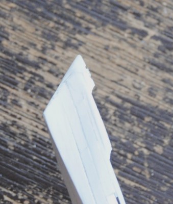

Yesterday I build added the stem. A rolled plate stem is always a bit difficult to build though this time its relatively easy as I did not have deal with an outward flare above the hull line.
A shape which consists of three half circles was cut out from .3mm styrene sheet. This was heated a little and pushed into a conical shape over some pliers I had lying around on the workbench. After this the plate was pushed and glued in place on the stem piece of the hull and it was cut down to the right height. This phase is always critical in terms of fit and I used three different plates before I had it right. Styrene is cheap....After that I started to sand the plate so it blended in with the hull and the bulwarks behind it, which are vertical on the Straat ships. As my bulwarks were bit thin and fragile I put a little flagpole platform and the roller fairleads in place behind them as a support. Next phase: sanding, filling and sanding again....

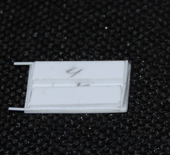

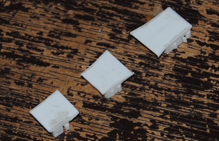

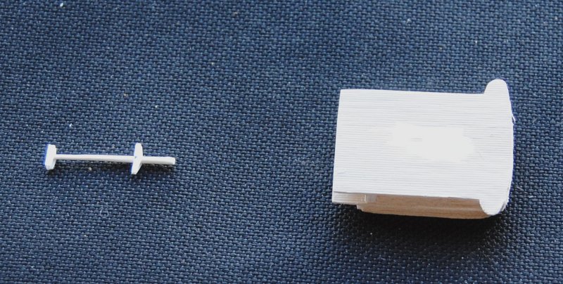

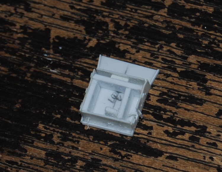

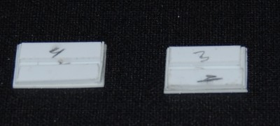

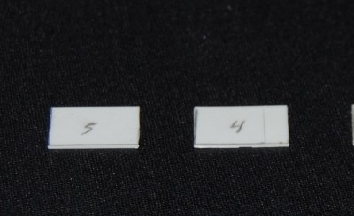

The past week I've mostly been filling, sanding and filling again. Important but visually uninteresting work. Yesterday I started to work on a sub assembly set, the cargo hatches.
Straat Clarence had 5 McGregor hatches. John Bowen gives you good drawings and sizes for these things. After some thought I decided to build them in layers. First I cut out the upper layer in .5 mm styrene plate. I glued two strips of 1.09 mm styrene (Evergreen HO strips) to them while leaving about .3mm to the sides. The ends were filled in with .3 mm strips. The hatches were turned over and I scribed the pontoon edges. Hatch rails were made of .3mm styrene rod and glued to the sides and the hatches were set aside. Hatch 2, 3 and 4 had their rails attached to the winch houses next to them so they will be built next.

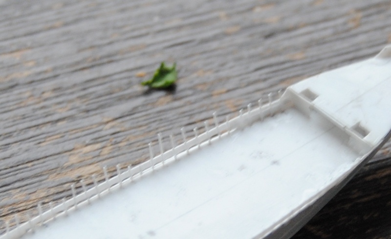

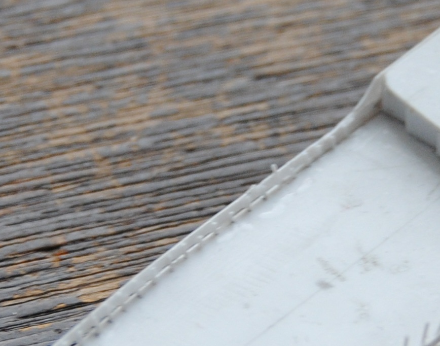

Now that I'm happy with the hull shape and plating I've decided to tackle the next step in hull construction, the bulwark supports. On my previous Straat C project I tried to achieve an in scale appearance by folding cut down PE railings and glueing them to the inside of the bulwarks, adding Krystal Klear to the corners to get the three dimensional shape of the supports. The result looked like this:
I tried to do this again but kept getting 'wobbly' and uneven support stanchions. I tried John Bowen's method of using small paper triangles and got even more wobbly results.
I was not very happy with this so I have decided to use Momoon's method even though this means the stanchion thickness will be slightly over scale.
Using the deck plans as a guide I drew the support positions on the deck with a sharp pencil and glued .3mm square styrene rod to the sides. The tops were cut off flush to the bulwarks using a nail cutter. And the process was repeated on the other side of the deck. I find that this is a surprisingly quick and easy way to get convincing bulwark support stanchions. Thanks Momoon!

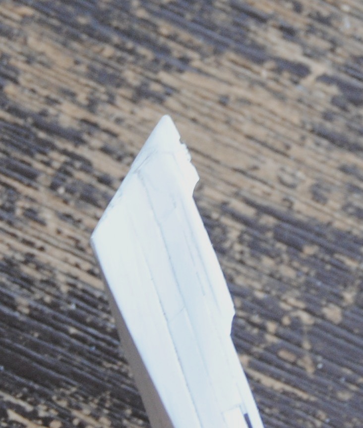

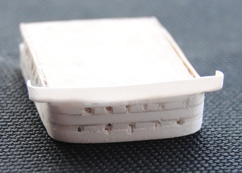

The superstructure took some time to work out as I wanted to get recessed windows, which will be glazed using Krystal Klear later. After some trial and error I did this:
First I put in a sheet of .3mm stryene and built up the curtain plated over it. Then I build up al the windows in 1 and 2 mm styrene strips: And I drilled out the windows. For the front windows I put in some extra layers as the superstructure has a slight 'streamline' form so the front leans backwards a bit. Next: priming and sanding again...

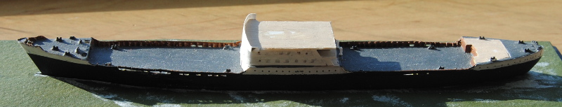

After 2 years (aaaarghhh!) I've been bitten by the building bug again having found some nice watercolor paper to work with.
So Straat Clarence has a water base now. I'm also finishing and painting the superstructure now. In the first picture the funnel and aft superstructure haven been placed on the hull and have not been glued down yet.
