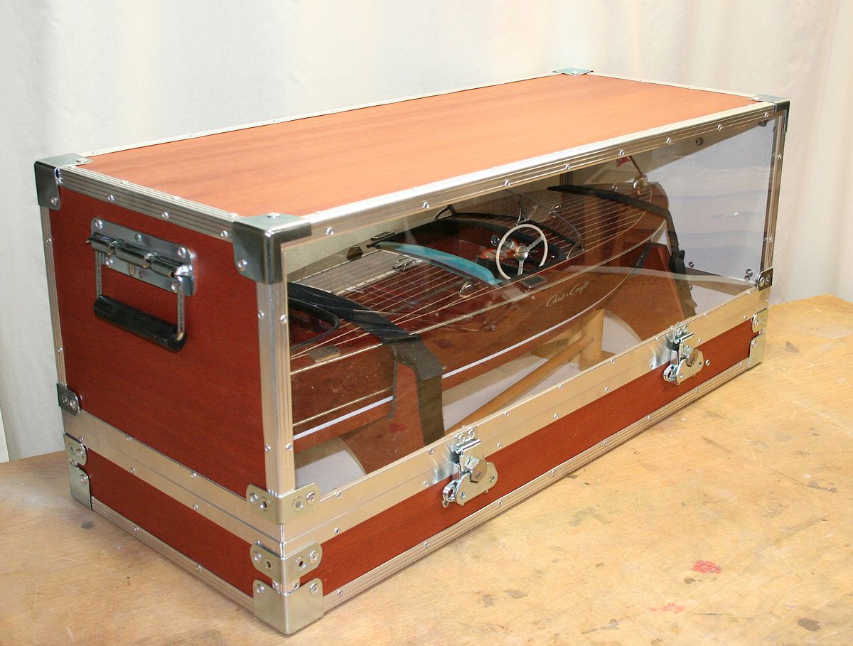

See my Road Cases thread at RC Groups:
http://www.rcgroups.com/forums/showthread.php?t=1785839
One of my cases
One of my cases

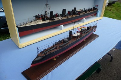

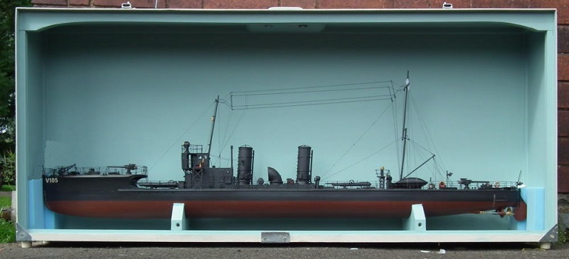

The base of my boxes are 20mm thick fir, Everthing else was 4mm ply. I built the boxes up wards from the more substantial base timber. Each panel simply overlapped at the edges and was glued (white PVA wood glue) and pinned with 25mm moulding pins (very fine panel pins). Some corner joints were then reinforced on the inside with 10mm square softwood glued in place. When all the glue was dry the outside corners and edges were dressed with a belt sander (nail heads too). The side was designed to drop in place at the bottom and lock with over centre luggage catches. Lifting handles were fitted on each end (top centre for smaller models).
Inside I fitted two permanent wooden cradles (lined with felt) for the model to sit in. A close fitting foam block inside protects the bow and stern, and the model it gently clamped between one on each beam, when the side panel is fitted in place.
The display stand for the model is also secured inside the box (fastened to the inside of the lift off side panel).
Metal corner protectors (designed for things like speaker and amplifier cabinets) can be added to stop the sharp corners sticking in you or your car upholstery. Four small rubber feet stop the box sliding around and luggage straps can be looped through the carrying handles to lash the box down while in transit.
I been all over the UK and (so far no damage in transit).
I usually finish the boxes off with a couple of coats of paint (blue looks good inside I don't know why) applies with a small brush and foam roller.
I attach a picture or two.
Model in transportation/storage box with the side removed.
Bow, stern and both beams protected by internal foam blocks.
