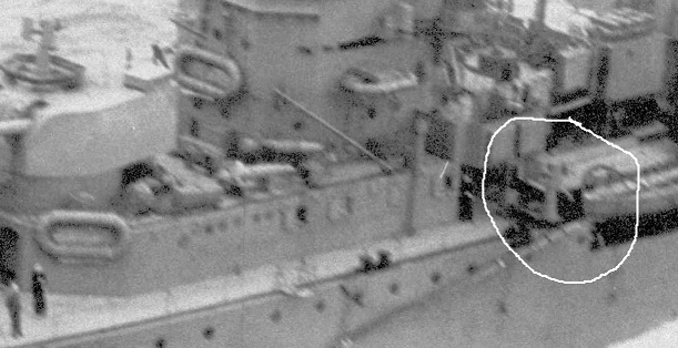

As per C.B. 01815B, in September 1941 Aurora had 6 x 20mm.
These were: one on B turret, one on Y turret, two on the quarterdeck and one each side of the bridge at deck level just forward of the fo'c'sle break as seen in this photo taken on 10th September 1941:
- Gernot
- Posts: 654
- Joined: Thu Sep 08, 2005 7:53 am
- Location: Tokyo, Japan
Re: Calling all Arethusa class fans
That is a great photo, a nice confirmation of the positions. Oh how exposed those guns were before the tubs were installed!
