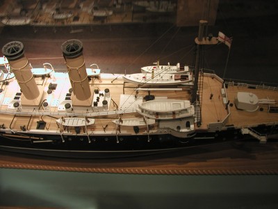

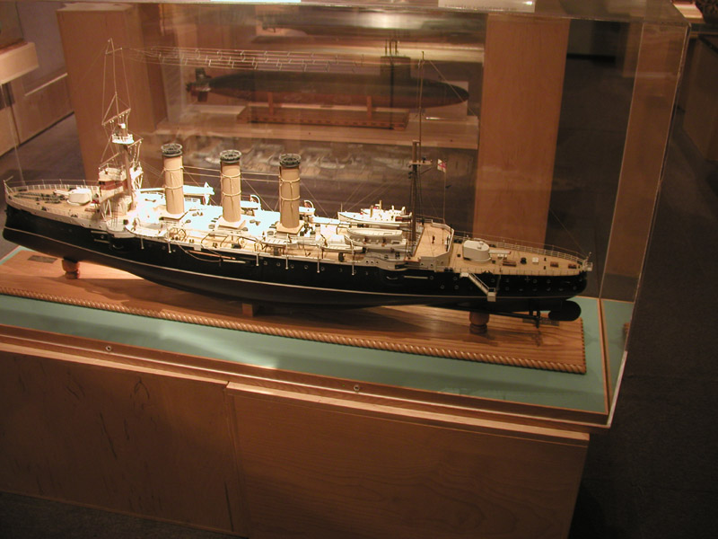

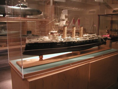

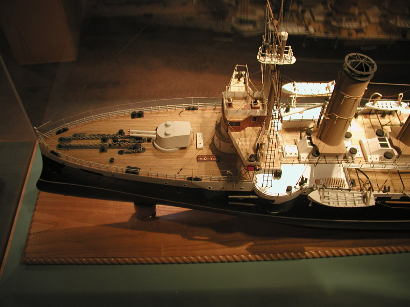

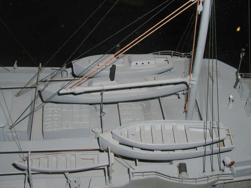

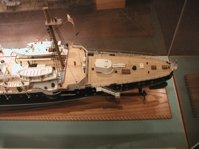

Here are some shots of a model of HMS Kent that was at the Granville Island Sport Fishing Model Ships and Trains Museum, which is now closed.
While not a builders model, it is very well done.
George
George

Thank you for the photos!
There are also no light guns on the after superstructure. Are the ones next to the forward two funnels correct? Especially the one next to the middle funnel?
It is interesting that there are a lot of models of the Drake class and County class featuring the Victorian painting scheme, whereas I have only seen photos of some of the real ships, which had this during their trials (with incomplete armament). The RN switched to grey camouflage about the time these two classes were built.

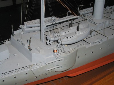

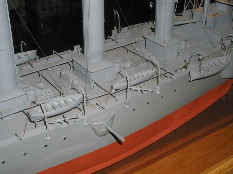

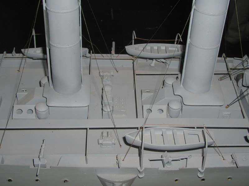

Here is HMS Kent in grey. HMS Kent at HMCS Naden, the training base for HMCS Esquimalt just west of Victoria B.C., is a hand made model representing the ship after her repairs from the Battle of the Falklands. Once again a different representation of the small arms.
George
George

Hi George,
these photos of Kent are wonderful and very helpful - many thanks for posting them. It is amazing what is out there in the form of large-scale models. I remember there were at least two of these builder's models at my naval boarding school in England but I can't recall (after 40 years) what they were.
At least my Monmouth is out of the box now and about to receive her bath in soapy water before I get on with building/painting.
