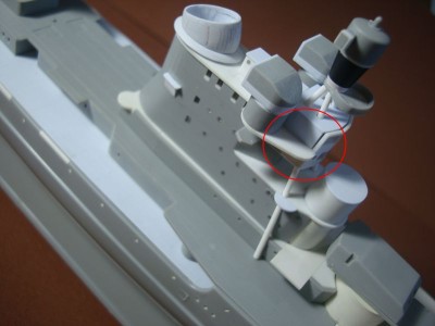

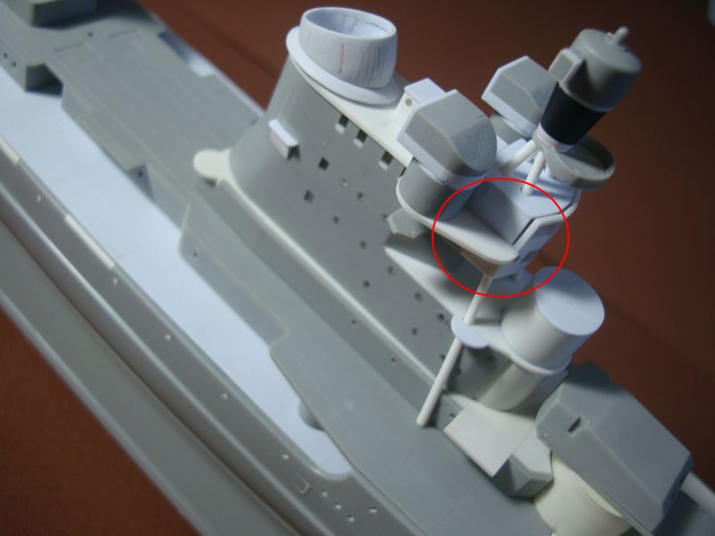

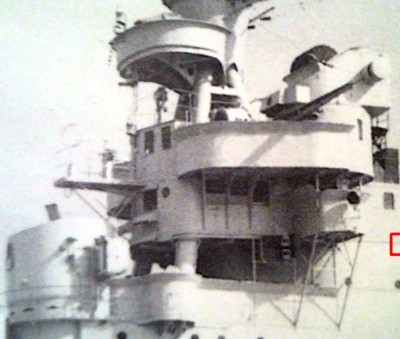

- Initially I was interpreting this top cabin with this configuration:
- But after seeing this Zara's superstructure picture I changed my mind about it. Comparing this picture with some pictures from Zara class cruisers from the Life Magazine's pictures sequence. I concluded, Pola probably had the same top cabin configuration used on Zara.
- And the new top cabin.
- Fitting some parts at this superstructure is very critical, I added some devices on pieces to facilitate the future assembly.
- And a dry fitting with the new pieces on it's places:

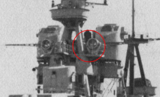

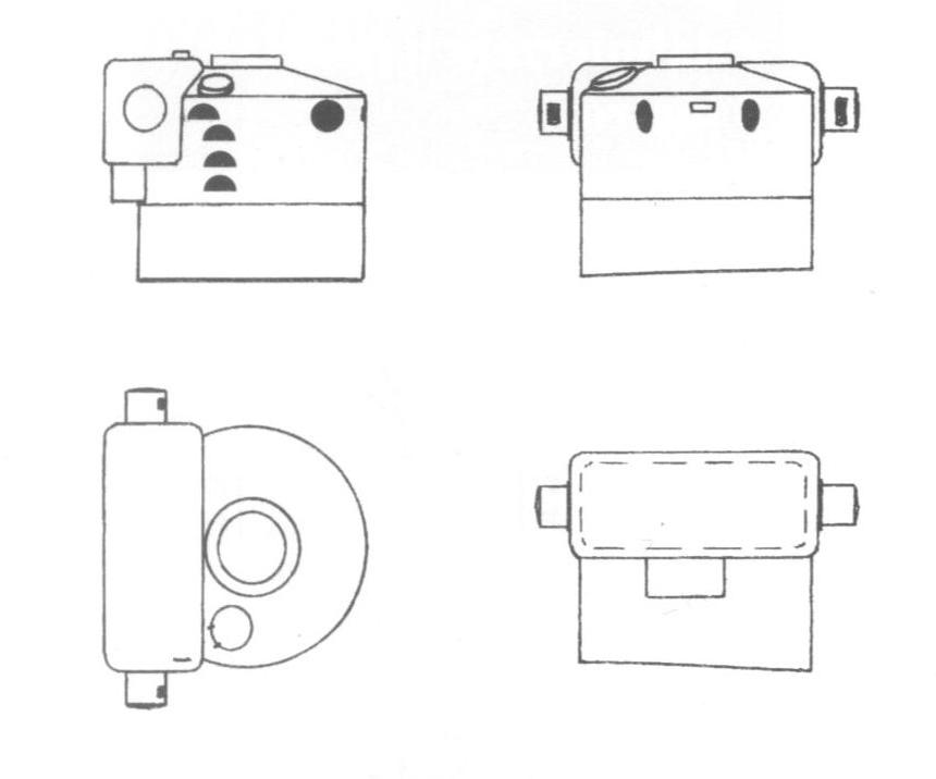

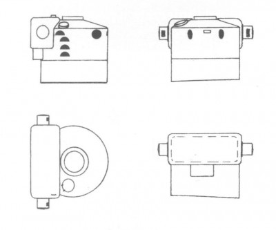

Before it's too late to do something: the AA fire directors are still off; in fact, the kit's part may well be trashed at once. The real thing was a cylinder with a conical roof and a box on the back for the rangefinder.
From Zara's Profile Morskie
R.Ricardo
Posts: 255
Joined: Thu May 16, 2013 10:21 am
Re: RN Pola - Mini Hobby 1/350
Post by R.Ricardo »
Secondo wrote:Before it's too late to do something: the AA fire directors are still off; in fact, the kit's part may well be trashed at once. The real thing was a cylinder with a conical roof and a box on the back for the rangefinder.
Hi Secondo,
I agree with you, AA fire directors from kit are terrible. But unfortunatelly the model you showed in this drawing was used only on Zara.
Pola used another model with a very different shape:
Best Regards,
Ricardo

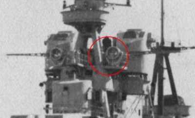

Secondo
Posts: 1246
Joined: Fri Jul 11, 2008 6:24 am
Location: Saint-Andiol, France
Post by Secondo »
My bad, I should have checked my references more attentively :heh: Sorry for the misleading!
Digging into the matter, I found that this kind of director was used on Zara and Fiume; Pola and Gorizia had the "sloped" type with an opening on the top.
Edit: a good profile of Pola can be found here:
http://www.naviearmatori.net/albums/use ... 200%29.jpg
R.Ricardo
Posts: 255
Post by R.Ricardo »
Secondo wrote:My bad, I should have checked my references more attentively :heh: Sorry for the misleading!
Ok, you're correct, model used in Gorizia looks much more like the used in Pola and I can use some pictures from it as reference.
I agree this profile is very good, but I see some inconsistences in it's AA fire directors format when comparing it with pictures.
For me the better Pola profile I know was this one published at Warship Pictorial 23 and replicated at Hobby Boss Pola edition. But unfortunatelly it don't show a lateral profile from these AA directors.
http://www.1999.co.jp/eng/image/10087075t2/60/2
Best Regards,
Ricardo

The range-finders look good but the inclined plate on top is probably too straight. IMO, looking at the sparse pics I found here and there and there seems to be may be a slight curve, some kind of concavity, or at least a more vertically inclined flat surface with a dent somehow smaller then the inclined plate probably housing observers with binoculars. I can't tell exactly, I'm sorry.
The new configuration of the upper tower, just below the main range-finder does not entirely convince me... Looking at the pics of the Pola, (chek some on my project and some on this same tread, seems to indicate two things: first of all it was a later addiction, not present before 1937, On those pics which show the structure, the main tripod seems visible anyway, meaning it was not completely inside the structure itself. If you check on early pics there is an horizonatal welded plate jut before the two rods of the main tree join, which could have been used as a rail to close the metal wall. IMO the walls of the cabin were just metal panels welded between the tree structure, and not a whole box containing the tripod itself...
Check your references and tell me what you think.
Keep on with the good work

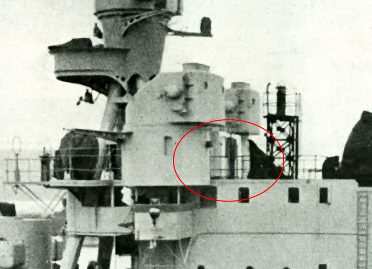

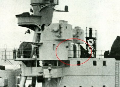

R.Ricardo
Posts: 255
Post by R.Ricardo »
Ramaja wrote:Hi R.Ricardo, very clean job as always.
Hi Ramaja,
About range-finders, may be you're correct. Like you I suffered with the lack of good plans and I only sketched it's general format until I have more elements for a definitive conclusions about it. I asked you for more pictures from your work at your post, to use them as reference and comparation with my own researchs.
About the upper tower, yes, I agree with you, its a latter addition as you said. But my conclusion about it had involved the four masts was based in what I'm seeing in the pictures below.

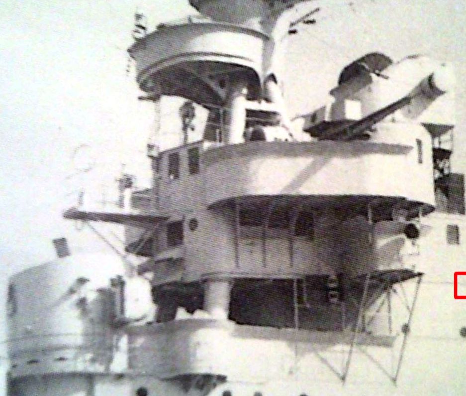

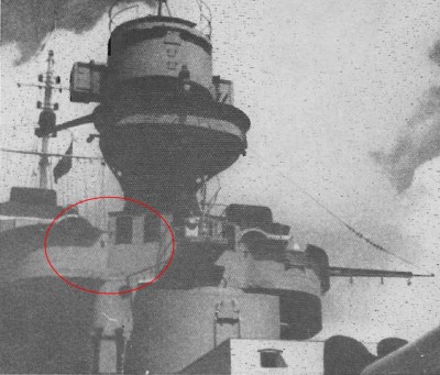

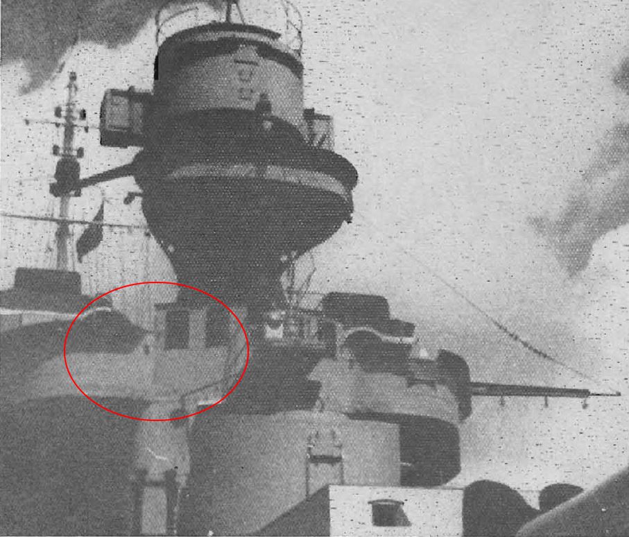

- The 1st one is the same from Zara I posted above, that pointed to me the direction I needed to see in the other pictures to have my conclusions.
- The second is a detail from a picture from Life Magazine, that show in sequence Fiume, Zara and Pola. Observe the same door I pointed (1) at picture above is barely visible at Pola upper tower. It seems for me, there was some similarities between Zara and Pola in this tower.
- The third is this picture with Pola behind Gorizia, here we can see this tower from rear. Seems for me this vertical line I pointed is the corner I pointed (2) at Zara's picture.
- Here a detail from drawing published at Warship Pictorial 23 - Italian Heavy Cruisers Of WW2. It's the same drawing now issued with the Hobby-Boss edition from Pola. I checked this drawing with pictures evidences and perhaps it's not perfect, but until now it's the better Pola drawing I found. Observe, it show the same conclusion with this tower involving the four masts.
And finaly a drawing from another source (http://www.naviearmatori.net/albums/use ... 200%29.jpg), showing the same interpretation:
I agree nothing I posted here is totally conclusive, but for me it's a possible interpretation for this tower format. I continue with my mind open to continues this discussion with some new evidences.
Best Regards,
Ricardo
Ramaja
Posts: 44
Joined: Tue May 28, 2013 12:54 pm
Location: Rimini, Italy
Post by Ramaja »
I'll try posting better pics from my range finders tomorrow, but I'm not that much convinced of them as well.
About the drawings from warship pictorial, it depends on what you are trying to reproduce: this drawing still shows 40mm Vikers Pon Pon and the Pola was changed again just before the war.
The forward part of the structure you did (with the forward windows) is correct IMO, but I have doubts about the rear new part you added: the pic in colour you showed with the four aligned ship is From the Rivista H in 1938, just before the mayor re-haul of the ship (it is missing the whole rear structure we are discussing. As far as I can tell, there was a narrow observation front platform which was protected with windows after some time, but was not extending rearward at the beginning. then the rear cabin was created and it was inserted between the quadripod rods.
The rear view of the ship in the pic below. shows the peculiar extension of the cabin on the large platform which embraces the forward funnel, not much different form what you did in the first version of your superstructure.
The reason I'm so interested is that I'm not really sure of how to do that and may be I'll change my own again
I'll try to check my references tomorrow to better focus the problem, but I'd not trust the Warship pictorial plan: it is a mix between 1934 and 1939 Pola with a lot of speculations in between.

Ramaja wrote:I'll try posting better pics from my range finders tomorrow, but I'm not that much convinced of them as well.
OK Ramaja,
Post your range finders pictures and we can discuss it's format, perhaps together we take a good conclusion about it. May be drawings from Pola was influenced by Zara's configuration like me. But without a good evidence in other way, I think it's a possible interpretation for this tower. I'll wait what you find in your references too before a definitive conclusion. For me is easy to change something, if it will be needed, because nothing is glued on it's place.
Here some pictures from Zara's rear tower for comparations.
And a detail from a snapshot from Pola at a 1938 parade Luce film I take. May be it's the same corner again pointed here.

Let's see if, with a bit of brainstorming, we can come out with an acceptable solution for this ship...
One peculiar aspect of the Pola in respect of her sister ships is the presence of the two light projectors on the main structure just forward of the two side range finders.
The other ship were differently arranged there meaning that probably more space was available up there. My suggestion is that, because of those elements, the bridge enclosing under the main range-finder had to shrink down just after the front observation windows, meaning that structure configuration could resemble more your first version rather that the new one.
The two drawings are totally unrealistic because in the colour one the ship present different aspects at the time (40mm Vikers installed and no 120mm but with an extended upper bridge) meaning it's not a faithful representation of an original Photo.
The second one has (impossibly) a door which opens exactly in front of the quadripod spar which means it's useless and lacks the Light Projectors entirely.
Try dry fitting all the stuff you see in the original pictures on the bridge you have designed and let me know if you do not come the my same conclusion ;)
Gianluigi
Here you see how this pic shows the presence of both the light projector and the enclosed structure: if you check the original photo (which is posted somewhere here or on the discussion on my own build) the illuminating 120mm is already installed, meaning the ship is in it's late building stages. You can see the quadripod rod is well visible and not encased as you did on your last version.
Here you can see as, in it's early stages (Venezia about 1930) the ship already has a built in structure, albeit a shorter one between the side range finders
here is another pic, of the early stages: you can see how large and how close the light projector is to the forward rod of the quadripod, meaning there is little room for movement around it. Cheking the first pic, the Projector looks in the same place
Now a pic of your last version of the structure. There is something weird because: 1 there is no room to move for the crew inside the box between the rod and the wall (being it almost in contact at floor level); 2 there is no more room for the large Light projector on the external platform.
Here is a (bad) pic of the Ship in 1938: given the perspective of the photo, I'd espect the side of the bridge cabin as you built it should be visible (check the main turret side) instead we can only see the sky and the rear tree wiring in that location even between the two side range finders.
