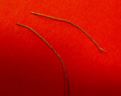

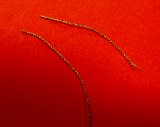

This is definitely a proven method. Armor modelers use multiple strands to make tow cables and two stands can be used to make chain.
This pic is some leftover that I had from my USS England build. It is two strands of .006 brass wire tightly twisted together then squeezed along its length with smooth jaw pliers.

Will give the wire twisting a try. Where do you find .006 brass wire? Do you mount it in a pin vise or drill for the twisting.
