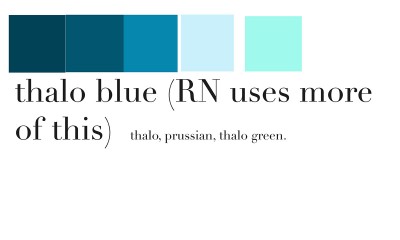

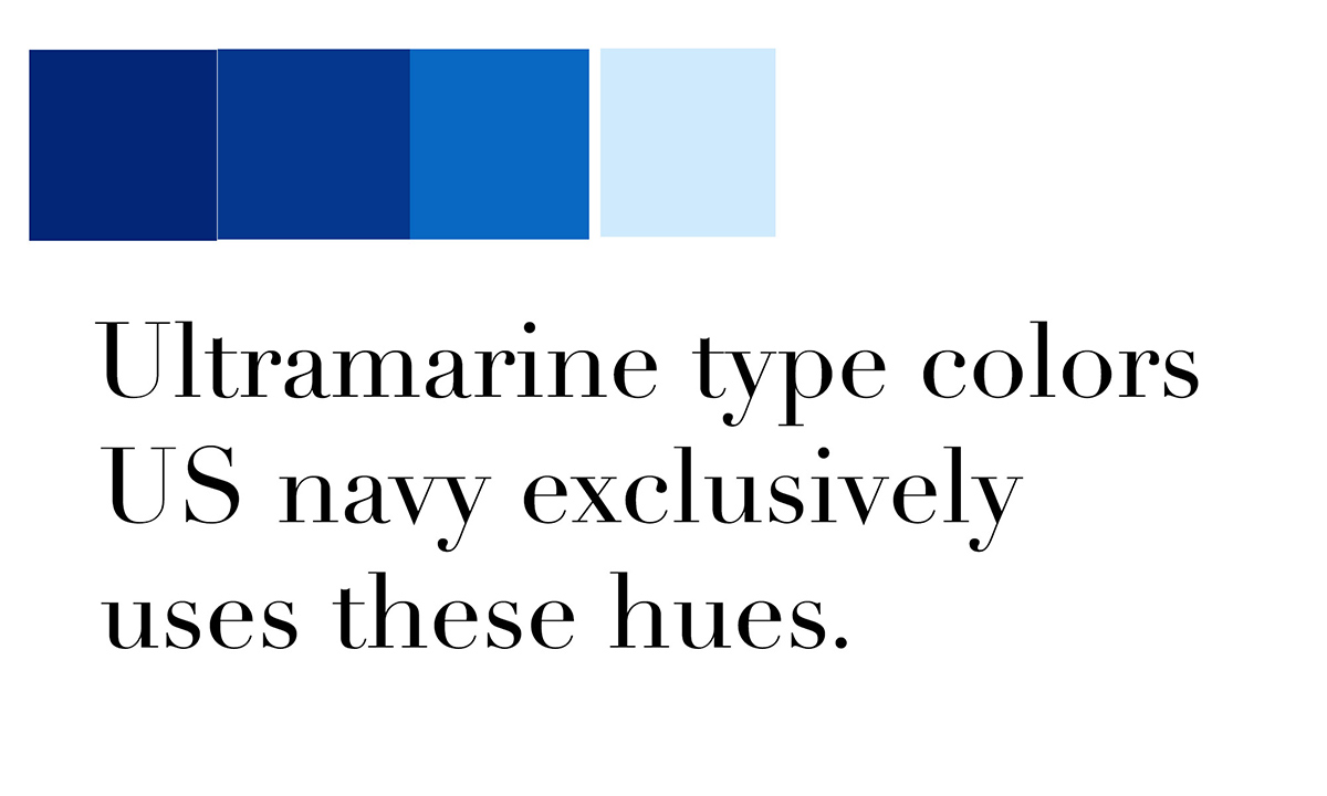

For ship modelling and most military applications, there is only one thing you need to know about Primaries, specifically blue. In not so technical terms, there are blue pigments that have a hue like blueberries and bluejeans, and there are blues that are like turquoise and indigo. When considering a mix, it is crucial that the correct type of blue is used. I'm picking on blue because In ship modelling, blue is the primary color that is used the most. Each primary color (red, yellow, blue) have vastly different types of pigments that represent them. For example, some reds are like santa's suit whereas other reds are more like a cherry. This would be the difference between say Cadmium red medium and Quinacridone red. Back to ships, in a nutshell, the RN used a combination of both turquoise (thalo) blues and Ultramarine blues; the thalo aspect which giving them their distinctly turquoise appearance while the US Navy seems to have no thalo (turquoise) based colors.
Turquoisy blues:
Thalo, Prussian, thalo green,
Blueberry blues:
Ultramarine
Kind of like both:
Cerulean, Cobalt
Using the correct blue in a ship mix is crucial.
RN= turqoisy+ultramarine
US=Ultramarine
As ship modellers, blues and greys are our most predominantly used colors. Understanding the look of the root colors will help you to understand why a color isn't looking correct. In most cases when it comes to bluish tints, the culprit is the type of blue used. But that's not all; which leads to a discussion of WHY colors are incorrect and understanding with greater accuracy what the problem is.

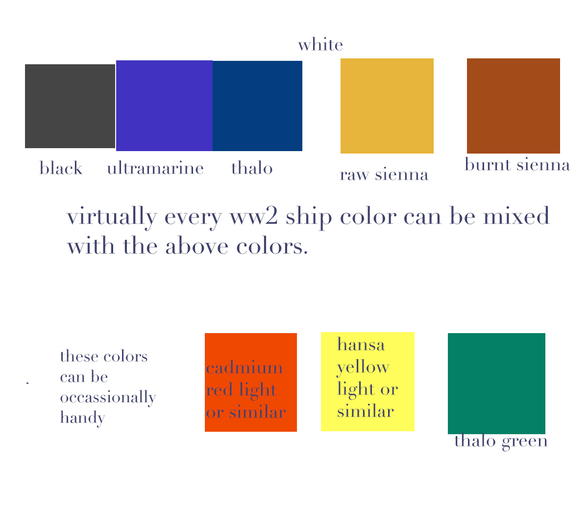

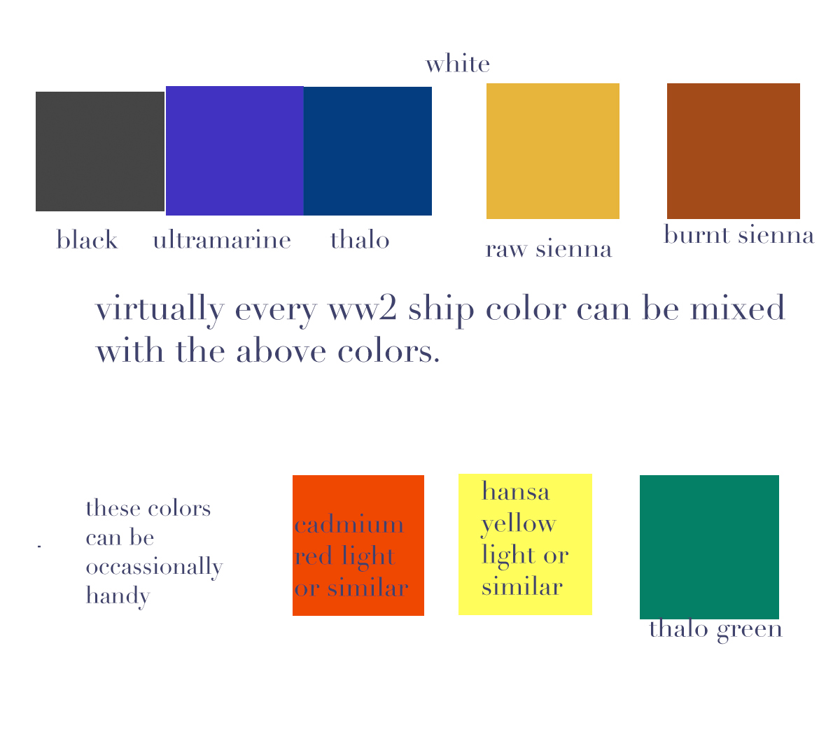

As I mentioned before, as well as pigments for the primary colors, there are also pigments that are know as 'earth pigments'. These pigments are usually derived from minerals that yield softer, more earthy tones such as red oxide, browns, and ocher colors (woody yellows).
These earth tones are used extensively to modify and adjust the chroma of the more vibrant colors. Interestingly, the red that hulls are painted were often the earth color red-oxide lead. This pigment was cheap and readily available hence its use. In photos, the red can look quite vibrant. In real life, it would have definitely appeared more like a moderately intense reddish rust color.

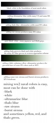

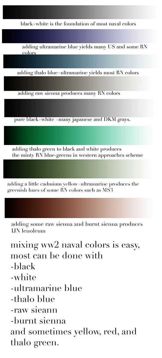

Mixing and understanding Navy colors.
Most WW2 naval colors begin their mix with black and white to make gray. Some grays contain more white, some more black. But neutral gray is the backbone of most naval colors. If you were to mix a ship color, this is the most effective way to begin the mix. To this mix, other colors are added to yield the final color. What colors? Well, military colors are surprisingly easy to understand and mix. Virtually all military and ship colors can be mixed using often just 2 or 3 of the following pigments:
-White
-Black
-Ultramarine Blue (blueberries)
-Thalo Blue (turqoise)
-Burnt Sienna (functions on the color wheel as red). It's a brick/earthy tone.
-Raw sienna (functions as yellow on the color wheel). It's an ochre type yellowy brown.
-Occasionally primary yellow (cadmium yellow light or equivalent) Lemon yellow.
-Occasionally some kind of bright red (cadmium red light or equivalent). Santa's suit
-Occasionally for RN colors Thalo green.
Nearly every commercially produced military color is a grey base with the addition of only one or two colors...usually an 'earth color' (burnt sienna, raw sienna).
I recently was commissioned by a guy to mix him jars of every single RN and US color as they appear on Snyder and Short's color sample sheets. Most, or rather all of the colors had this kind of mixology:
black+white= 507C
black+white+ultramarine blue+thalo blue=B6
Black+white+Ultramarine blue+thalo blue+raw sienna=MS3
black+white+ultramarine blue=US navy deck
black+white+ultramraine blue (different quantities than US navy deck) = most US navy camouflage colors.
Etc. etc. etc.
Glancing at the IJN sheets, most of those gray mixes are black+white+blue. I'd have to do some mixing to assess if the correct blue is ultramarine or thalo in nature. Regardless, easy peasy.
Decks:
black+white+raw sienna (depending on quantities will make a lighter deck)
black +white+burnt sienna+raw sienna (teak)
So you can see how simplistic and repetitive these mixes are. After a while, I was able to simply glance at the Snyder and Short color sample and instantly know the mix.
Given this, I find it interesting how many colors are available to the hobbyist and am shocked by how many of those colors are simply the same colors over and over again with varying degrees of white or black!

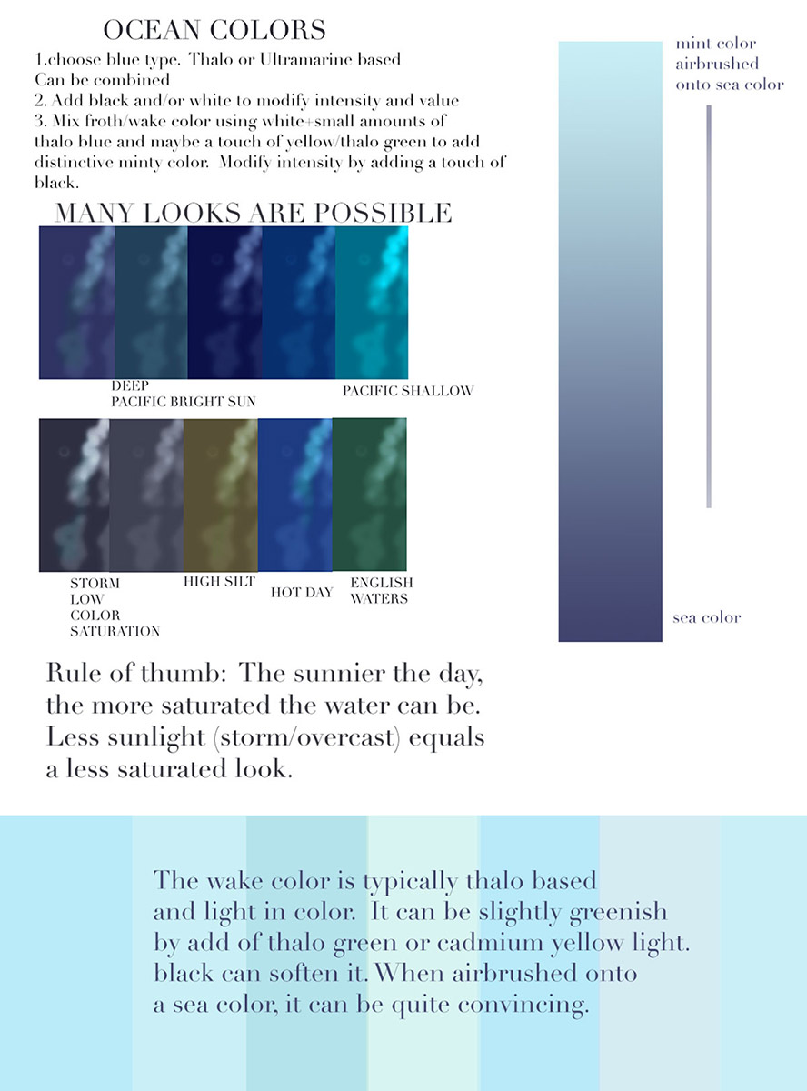

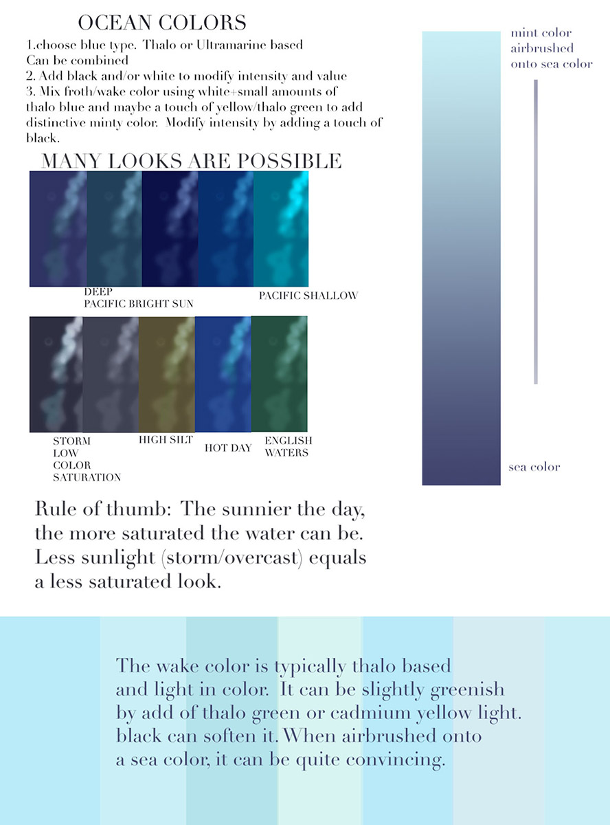

Ocean Colors
The sea can be painted in a vast range of hues and values.
When mixing a sea color, you have to consider the darkness or lightness of the sea and it's blue-base (thalo or ultramarine based). They have different looks. Predominantly, the ocean is a combination of the two leaning towards thalo bias. A typically 'blue' sea in it's rawest look is quite close to Cobalt blue.
When mixing an ocean color, first choose what blue you want to use. If you want, you can then add black and or white to this blue to modify its intensity and darkness/lightness. To this mix, you can then add an earth color; either raw sienna or raw umber. Of course, any color can be added, but you'll be amazed at the versatility of simple 'earth' colors.
The wake color is that minty, frothy color of the sub-surface churn. It is most often a soft, light value minty, thalo-based green-blue. Much like mints in a jar. Technically, this color occurs as a result of white foam that is under a few feet of blue water resulting in a darkened hue. The sun, in combination with greenness of the water produces the minty quality. Sometimes, the subsurface churn is simply a lighter version of the sea color. I made a chart that describes this all visually and provides some ideas for different ocean colors.
Rule of thumb:
On an overcast day, colors are less saturated and appear more gray. Rich color saturation is a product of more intense light. A stormy scene might benefit by having many greys and low intensity minty colors in the wake. A hot, sunny day in the pacific might have more intense blues and a more punchy mint color in the wake.
The diagram says it all.

You're absolutely correct about letting the Devil have the details.
To this I will add one thing:
There is probably a fair bit of variation in the original colors....mixing their own paints aboard, slight differences in batches, etc. However, one thing that should be correct and likely wouldn't change is the nature of the blues used. While the value of the color and the overall chroma can be off by slight degrees by virtue of quantity, the exact blues in the mix should be right or the color will be incorrect for the given navy.
Black+white+either pthalo blue or Ultramarine blue (or a bit of both) is the largest determining factor in mixing ww2 navy colors.
Total speculation alert for the following:
At some point it was decided what colors and patterns the ships would be painted in. The artists/designers who came up with these ideas did their initial work on paper or canvas using artist's paints. I assume these plans were then handed to contractors who make paint. Depending on the availability of certain pigments and given the large quantities needed, the correct material sourcing would have been nailed down and adhered to for long periods. The colors in multi-paneled schemes would be based on tints of the same base colors to keep it simple. If you analyzed these paints closely enough from a mixing point of view, I'm certain (and actually came to realize when I was mixing all the S&S chips) that they're all based out of a small number of root colors that have been lightened or darkened. 90% of them black, blue, and white. The purple you refer to that the US navy was given to mix their own was most likely a very dark, ultramarine based blue with a bit of black in it giving it a slightly purple hue. From this, they could easily mix lighter tints with white...giving you the classic USN colors.
