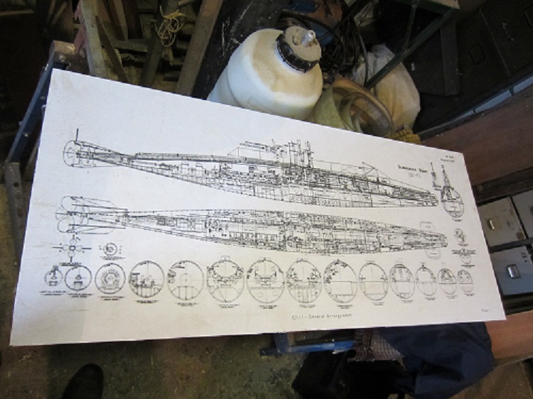

The enlarged plans were pasted onto a board. This kept them nice and flat as they migrated between the house and the workshop.

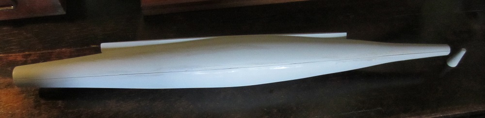

The basic turned hull plug. It has just been primed to seal the surface. The tail section has also been turned but I have yet to make the nose/bw piece.

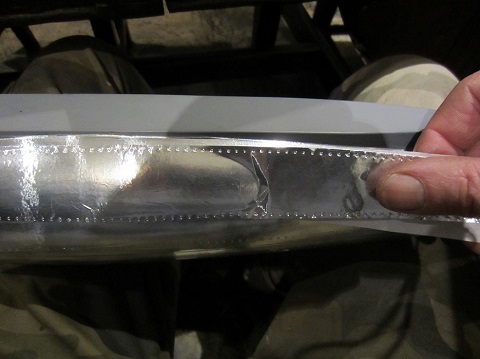

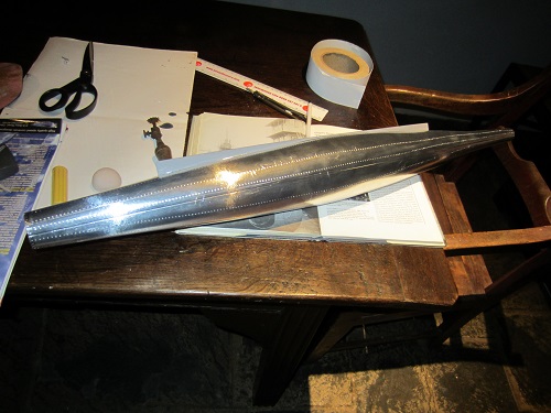

Having turned the very basic wooden plug and primed it. I next marked on the position of the joints in the hull plate lines. I wanted to eventually produce a GRP hull with much of the surface detail already moulded in, the same as the other GRP hulls I had previously made.
The next stage is to add hull plates.

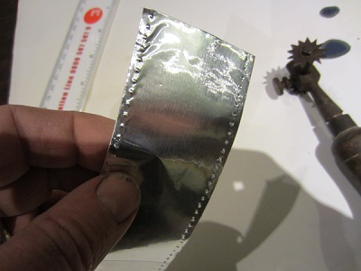

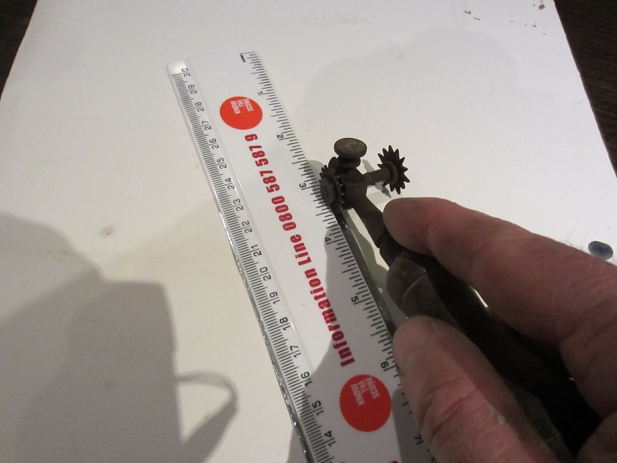

To produce the plates I again resorted to adhesive aluminium foil tape. The rivets on these subs were countersunk flush, but were still visible. Experimenting I discovered that a very old marking wheel used on the reverse of the tape gave me raised rivets, but using it on the front gave the impression of flush rivets.
This picture shows the two processes, with raised rivets on the left and the flush on the right.
Using the marking wheel produces raised or flush rivet depending on whether you use the wheel on the front or back.
Running the marking wheel along a ruler near the "plate" edge is easy.

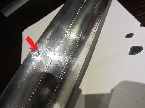

The aluminium foil tape is great stuff to work with. It has a very sticky adhesive and will stick like fury to any dust and grease free smooth surface. The huge plus is that with it being soft metal you can (with care) make it conform to curved surfaces, and in particular to surfaces with a double curve like this submarine hull. I cut the tape to shape first with sharp scissors then embossed in the rivets from the shiny side. Starting at one end I then laid the tape in place pressing it down along the centre line, while pulling away the paper backing 1cm at a time. I took care to exclude air bubble towards the edges. The riveted edges were not burnished down, but smoothed into place with a finger. Any slight wrinkles can be burnished out with ones fingernail but pressing the rivets too hard makes them disappear!
The odd tiny air bubble can be dealt with by pricking it with a fine pin to let the air out. Each foil strip has rivets embossed only on one edge and this edge overlaps the previous strip by about 3mm creating the plate line. I decided when I had finished that the rivets were a little too pronounced so I slightly burnished them down using my fingernail.
The plating process was fairly quick and stress free.
A word of warning. The foil tape is quite fragile and marks easily. Putting the hull plug down on the table on top of a discarded tool or pencil marked it and I then had to burnish out the marks. Painted over it would make it strong enough for a static model but it would be no good as plating on a working model.
Each foil strip is laid over lapping the previous one slightly. The tape was pressed down from the centre outwards excluding air bubbles.
Here is the plating on the underside of the hull plug. The arrow indicates one of the two screws temporarily holding the two halves together.

I for got to say that when embossing rivets into this aluminium foil its best done on a slightly soft surface. I used an old magazine. The marking wheel was very effective and single rivets can be done with a ball point pen.
Lots of other small surface detail can be made with this stuff too like door hinges, reinforcing straps,inspection plates etc.

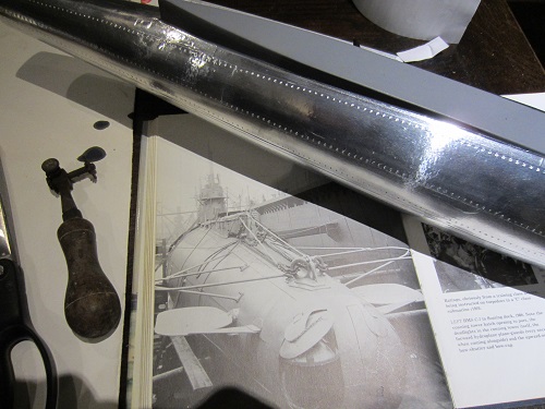

When the hull had been plated all over,I moved onto the raised deck section. Photos show this riveted onto the top of the pressure hull, so I carefully applied the foil along the sides of this section with a small riveted overlap onto the pressure hull.
The hull was plated all over before starting work on the raised deck section.
Contemporary photos were studied to get the plate and rivet positions as close as possible to the prototype.

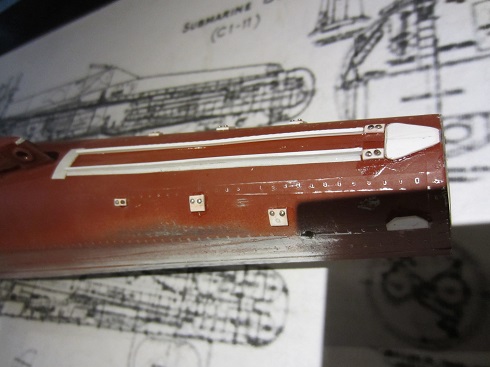

The main plating was completed before I used a sharp scalpel to cut along the centre line between the two wooden plug halves. The two retaining screws (underneath the hull) were uncovered and removed and the plug was split. It was easier to plate the hull with it whole. It will be easier to add the additional surface detail to the individual plug halves, as the thing keeps rolling around when both halves are fastened together!
You can see that I have started to prime some of the hull. I wiped it over with white spirit to remove greasy hand prints first. Car aerosol primer sticks to the aluminium foil well and also forms a good surface to CA glue on any addition detail. The CA glue melts the paint and drying time is quick whereas the bare shiny foil can sometimes slow the adhesive down.
The next question some one will ask is why bother painting it at all if it�s just a plug to manufacture a mould? Well the paint fills any surface scratches and gives a good matt finish which will eventually show up clearly where mould release agent has been applied. Miss a bit and getting the mould off becomes very difficult and will damage either the plug or the mould. Why red? Well it�s easiest to see faults and imperfections. I tried both grey and white but both were hard on the eyes.
The top of the hull has now had a single coat of car finish primer.
Here some of the surface detail has been added to the top forward section of the hull.

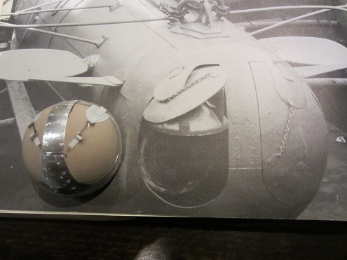

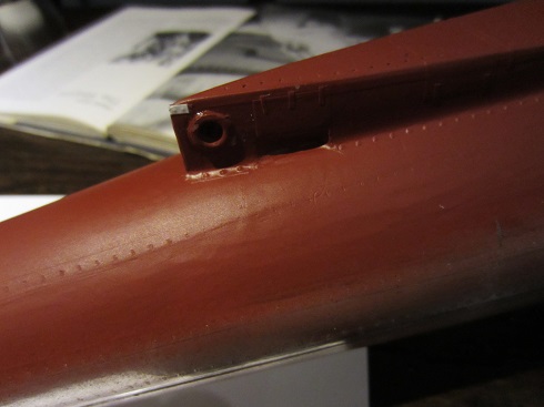

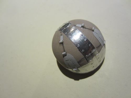

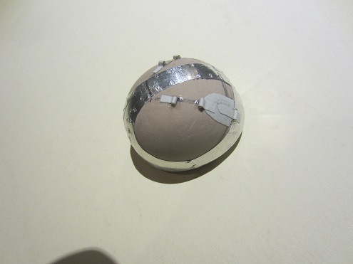

At this point I turned my attention to the bow and stern pieces. As I have already said, I thought it best to cast these as separate pieces. The stern is very pointed and will have to carry a prop shaft and 8mm dia casing, so needs to be drilled and I thought this would be difficult if it was part of the GRP hull. Similarly the bow has some fine detail and if it was GRP and there was a seam running horizontally through it, it would spoil the detail.
I used a piece of cast resin "model board" for the bow, turning it on the lathe so that it matched the front of the two plug halves (I also added a register to eventually fit inside the front of the hull mouldings). The plates, rivets, bow torpedo doors and other fine detail were then added. Studying the excellent contemporary photo of C1 in dry dock was invaluable. I cut the aluminium foil to shape then carefully teased it around the double curve of the bow to produce the plates.
I used fine brass wire, 0.25mm plastic card and two thickness of aluminium foil to create detail like the hinges. I know all this will reproduce well in resin.
Here is the partly completed master for the bow, showing next to the picture of C1 in dry dock.
The fine chains on the bow doors will be added shortly and they too will be cast in resin as part of the bow.
There is a register turned on the base that will eventually help locate the bow into the hull mouldings.

The Auminium foil looks like a great idea, far better detail than my plastic sheet or old business cards!! Until you make the point about damage, knowing my seamanship.
Will she be a kit? I could be tempted!

Doug
Yes I think even a carefully sailed model would risk damage to this quite thin imitation hull plating, however, you could use it on any deck structure, bridge, etc where plating might be required and it would hopefully be far less likely to be knocked. It has other advantages. If you are constructing in wood, after one coat of sealant or primer, the aluminium foils sticks well and obliterates all wood grain and texture. Subsequently painting onto the aluminium is easy.
In answer to your question, I hope to add this to my other kits, but don't hold your breath, and believe it or not there is already a waiting list!!!!. If we both had one we would have to come to an agreement regarding identification numbers. We can't both have C1 and sail at Glasgow. Of course there is great potential to modify this first batch C class hull into either a B boat or one of the second batch of C boats. I suppose I should eventually consider casting the different conning tower for the latter.
