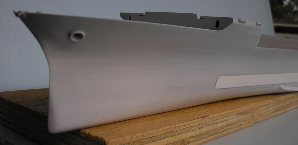

Starting down the second side having learned from the first side. It's going more quickly this side.. Here are some quick tips.
Sanding sticks are OK in some spots, but not in most. Use sanding shapes that mirror the area being sanded. I use some black rubber shapes that are convex and concave.
I start sanding in the center of the raised area first in areas that are concave using the convex (mirror) sanding shape. After the center thickness is reduced, I work toward the edge of the raised area. Just remember the plate is not flat if it is on a convex or concave part of the hull. Using a flat sandi;ng stick will not give you the correct shape without a lot of work.
I am starting with 150 grit and getting close, then stepping down to finer grits.
As you work, sight down the length of the hull. It should always be smooth with no bumps or valleys. Keep looking at it frequently so you don't create problems. Hull lines are always smooth and flowing.
By doing the above, I am going about twice as fast as the first side. The key is using the shapes under the sandpaper, not flat sticks, in the right spots. I don't recall where I got them, but I got a whole range of them when I scratch built my HORNET hull.

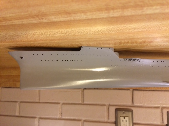

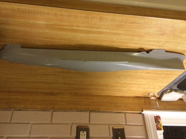

Re: Merit Yorktown Hull Plating "Fix" Photo Archive

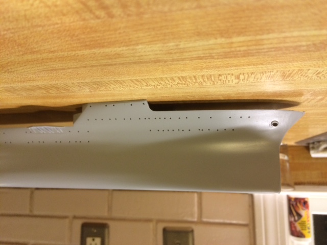

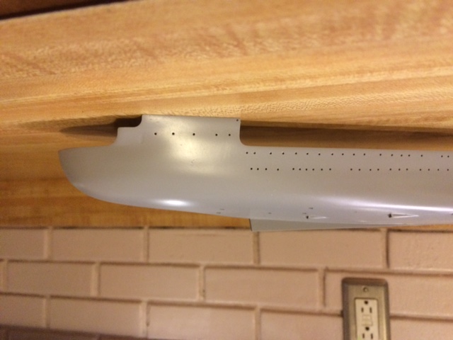

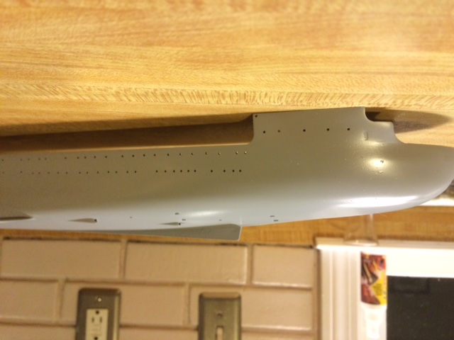

Okay, so long promised...
I hit it with a glosscoat to try to pick things up.
As I said in my last post, my technique was nothing but brute force.
I used some putty in a few areas to smooth transitions where I couldn't cut plastic. I used Mr. Surfacer 1000 to smooth out any areas where I couldn't obliterate my cut marks.
I'm ecstatic I finally have a hull for a 1/350 CV-6 at Midway. My excitement knows no bounds at all after all the pain of the Trumpeter Hornet release.
I went through some spells of irrational anger at whoever applied the hull plating. As somebody that does design work in 3D, it's easy for me to understand what was done (flat plating profile applied on the flat surface). I still got pretty badly tweaked as I sanded. And sanded. And sanded.
I wish I had a trick, but I don't. Only pitfalls. I nearly blew away one of the shaft exits and had to rebuild it. The outboard props are in an unfortunate area as related to the bilge keel and the plating- they're easily toasted if you aren't paying attention. I wasn't, apparently.
Take your time, sand under a water stream, and change your paper more frequently than you should. Apply putty where you can't make the lines disappear. Apply putty at the bow sink (apologies for no picture).
Try to have fun- the good part is ahead of me now, right? Right? ...?

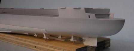

Sorry not to post sooner, I've been out of town for over a week and was not able to post pictures, just text.
For anyone who's going to the effort to do this, here are a couple more things to at least consider. When you get the hull smooth by removing the oversized plating, you have done a lot of work. There are a couple more things to consider - at least, I think are worth considering - once you have gotten this far. There are some distinctive features of the YORKTOWN hull you can add which will enhance the look and bring it even closer to the real ship. There are a couple of knuckles in the hull which are prominent and add to the character of the hull. One occurs where the shell plating under the aft 5" platforms meets the hull at the main deck / hangar deck level. Full disclosure - the first two pictures are taken of my HORNET hull in-progress. I have gotten close on my Merit YORKTOWN, but not to this point quite yet because of my travel.

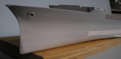

The knuckle is visible in this picture. Look at navsource's photo gallery for all the YORKTOWNs for additional pix.
There is also a knuckle halfway down the forward 5" platform shell plating at the focs'l deck level, half the length of the platform. It can be seen in this model photo, and in some ship photos when the sun angle is right. Trust me (or don't), it is there on the real ship and in the plans (MD Silver).
One final thing. As this picture shows (HORNET in drydock), the hull is actually concave under the aft 5" gun platforms. The red line in the picture shows, somewhat exaggerated, the concave curve, the knuckle, and the shell plating angle just below the platform.
How do you get these features in a smooth hull? Use sanding forms for the sandpaper that have fairly large radii and carefully sand the features into the plastic hull. I have used a piece of 4" PVC pipe, maybe 20 degrees of the full circle (as viewed from the end) and two inches long along the length of the pipe to get a wide radius convex sanding surface. The plastic model hull is thick enough to do this and provide a very good representation. Proceed carefully. Hold the hull up to a bright light frequently and look inside it so you can see if the hull is getting too thin before it's too late. Depending on how thin you sand it, you can laminate a piece or two of Evergreen 0.020 plastic inside to reinforce the area without distorting your work.
As far as the sink area in the bow, I am planning to push in a tapered plastic wedge into the void on the inside to push the hull outward at that point. This will also make it easier to thin the stem really thin. This is a theory right now until I actually do it. I'll report back when I do. Paul B used a good analogy in the 'April Fool's' CV-5 thread - the hull should resemble a hollow-ground knife blade at the bow. In other words, with the hull laying on the table and bottom side up toward you, the actual waterline as seen from that perspective (looking directly down on the bottom) is a very long and thin wedge which is slightly concave inward as you move from bow toward midships. I emphasize the 'slightly'. The Merit hull is really good as is, but I plan to make the cutwater thinner and sharper than it is. I theorize the wedge inside will make the stem area more rigid and give me more thickness to sand into.
