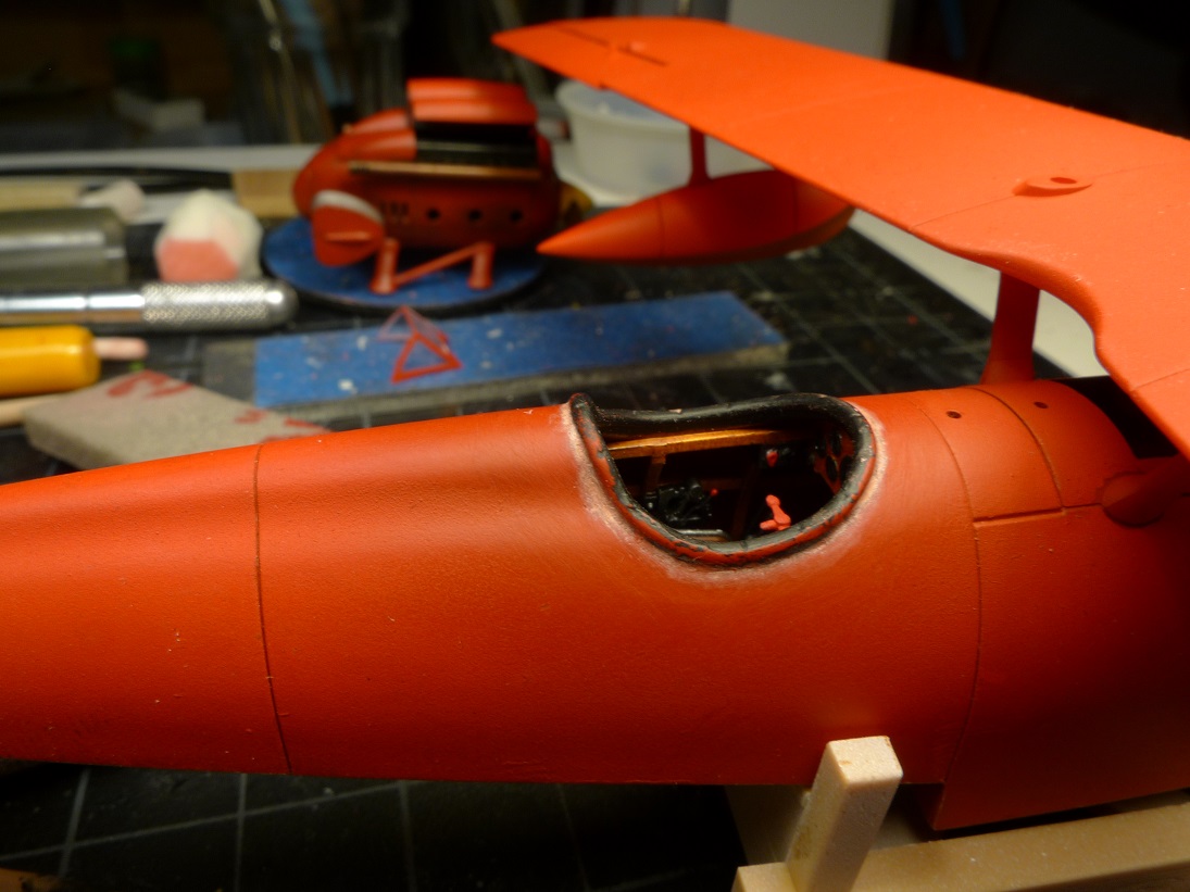

actually I have a question in the same vein. currently I am frustrated by not being able to create a clean straight line between two colors. in the picture below I need to have a clean separation between the black cockpit 'padding' and the red fuselage. I have tried hand painting (not steady enough
), masking with Tamiya tape (the curve prevented a good seal, thus paint seeped in
), Vallejo liquid mask (again, wobbly line
). off course every time I try and remove unsatisfactory work the airbrushed red get more damaged and harder to fix. liquid mask seems to be the best option therefore i suppose i should just keep trying till i am happy with the separation. how do you guys deal with painting parts that are molded as one piece but require different colors? this is one of the issues with building from a kit i have failed to overcome so far

a380,.try this.....a380 wrote:actually I have a question in the same vein. currently I am frustrated by not being able to create a clean straight line between two colors. in the picture below I need to have a clean separation between the black cockpit 'padding' and the red fuselage. I have tried hand painting (not steady enough), masking with Tamiya tape (the curve prevented a good seal, thus paint seeped in
sorry for the rant
thanks
amit
Scribe a line around the padding, between it an the fuselage. Take your time and make several clean and neat passes. Now tape round the area and burnish the tape down into the scribed line to achieve a uniform separation all the way around. Next trim of the area you want to paint with a new sharp blade and removed that portion of the tape. You will have a good sharp edge that will airbrush just fine. This will also work just as well with liquid mask.

Several light coats that are allowed to set up in-between is always the safe way to go to prevent leakage under the mask.

thank you got_cha and sargentx for your advice.
I will definitely try the scribed line technique
