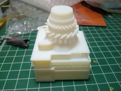

Image The island came out great. I like the solid windows. Easier to paint. Great job Chris!

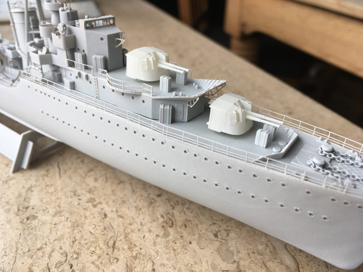

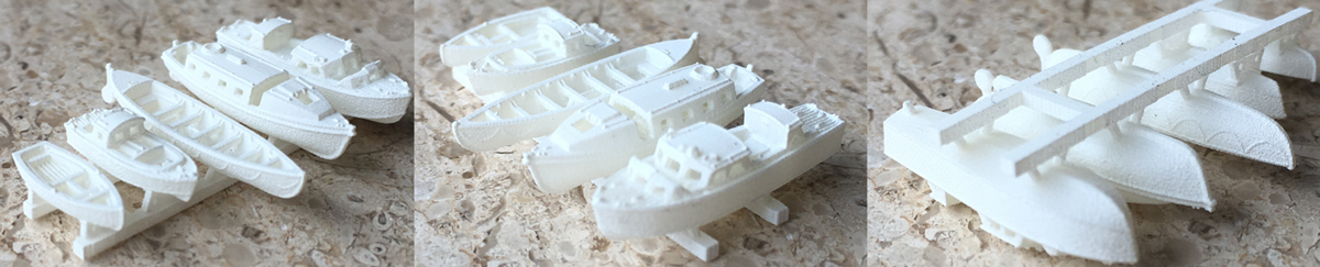

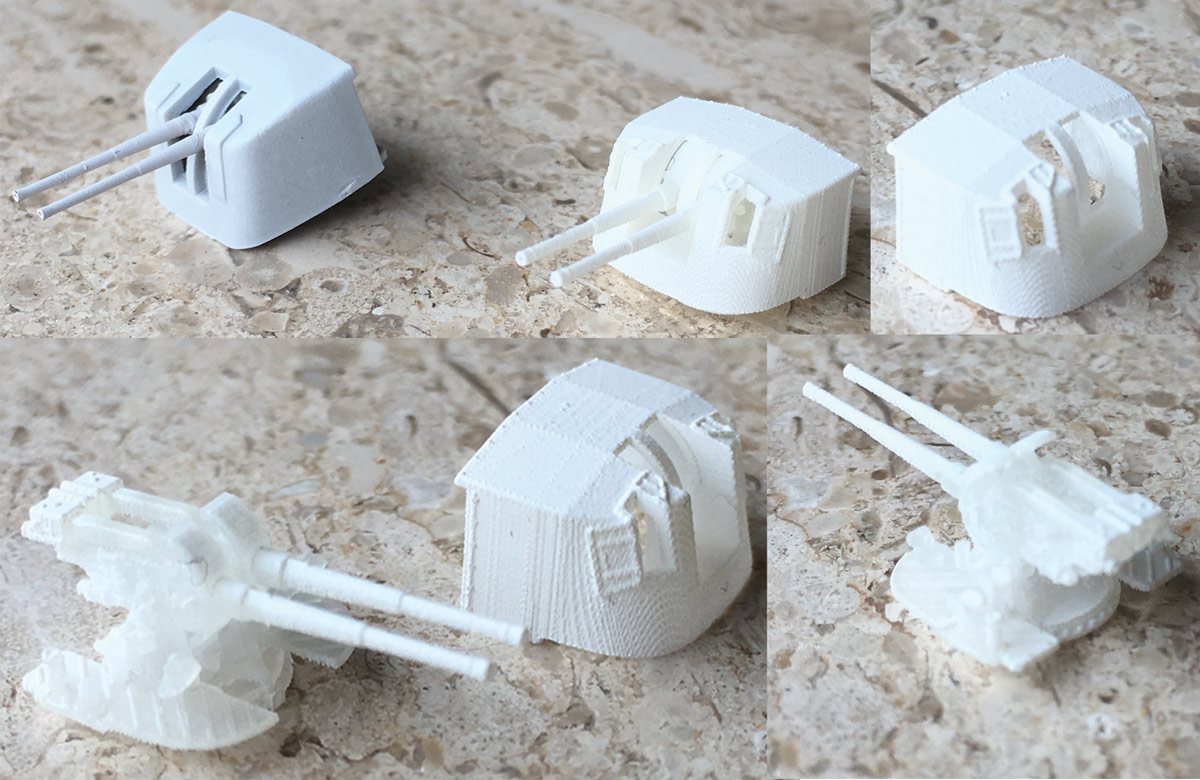

I ordered some of MicroMaster's excellent Royal Navy sculpts in 1/350 to improve my HMS Zulu.
Overall the prints came out nicely. The sculpts themselves are great and very detailed and a huge improvement over the parts in the original Trumpeter kit.
Since the translucent plastic photographs poorly, I've given the parts a light dusting of white primer, to bring out the details better. No further cleanup was done to make the review as accurate as possible.
This was my first attempt to print anything in Frosted Extreme Detail (having previously used Frosted Ultra Detail for some wargaming related miniatures), so I was very interested to see if there was a noticable improvement over FUD-prints.
All details on the models have printed well - and some of these are very fine indeed. The gun loading mechanism is extremely impressive! I did notice some roughness to the prints on some curved parts, that I haven't experienced with FUD. This probably has something to do with the orientation of the model in the printer and a bunch of other technical issues, and some roughness is always to be expected on curved surfaces due to the way a 3d printer works.
The most noticable areas are the front of the turrets and the boats' hulls, but these are easily fixed by scraping with a sharp hoppy knife.
I haven't quite decided if I want to go with the printed barrels (which are more correct) or turned brass (which is smoother).
As always make sure to clean your models properly. At first I thought the side windows on the motorboat hadn't printed properly and it was only after scraping with a needle that I discovered that they were still covered in waxy residue from the printing process that Shapeways hadn't caught in their cleanup process.
One minor criticism though, is that the very fine rivets on the armor plating - while probably correctly scaled - could benefit from being exaggerated slightly, as they are barely noticable among the general roughness and will almost certainly dissapear completely after a coat of paint. Shapeways simply don't offer a sufficiently high resolution printing technology to solve this issue. Compared to the NorthStar models 4" gun visible on the finished model I wouldn't mind a bit more exaggeration of those kind of details.
I wouldn't say that there's a big difference between Frosted Ultra Detail and Frosted Extreme Detail. You can print finer detail, but ythe slight roughness on curved surfaces persists. Still, the price difference is minor, so there's not really much reason to go with the cheaper option and overall I am very pleased with the results!
