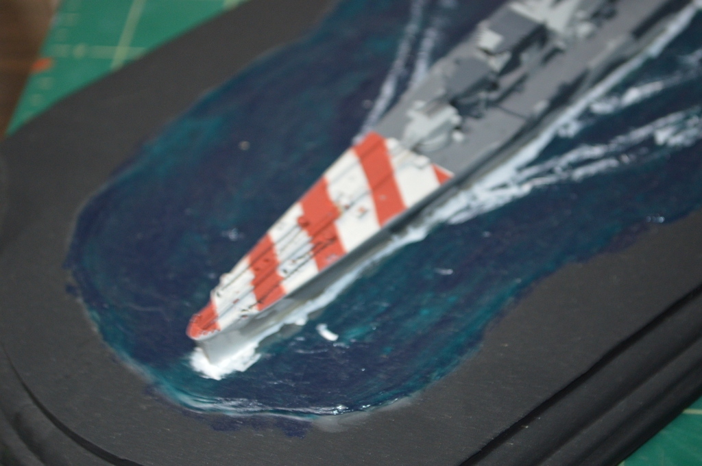

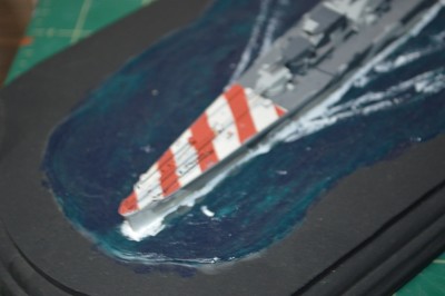

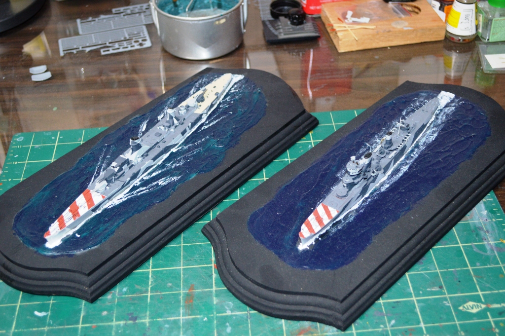

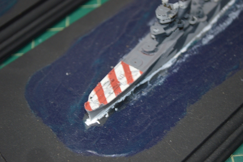

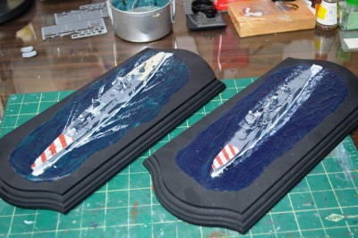

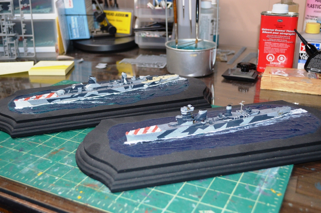

I did the stripes on some Italian cruisers some years ago with tape. I think I used Testor's tape? It was more elastic then Tamiya tape and easier to use. I airbrushed the white first - masked and then airbrushed the red. Not perfect, but not that bad (I think?):
Trento (left) and Bande Nere (right)
Bande Nere
Bande Nere
Trento
Trento
These are more than a few years old, and have been languishing on the "shelf of doom" for sometime. I should really get around to finishing them sometime.
