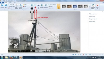

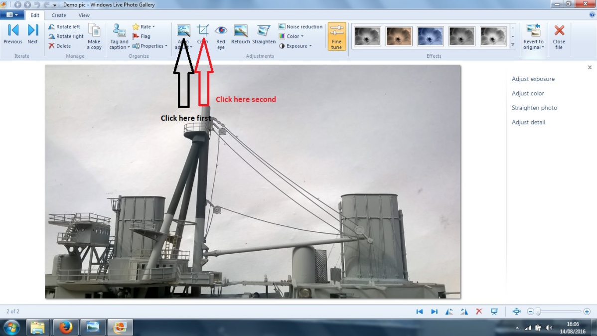

At the top of the page, you will note the tags 'File, Print, EMail, Burn, Open'. Select 'open' and from there - 'Windows Live Photo Gallery'. A new tag opens at the top, 'Edit, organize and share'. Select this and once opened you will be allowed to select the desired image.
Once the image is open, I always select 'Auto adjust' as this will enhance the image to the best contrast, brightness, colour saturation etc. I then, if required, select crop.

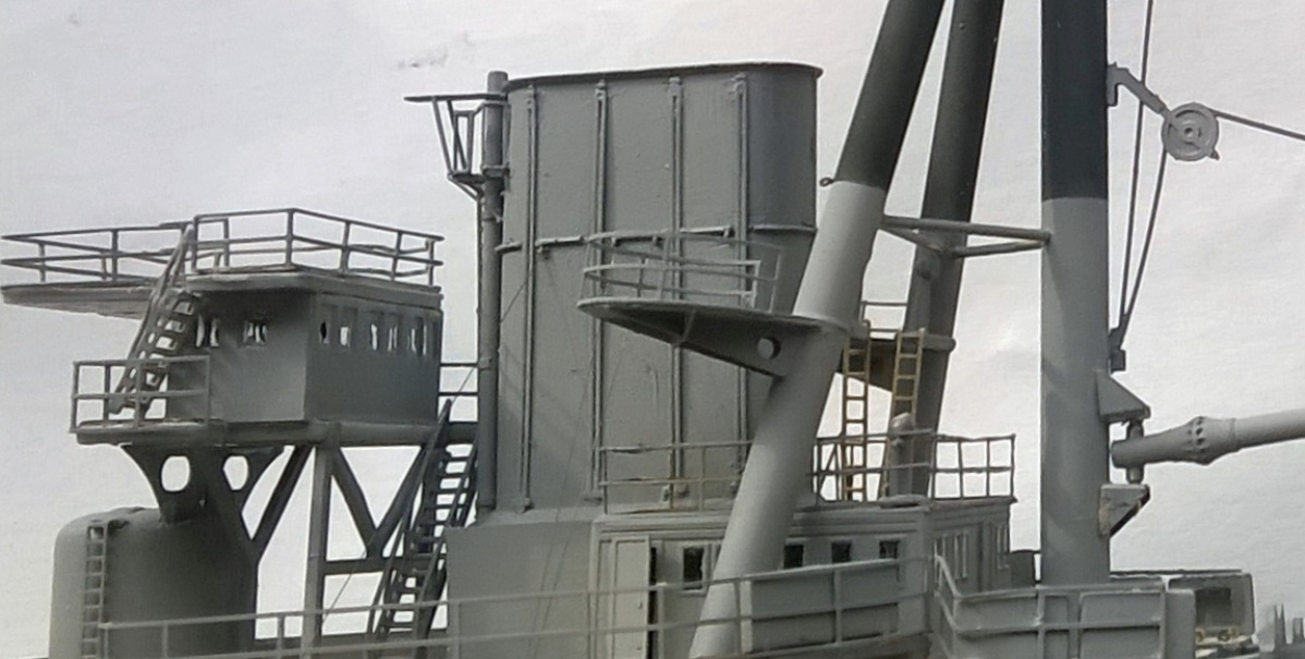

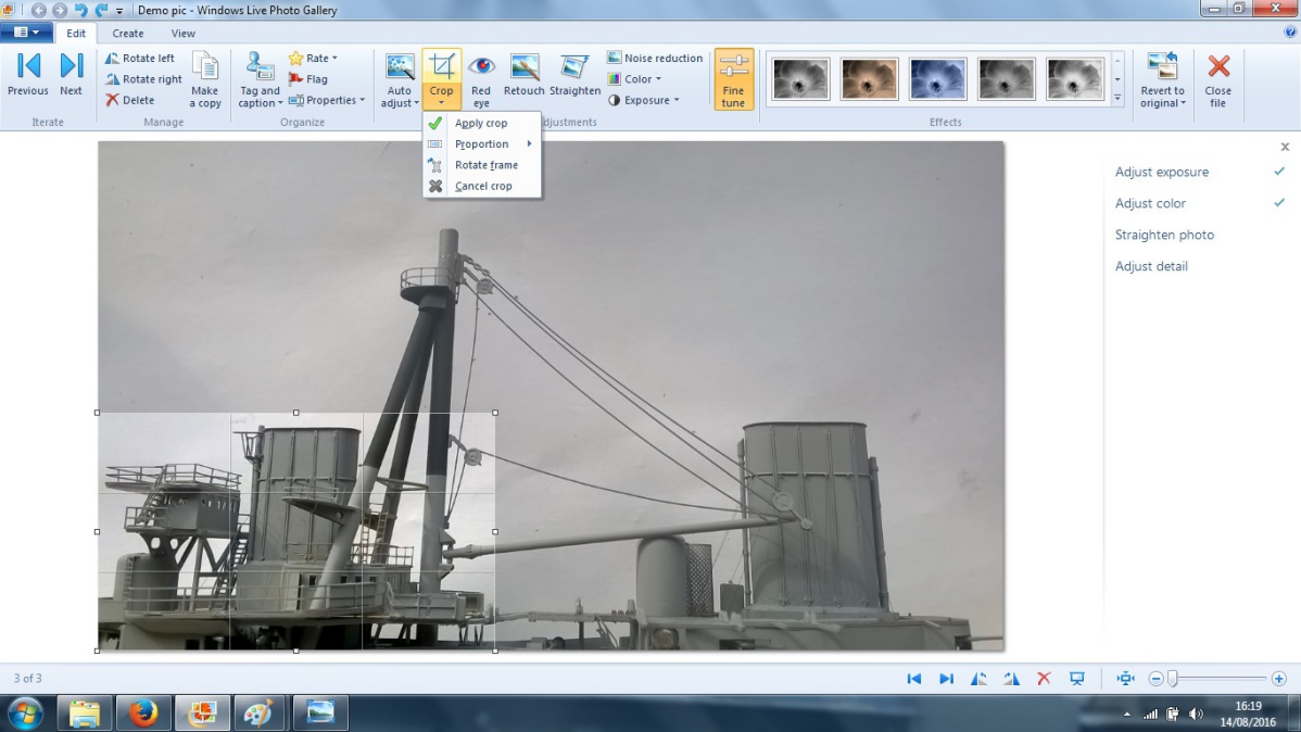

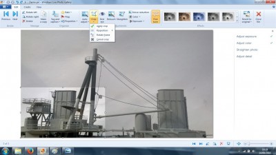

When 'crop' is opened a square will open on the image, you can now reduce, enlarge or move that square over your photo to select the area you wish to display by hovering your mouse over the little boxes at the edges of the box, or in the middle and moving the box around the screen.
Once satisfied with the selected area, left click on the box at the lower part of 'Crop' and a drop-down appears, click on 'Apply crop' and the earlier highlighted area fills the screen.

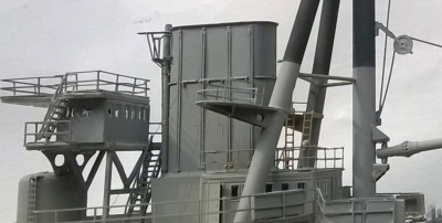

If you are satisfied with the selection, in the image, right-click and select copy. That's the image now prepared for display.
If you go to the containing folder and right-click on this new image to check the properties as before, they are still not of the required parameters. The readings for this particular image are - size - 306 KB (313,541 bytes), and dimensions - 1149 x 580. The file size, although massively reduced from the 1.3Mb of the original, is still too big, but the image dimensions are below the 1200 pixel limit. We will now deal with both.

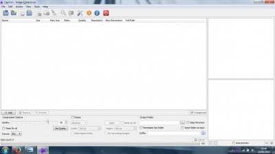

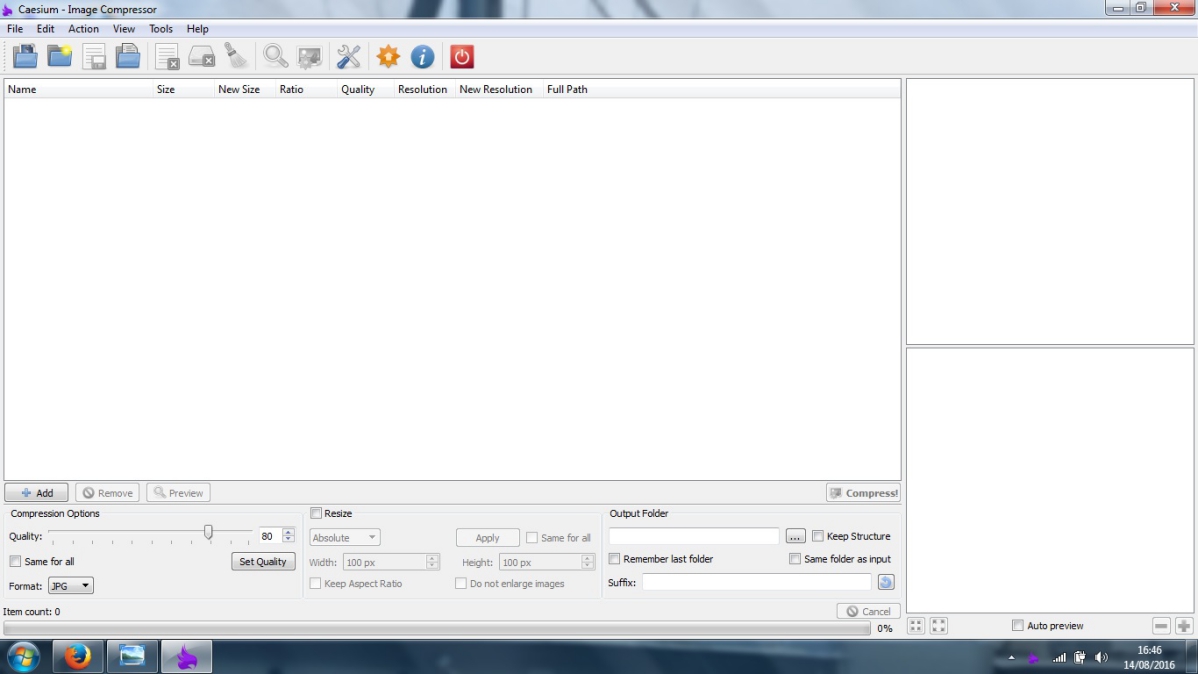

Once downloaded and opened on your computer, you will see this as your initial screen -

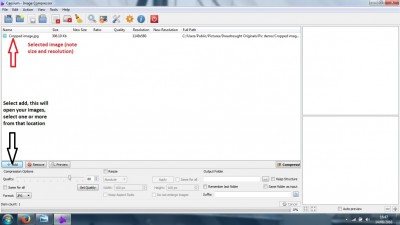

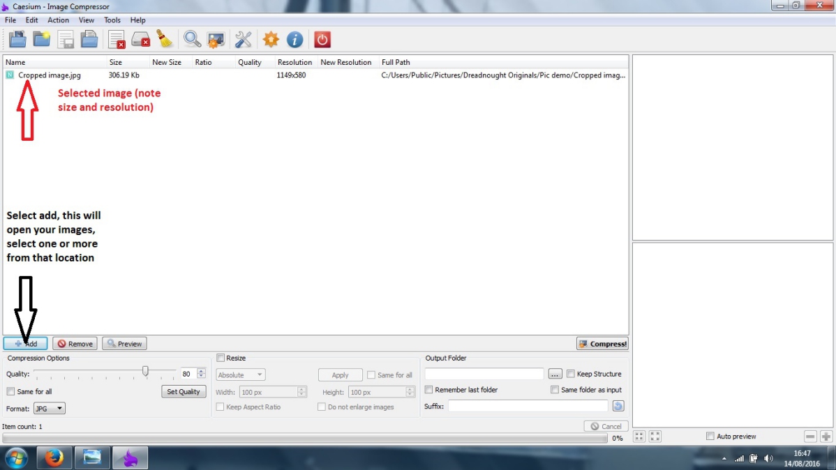

We now need to add our images, simply click 'add', this will allow you to navigate to the desired folder and enable you to add single or multiple images as required to allow reduction.

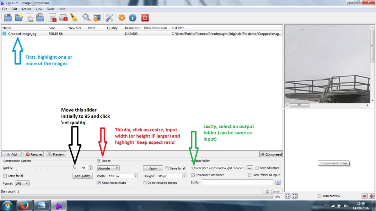

We now need to manipulate the image to adjust the parameters to the requirements.
The software allows us to adjust the image quality and the image size. Click on the image/images and then select the quality slider. I adjust this to 95 initially. Then select and tick the 'resize' box. This will set the pixel limit, either width or height. Adjust to 1200 and tick 'keep aspect ratio' this will automatically set the height, if it doesn't, simply click outside the 'resize' box. You will need to select an output folder as required. Once everything is filled in, click on 'Compress'.

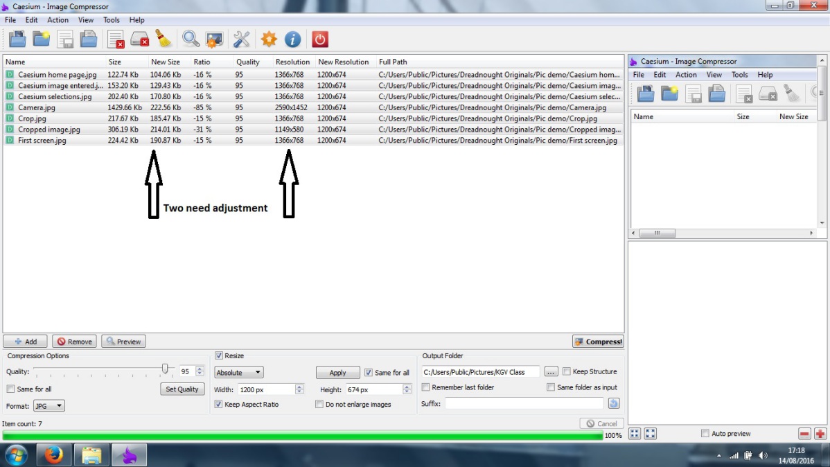

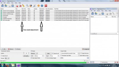

As long as the 'new size' column is below 200kb, your work here is finished! If it isn't, you will need to adjust accordingly, as below -

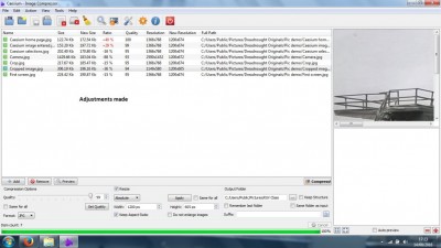

If you notice, in the new resolution column, all the sizes are the same. Two of the images have different aspect ratios. The software allows you to adjust these individually. I have done that now so here is the screen after the adjustments are made -
Notice how the quality column figure has been adjusted to make the 'new size' as close-to, but under 200kb. You can adjust these figures as many times as you like by pressing 'Compress' any number of times.
If we now go to the output folder and recheck our sizes, you will find they match with the software figures.
